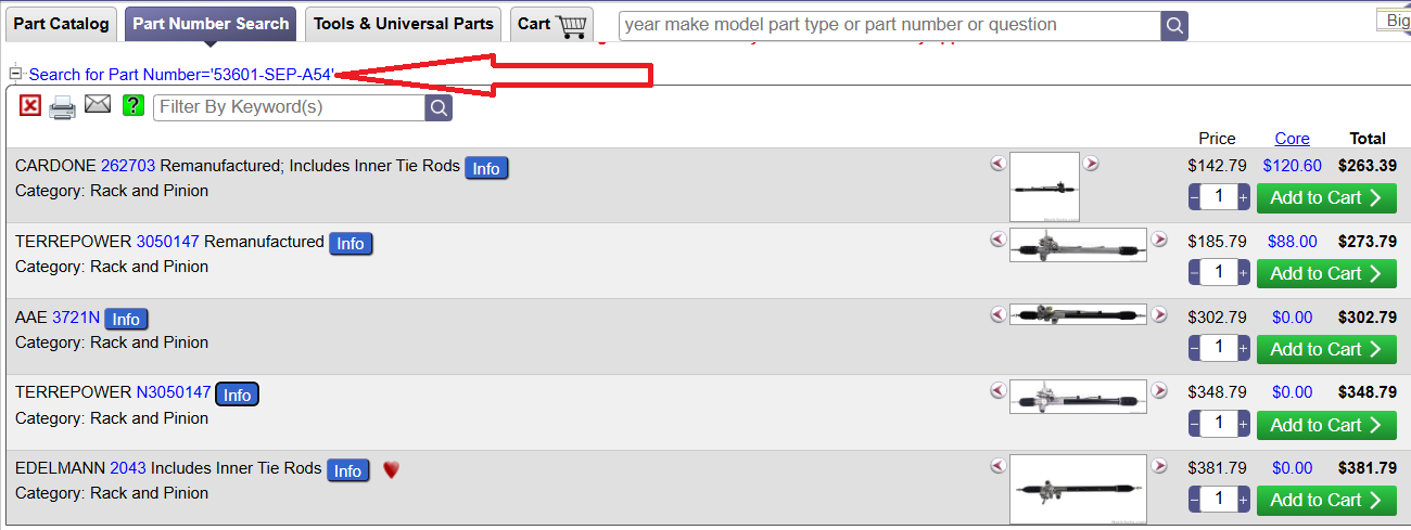

Here's the OEM part number...
and here are all the rockauto available racks that tie to that OEM part #.
Thank you for the information. When I type the part number it pulls up the base model racks. Do you mind sharing the link pretty please.
The screenshot with the parts actually do not have the 2.64 end to end turning ration. They all have 3 which is for the base model unfortunately.

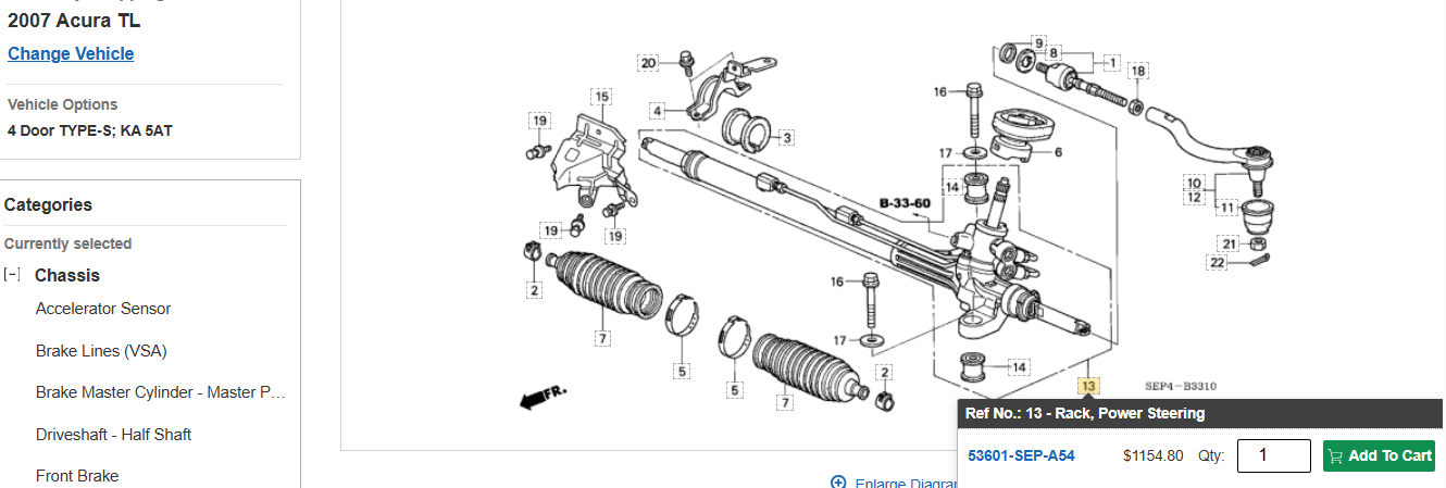

Old Apr 30, 2026 | 05:18 PM
csmeance's Avatar
Posts: 21,411
Likes: 2,187
From: Space Coast, FL
Here is a the parts diagram with the "short rack" (Item #1) for auto or Manual trans - About $1100 plus shipping - it's odd because the listing is for type-s but the rack is for the 3.2L according to the description. best to call an acura dealer or this site and see if they can give you an accurate part no.
https://acura.oempartsonline.com/v-2...ted-components
There are a few sites like OEMacuraparts.com that might be closer to you and have a lower shipping cost so look around and make sure to factor in the shipping. You can buy new boots and all that jazz if you want from acura or go aftermarket for them such as the inner tie rods, etc or reuse your old ones.
Make sure you use ONLY ACURA/HONDA Power steering fluid!!! Autozone equivalent is too thin and will cause lots of leaks. If you are using aftermarket fluid, flush it for OEM and see if your leak goes away.
Otherwise your other option is used or to get your current one rebuilt by someone.
