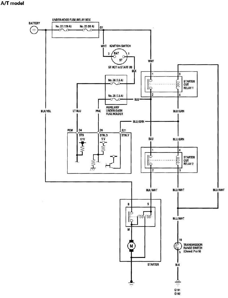

Starting system is not too complicated. If it clicks loudly, then most likely starter is going bad. But the click must be coming from under the hood - not from relays in interior fuse-box. If not sure either check if starter solenoid is getting power, or try to jump the starter directly from the battery positive.
Here's the diagram for auto 07-08. Other models will be different. There's is couple fuses to check.

Car doesn't display anything about checking starting system, right? If it wasn't clicking and battery is not dead, then I would start with checking out listed fuses.
Next step after fuses, figure out if starter solenoid is getting good power. Maybe try to jump the solenoid to battery positive to see if it will crank.
If starter is good, then take out Cut relay #2
When attempting to start the car, one side of this relay coil should have good power, and other should have a good ground. (pin #3 and pin #4 on schematic) (use test light)
If no ground, then take a look at trans range switch. If no power then pcm is not sending a signal, check the ignition switch. If both present check if power appears at pin #1 of the same relay when attempting to crank.
