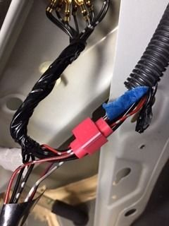

The quick splice did the job- you need an 18-22 gauge splice to do trick.
Here's a picture of 'fix':
I used the blue tape only to mark the good wire. One hint is to drill out the barrel that has the plastic stop in it. This way you place splice on both wires and don't have to cut the bad wire. I'll wash the car and check for any leaks in the tail light area and then put the trunk interior back together.
