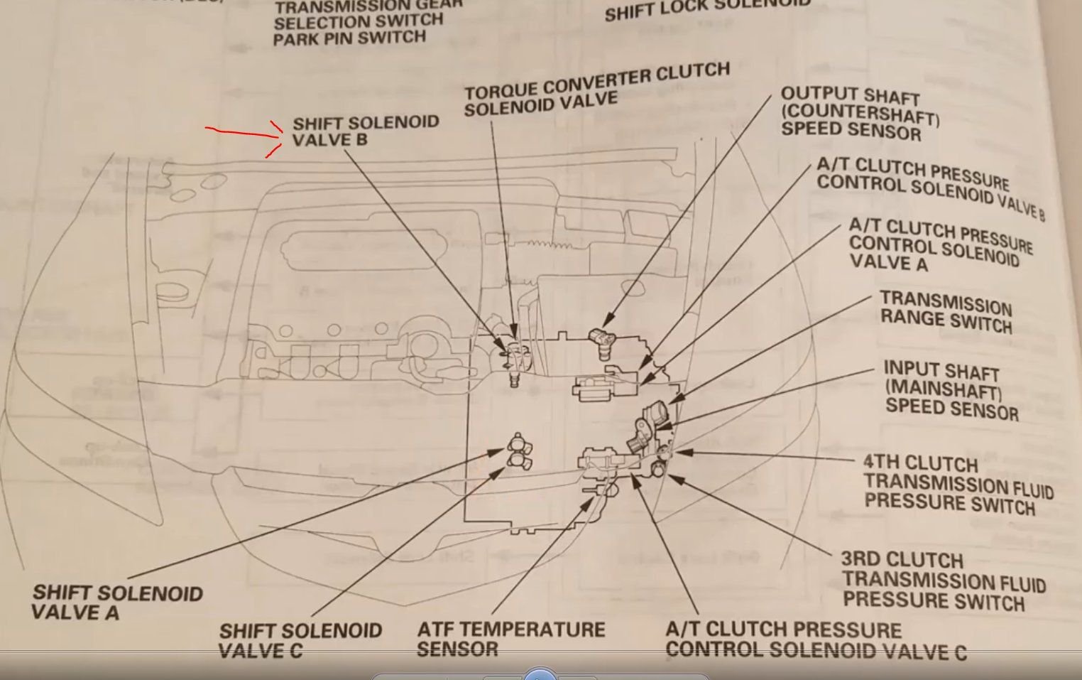

Hello guys could use some advice on fixing my 06 TL VSA indicator is on i have a P0976 code popping up its low circuit Solenoid B is that underneath the tranny if so which one is B because there's two of them there

There are 2 on top the tranny, under the Throttle body. I think the arrow is pointing to the front solenoid.
