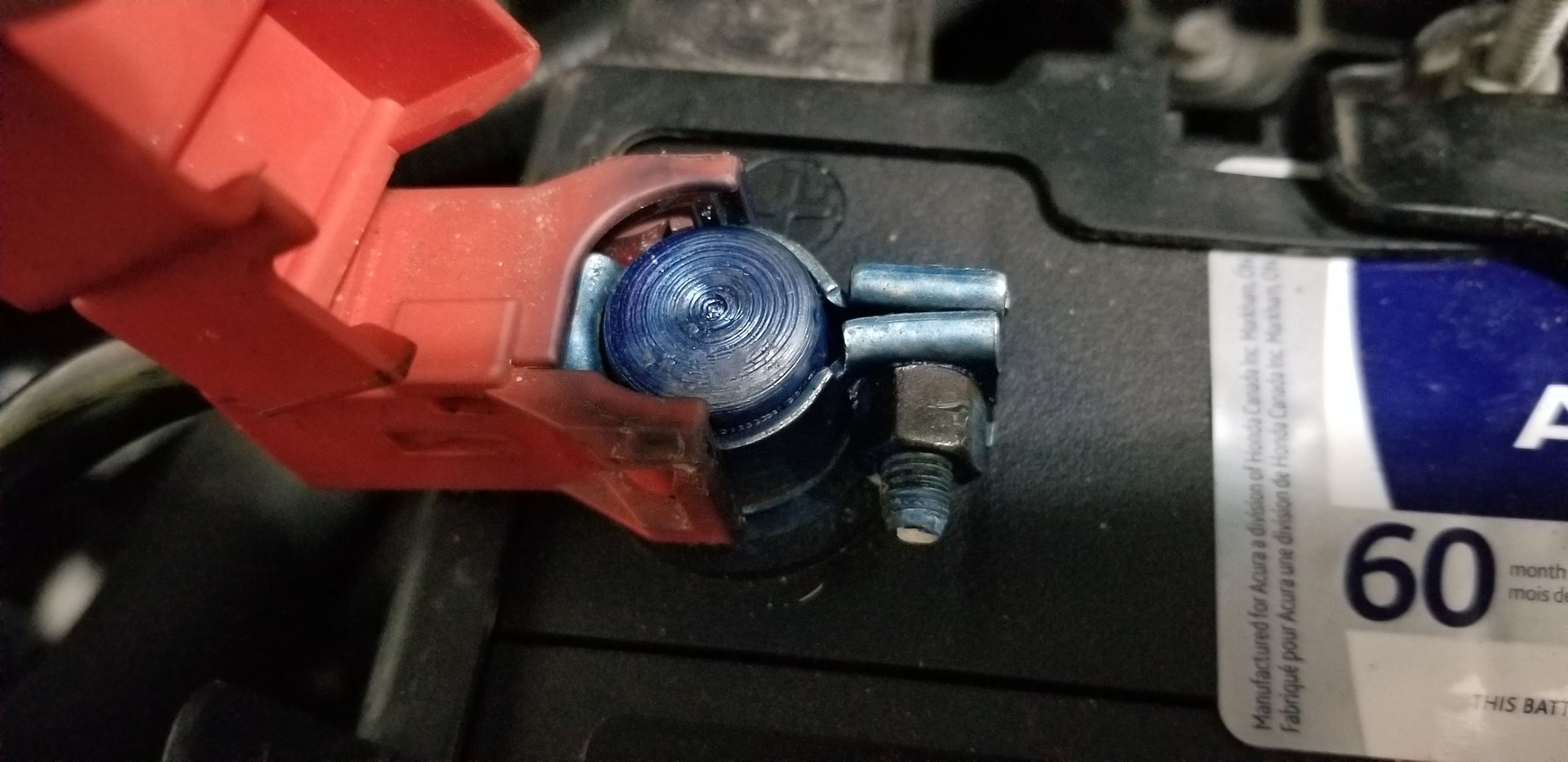

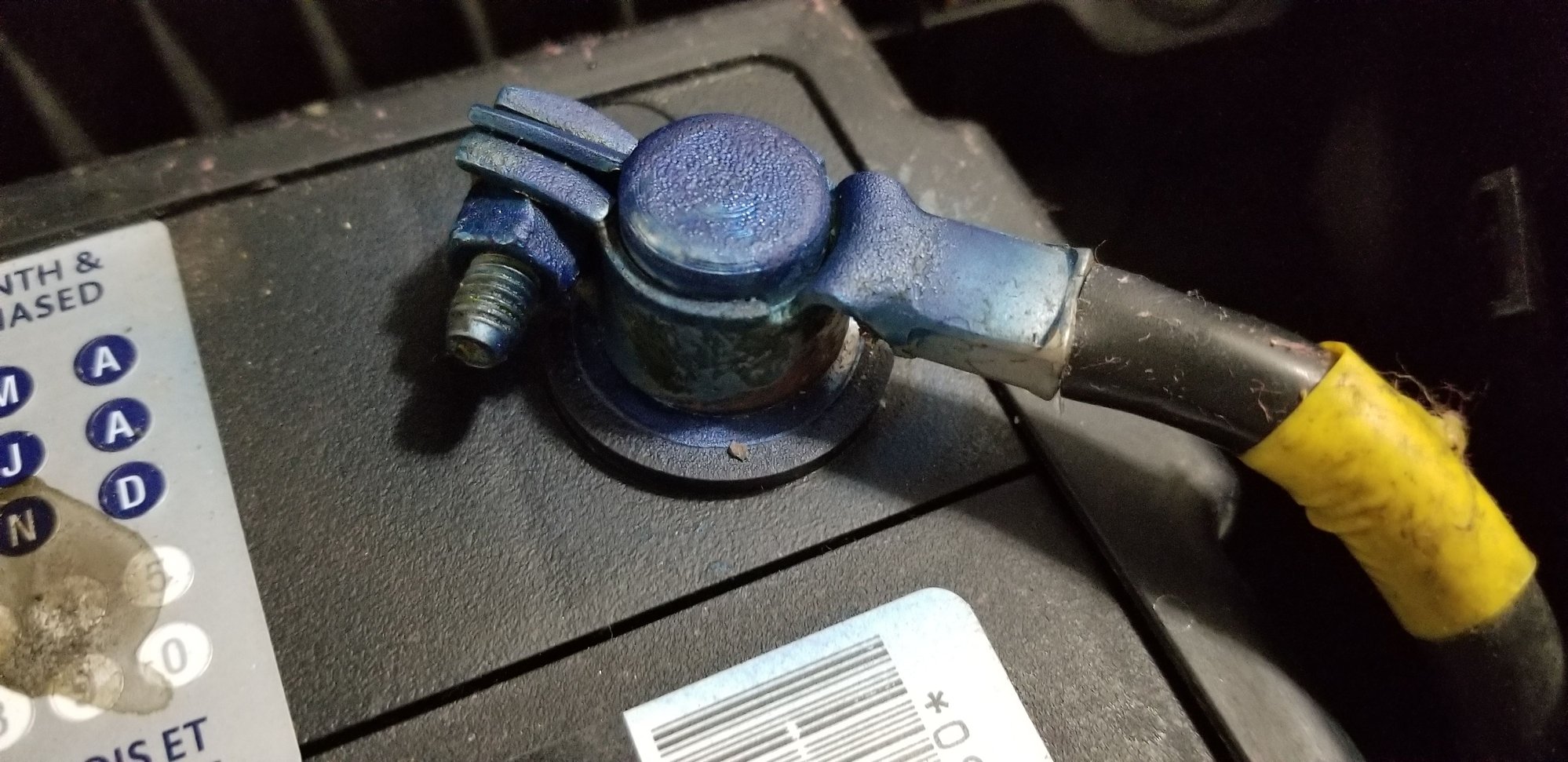

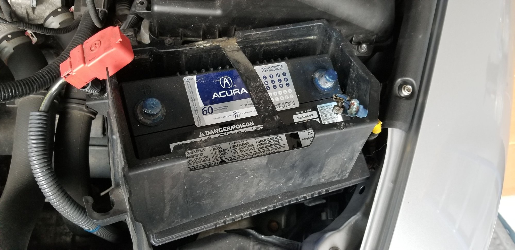

Did a check on battery terminal connectors. Looks like they really cleaned it up at dealer when Installing the new battery.

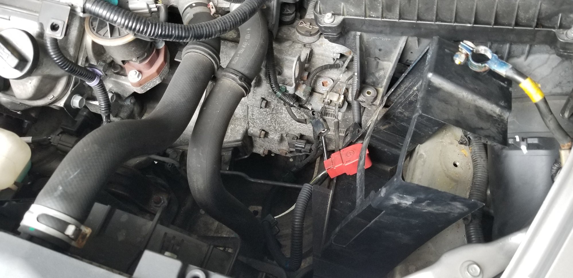

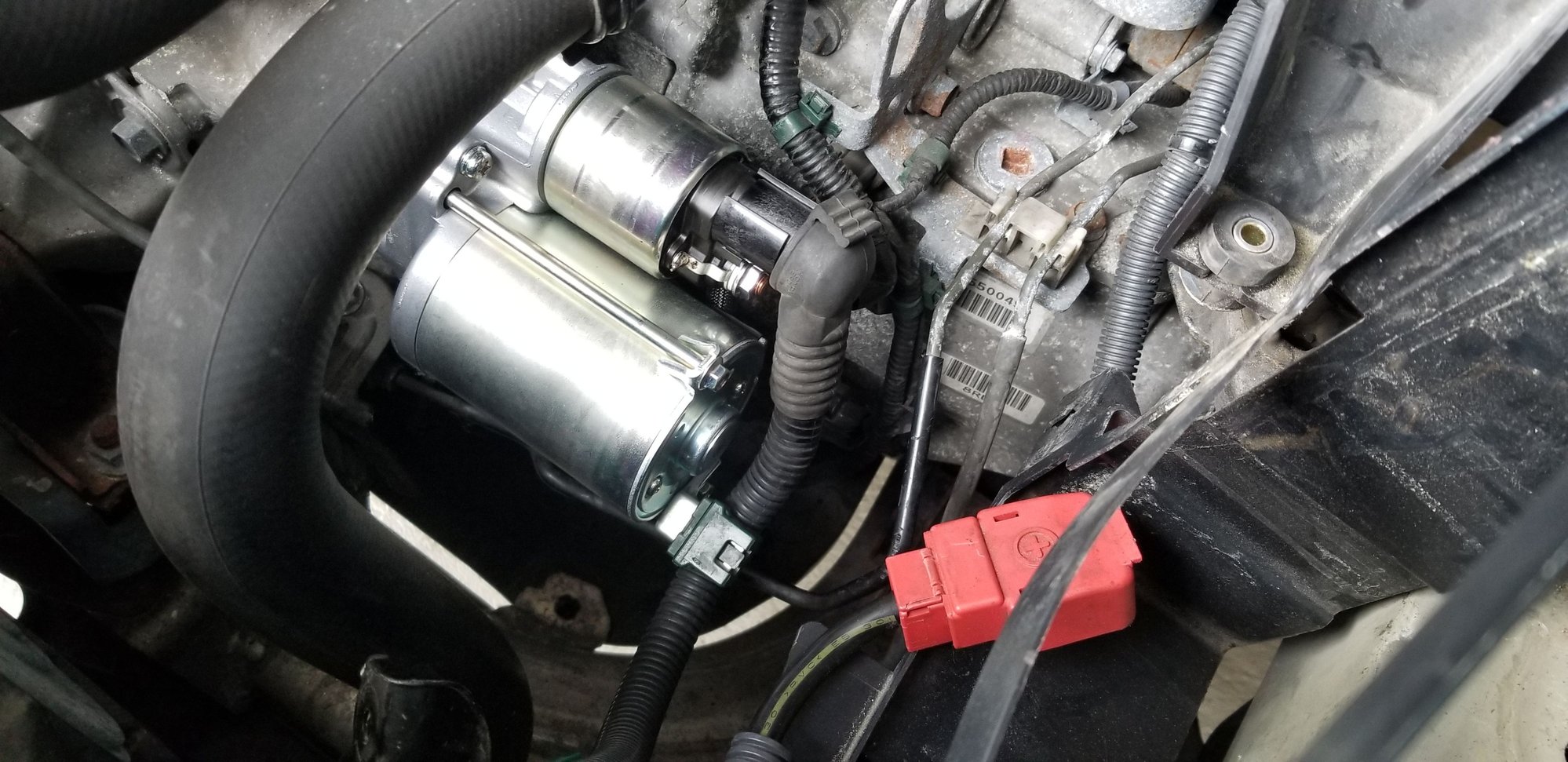

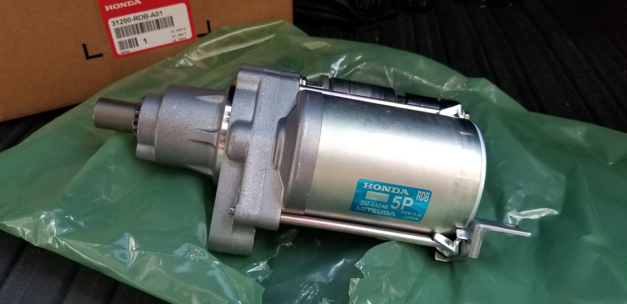

Here we go! DIY!

Nice starter! OEM *drool*

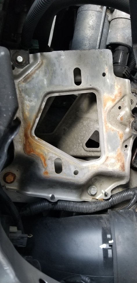

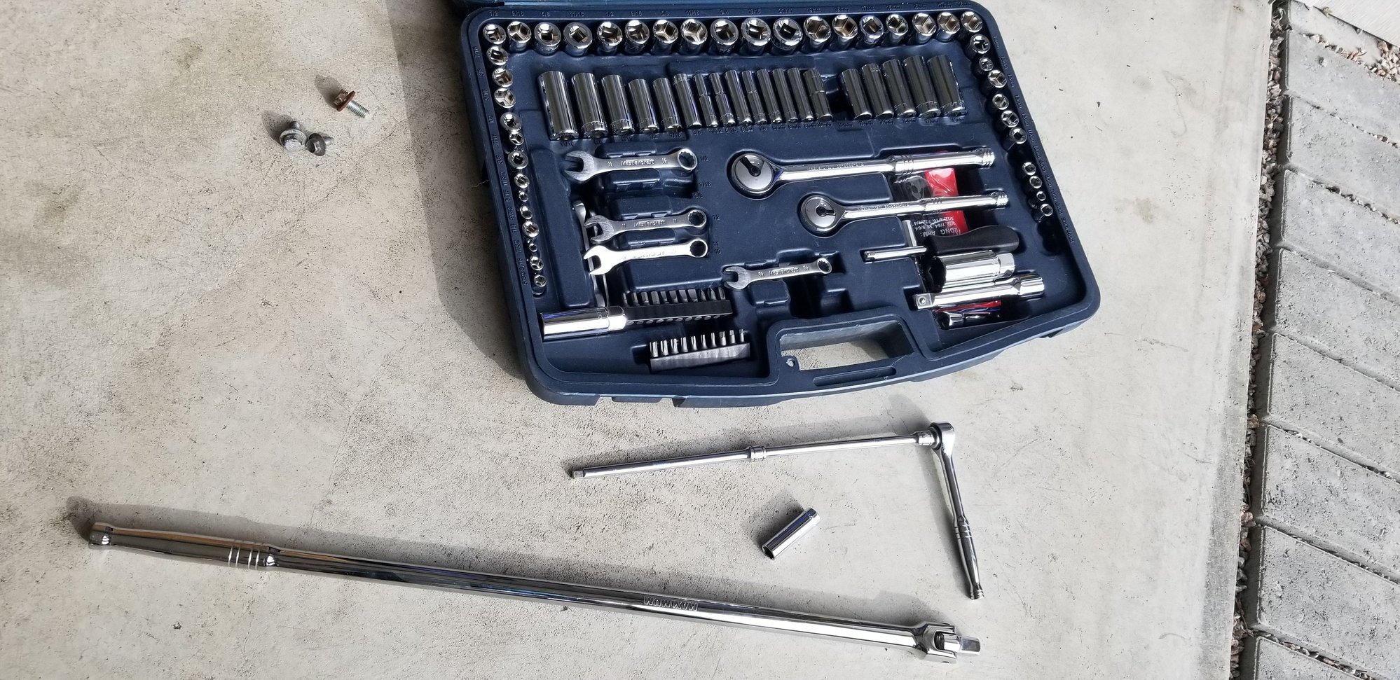

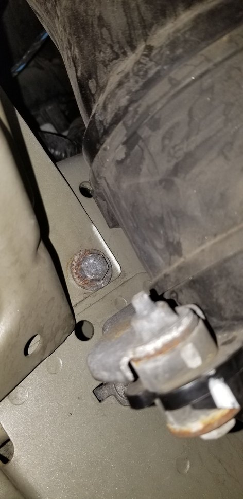

Phew. Done. And yup. It was the cursed battery tray that took forever.
Definitely glad I had a shit ton of sockets extensions and breaker bar.

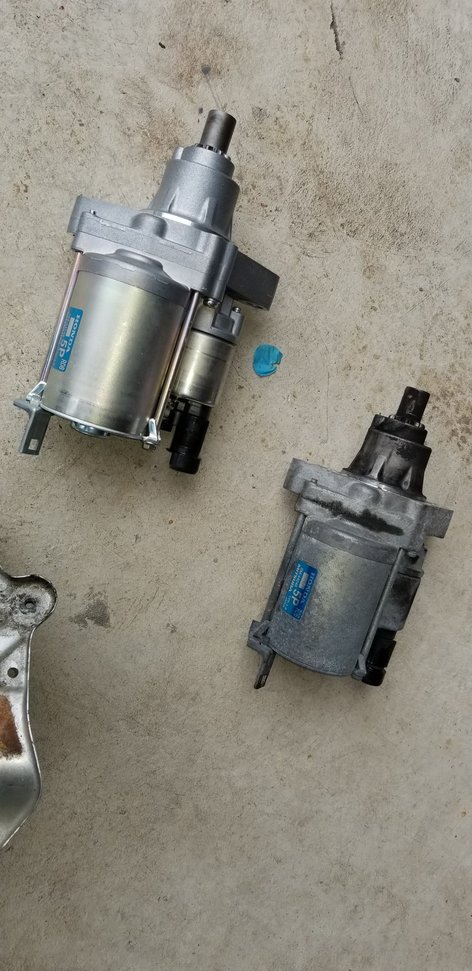

Happy to report that the car has been 'started' about 10 times since the new starter was installed - NO ISSUES starting.
