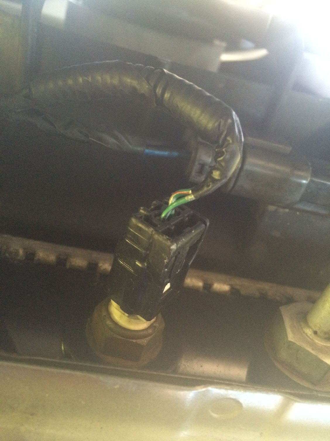

Electrical Clip removal
I got two estimates at $800+ from an independent shop (my regular independent mechanic is gone for most of the next three weeks on vacation) and $1200+ from an Acura dealer. So out of my comfort zone big time, but the hoses are disconnected and I would appreciate any advice disconnecting the electrical connection at the bottom of the radiator. I tried pulling and depressing on the white area on the right of the pic without any movement so I thought it best to ask.
Old Jun 16, 2016 | 11:42 AM
Posts: 48,311
Push clip harder or use a screwdriver
