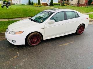

Hey guys, i have an auto, 08 Acura TL with 174k mls. Just purchased it today for 2500. It was a desperate buy do to my other car dying on me. I have an ill wife and child and need transportation for doctor visits. Anyway, i notice the car hesitates to get in 3rd or 4th gear and it down shifts kinda rough. Was hoping someone would have any insight on what the issue may be? First and second work just fine so far and fifth but as i said, when i slow down and it down shifts, its kinda rough like its stuck in the gear then goes.
