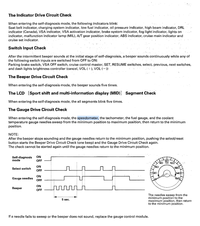

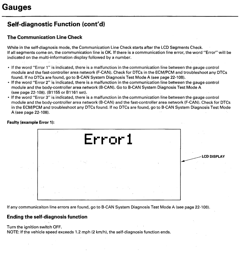

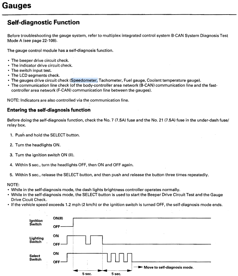

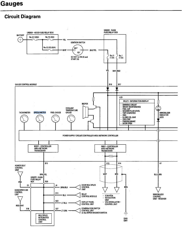

The gauge is controlled over the CAN line so it's not as simple as having the VSS straight to the speedometer. You could try the gauge self-diagnostics test. Note: you will need a bi-directional scanner to do the B-CAN System Diagnosis Test Mode A it mentions so skip it.
My advice:
  1. Do a full scan of all the modules and see if there are any related to the gauge cluster, VSS, or CAN.
  2. Do the self-diagnostic test and make sure the needles move freely. Could just be a sticky needle.
