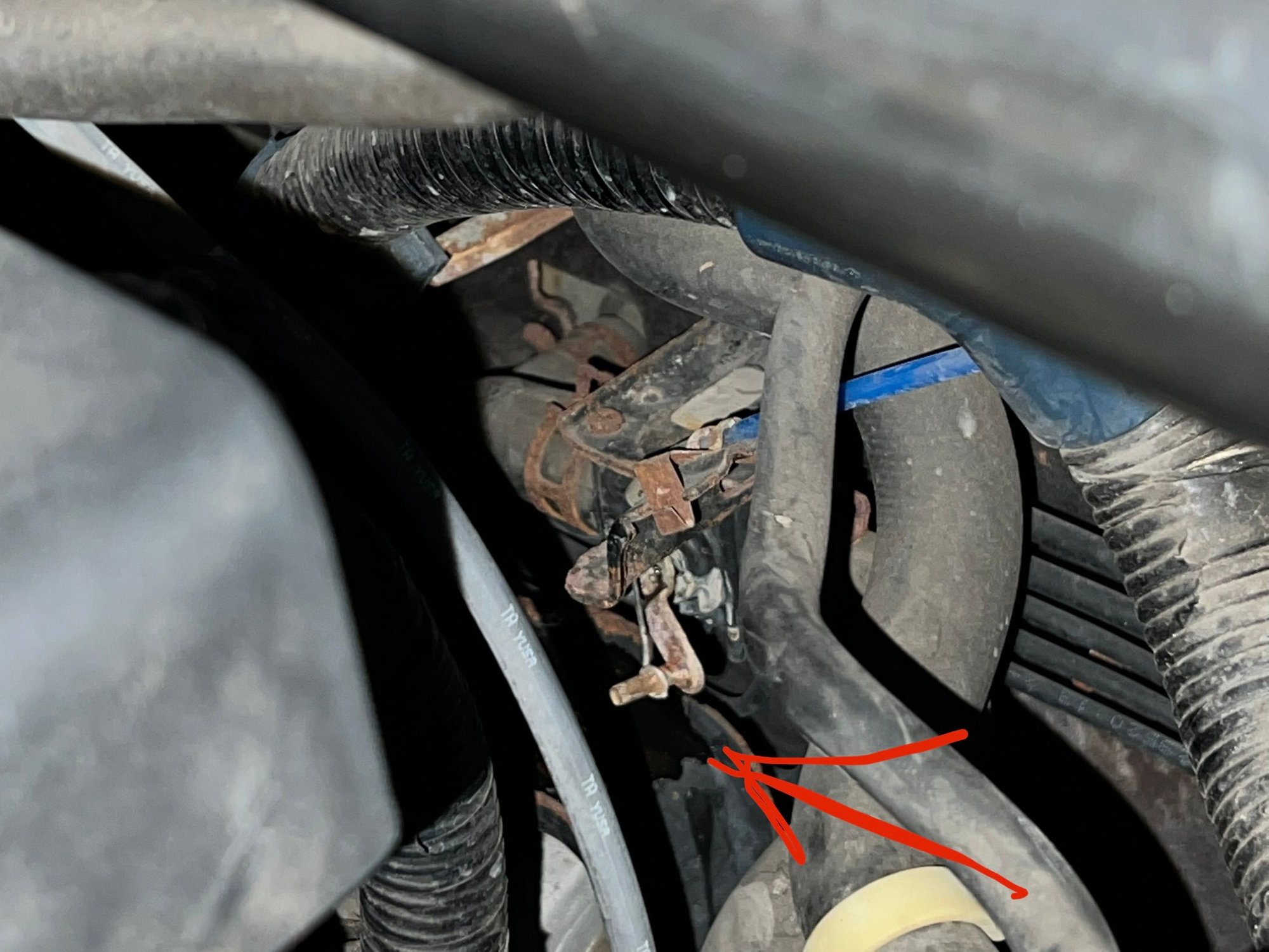

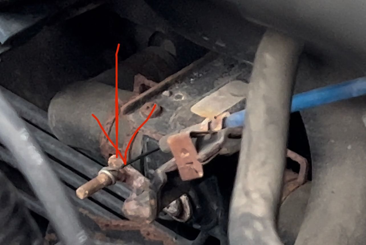

Can anyone help demystify this situation? Recently when it got cold noticed my heat wasn’t working was blowing cold air. Topped off the coolant with the Honda type 2 coolant i no change. Came to investigate the heat control valve being in the up position. Wiggled it until it seemed to move down with the car running. I get heat and cooling now in this down position so and noticed a bit of a leak. Okay sounding like it will need a replacement. My question is shouldn’t this valve be moving up and down for heat /cold? It doesn’t seem to move from the down position but the heat / cold still work. How could that be?
Up position no heat, ac works
Forced down heat / ac work fine

In the end blend door / air mix door inside the HVAC assembly, inside the car, is responsible for mixing the air to get the temperature that you want. It still has the ability to close the airflow over the heater core, so AC will still work even with the control valve stuck open.
Only problem is that you have very hot heater core inside the cabin, so some heat will "leak" and heat up the cabin. Peak AC performance will be diminished with heater core control valve stuck open. Cheaper cars often ignore it and not use the heater core valve.
It doesn't move most likely because either it's stuck and actuator is too weak to move it, actuator is broken, or linkage is broken. Since it's leaking replace it, and then you can see if actuator moves. Or remove the linkage and see if actuator moves without resistance. As even if it was working fine before / be able to eventually open the valve, too much resistance might had broken it (it's most likely all plastic gears inside the actuator).

Thanks I'll look to get the parts ordered and probably replace hoses and clamps as it's all rusted. For now since it will be cold till about February it should be okay in the open position.
