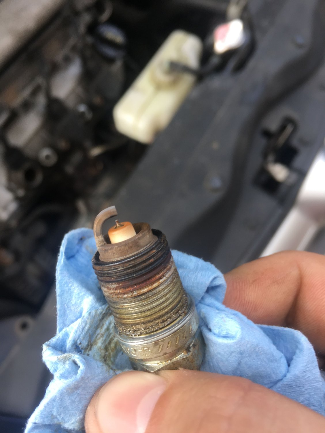

Ok, so after checking all the lines everything looked pretty good. I shoved the hose going to the front mount and it felt like it sat better in place, like it was halfway to coming out. I also pulled 1 plug to get a look at the shape of them since I have not changed them since purchasing the car. I will attach a picture of the one plug I pulled, You guys think I should change them all out? But anyways, after inspecting all lines and pulling a plug I put everything back together hook up the battery and voila! the engine has yet to rough idle again. I have only driven it a couple of miles and the engine has been running for 35 min but so far it hasn't surged again. I am not sure if it was the reset of the ECU by unplugging the battery or shoving the vacuum line into the mount further but the engine seems to have lost its rough idle. I will do some highway driving and really open her up and see if my results and consistent. Also please let me know what you guys think about how this plug looks.

Plug looks mint. Brown indicates ideal air fuel ratio. Problem most likely lied within vacuum or reset.
