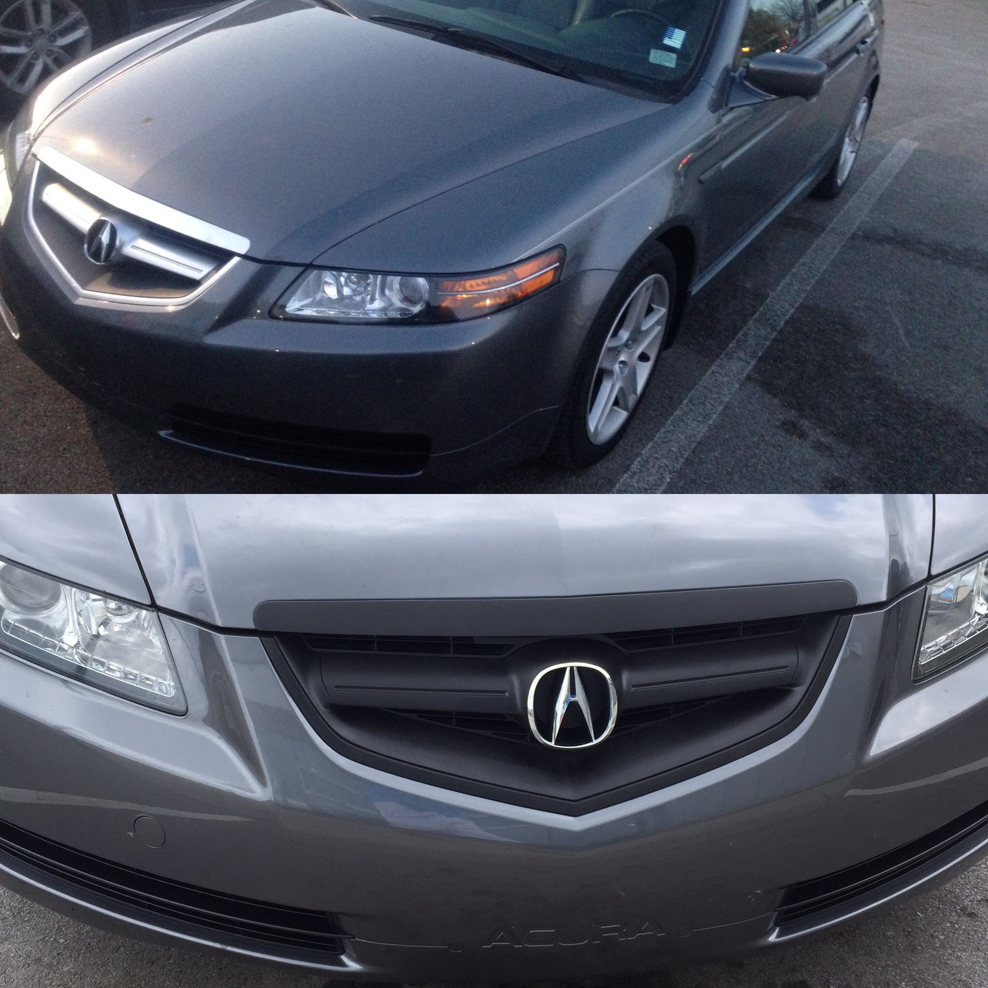

After seeing so many people tackle this project, I decided to try it for myself. Here is a before and after shot:

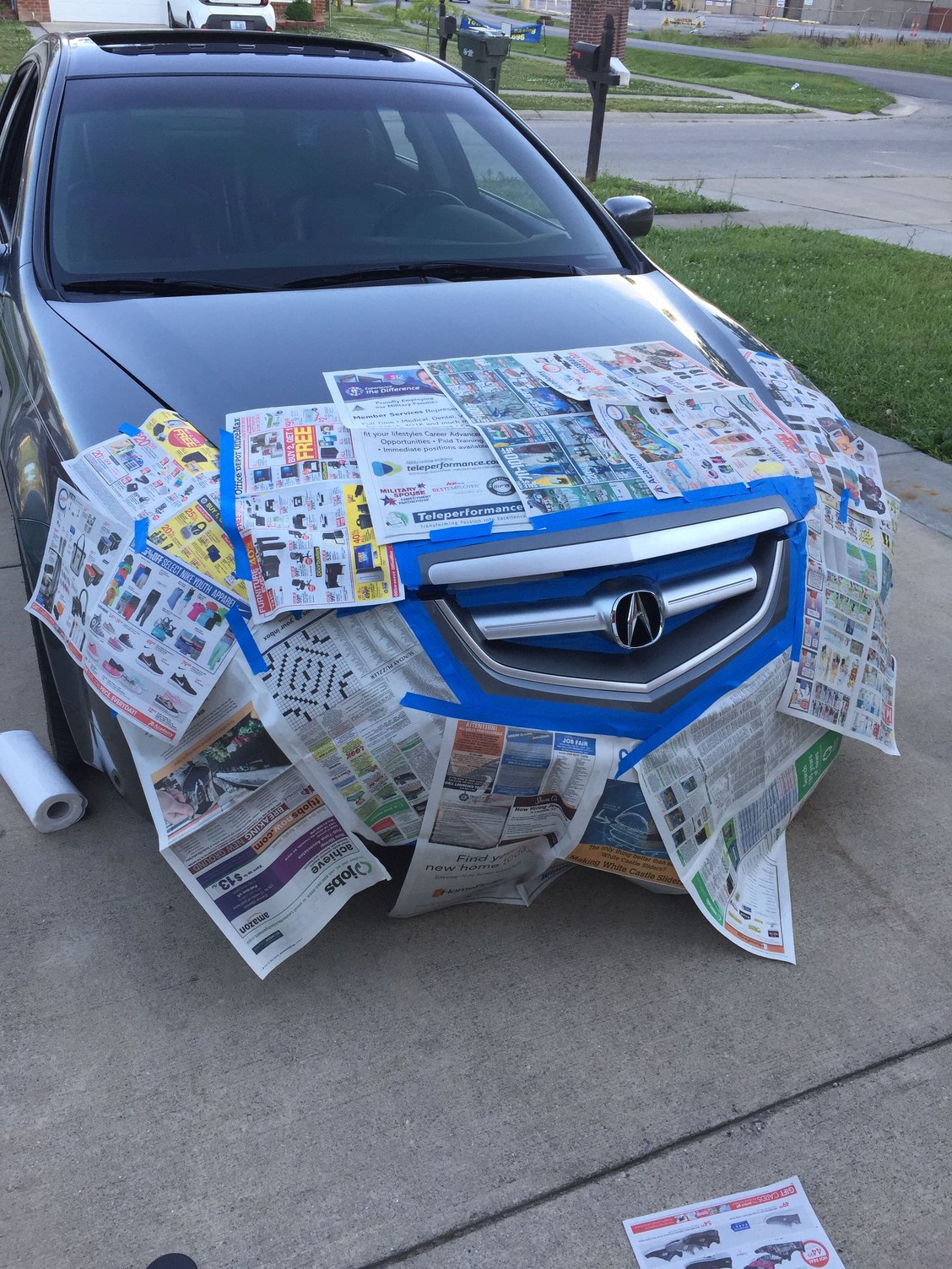

Taping properly may take a lot of time, but it's highly worth it. A common misconception with plasti dip is that you should tape right along the edge of whatever object you are trying to paint. This is definitely not what you should be doing. When taping, be sure to leave a gap (maybe a few centimeters) between the edge of the grill and the edge of the tape. Once the plasti dip dries, you will be able to peel off the excess plasti dip from your car's paint easily, leaving a clean edge. When peeling it off, plasti dip breaks at any edge, so you should be left with a clean line if done properly.
I chose to leave the Acura emblem chrome, so the same taping concept that I described applies as shown in the below image. I left a thin layer of chrome exposed, allowing me to easily peel off the plasti dip along the edge of the emblem.

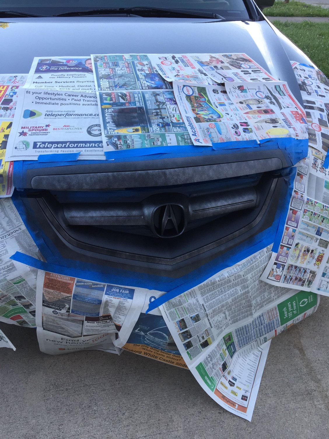

As instructed, for my first coat, I attempted to leave about 50% transparency. After about 15-20 minutes, the plasti dip was dry and I was able to apply my second coat. In total, I sprayed a total of 4 coats and there were not drips. Make sure not to hold down the trigger too long in one place.

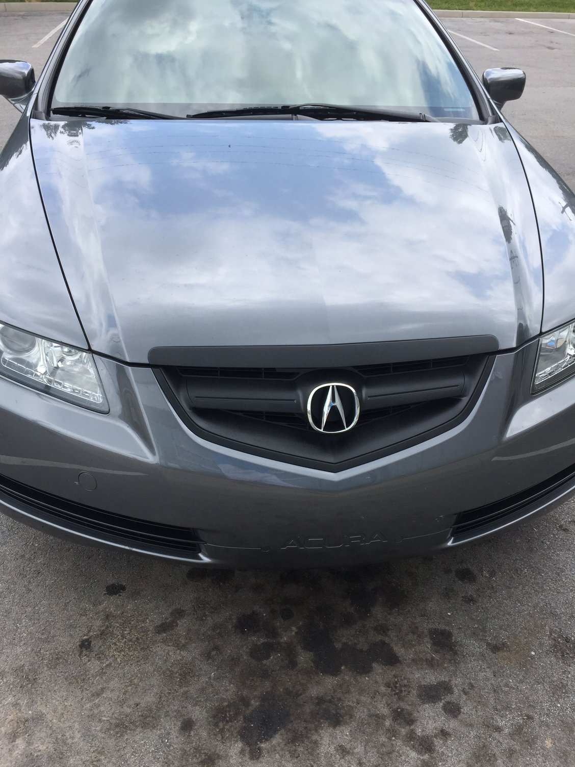

Once the plasti dip was dry, I added 3 coats of glossifier to add some shine. If you have a black Acura TL with the nighthawk black pearl paint, I highly recommend adding glossifier as well. This helps the grill match the factory paint and makes the finish look more natural.

Sorry that they aren't in order, my iPad won't allow me to re organize them. It all went well except the glossifier added a rough texture on the bottom. Did 5 coats black and 2 clear. The hood strip came perfectly and so did the center of the grill but not sure what I did to the bottom. It looks fine though. I may end up tearing it off and trying again but I'm happy with it for now
