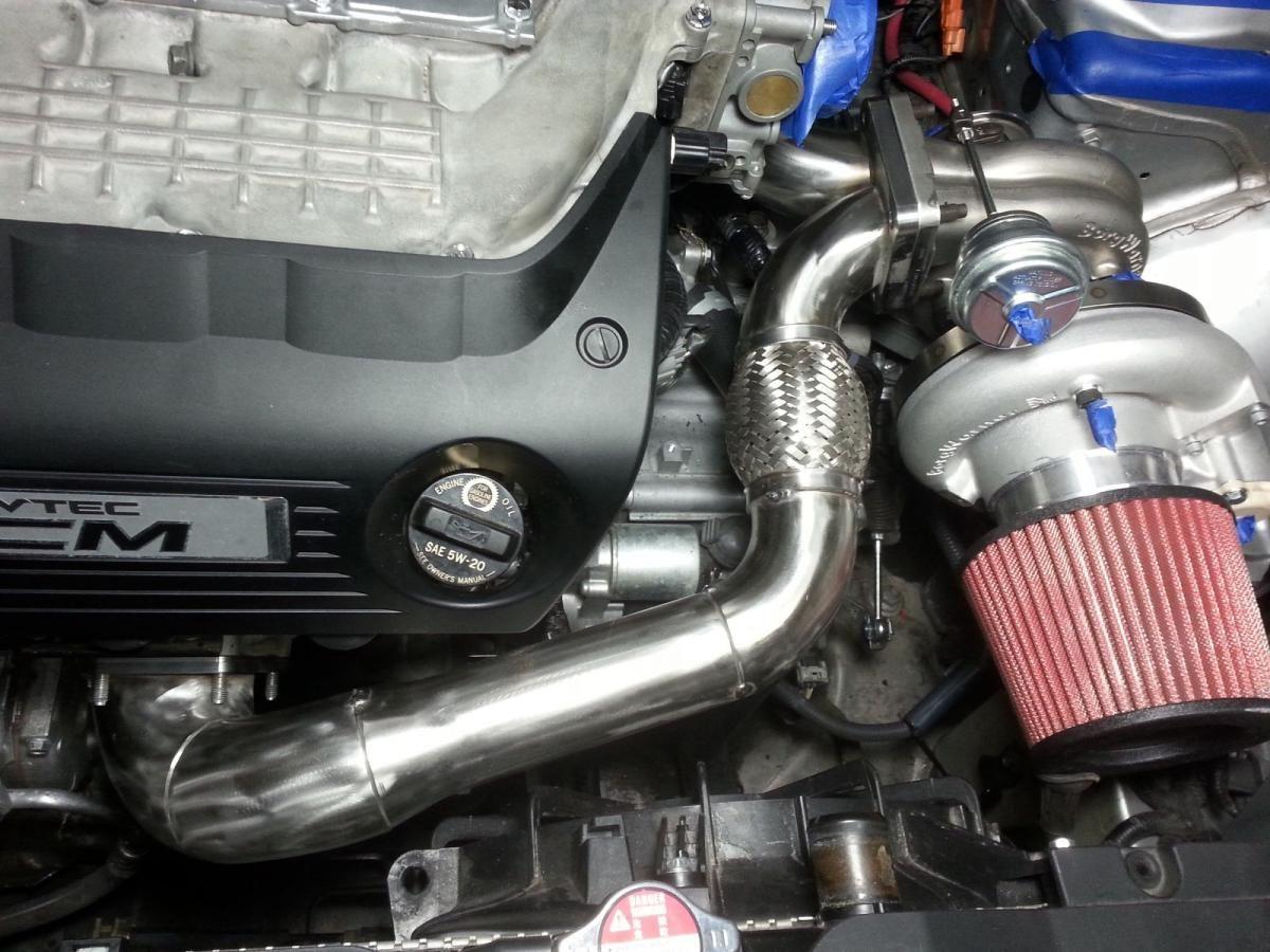

I’m looking to turbocharge my type S I’m buying next week similarly to how Utah TSX did. I want to go low comp high boost (15-18lbs) I know I’ll need pauter rods, colder plugs. But I’m looking for options on cams, as wells as good pistons for low comp. also he did water meth but I’ve been considering and studying E85 instead for its cooling abilities ( is it feasible to run both? Or straight meth with E85). Any suggestions? Does anyone know someone who can build another manifold like his? Or just trial and error on my own?

My main concern is just doing it right the first time and getting as much power as possible without breaking skirts and crap. End goal will be 600+ whp AWD lifted on 245/65/17 off road tires. Running at least E85 maybe straight meth as well. If needed I’ll switch headers but I’d rather not just cause I like the design especially with the turbo manifold in the pic.
