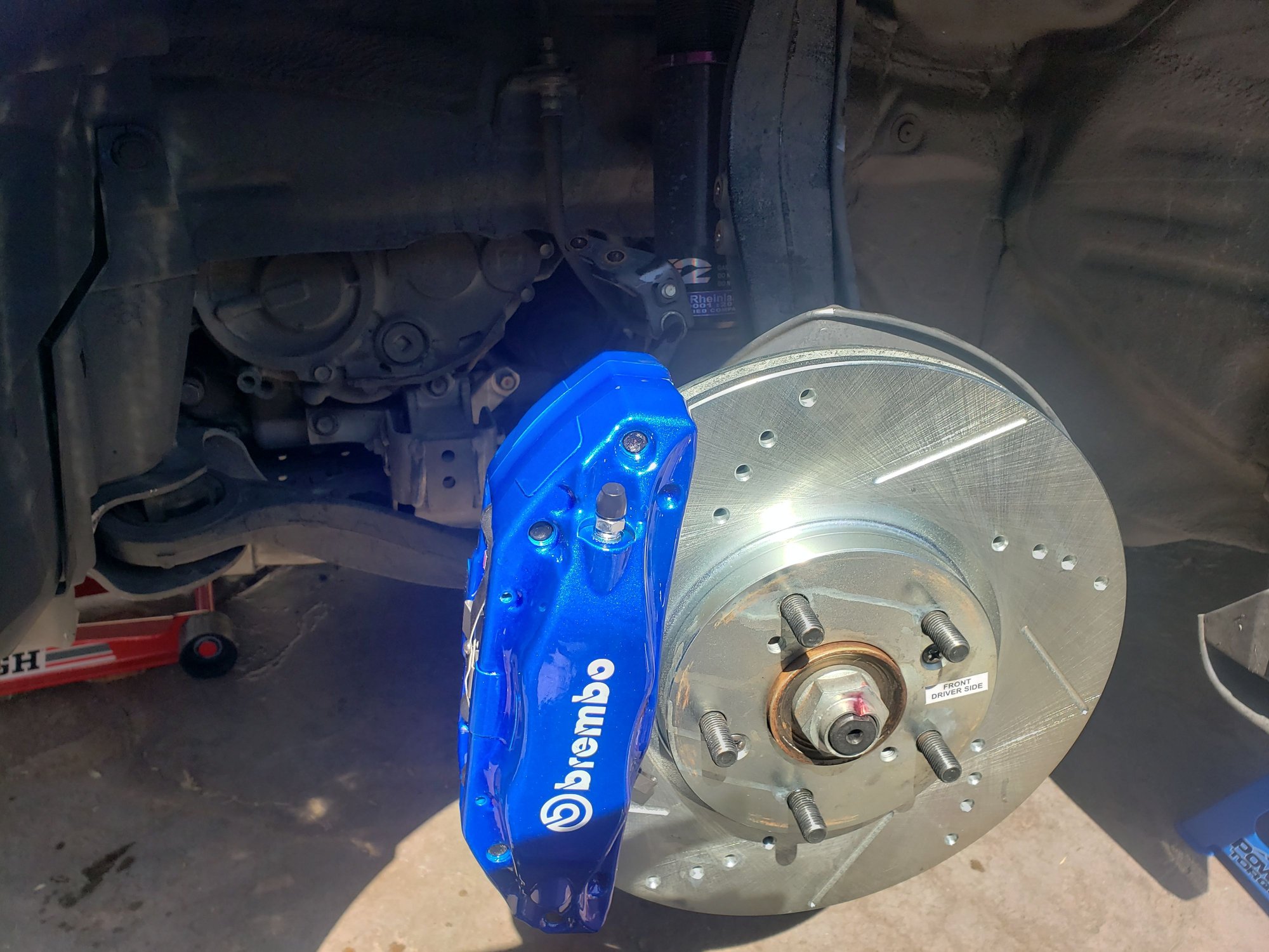

OP you can do what I did and go the Hyundai Genesis Brembo route. It bolts right up to the base knuckle. See the post I made.
https://acurazine.com/forums/3g-tl-p...%24800-985869/

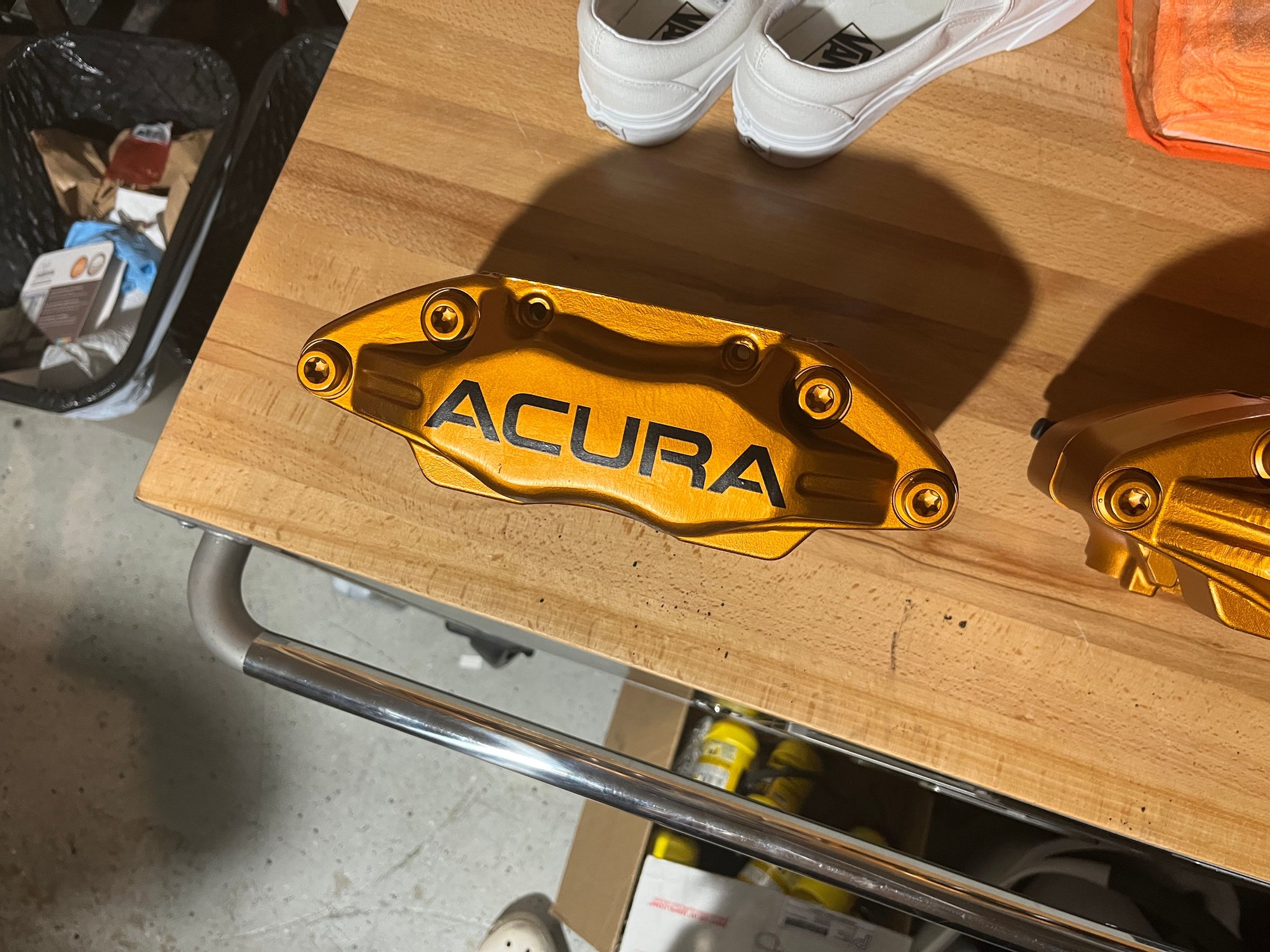

I went the Advic route...shaved down the Acura and replaced it with some high heat vinyl stickers. 12.8" 350z rotors and EBC redstuff pads. I've had no problems with the setup, and it's got pretty good stopping power. I wanted this setup more for the looks over the actual performance, although the added performance over the base calipers was a plus.
