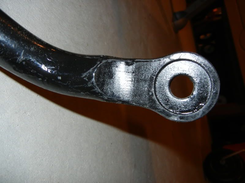

Update - Got some toys in!
H&R Sport Springs
Koni Sport
Braille Battery and a Battery Relocation Kit
Progress RSB
Type S FSB
IHC: You were asking if you can drill another hole in the FSB to make it adjustable...
