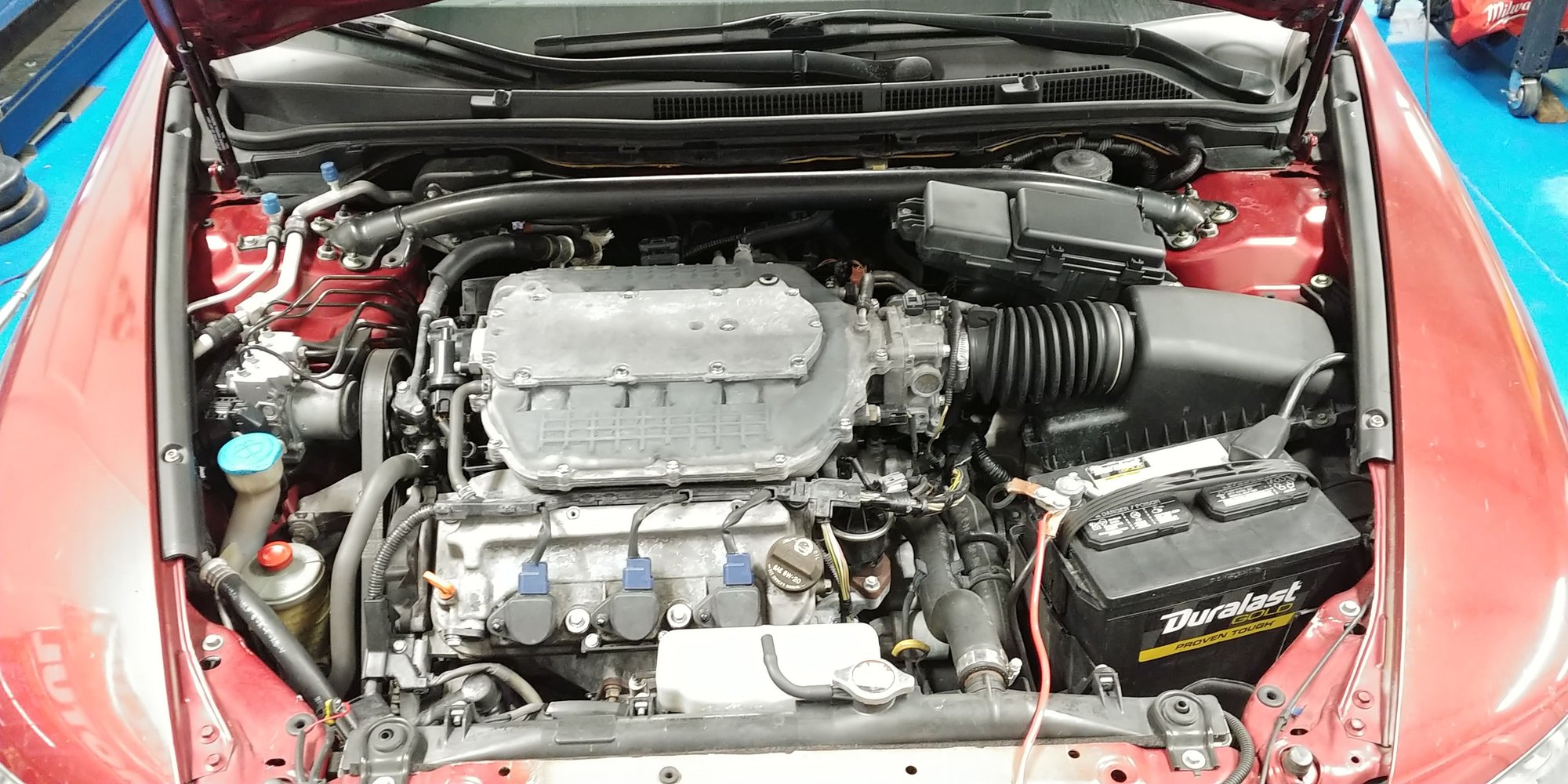

So I did my research and I've been wanting to get my hands on these "infamous" RL cams to swap into my motor. My car is a 100% bare bones stock 07 Base A/T. I put my car on the dyno at my job to keep track of my progress as I tinker with the car. My official bone stock numbers were 214whp @ 205ft lbs which is around what these cars make. Eventually my local junkyard finally got a 07 Acura RL SH-AWD (J35A8) in their lot; perfect opportunity to get these "alleged" best OEM cams for our cars and it only cost me $42 lol. I got em and installed em and the numbers after were averaging 228whp over 4 consecutive runs and peaked at 230whp @ 212ft lbs. I was kinda shocked especially without a tune. I was expecting around 6-8whp at the most. Best $42 spent lol. So things to note for those that are interested in doing this cam swap; The cams are a direct install nothing special is needed. The RL and base TL cam gears are the same i used my stock cam gears with these RL cams. Im also still using my stock valvetrain (Springs & valves). Also when you are going to do cams you have to check your valve lash and adjust if needed. I found that a few of the exhaust valves were on the really tight after swapping cams so you want to make sure you adjust them and not just drop em in and go. I measured both sets of cams in a very ghetto/ backyard way kinda way and noted the RL cams net a bit more lift than the stock J32A3 by using a smaller base circle. Anyway onto the pics.
My trusty dusty J32A3 Auto.
Official 100% Bone Stock numbers

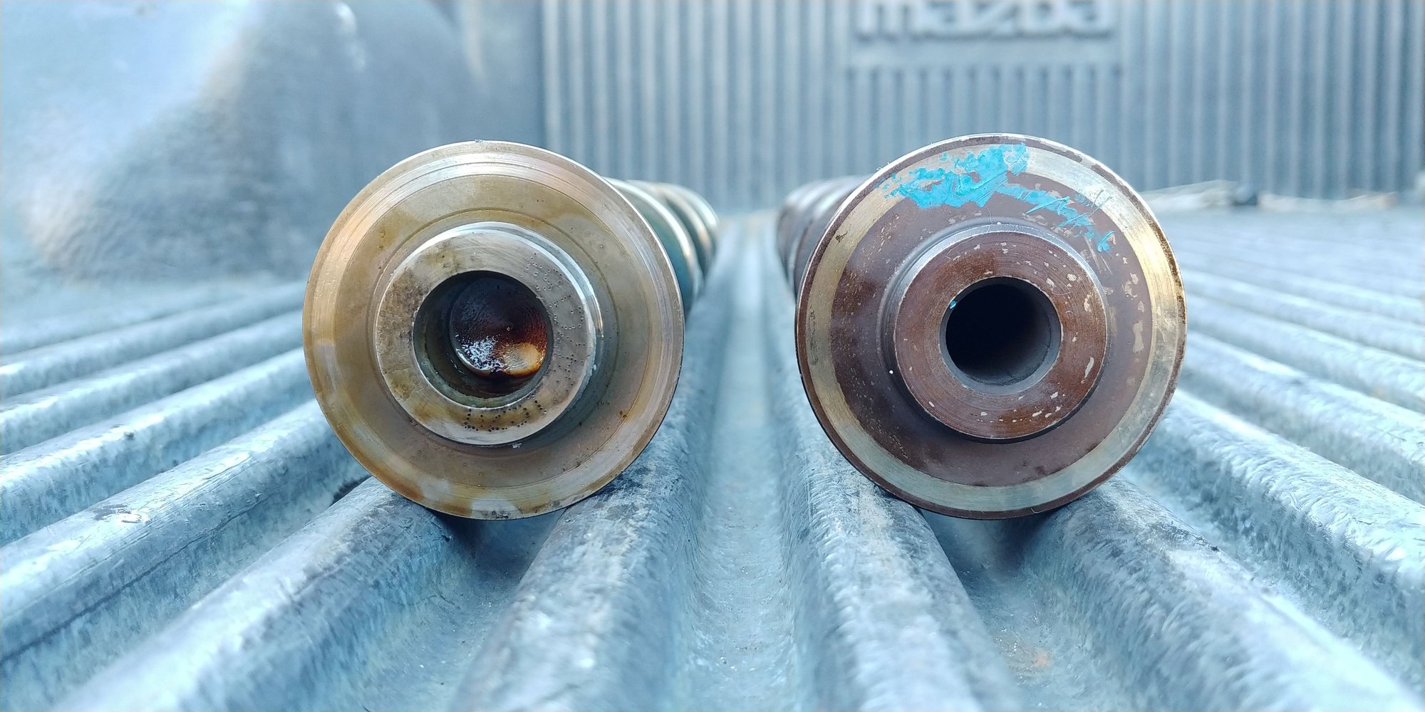

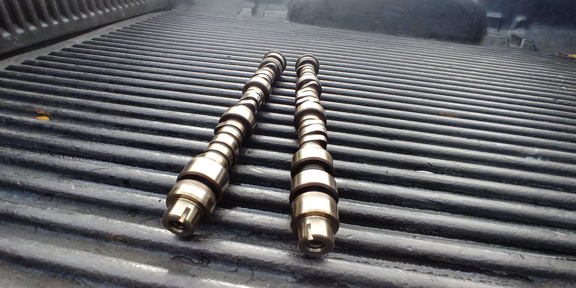

Checking to see how hollow these cams are.
.....definately hollow
Stock J32A3 Cam on the left RL J35A8 Cam on the right. Yea the base isnt hollow

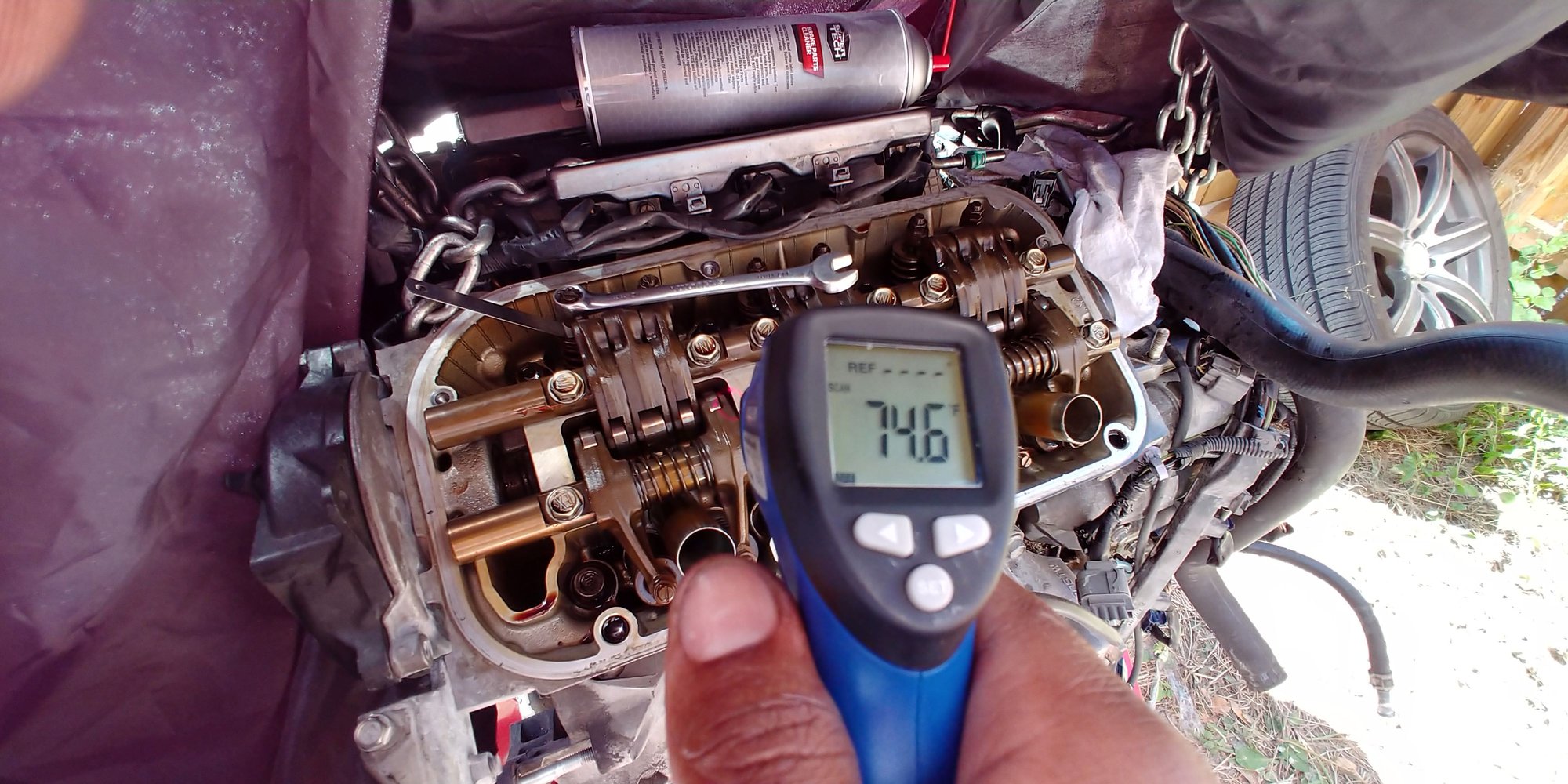

Always check your valve lash with the motor cold. I.E below 100 degrees Fahrenheit.

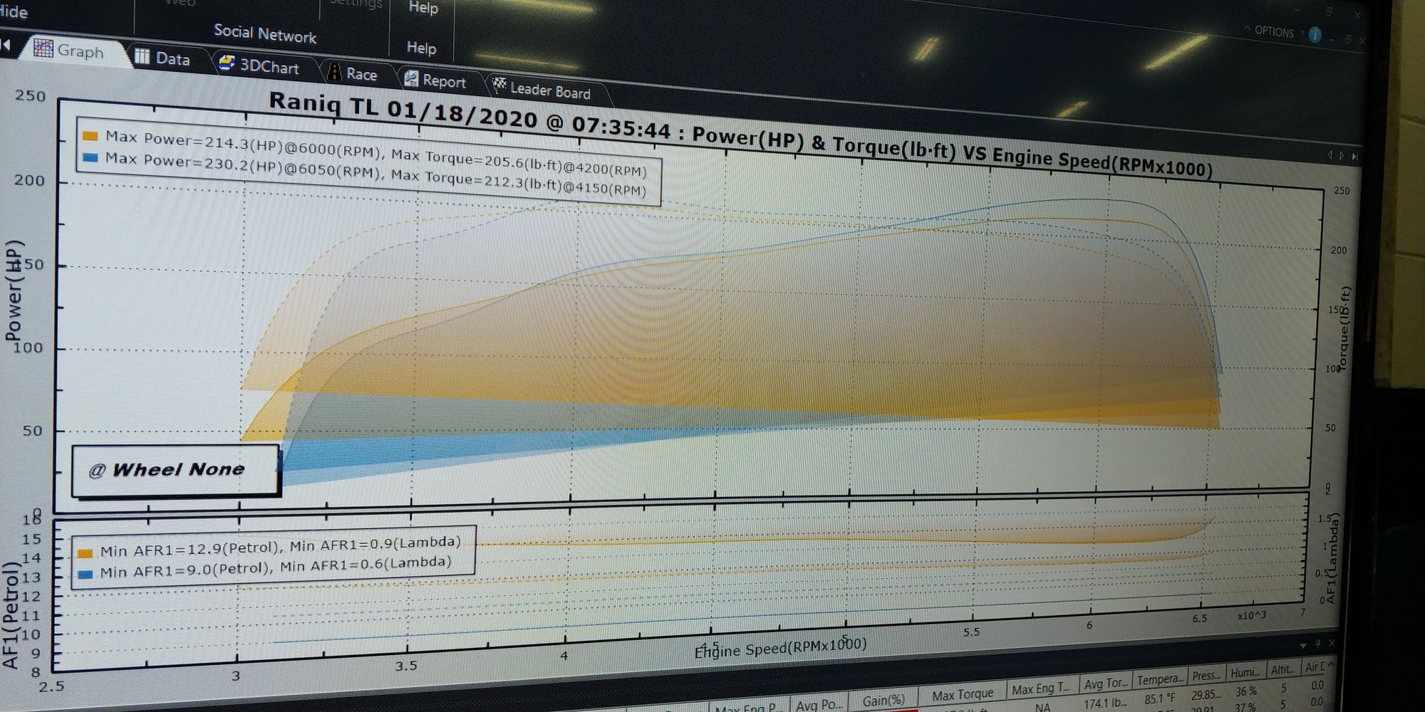

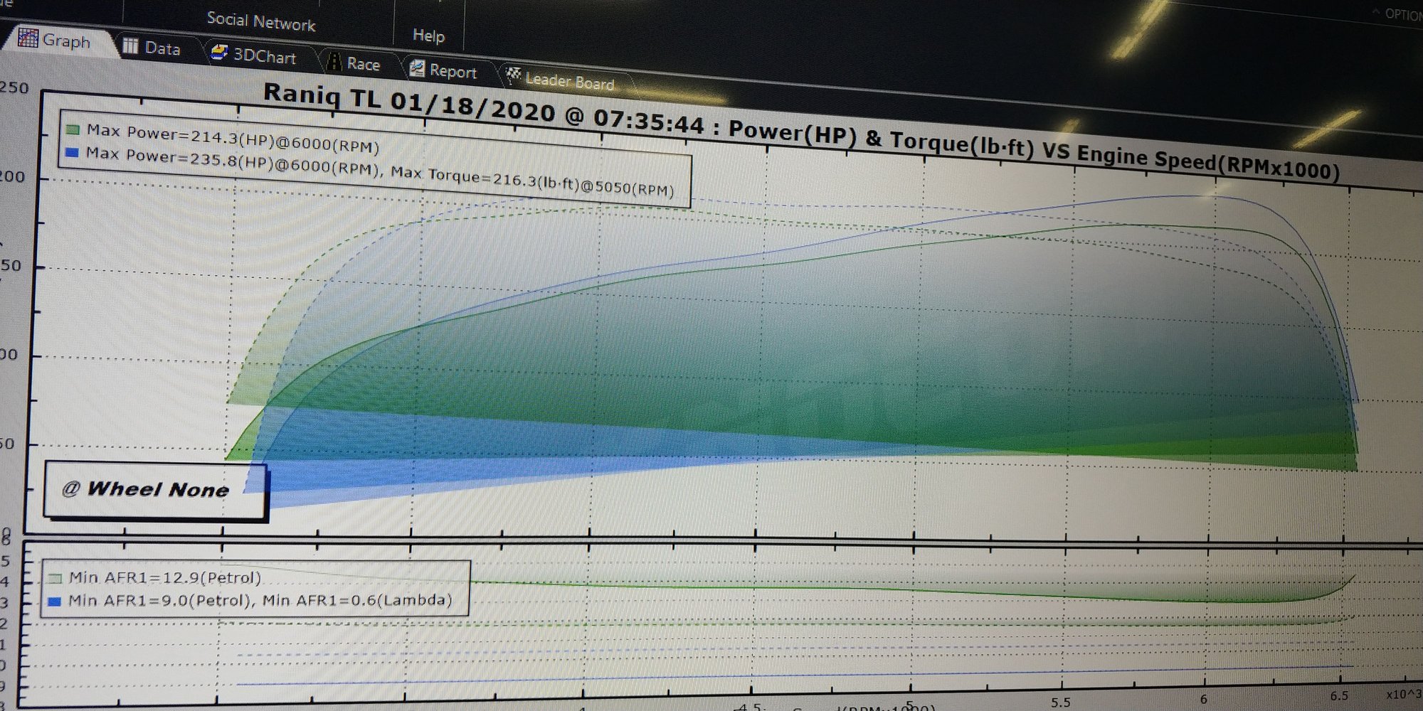

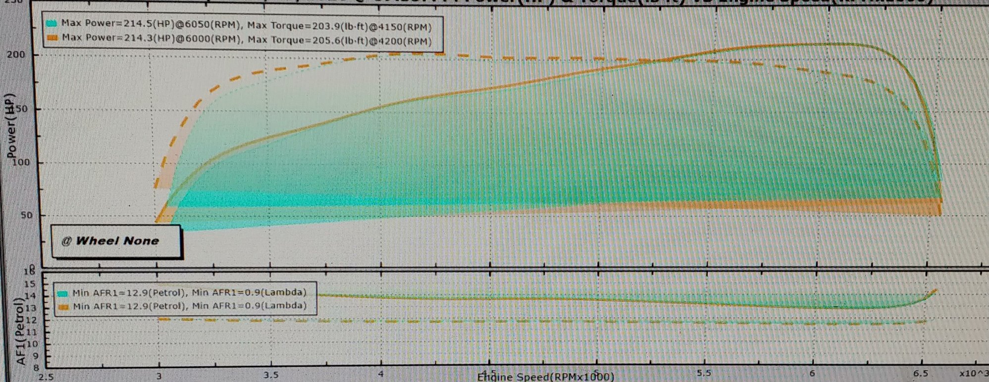

Before and after dyno. (Orange is before cams blue is after cams)
Verdict; if you can get your hands on these cams for a decent price go for it! It was well worth it for me

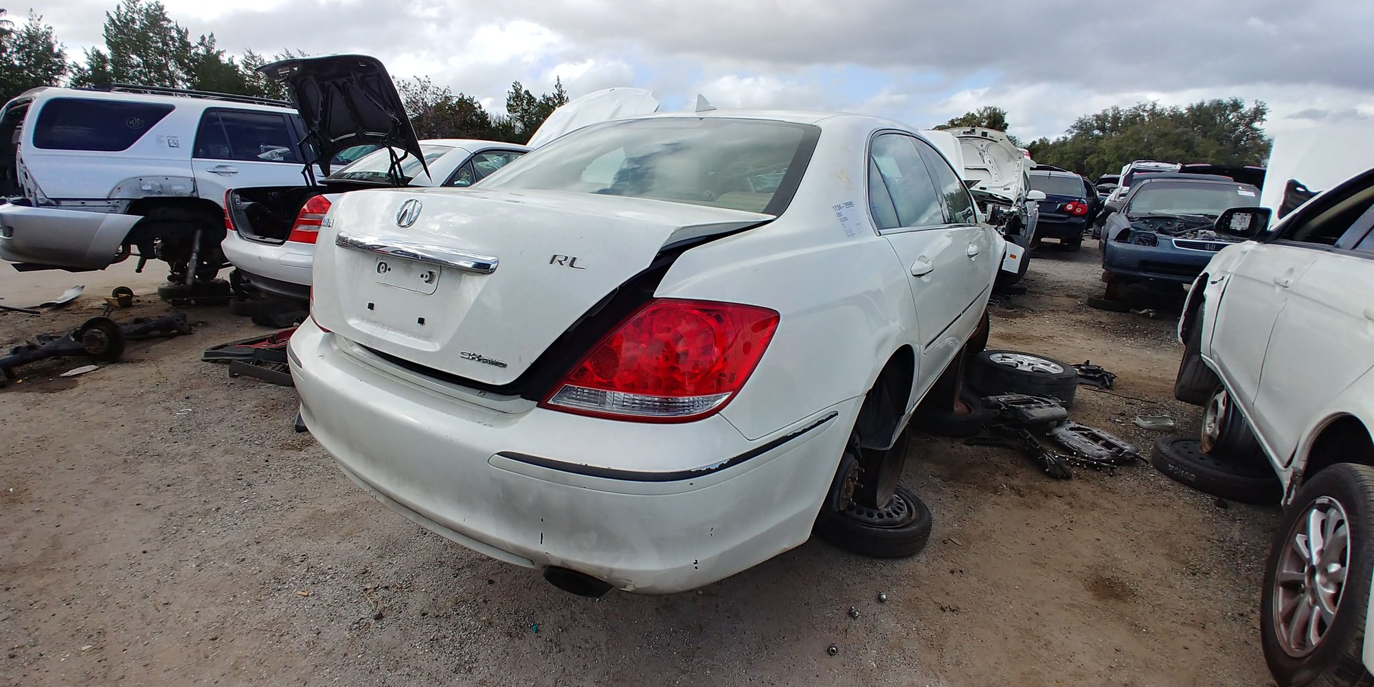

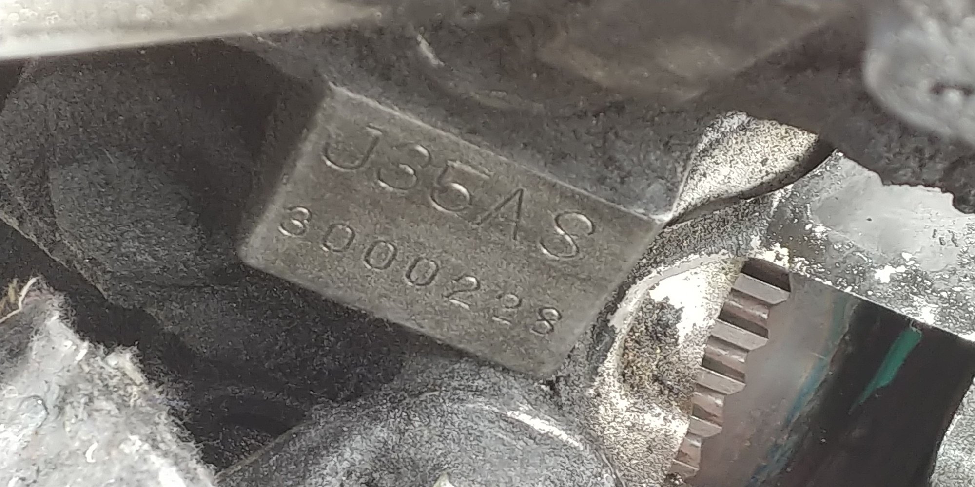

Quote: Eventually my local junkyard finally got a 07 Acura RL SH-AWD (J35A8) in their lot; perfect opportunity to get these "alleged" best OEM cams for our cars and it only cost me $42 lol.
Nice work with the cam 'experiment'!
I've found some great deals at salvage yards! A few months ago I found a donor CL-S and purchased the complete stock air box system from the air flow tube all the way to the resonator; two complete rear shock assemblies; front and rear factory sway bars, front strut tower bar; 5 fuel injectors and 3 coil packs for around $150.

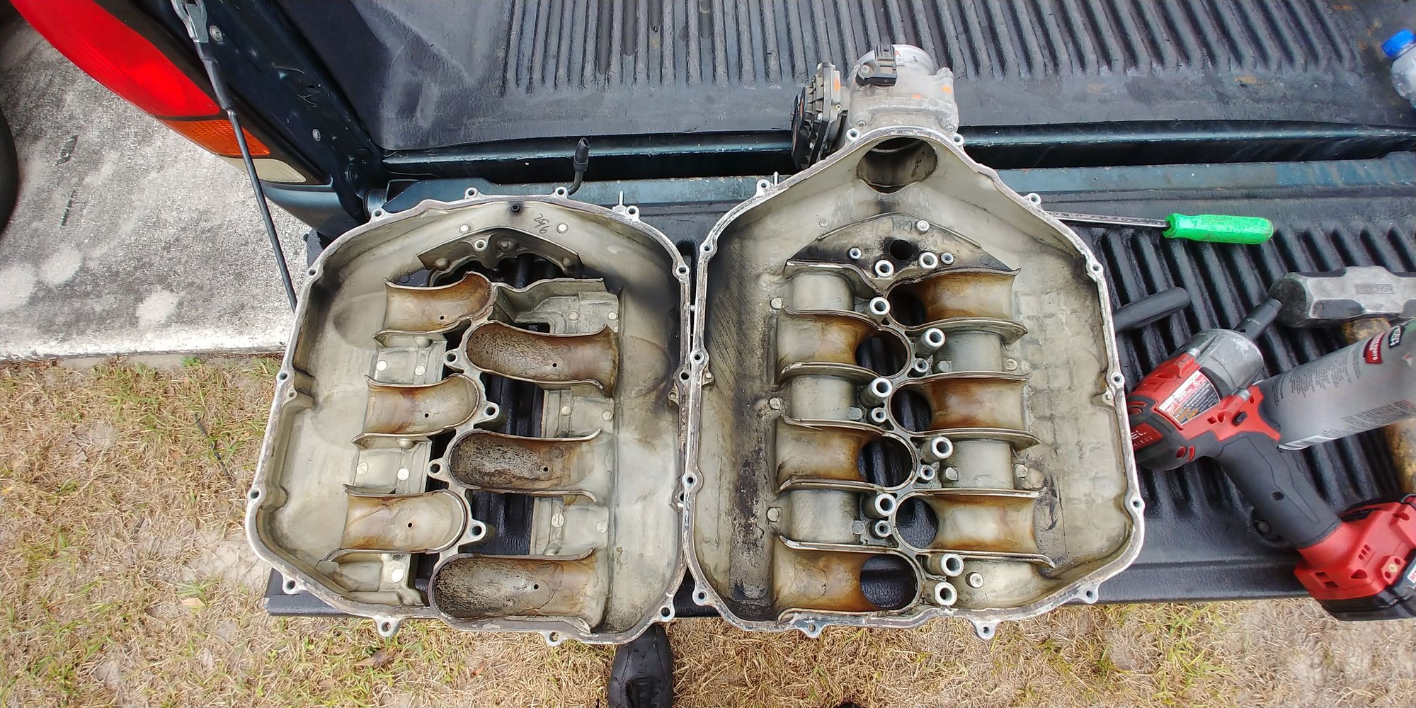

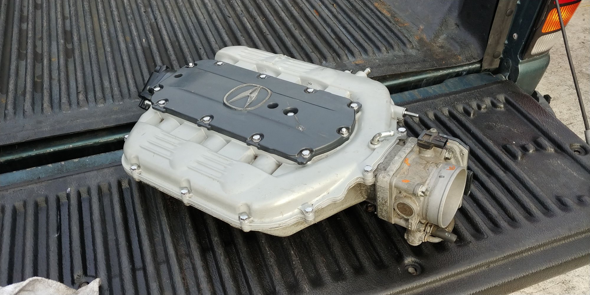

Nice find! I actually very recently got my hands on a 3.7L intake manifold from a 2013 TL at my junk yard and got that. I have that on and a temporary intake pipe now and there are definately more gains with that. Im gunna do a before and after with that manifold combined with the cams. Im gunna say i may be close to ~240whp now going off mph. I did videos to record my progress of me doing pulls in Antarctica from 24-25mph to about 100mph and compared the videos side by side. With only the cams the car revved up faster and i was about 1-2mph faster. Now with the manifold compared to totally stock im about 4-5mph faster so I cant wait to see what the power is now. By the way I got the Intake manifold, throttle body and top plate for $82 so that's another awesome score!

Quote: By the way I got the Intake manifold, throttle body and top plate for $82 so that's another awesome score!
That's a crazy good pick price for that IM package!
I can see from the picture above that that place is organized. Those are the types of 'pick n pulls' I like. Nice rows of acura's and honda's, all lifted up off the ground.
Quote:

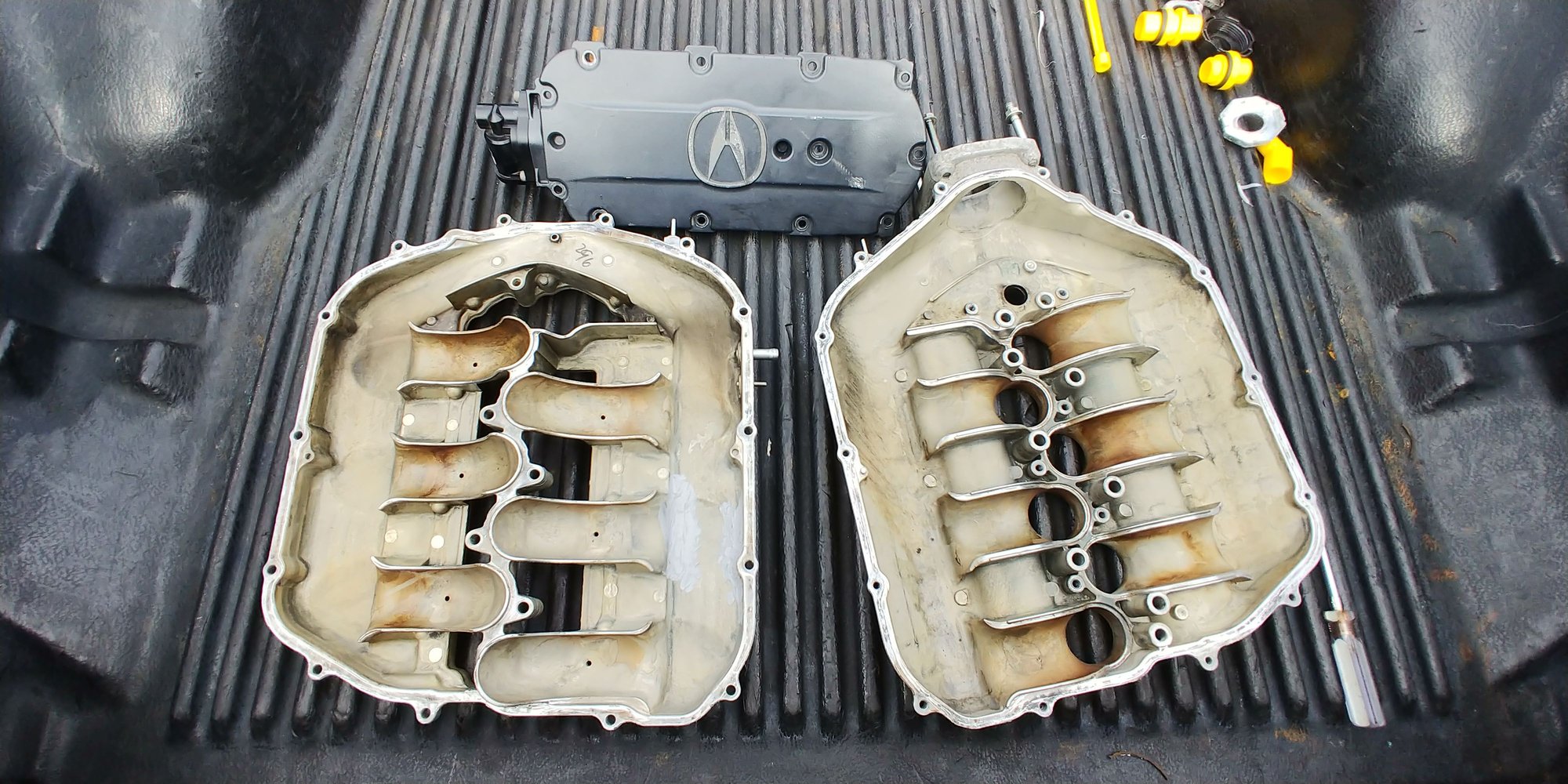

I stated to Saving4aTL yesterday, who is in the process of doing a port job on a similar IM, that I'd never seen the inside of one of those newer TL IM's. Now here you are a day later with the same IM split open, as well. Check out his Rotrex thread, maybe a port job is on the agenda for you to help get those NA HP dyno numbers higher on your TL.

Thanks Zeta,
Yes, the channels are smooth so just smoothing out the casting marks will help. The real gain is in the bottleneck we inlet.
I’ll post photos up Monday night.
Reply 1
Apr 10, 2020 | 06:38 PM
I opened my manifold up because it had a little crack in it that I needed to fix. So I did that and so far so good.

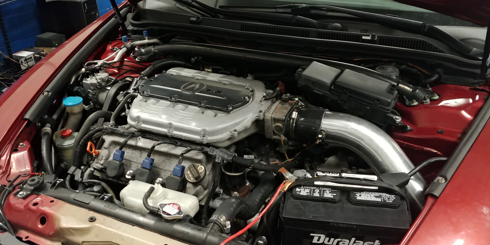

Update. So I know the main point of this thread is the cams but since I mentioned attaining the 3.7L manifold setup figured if just put the gains of that 2. I gained 5hp from the manifold with 3.5" intake piping. Granted i think it should be a little more given that today or at least right now as i unstrap the car off the dyno its showing 89% humidity versus the first to sessions when it was 59%. Id figure it would be more like 7-8hp gain if it werent so florida lol. Any who I gained 21hp for $124. Im happy with that
5hp gain
21hp gain from RL cams and 3.7L Intake manifold

Apr 14, 2020 | 08:20 AM
you starting to talking about dollar per WHP gain, I like where this is going tho, on the other hand congrats you are now surpass stock AT Type S performance. 250 WHP is where the stock Type S MT sit, next goal lol.

Quote: Update. So I know the main point of this thread is the cams but since I mentioned attaining the 3.7L manifold setup figured if just put the gains of that 2. I gained 5hp from the manifold with 3.5" intake piping. Granted i think it should be a little more given that today or at least right now as i unstrap the car off the dyno its showing 89% humidity versus the first to sessions when it was 59%. Id figure it would be more like 7-8hp gain if it werent so florida lol. Any who I gained 21hp for $124.
10% power gain to the wheels for the price of one month of cable and internet? Unheard of and awesome!
Even better, it's not just a gain at peak. Look at that area under the curve.
Reply 2

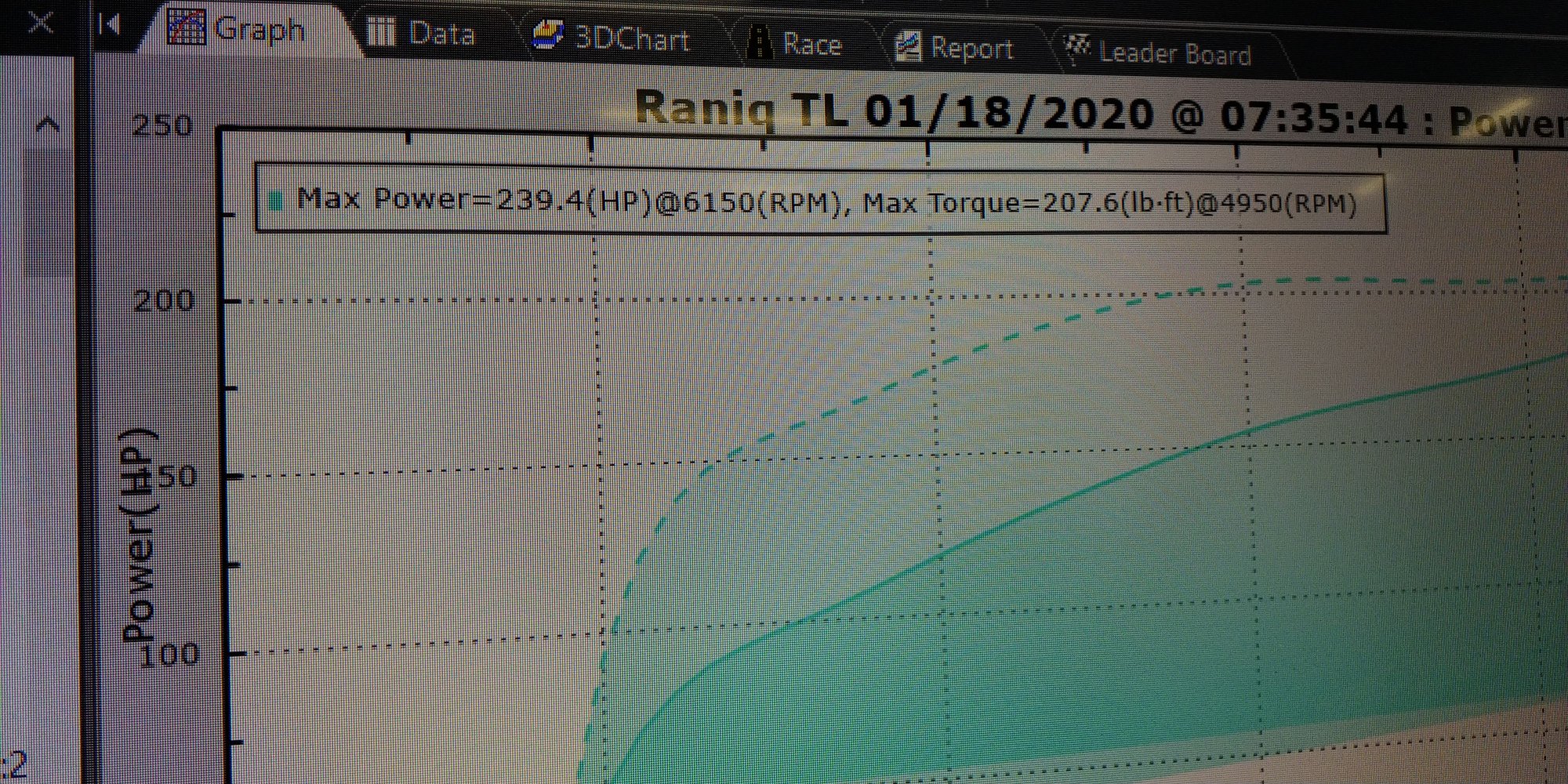

Apr 16, 2020 | 09:14 AM
So I went on again just to see the absolute most I can get out of it. The humidity was still around 79% but it was a little cooler. Ended up peaking 239whp @ 207ft lbs. Dont ask me what happened to the 11ft lbs on that run all the others were from 236-238whp @ 213-216ft lbs. I hung up the towel and gave my wife back her car lol. Im done for now. So until i get another sweet deal on mods ✌
