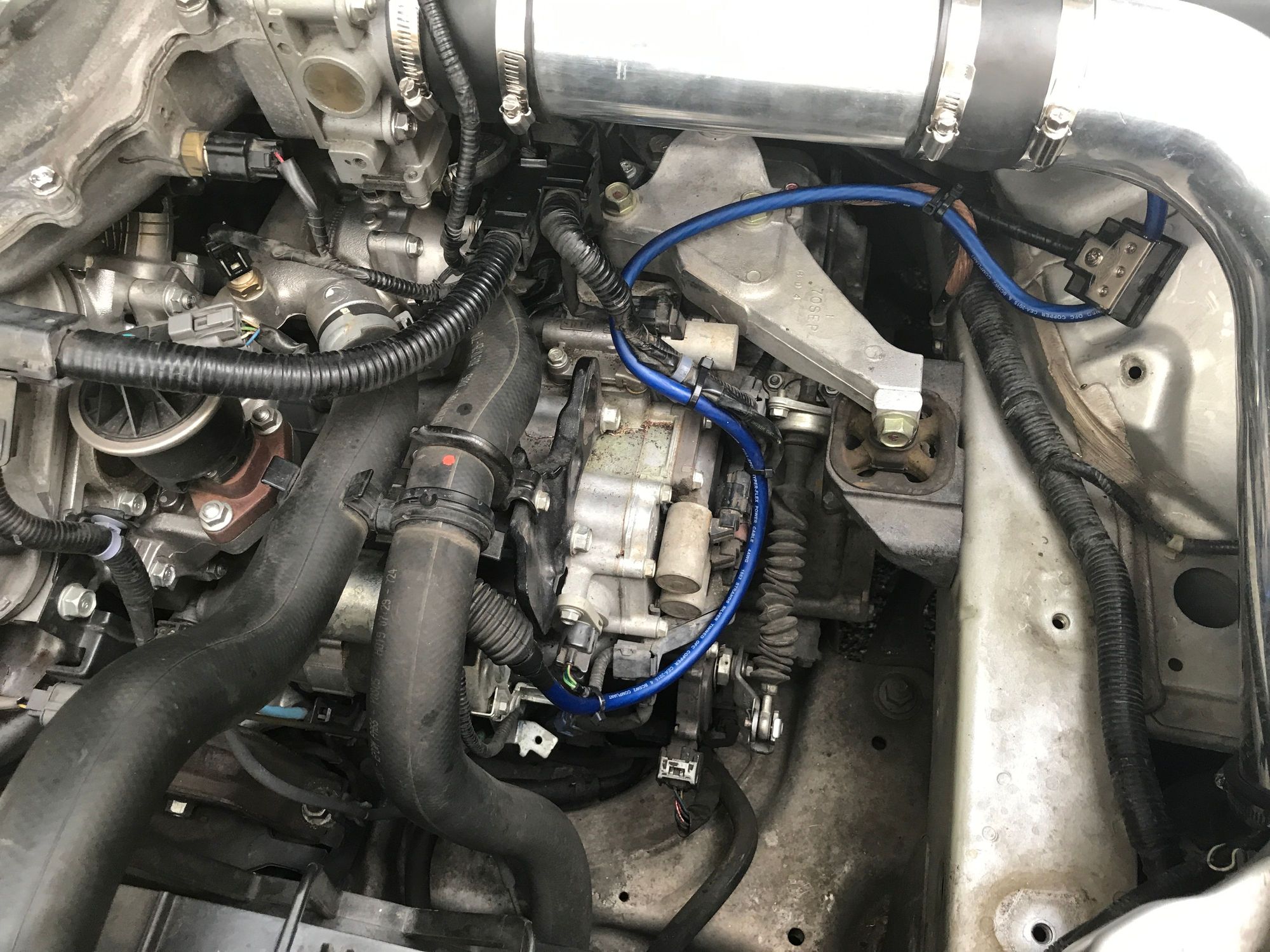

Installed used OEM ASM type S rear bumper for the quad ATLP.
Throttle body coolant bypass: looped the line. Used another hose to loop the inlet/outlet coolant line to the TB. Used third hose to loop the metal tube connected to the vacuum tube going to the intake.
No extra parts needed to achieve. Only Neednose pliers for clamps. Did this to lower intake temps after s/C install.

I often wondered if this was a placebo mod...
I had it done on my both my TL's...
Old 01-15-2018, 03:49 PM
It may be, but if it gets my intake temps a couple degrees cooler after boostering then I'm happy for it.

Definitely...
in FL summer heatsoak was legit on the TL.
I did the cooling mod thing too and it helped.

I tried to make it as clean of an install as possible.
It took me 14 hours!!
Making way for the Supercharger.
