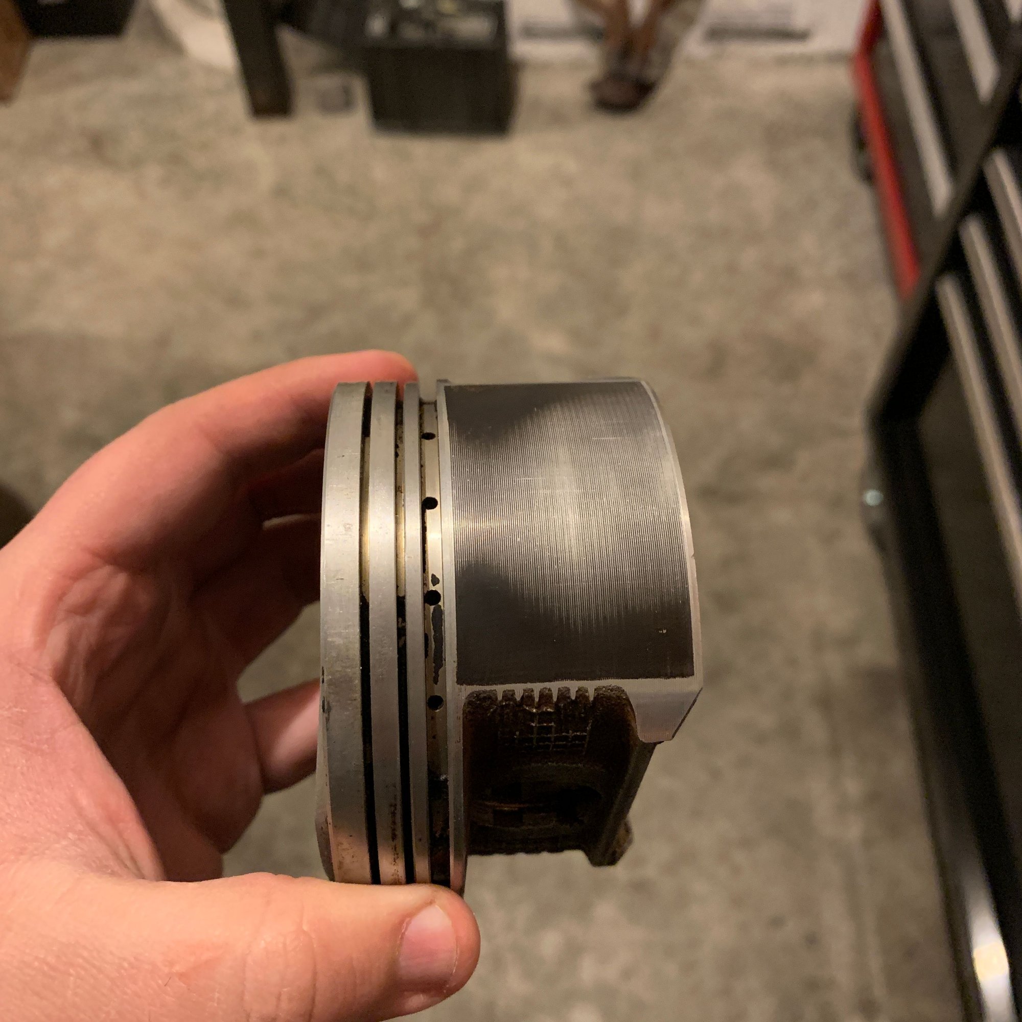

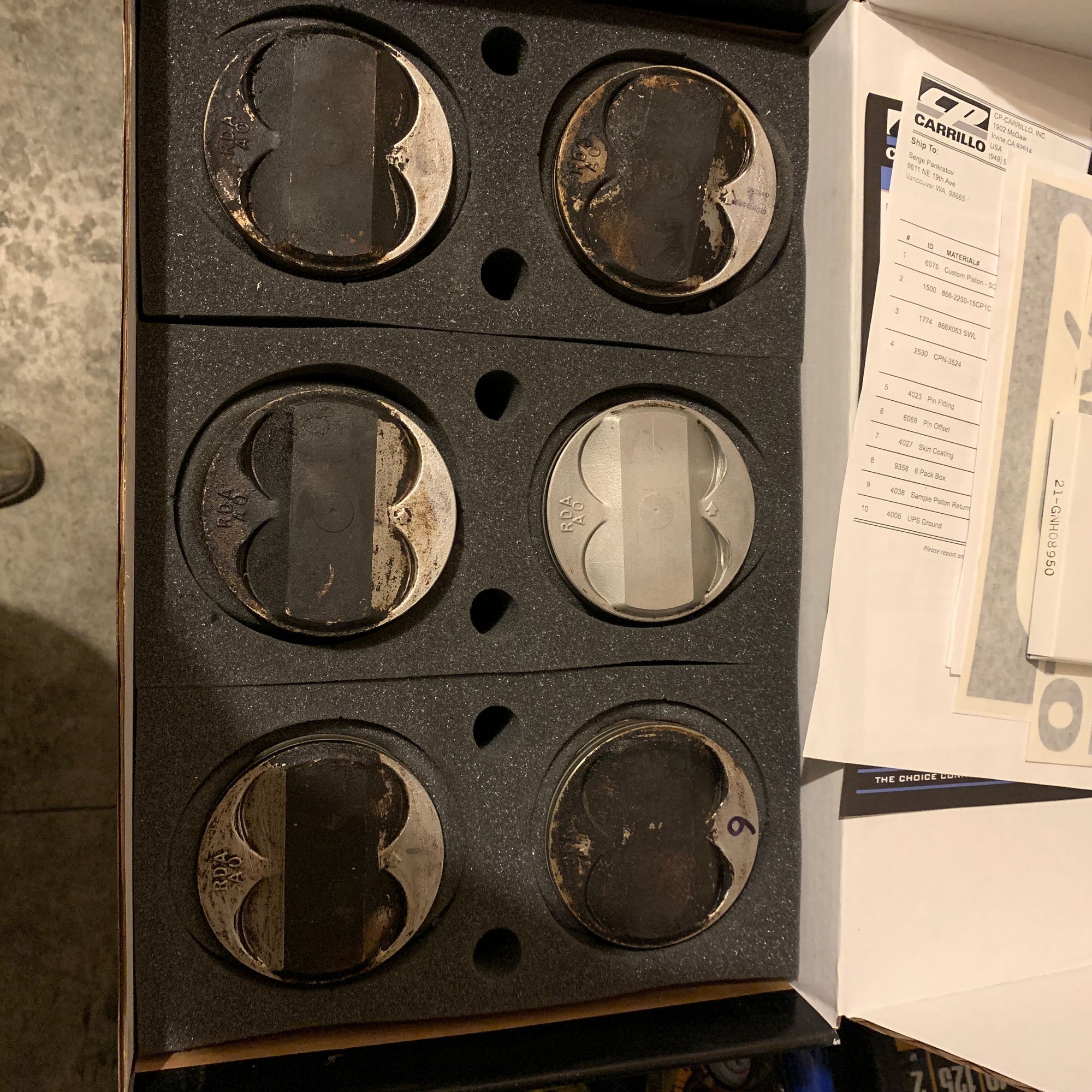

I just remembered that I saved all the original pistons.
guess which one is #4 😄
I forgot to include the fact that cyl #4 AND #5 were bad. But 4 was “a bit” worse.

All the pictures of the piston skirts are taken from the exhaust side and it seems that cylinders 1-3 all show “normal” wear and cylinders 4-6 are all excessively worn.
