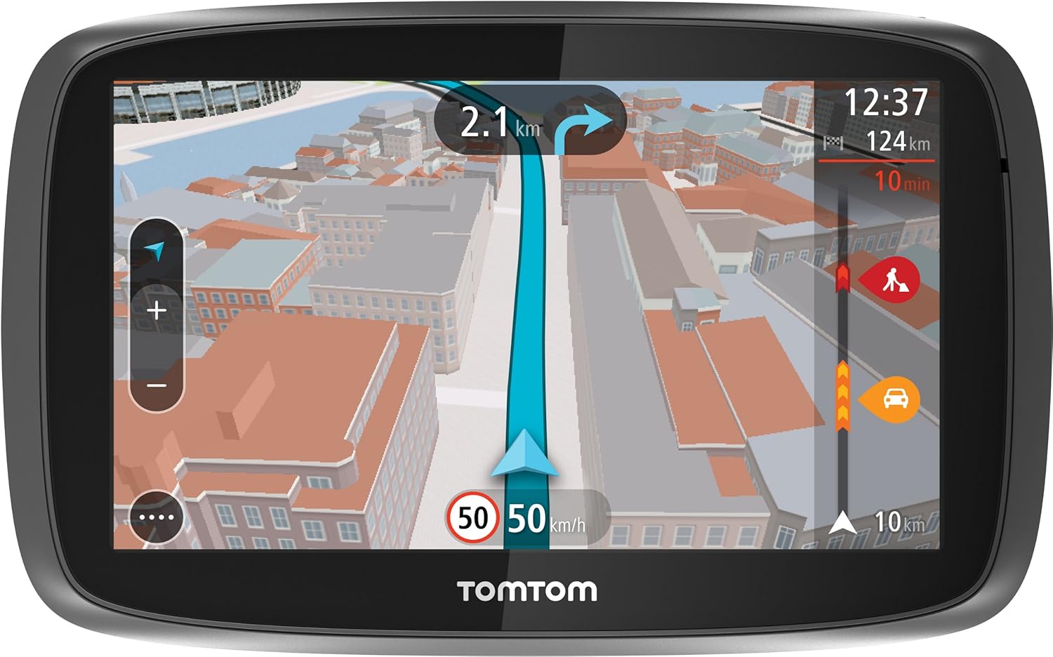

I'm looking at the TomTom GO 500
My friend has the GO 50 C, and I'm blown away by it.
The graphics and UI is very eye candy!
Very well designed.
I know Garmins are very reliable and work amazing, I was never a fan of the UI looks, though
If only our integrated navigation was the same.
Very well designed.
Those graphics are awesome. I looked on Amazon and the top rated Navi's were made by Garmin, but I haven't heard anything negative about Tom Tom. More research is in order.
