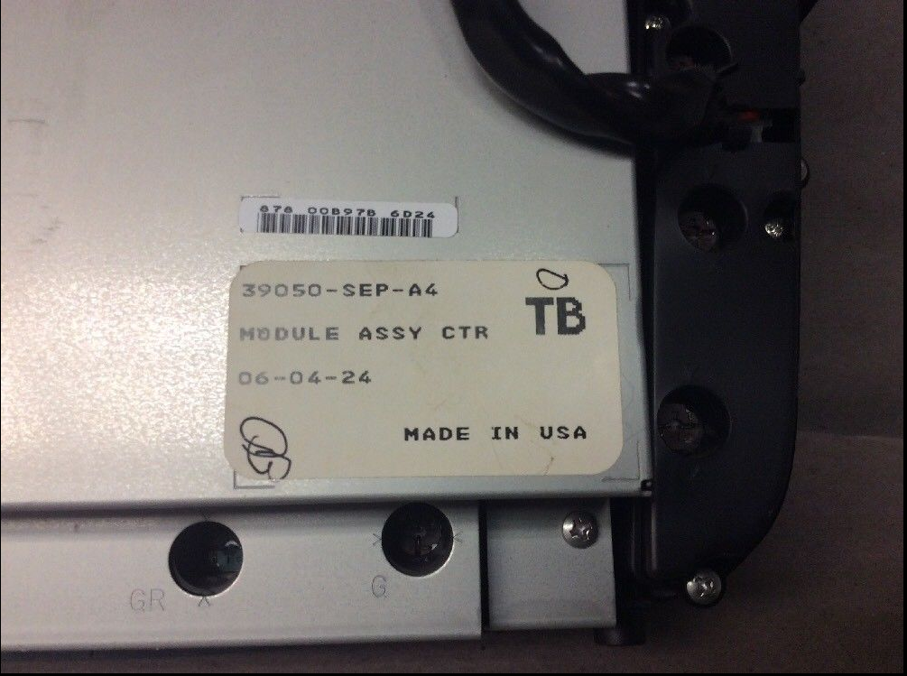

I got the unit from ebay the price seems to be all over the place but i got it for 100 shipped. I attached a picture for part number reference. as for removing the dash between the instructions here and you tube it was pretty easy just get plastic tool for interior so you don't scratch up what you have. if you start from inside the console and remove those 2 screws and pop off the plastic you can see all the screws and everything just kind of pushes towards the back seat
I had 2 things that were a little screwy someone had taken mine apart before and mixed the screws up so i wasn't sure which went where I should have taken a picture of the screws so i knew for sure which screw went into which hole I had some silver and some black but they were definitely mixed up from before.
the other thing was the screws holding the radio in on the bottom i dropped one and well im still not sure where it is. if i had taken more plastic off beside the glove box i wouldn't have dropped it or maybe taken some precautions to not let it fall to begin with honestly it was much easier than i expected.
Make sure you get the correct one since all the gen 3 TL's have different navigation systems. Mine is 2006 TL i know they changed in 08 but im not sure about 07 or before the 2006 model TL
hope that helps
