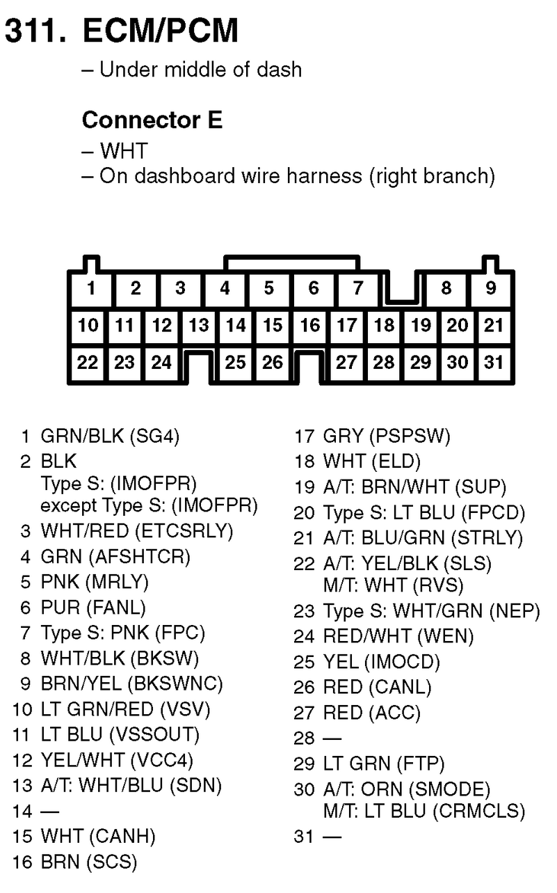

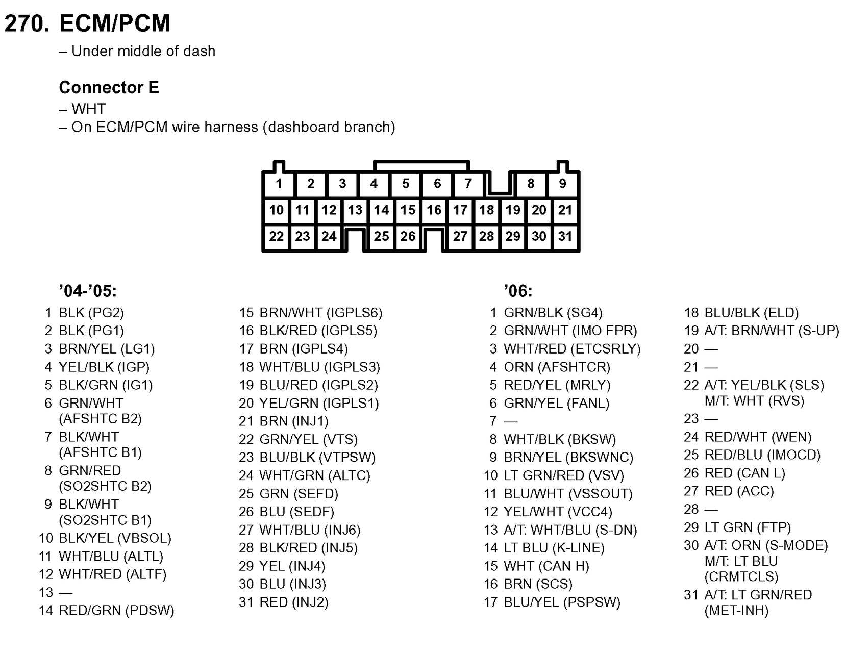

So to start I have a 2006 TL AT with navi and tpms. Here soon I'll be replacing the ECU with an 08 TL AT ECU. I can't find an ECU harness for the automatic transmission.
does anybody have the pinout for both of them, or possibly be able to tell me which pins need moved and where?

Get yourself service manuals.
This should be 2004-2006: https://acurazine.com/forums/third-g.../#post15344256
This is for 2007-2008: https://acurazine.com/forums/3g-tl-p.../#post16101585
ECM Connectors for 2007-2008 TL:
Spoiler
ECM Connectors for 2004-2006:
Spoiler
