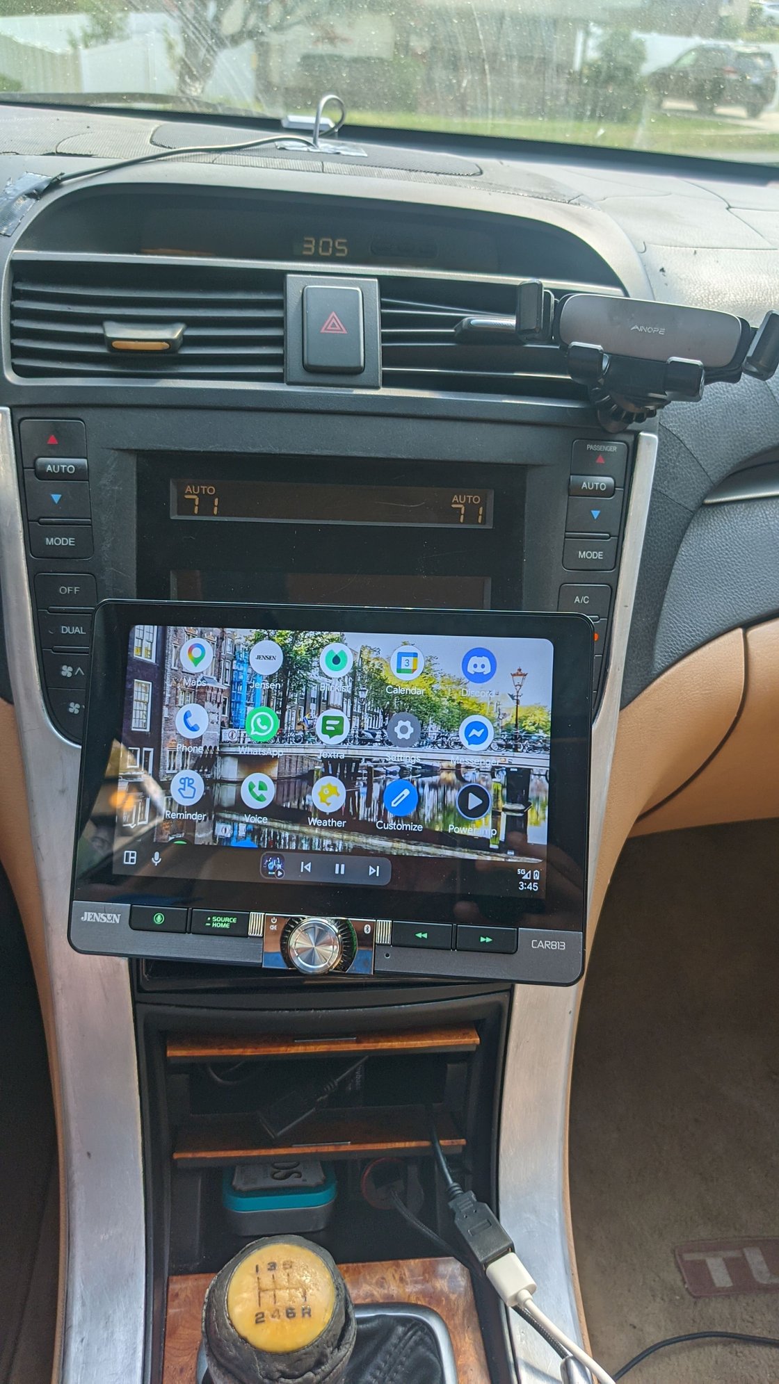

In case anyone cares, here's an update.
I decided to use MobileMaxxAudio (not a sponsor) kits to make things easier. I bought their plug n play 5 channel amp and subwoofer upgrade package. I replaced all speakers with Kickers and got one of the floating touchscreen head units from Crutchfield (Jensen CAR813). I was never looking for the most explosive system or anything, I just wanted significantly better audio and a touchscreen for Android Auto that wasn't placed so damn low.
I'm happy with my results. The bass kicks and it gets plenty loud. I feel the screen could be slightly higher but it's definitely a huge improvement from stock. The install took a lot of planning (mostly figuring out where to splice and dice to radio harnesses). If you're interested in the nitty gritty details of this install for yourself, let me know.
