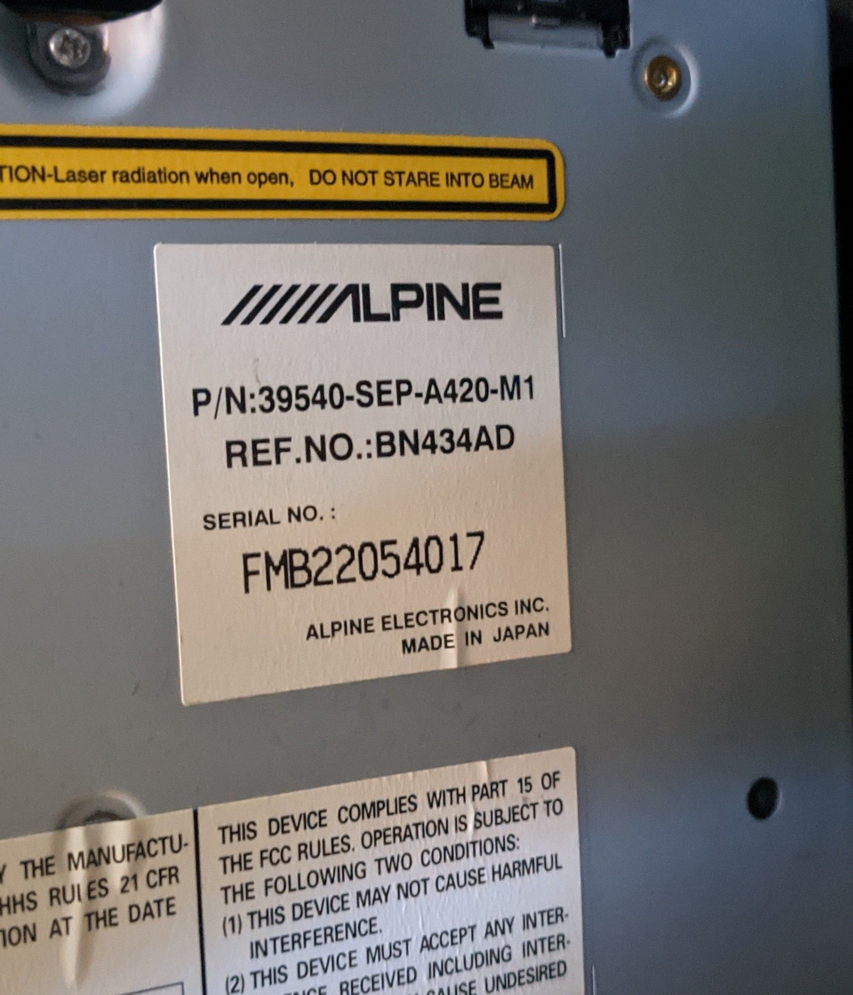

Yeah, but there is something suspect there.. Was the DVD replaced in the past with an 06 one perhaps? From factory, it should have been a white disc. Previous owner did something funky.
2006 TL DVD drive: 39540-SEP-406
2007-2008 DVD Drive: 39546-SEP-A51
Can you take your DVD drive out and confirm the part number?
Old Jan 29, 2021 | 03:02 PM
BoringNBP's Avatar
Joined: Feb 2017
Posts: 30
It is
P/N:39540-SEP-A420-M1
Old Jan 29, 2021 | 05:16 PM
Posts: 48,311
https://www.oemacuraparts.com/oem-pa...QtYXV0b21hdGlj
Yeah that's an 05-06 Drive, explains why it has an orange disc then.. Just to make sure we're not overlooking the obvious but you're sure this is an 2007 and not a 2006 TL?
Old Jan 29, 2021 | 05:18 PM
BoringNBP's Avatar
Joined: Feb 2017
Posts: 30
Annnnndddd...that's why I'm an idiot. It's a 2006 TL.
