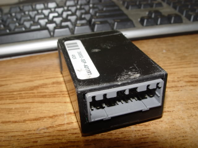

I think you should start from scratch all over again if you really want it to work. First of all, you need to disconnect the cable in the battery and after connect the black one. Wait 15 minutes then you reconnect the terminal back to the way it was before. Then you get inside the car and set the brightness to your likings and turn the headlights on. Set your brightness for your night time driving to your likings as well as your seating. After, you press memory and see if you see two lights flashing on the memory 1 and memory 2. If it's flashing, press memory 1. Check your brightness that you set before. Then you start the engine, shut off the engine and see if the memory of your brightness was set or not. If you don't, then your memory unit is deflected. (the memory unit is locate under steering wheel). See pic's...Name:  MemoryUnit.jpg
