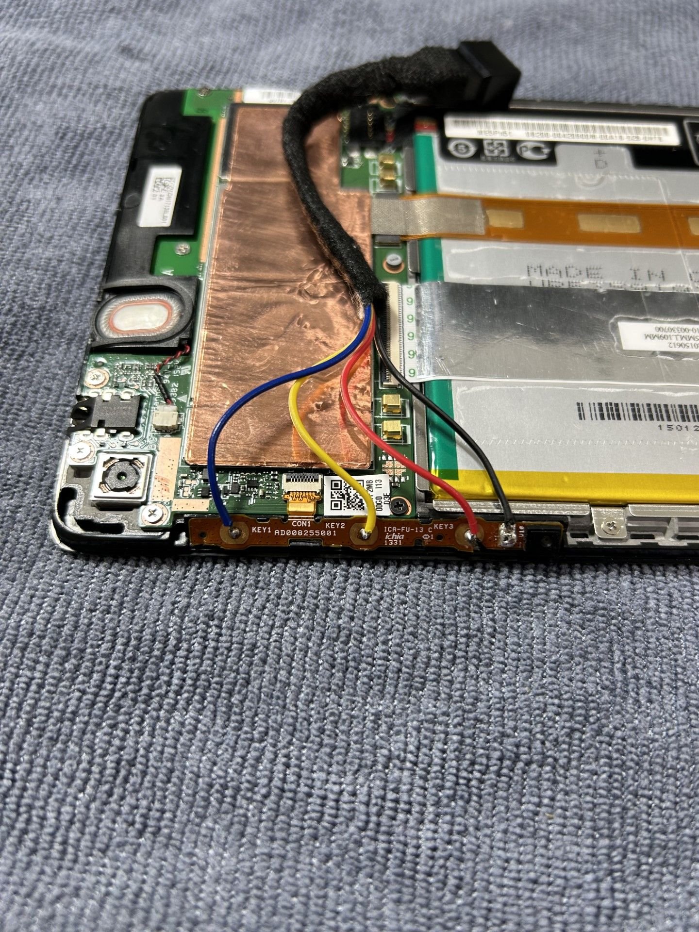

II. Backstory: Nexus 7 Journey
To start, you must know that I spent years (you read that right, I said years), experimenting with my Nexus 7 retrofit. Despite countless tablet configurations, each method that I endeavored failed to meet my expectations. I could write a novel detailing all of my frustrations, but essentially the final straw that broke the camel’s back was a lack of reliability. Each of the micro solder connections that I needed to function properly continued to break throughout everyday use. This ultimately led to my decision to scrap the project completely. Below are a few pictures that outline my final setup before throwing all of these parts into a storage box.

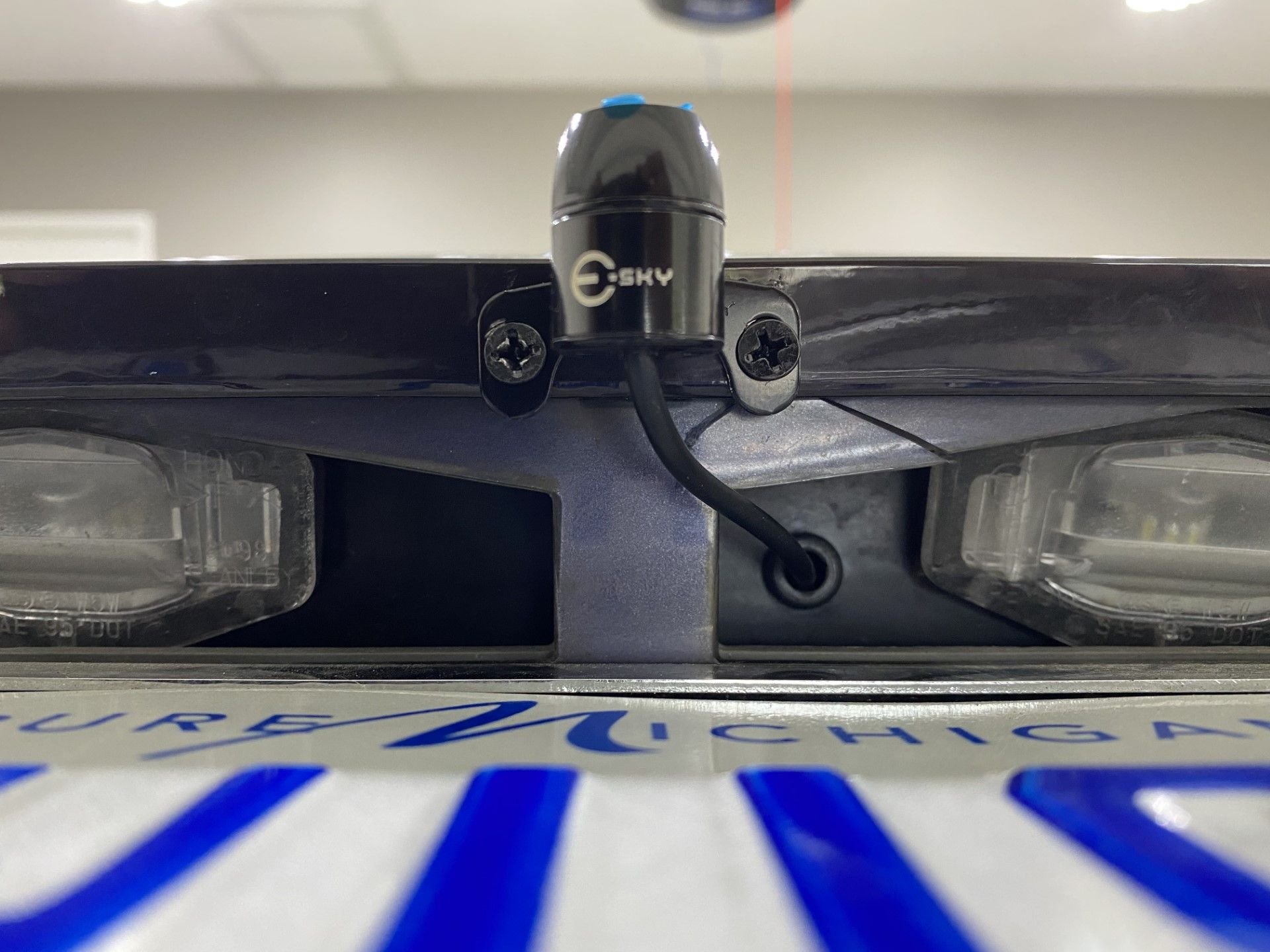

2. AV In (2.5mm)
AV in is simply just a 2.5mm jack that allows the unit to receive a composite RCA signal from a backup camera. Most units have this feature.

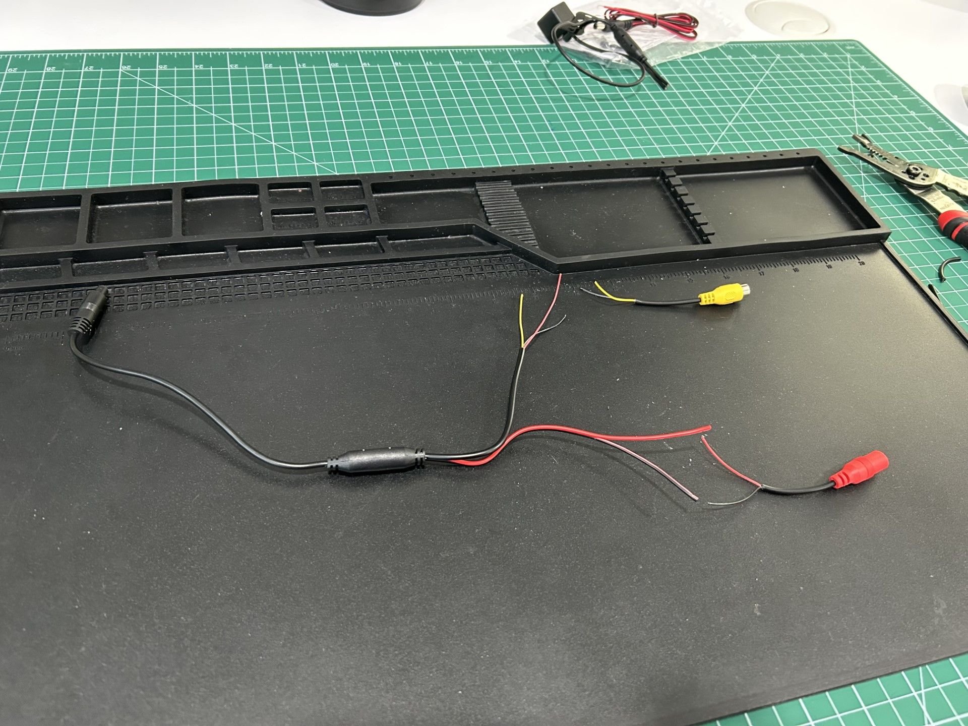

Carpuride: They offer the ability to purchase the unit with or without a backup camera. The non-backup camera units still have this input feature. The only difference is that buyers simply won’t receive the necessary cords nor Capuride’s own backup camera. However, one can still be installed and used without any issues.

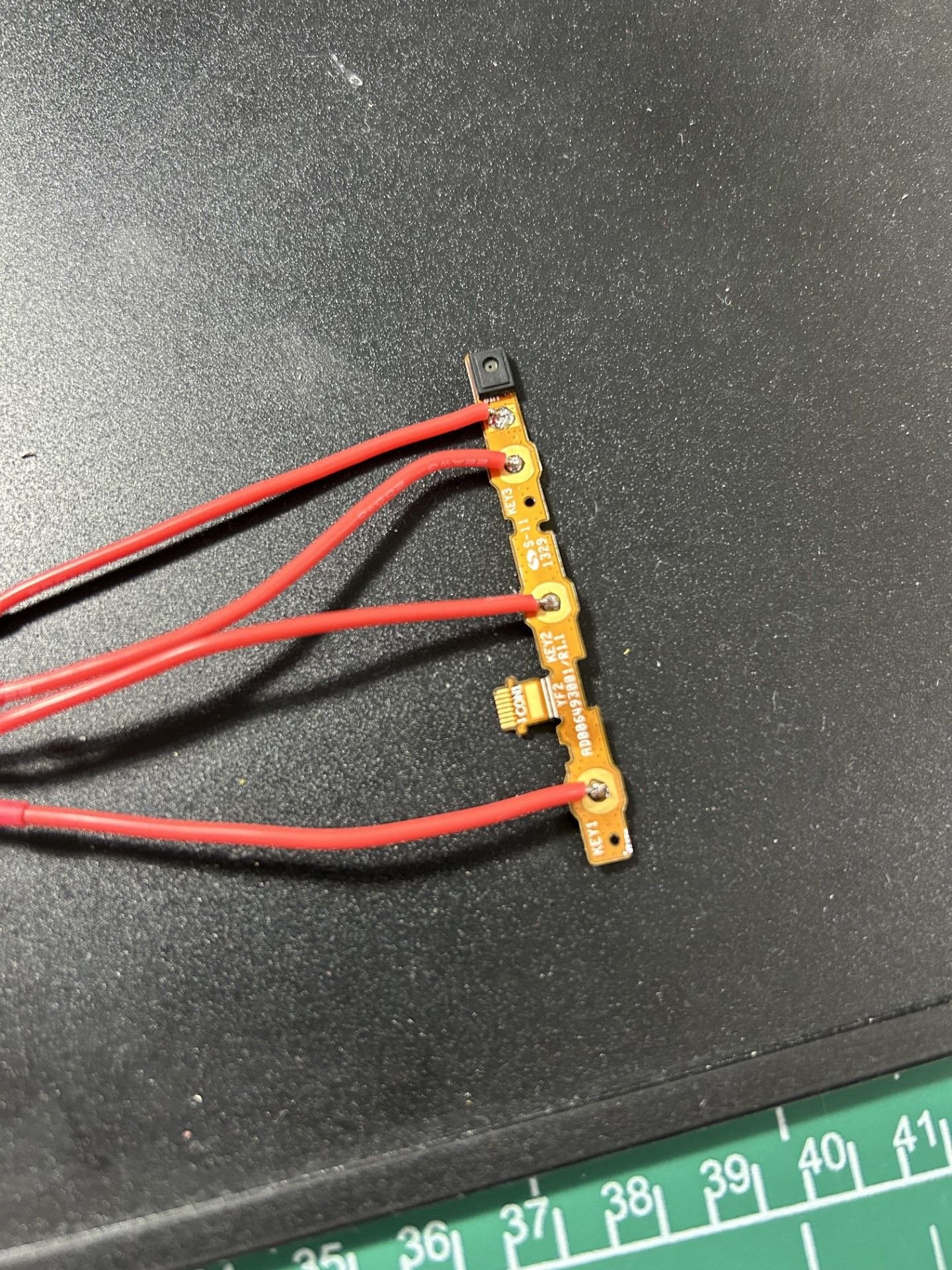

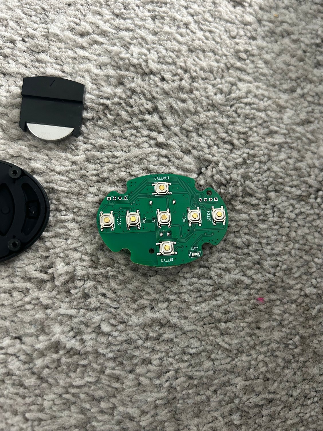

5. Steering Wheel Controller (SWC)

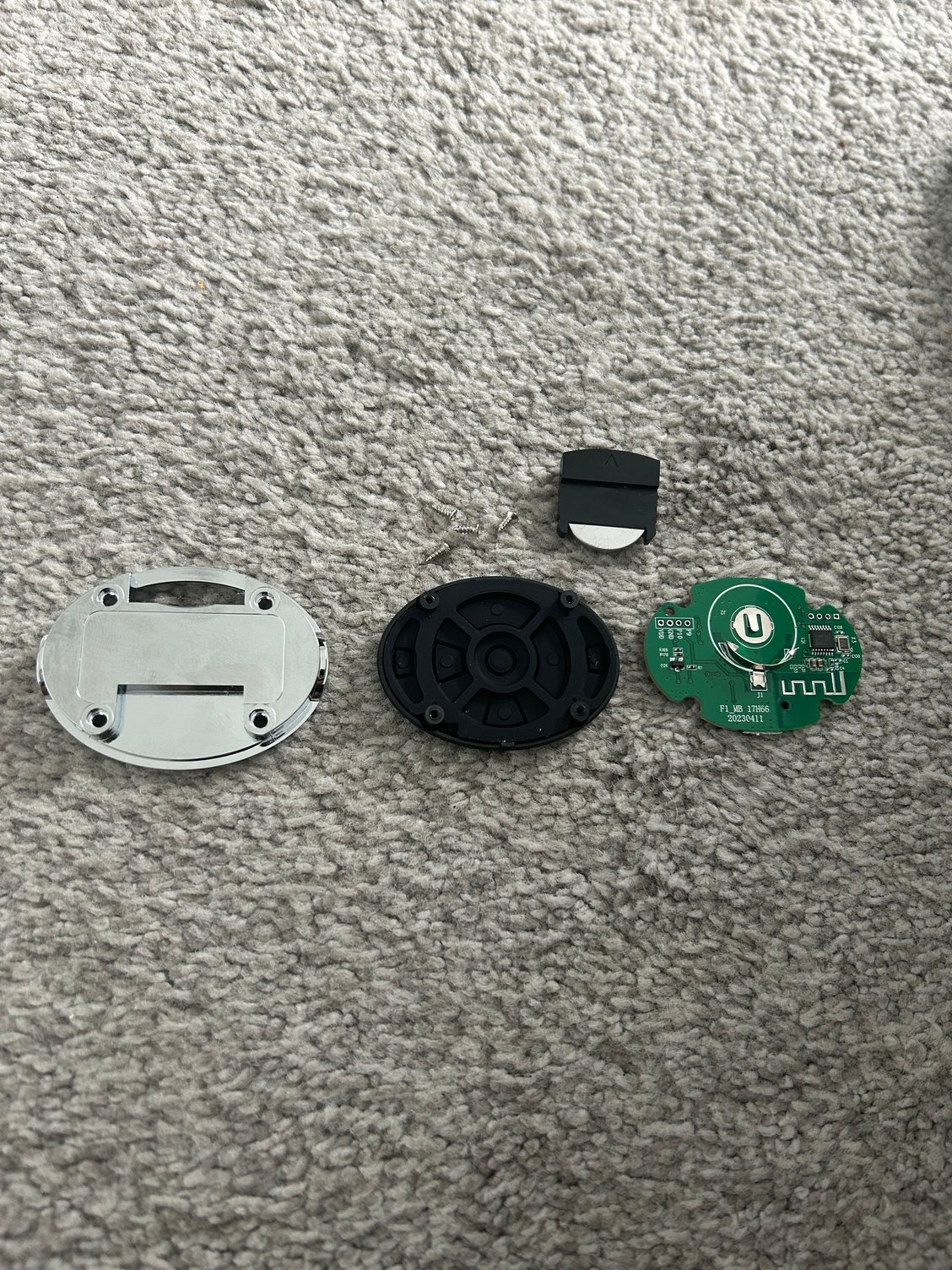

Because these units are not meant to replace a factory radios, OEM steering wheel controls will not work unless the dual-Bluetooth feature is used to pair the device (more on that later). At the time of this post, only one brand offers an external steering wheel controller. Any guess who that is? Yeah, it’s Carpuride.
Carpuride: Shortly after I made my original decision to purchase the Carpuride W701, Carpuride started advertising units with an optional steering wheel controller.
First, I emailed Capuride’s customer service department to inquiry if the SWCs would be compatible with my units. The team requested that I provide the product information and software version. While it was determined that my unit wasn’t ultimately compatible, the team proceeded to email me the appropriate software upgrade file to root via USB. Like I said, their customer service is absolutely outstanding!
Second, while the SWCs weren’t offered as a standalone product to purchase on their website, the Carpuride team made an exception and allowed me to purchase a few separately. They provided me with their PayPal information and within a few weeks, I received a controller. More to come on that near the end of this thread...

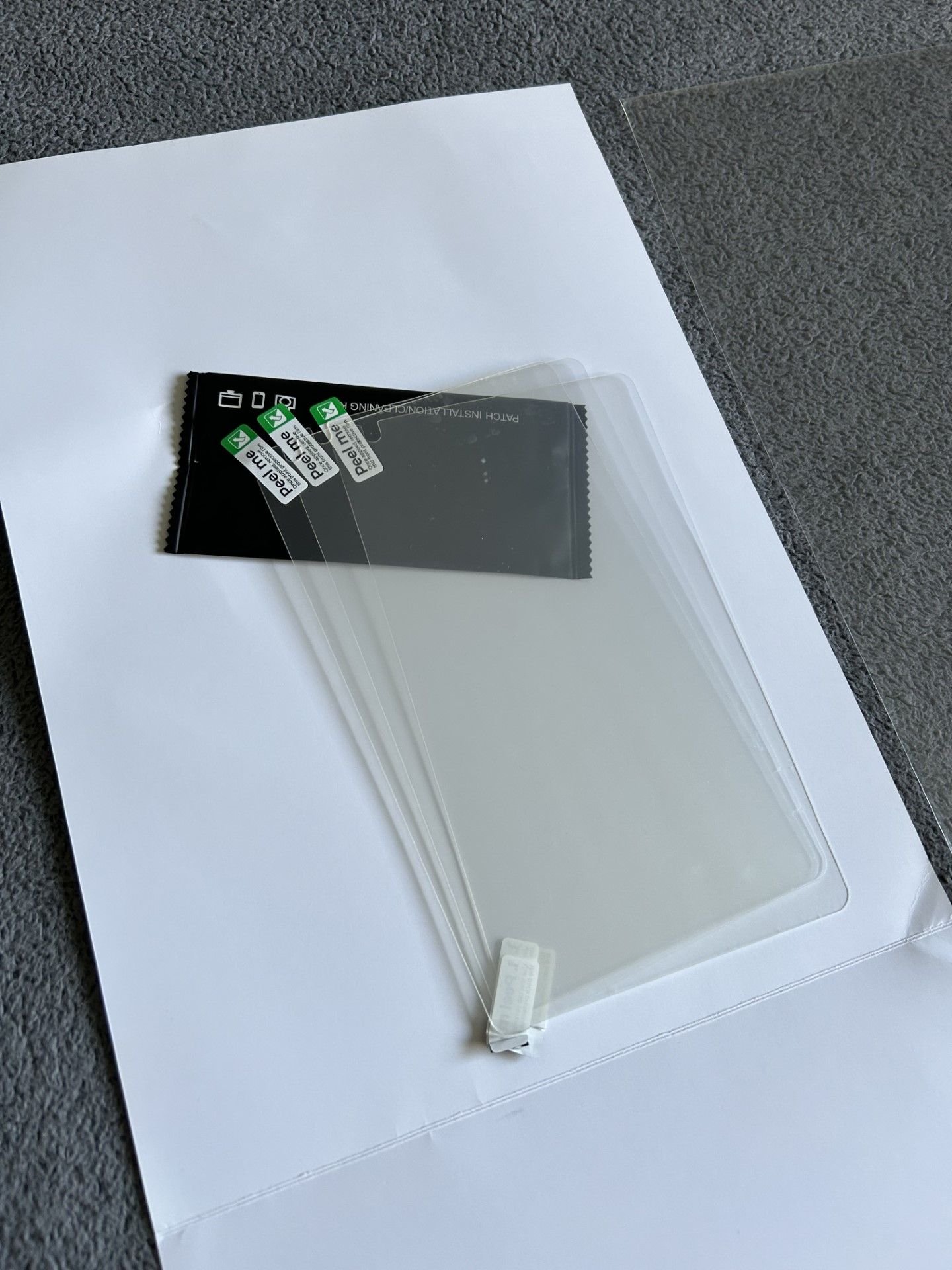

D. Screen Protector Options

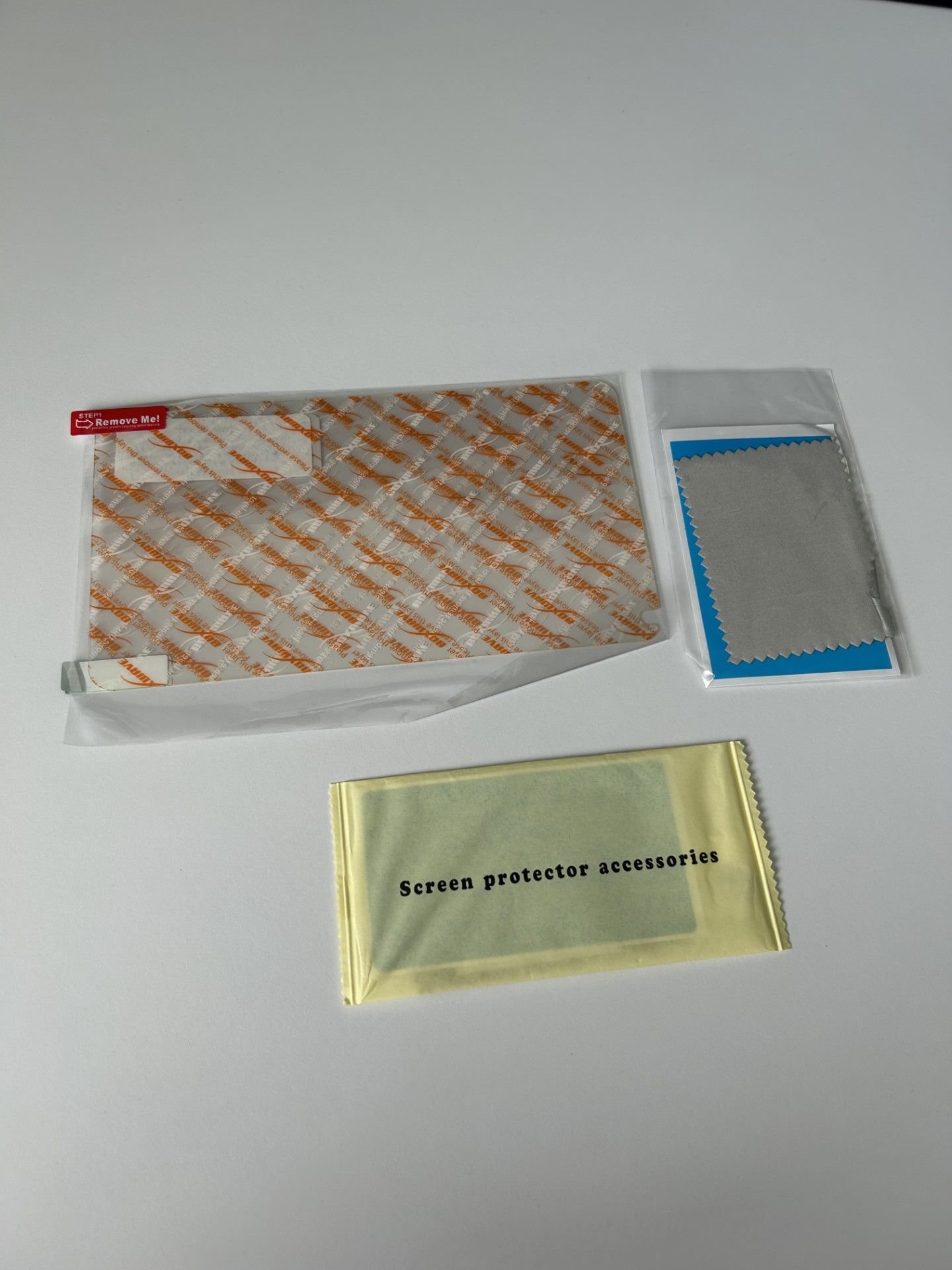

I like to take care of my possessions, so finding a unit that offered some sort of protection was important.
Unfortunately, I didn’t find a singular brand that offered their own screen protector for purchase. However, I did find a few companies that manufactured and sold a “Carpuride” W701 screen protector. Keep in mind that most of these 7.0” units are built by Chinese manufactures and come with the exact same screen shape, so I figured these protectors would work even if I decided to go with another brand.

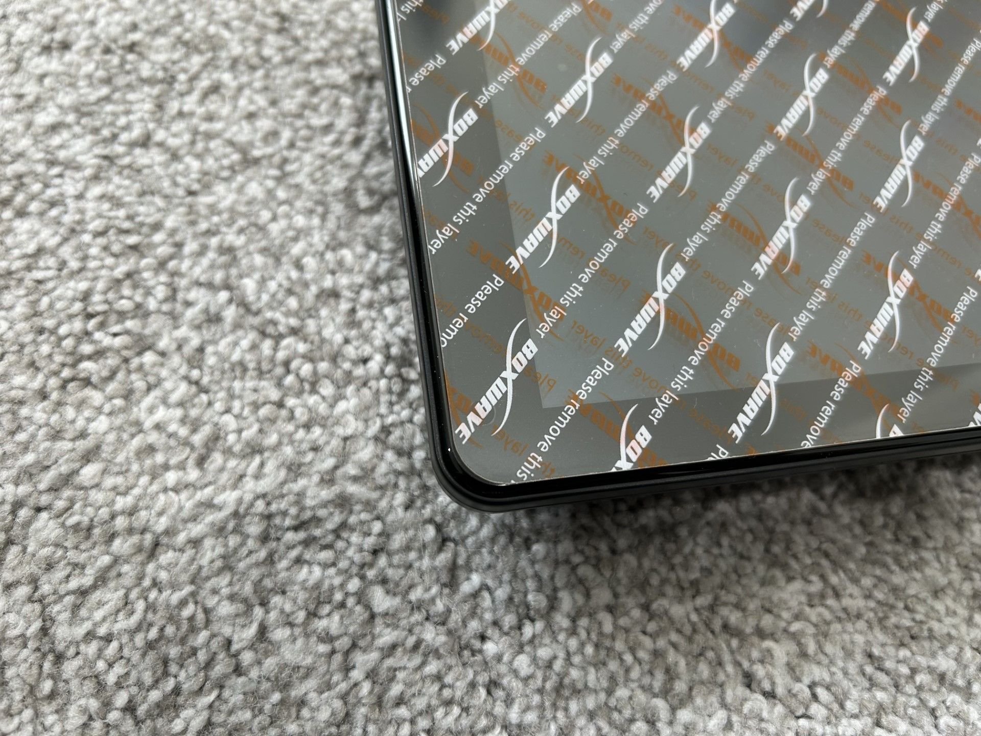

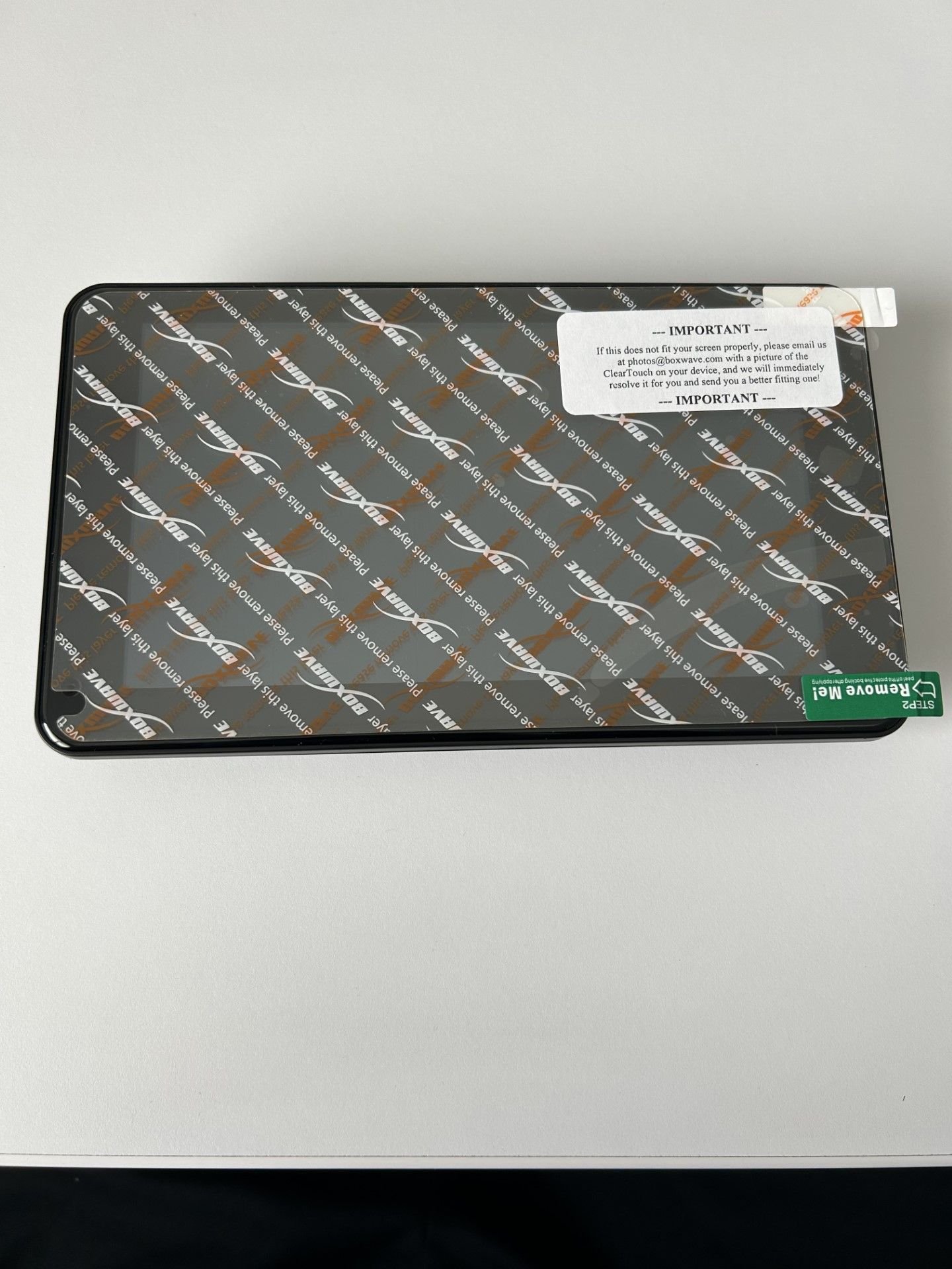

1.Boxwave (Trash!)
My first purchase was the Boxwave ClearTouch Anti-Glare Screen Protector (i.e. matte):
https://www.amazon.com/gp/your-account/order-history/ref=ppx_yo_dt_b_search_od?ie=UTF8&ij=&opt=ab&ref_=&search=114-0273648-6129036 https://www.amazon.com/gp/your-account/order-history/ref=ppx_yo_dt_b_search_od?ie=UTF8&ij=&opt=ab&ref_=&search=114-0273648-6129036
Although not advertised on their Amazon advertisement, these protectors contain a microphone hole cutout. Unfortunately, the hole location was not correct, so I contacted Boxwave through Amazon’s customer service and shared some pictures of the screen protector. Boxwave offered to correct the hole cutout or refund my money. I told them that I had planned to use an external microphone, so I asked if they could simply send me screen protectors with no hole cutout. They agreed to do so and I received new screen protectors at no cost.
Supposedly, their advertised “glueless” adhesives system allows users to re-use their ClearTouch screen protectors. However, I couldn’t even get these screen protectors to stick to my unit initially. I contacted customer service again and didn’t really receive any tips, but rather they told me that they would refund my money.
I threw them in the trash.

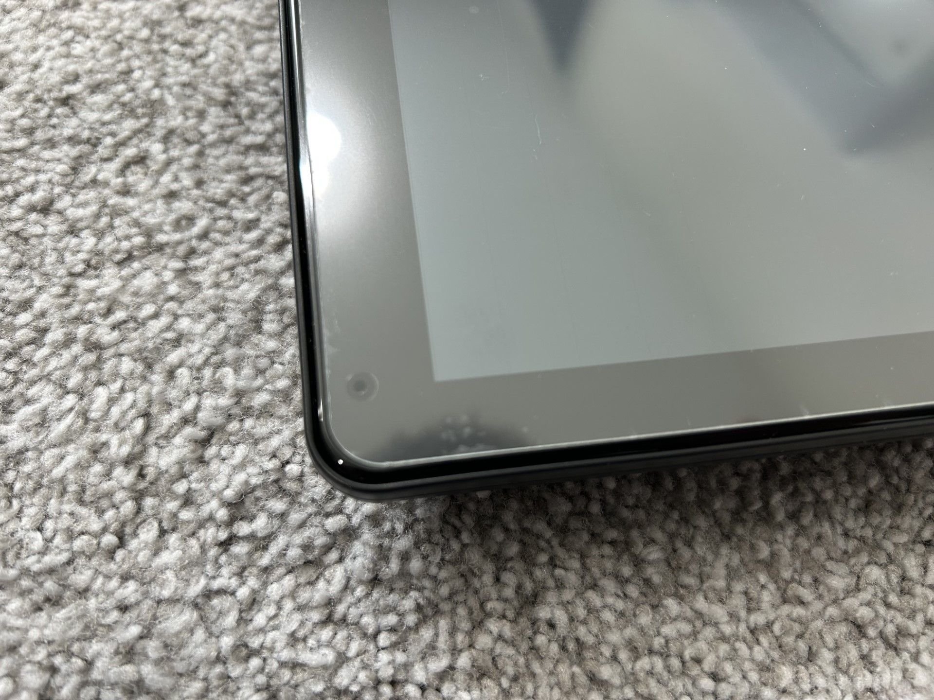

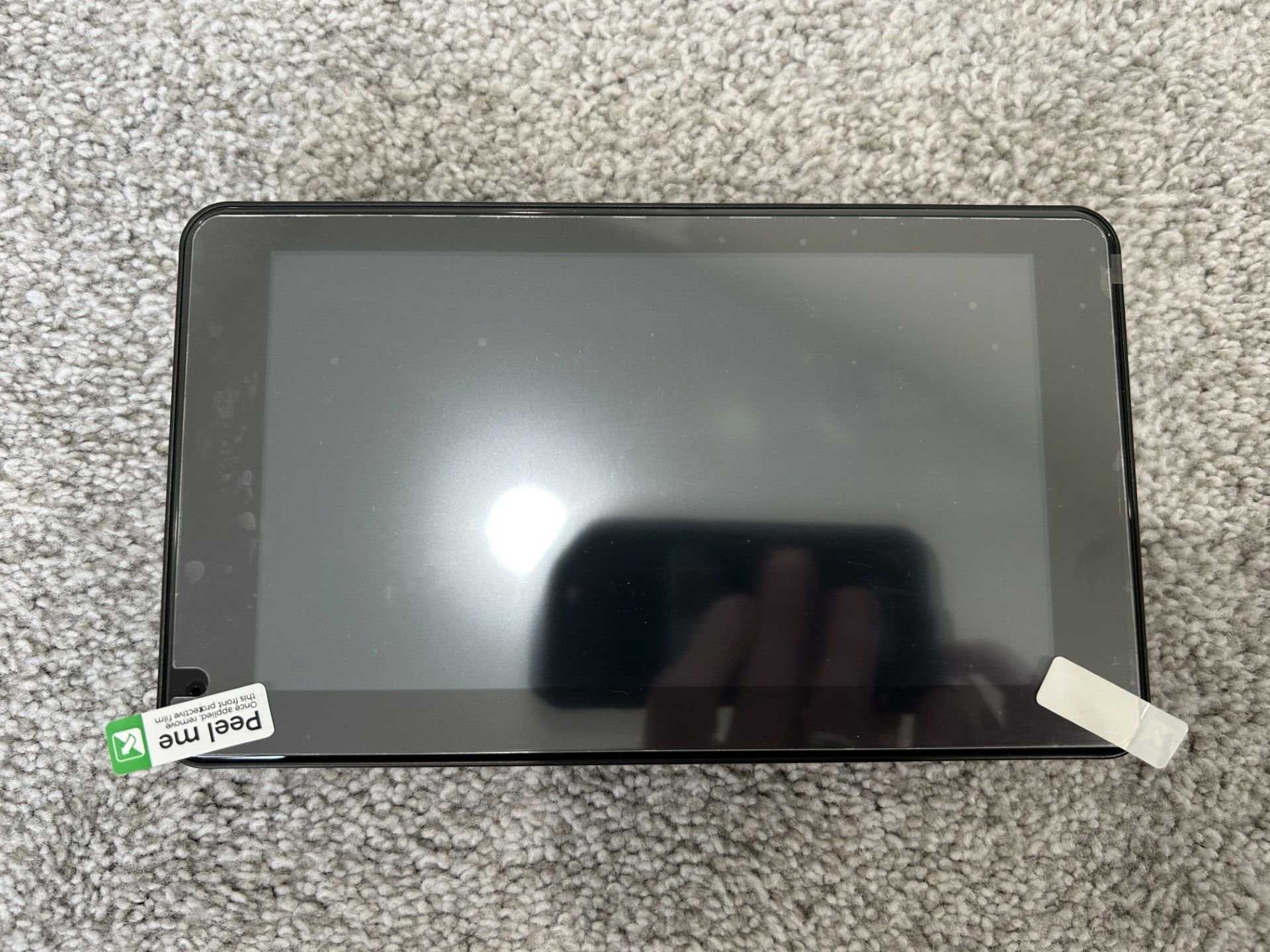

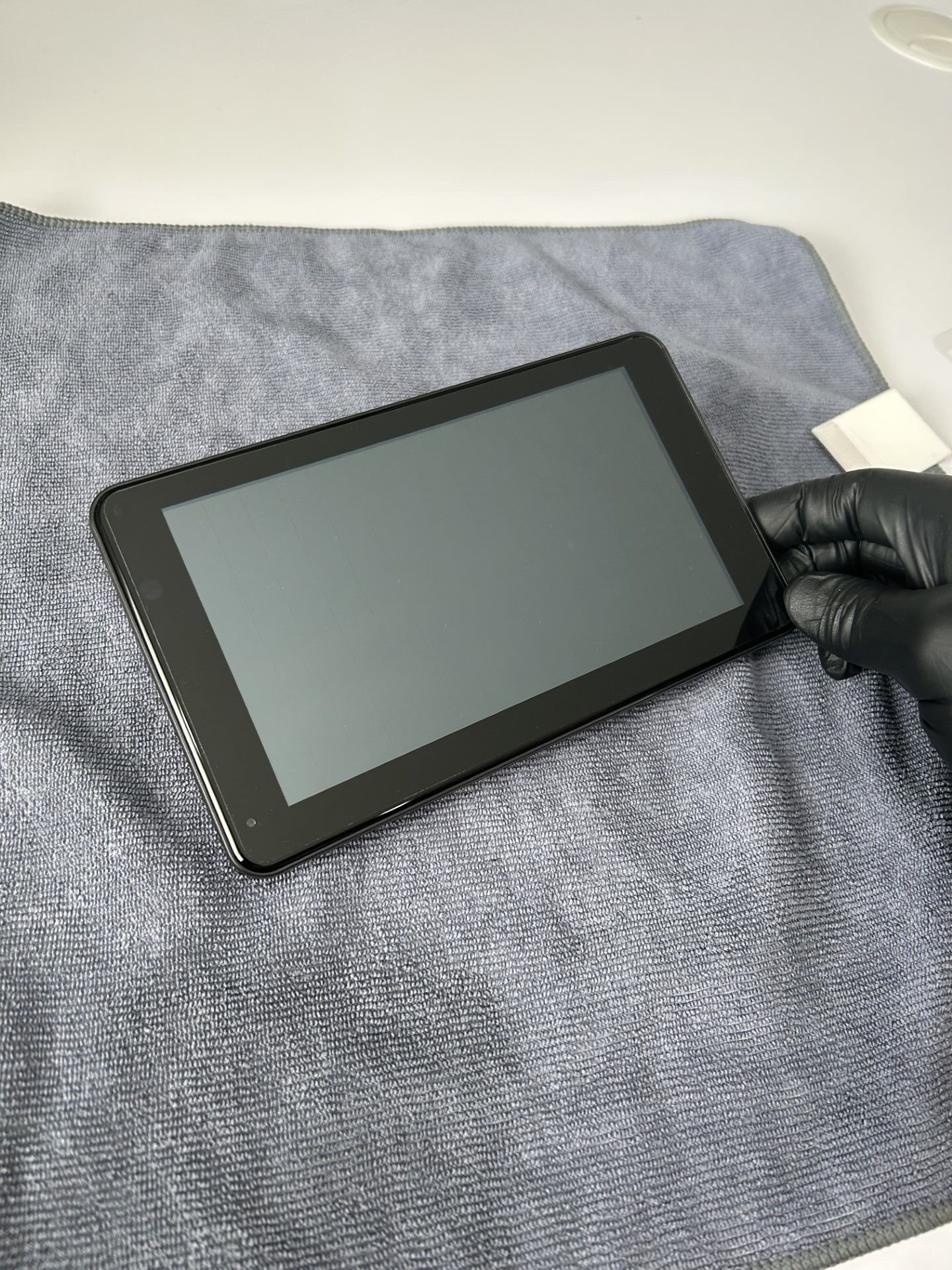

2. ScreenShield (Success!)
My second purchase was the ScreenShield BROTECT AirGlass Matte Screen Protector:
https://screenshield.us/products/3x-...word=carpuride
*As an aside, my assumption is that ScreenShield may have updated their products since originally posting the BROTECT screen protectors on their website. I actually received the Optic+ Anti-Glare product. If you refer to the below hyperlink, you will see all of their Carpuride options and understand what I mean.
Product advertised:
BROTECT AirGlass Matte Glass Scree Protector
Product received:
Optic+ Anti-Glare Screen Protector
For reference, The W103 is a new product and the images posted online match the packaging that I received for my W701 purchase.
https://screenshield.us/pages/rapid-...wE&q=carpuride
As advertised, ScreenShield’s screen protectors are originally manufactured with a microphone hole cutout. Unfortunately, when I received my products, the hole was just a bit off center. Similar to how I navigated with Boxwave, I emailed ScreeShield’s support team to see if a correction could be made. I was connected with an individual named George and I asked if he could make me new screen protectors without a microphone hole. George got back to me within a day, notifying me he’d provide me with free replacements. You can’t beat that level of care!
As you will see in the below images. The overall fit of the screen protector is very good. It covers much better than Boxwave screen protectors and without the microphone hole cutout, you can hardly tell it’s there!
*Images below were simply a test fit. I did not install the screen protectors yet
When the time came for installation, I was shocked at how easy the it was. Using the application cloth and plastic card that ScreenShield provided, I was able to install my screen protectors without any bubbles on the very first try! When the Capuride unit is installed in my car, you can’t even tell there is a screen protector on there. This satisfied my desire to have a true OEM look.
While I like the functionality of matte screen protectors (reduction glare and zero fingerprints) the resolution of the Carpuride unit was a bit reduced/grainy. This is one of the tradeoffs you get when you purchase matte screen protectors, so I emailed George and thought I’d give the clear version a try.
Therefore, my third purchase was the ScreenShield BROTECT AirGlass Screen Protector:
https://screenshield.us/products/bro...word=carpuride
Product received:
Optic+ Nano Glass Screen Protector
Similar to my other applications, this went without a hiccup. If you’re looking for any sort of screen protector, check out their website and tell them I sent you.

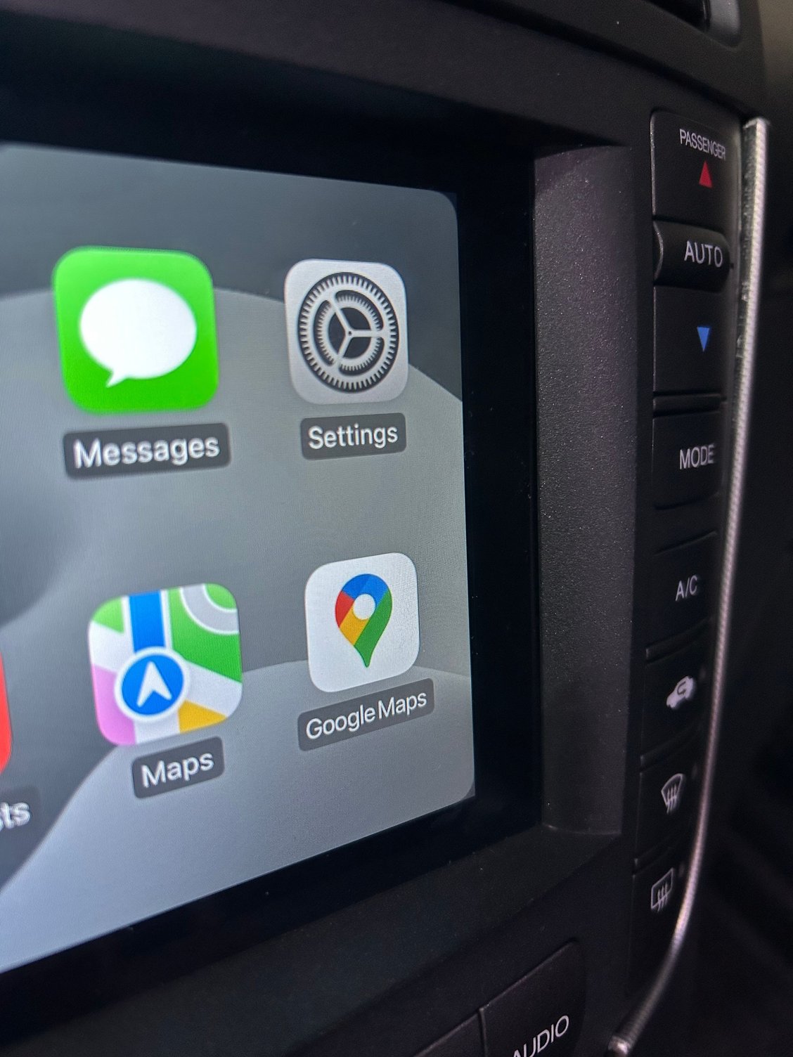

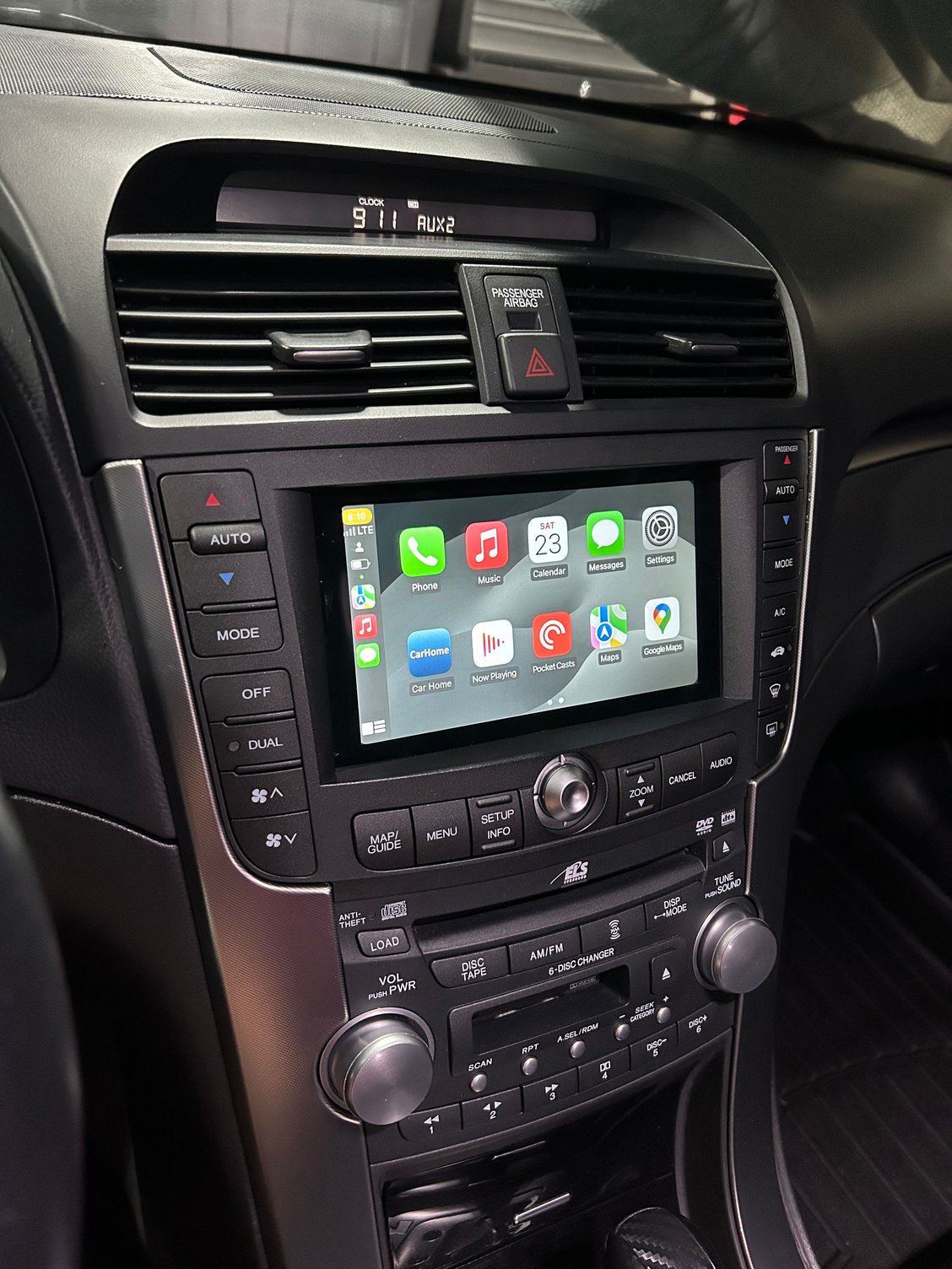

V. Installation
Now that you know the reasons why I chose my Carpuride W701 unit, I will take you through my installation method. My installation required a great deal of time, resources, and patience. I know that I went quite above and beyond what Is practical, but for me, it was 100% worth the effort to maintain my OEM look.
Below is a picture that outlines my current and future layout plans:

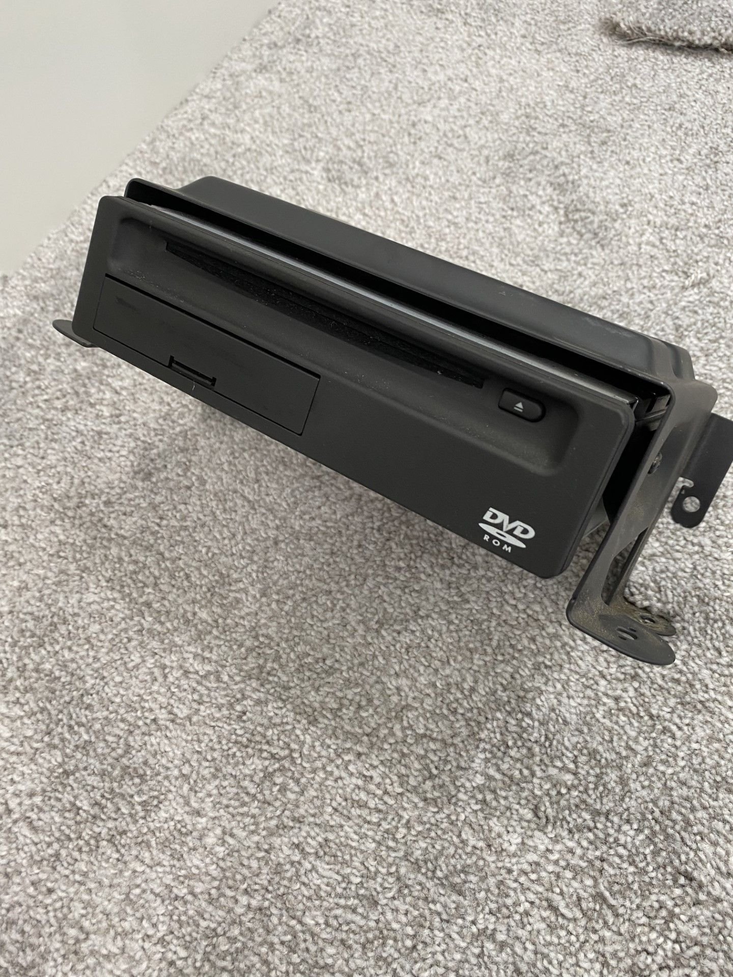

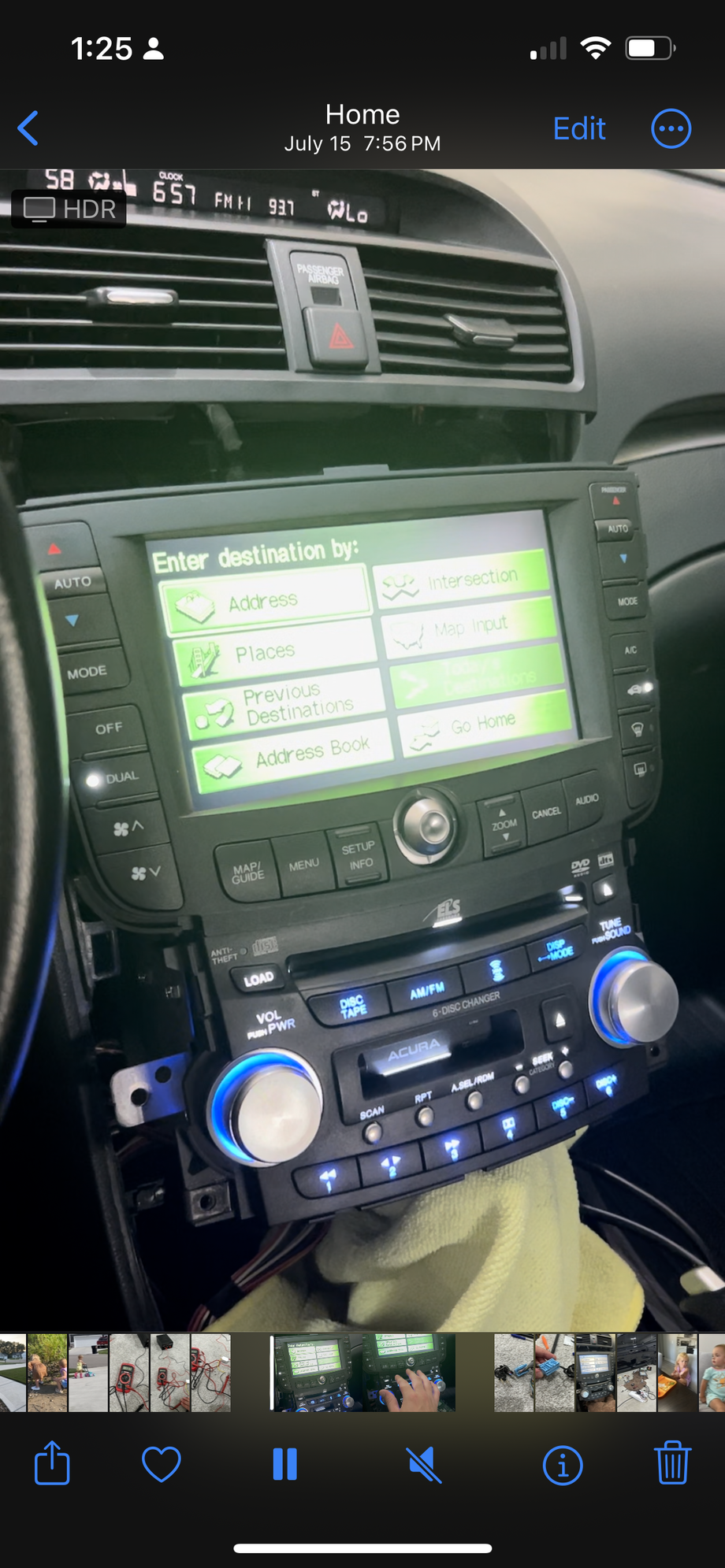

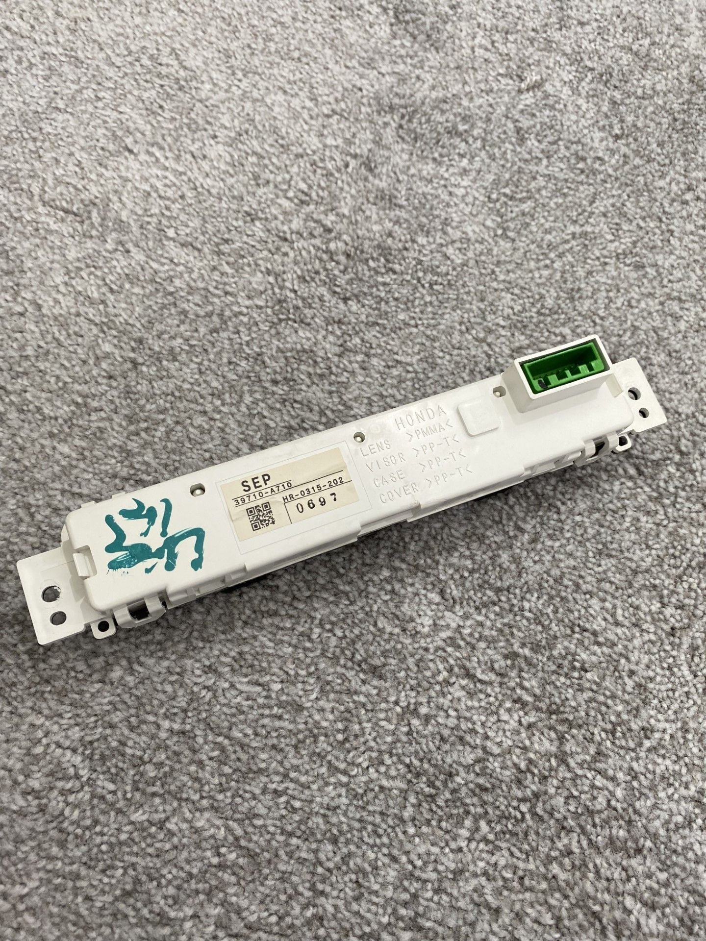

A.Navigation System
Base model TLs do not come equipped with a sub-display for HVAC and Radio controls. This feature was only available for navigation models. Therefore, in order for a third party tablet to be installed, I had to either:
1) relocate my OEM radio and HVAC screens – Do not get me started on this I had so many trials and errors during my Nexus 7 retrofit.
2) install an OEM navigation system so that I could use the navigation sub display screen.
I went with option 2.
I won’t detail this process given the complexity of what needs to be done and there are separate threads on it already. However, please note that I was only able to finish this conversion with the help of the famous Martin Pan, who makes custom navigation wiring harnesses.
After communicating with him for nearly 8 months, he told me that he no longer wishes to provide this service, so I will respect his wishes and not share his contact information. If you’re savvy enough, you can probably find his information online.

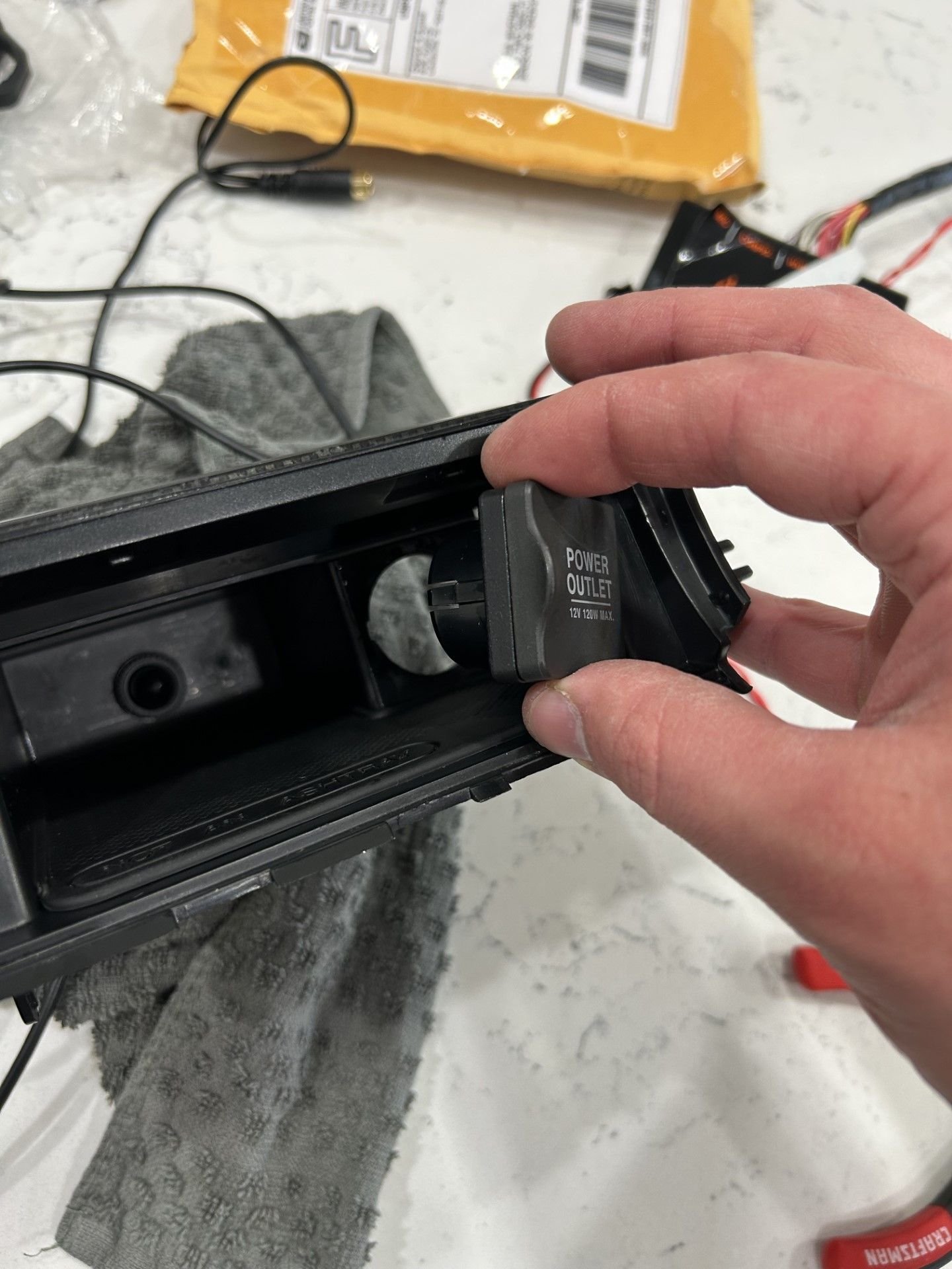

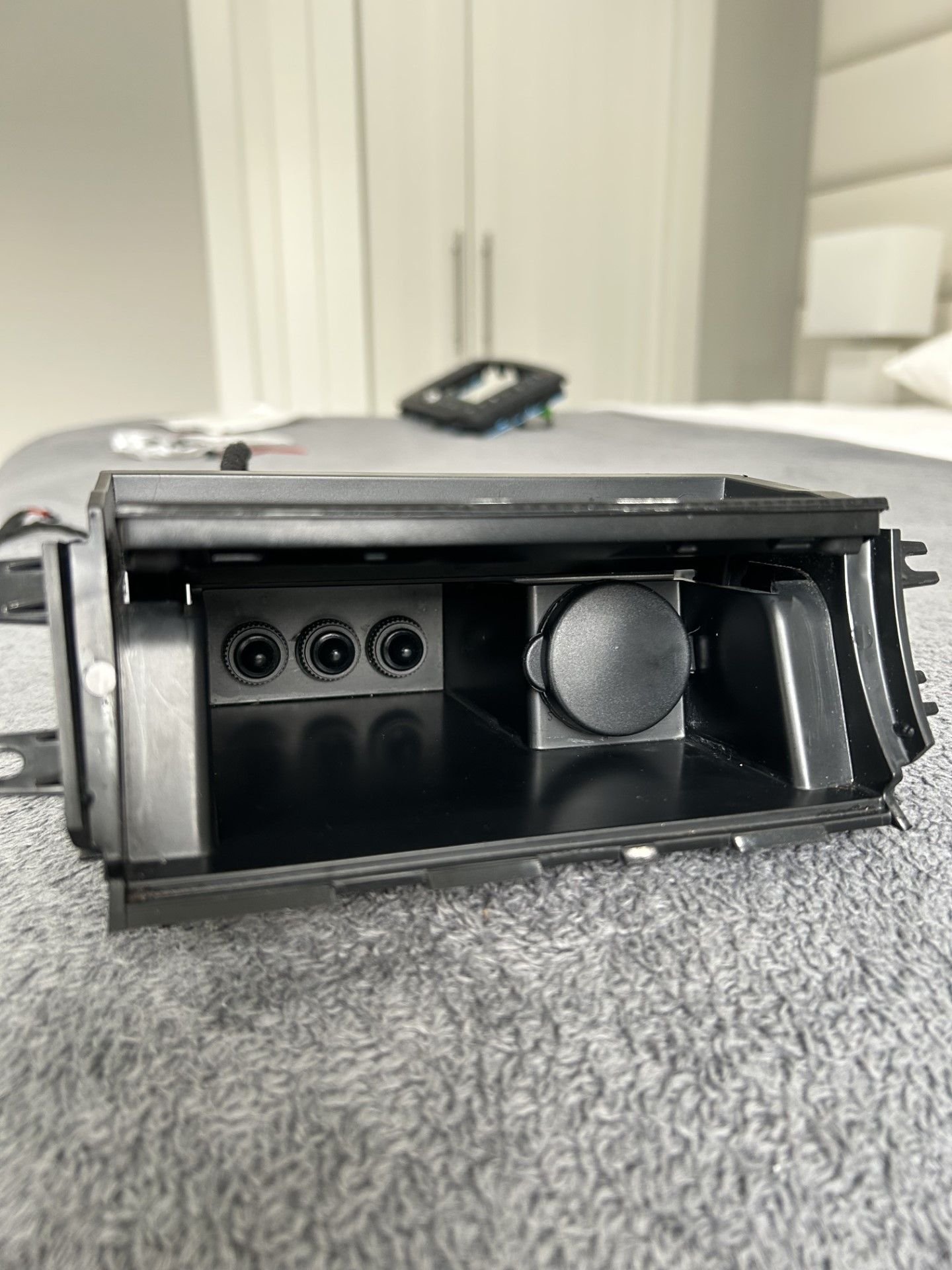

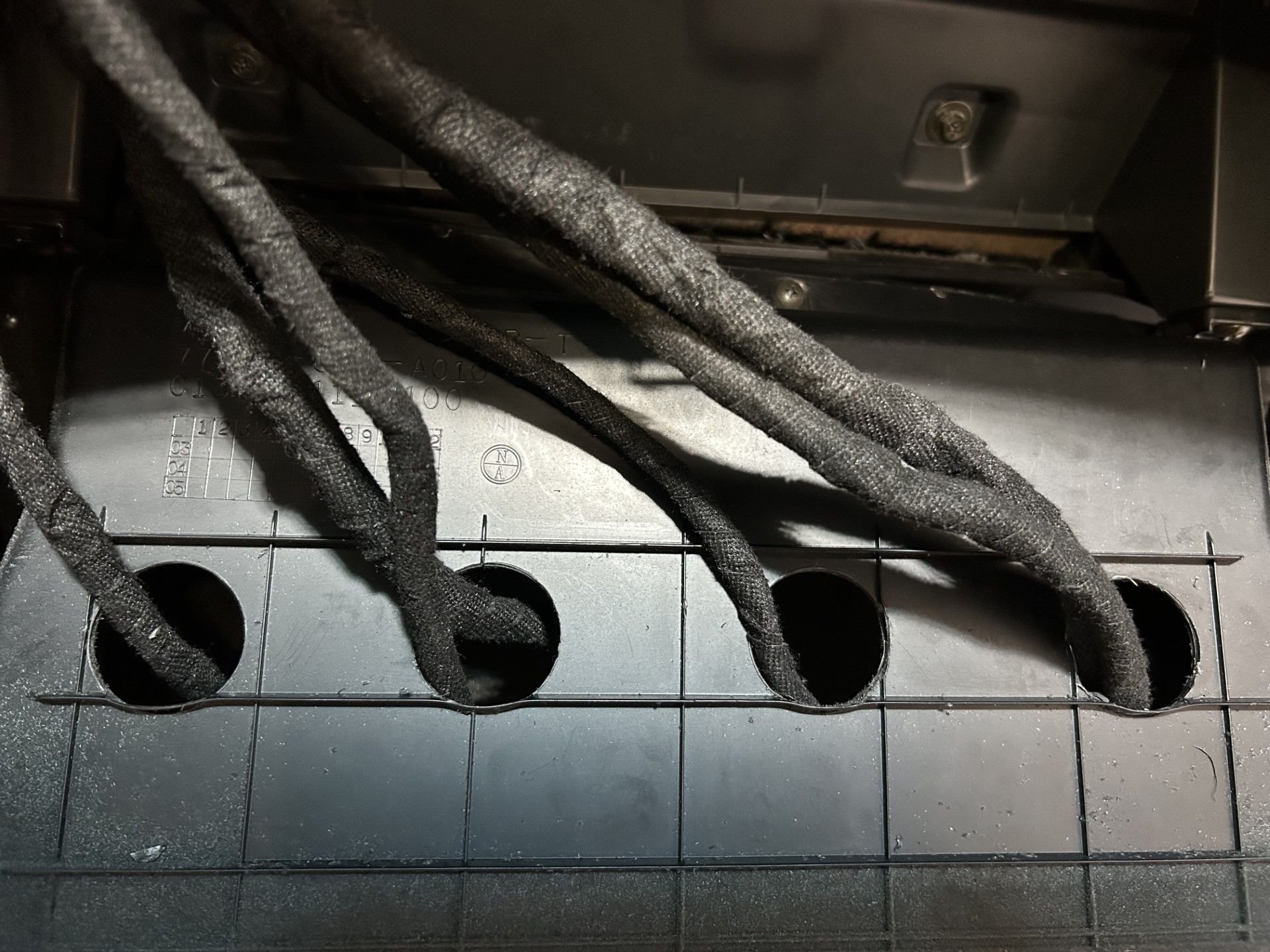

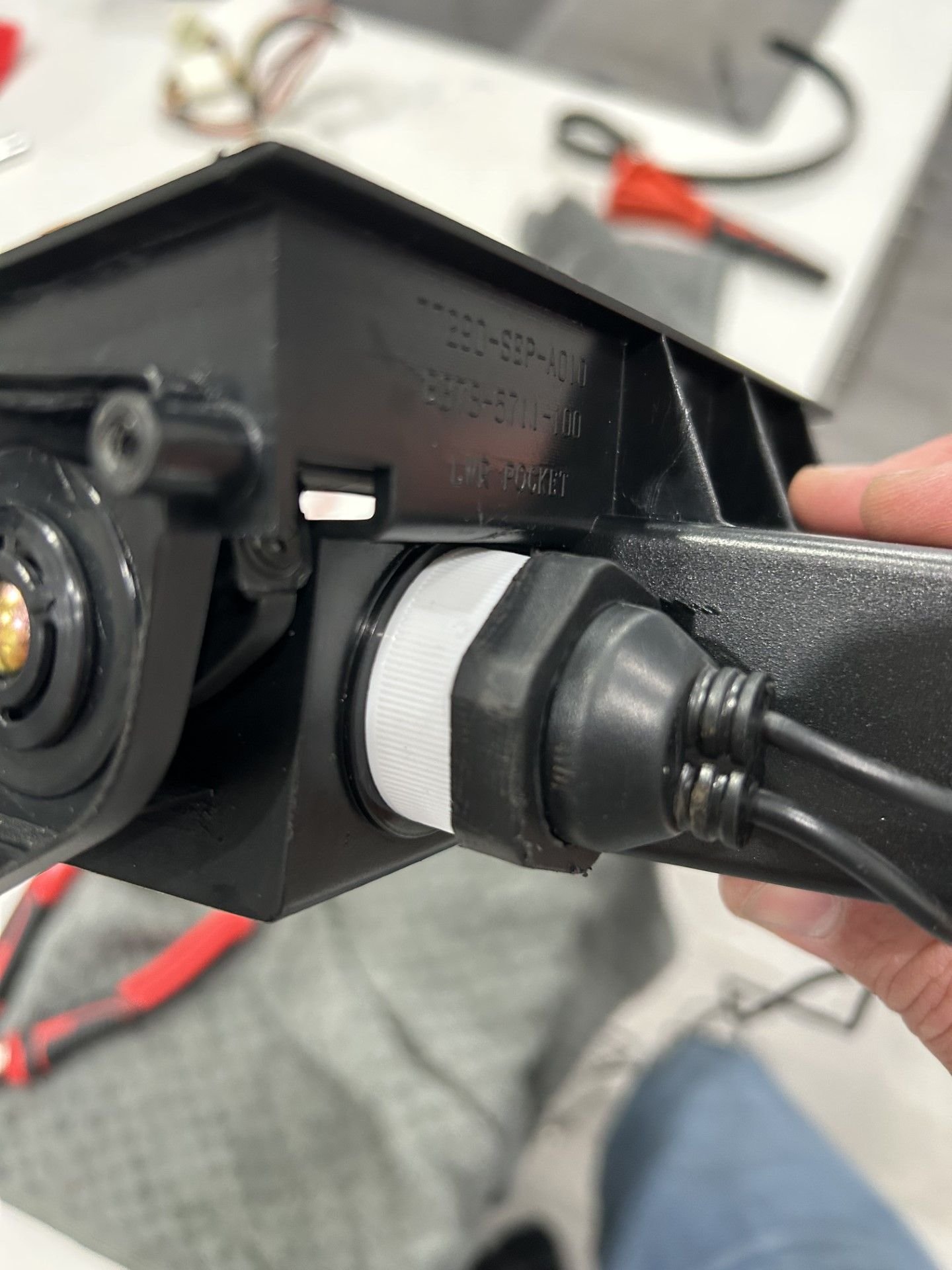

B. Power Source

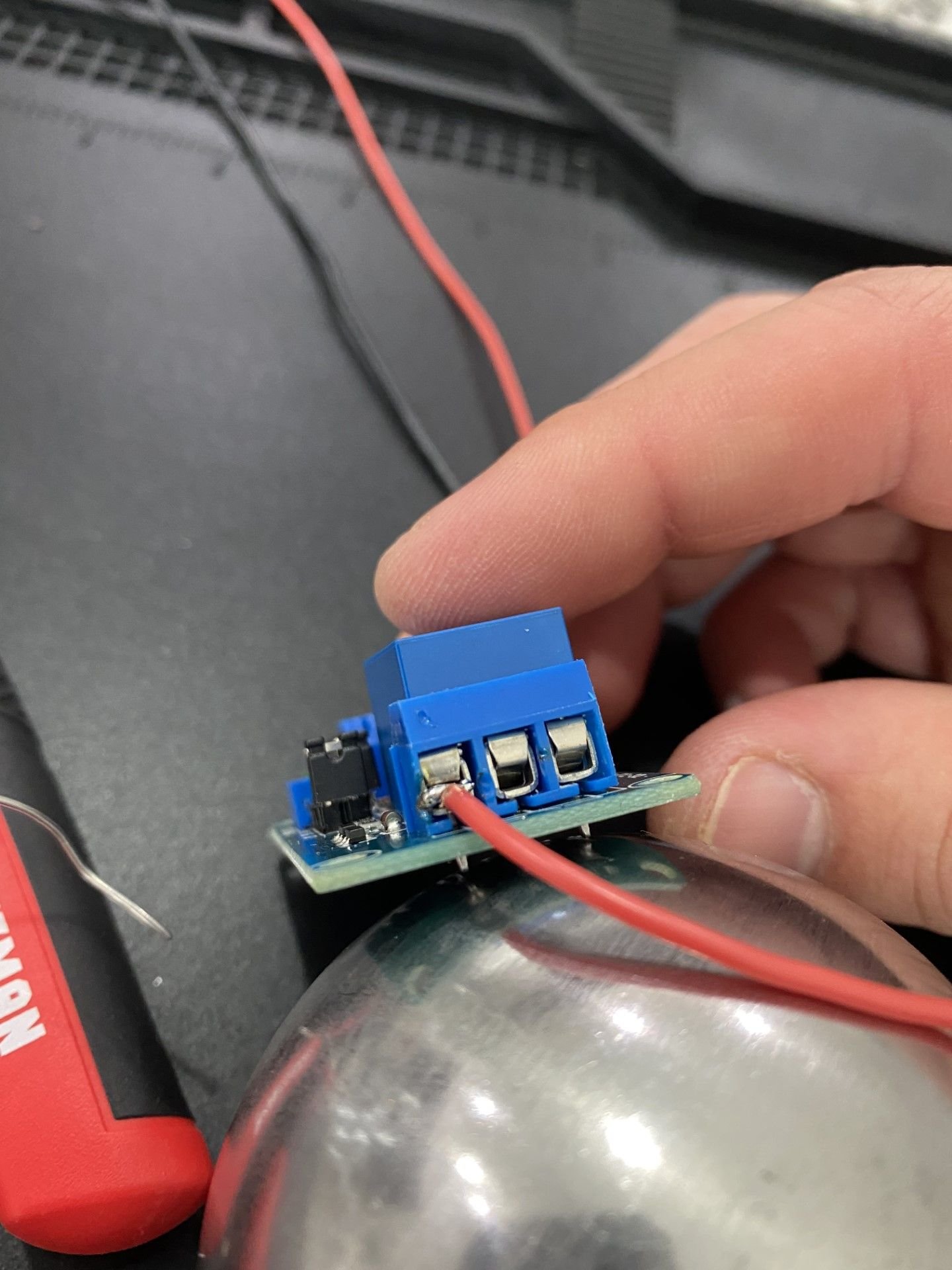

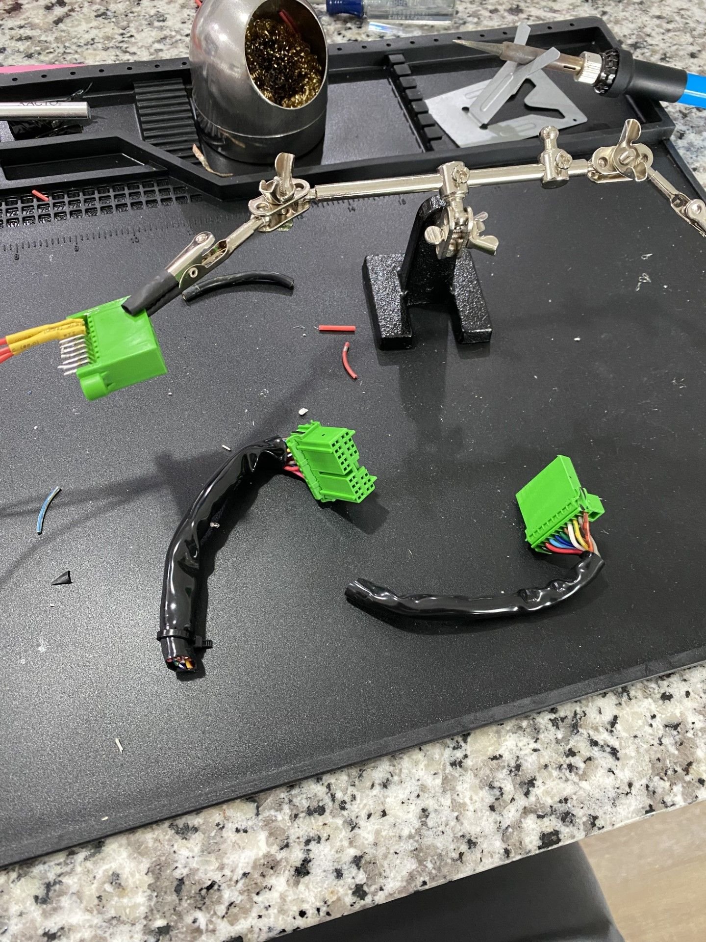

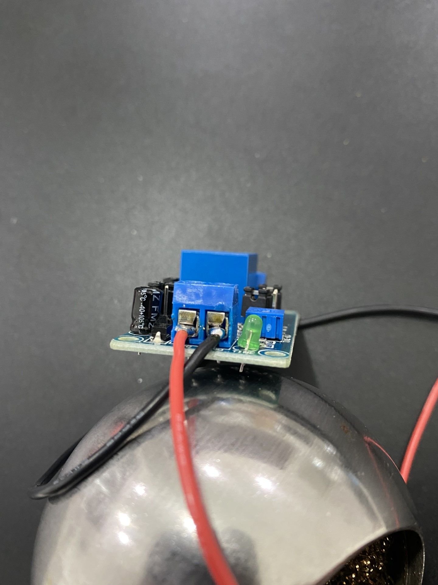

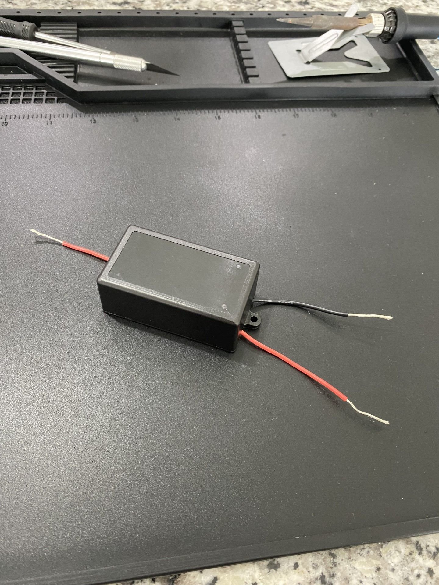

Rather than simply using the cigarette power adapter that came with my Carpuride unit, I decided to hardwire the unit to my interior fuse panel with a timer delay. This makes the assembly completely hidden and also allows for a 3 second delay while the vehicles engine turns over. Heavy draws of power during the ignition process can cause unnecessary wear and tear on tablets, so a timer delay seemed like an obvious choice.

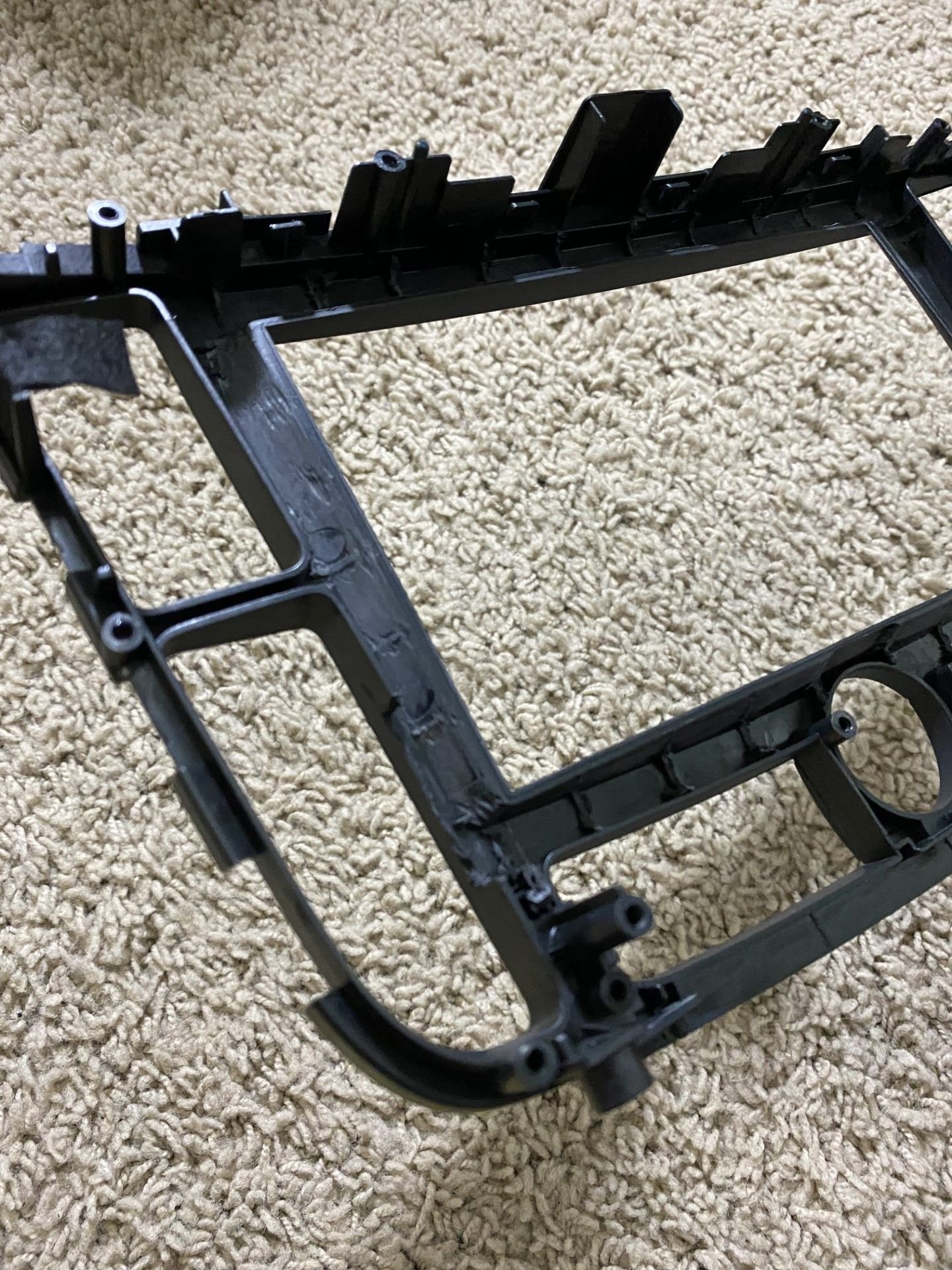

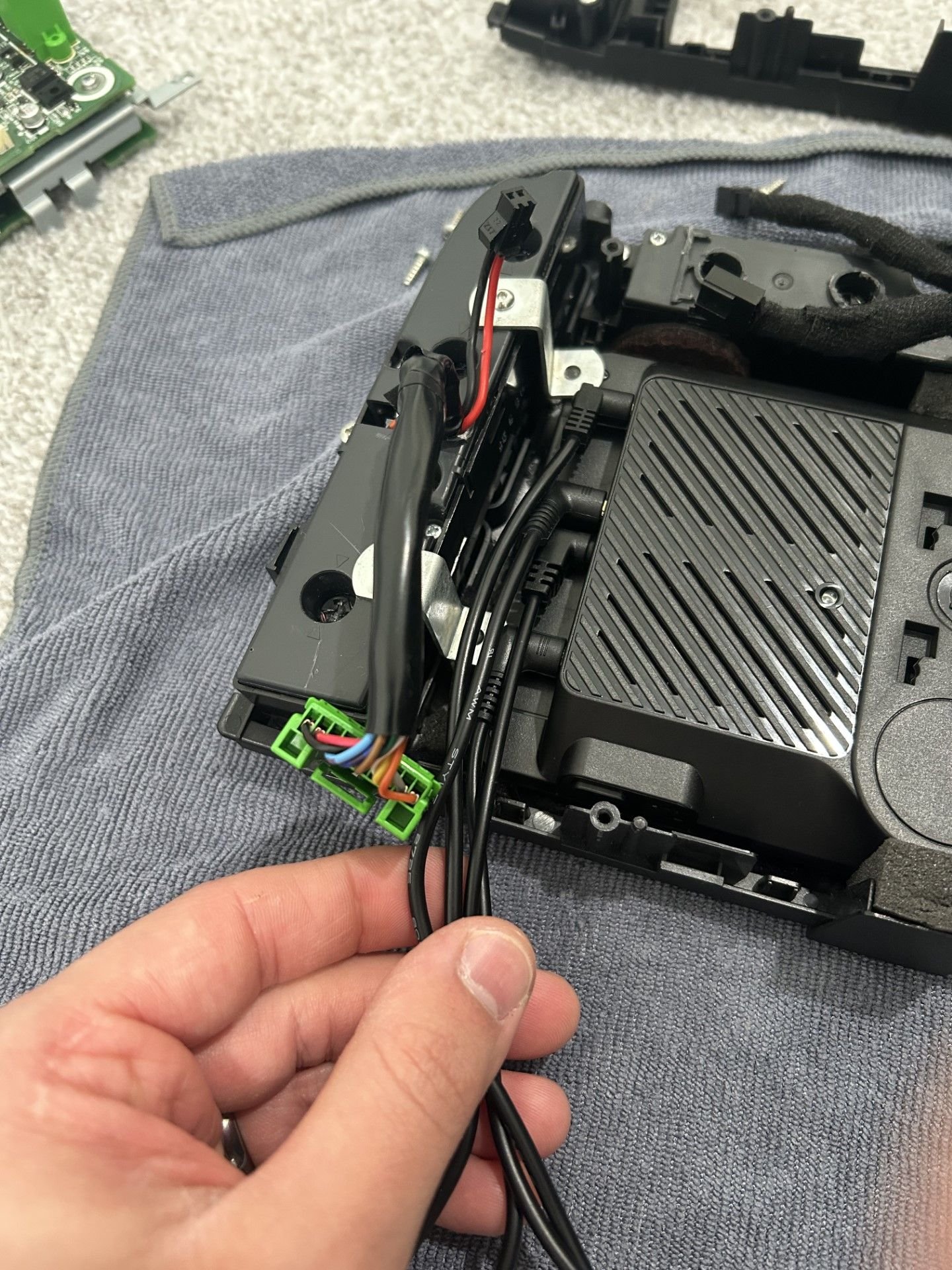

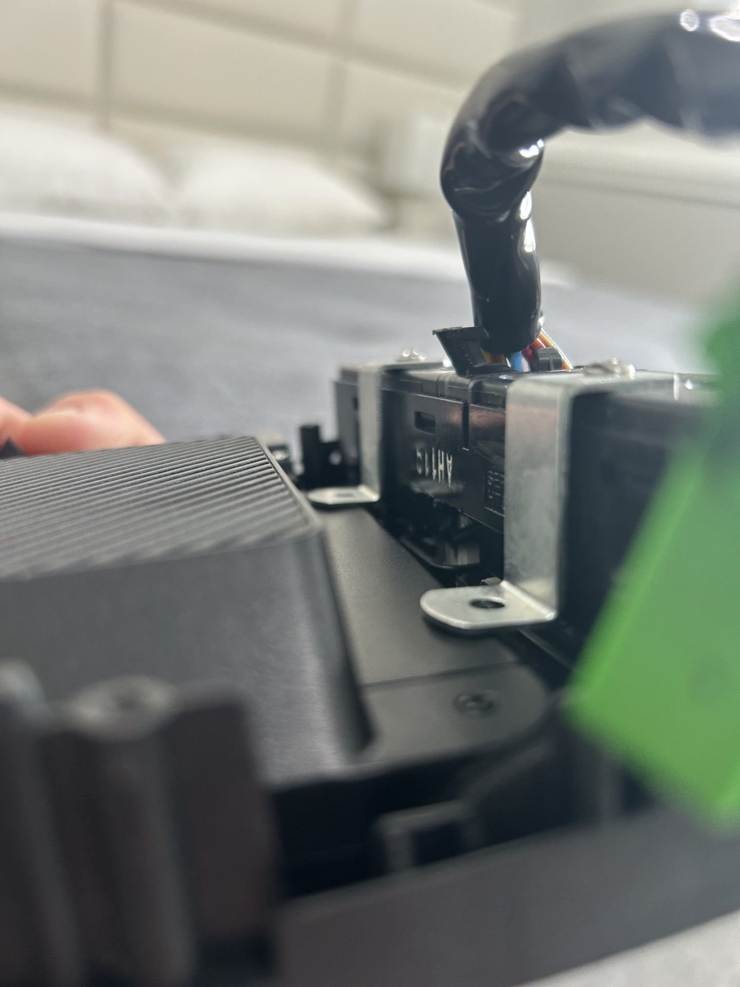

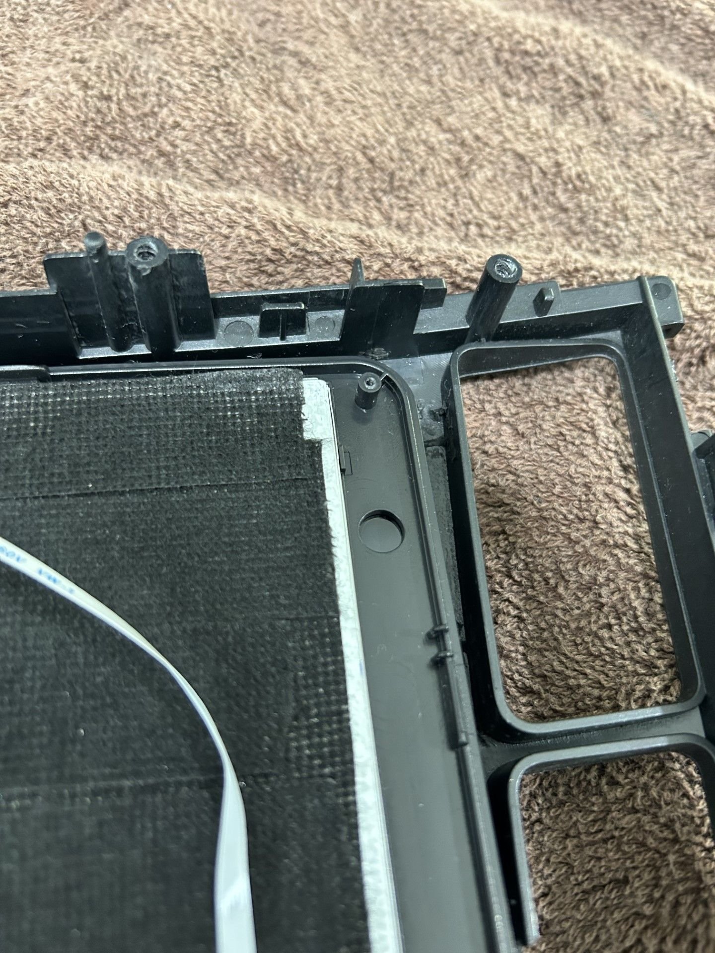

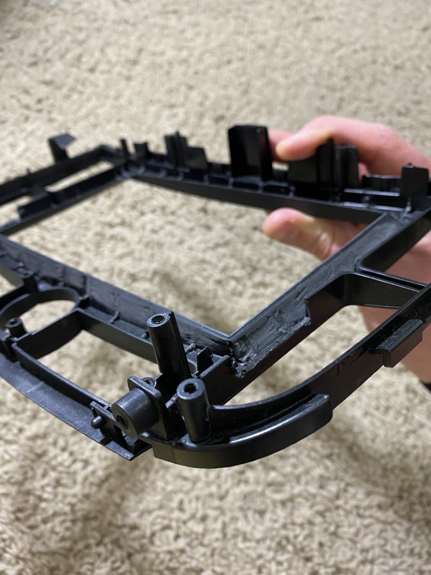

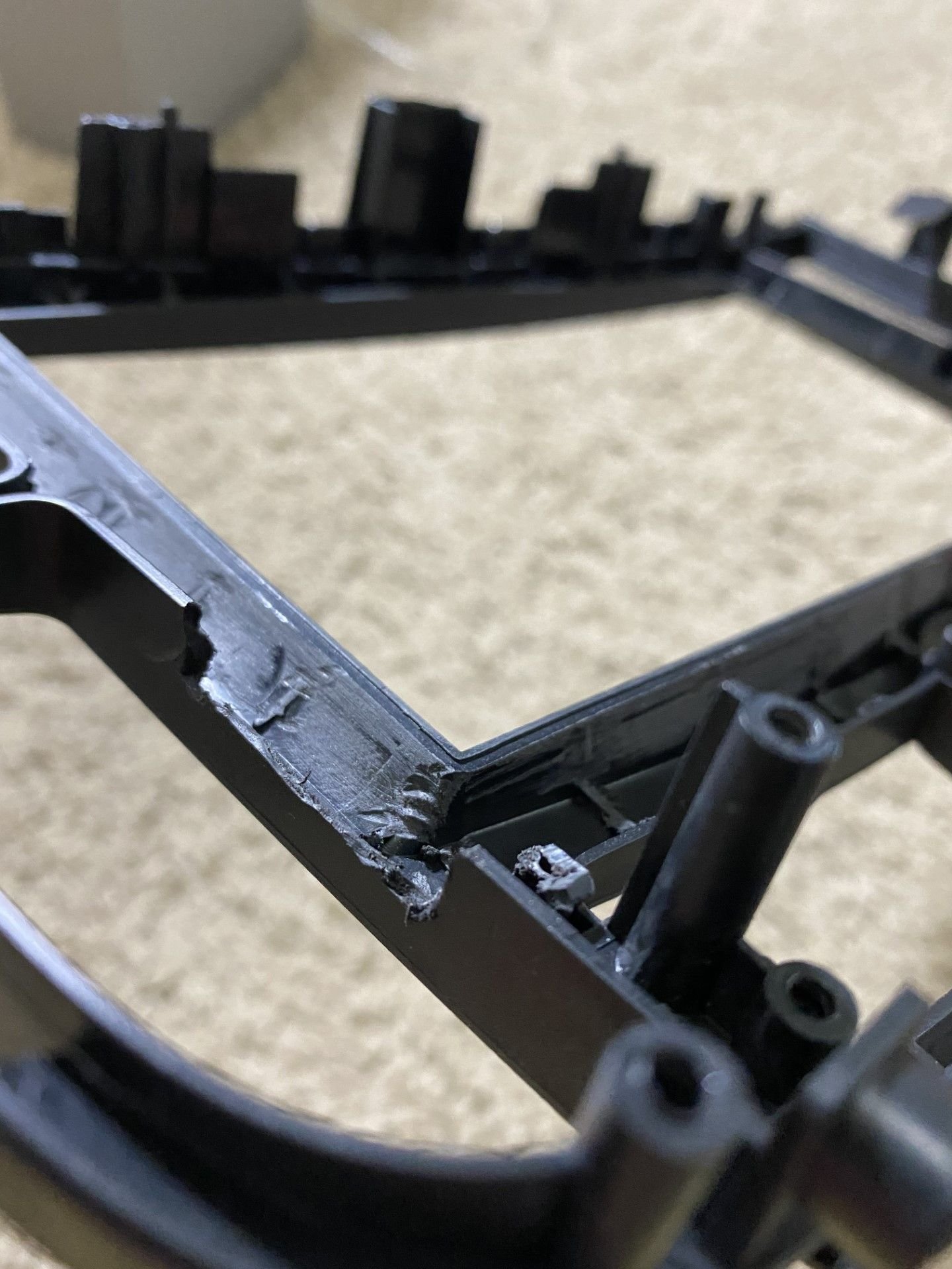

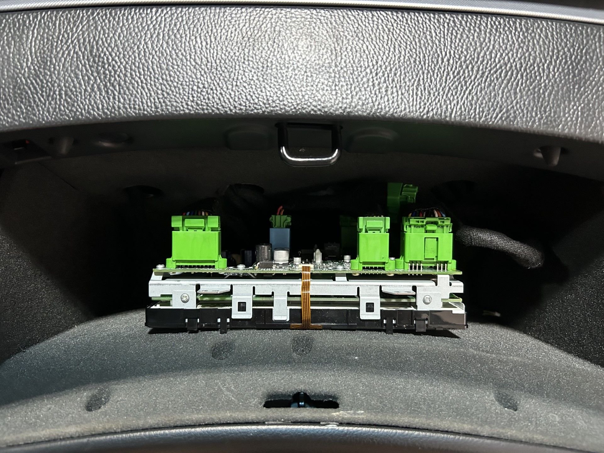

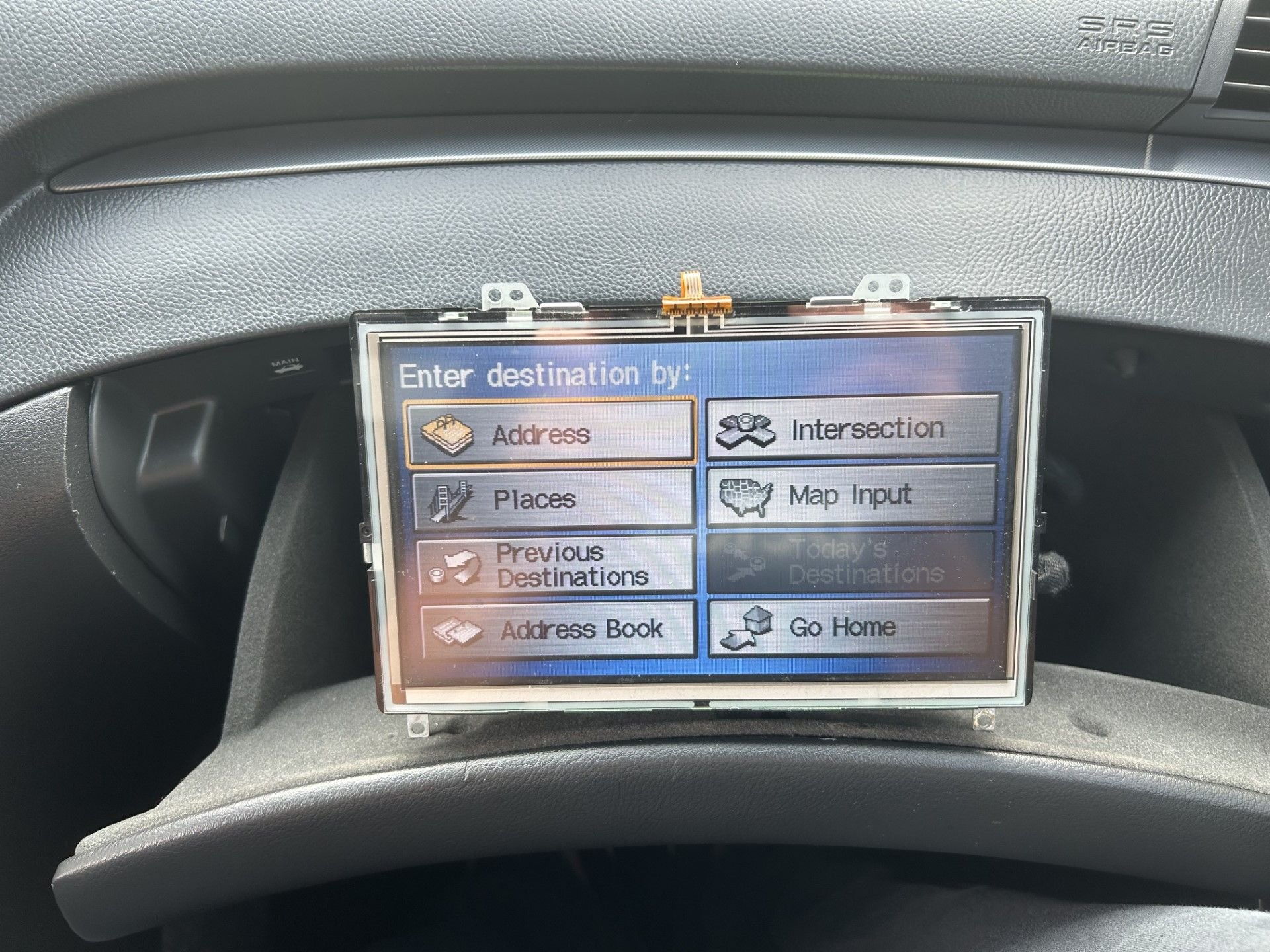

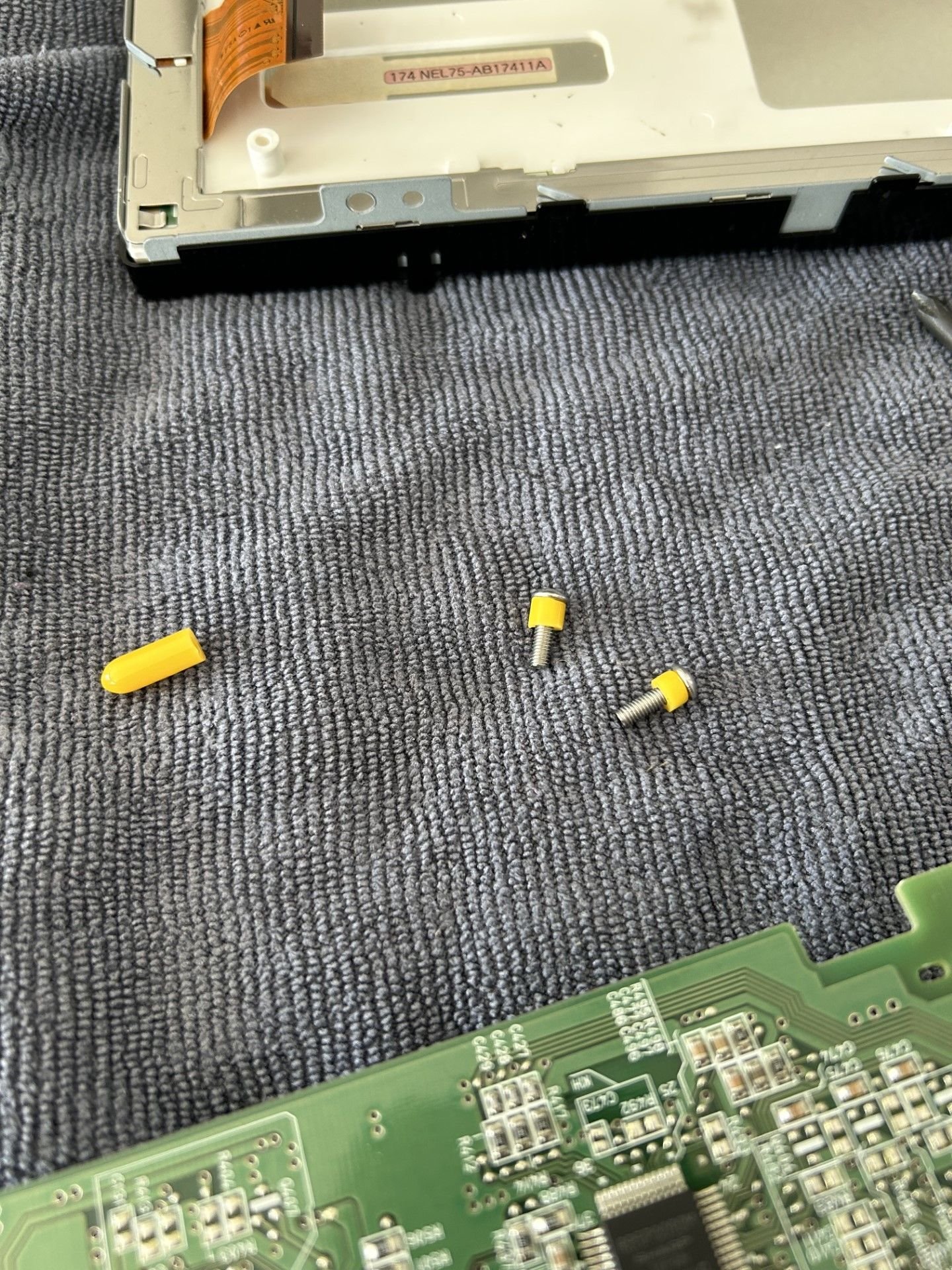

C. Carpuride Screen Mounting (First Attempt)
The first mounting method that I attempted was that I sandwiched the Carpuride unit in between the OEM avigation board and the back face of the navigation plastic bezel.

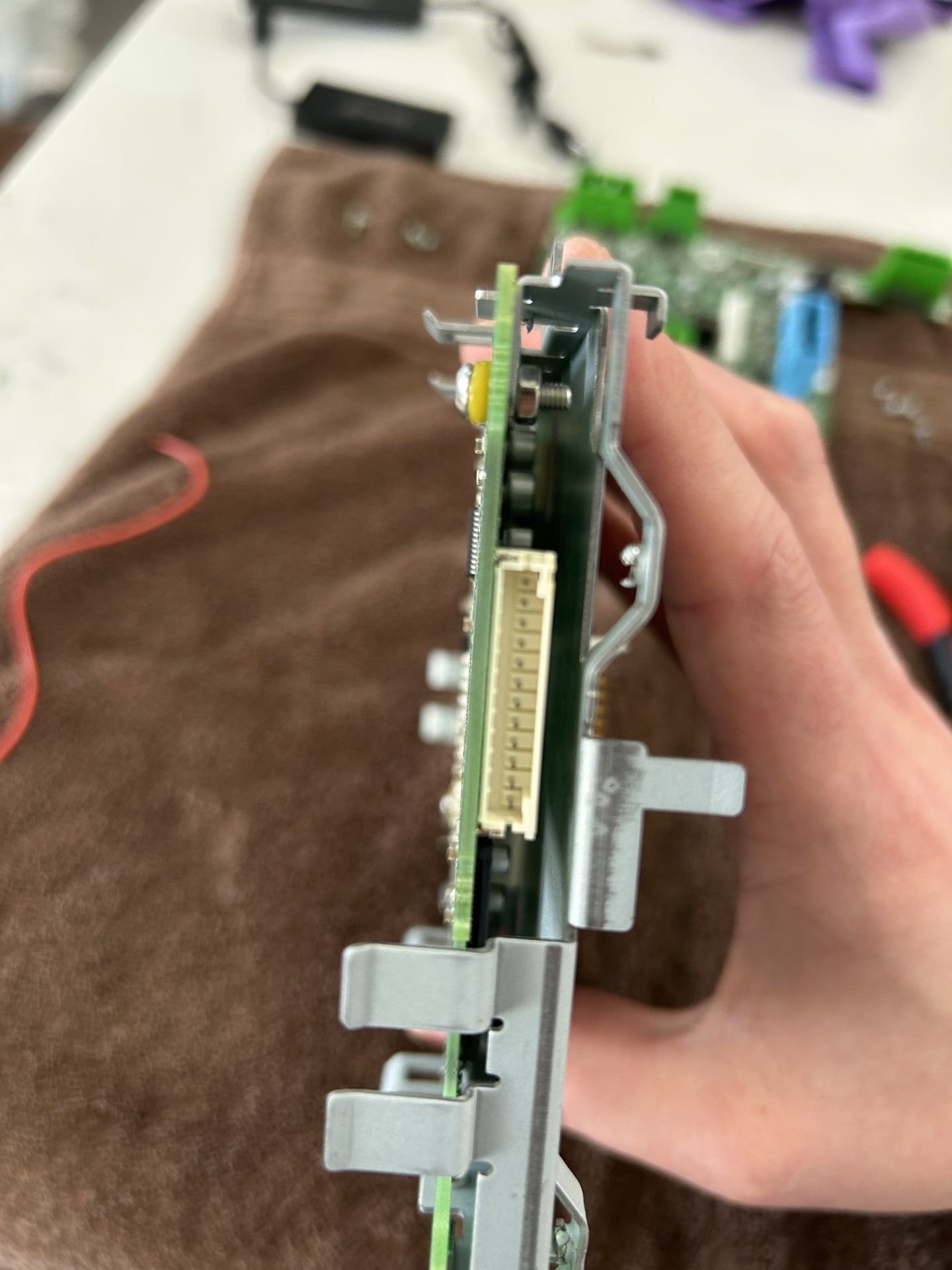

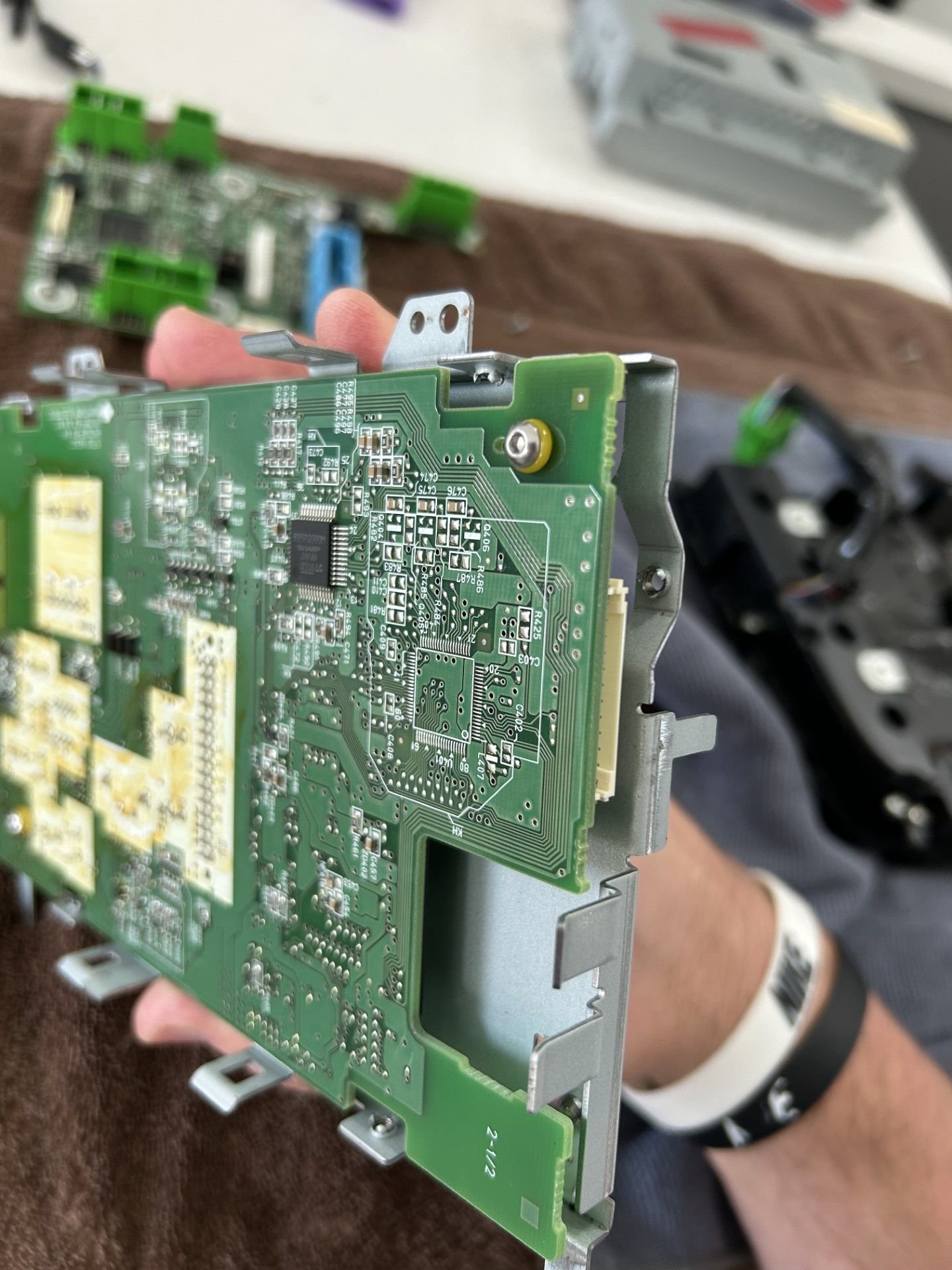

In order for the Carpuride unit to sit flush, the navigation bezel had to be modified significantly. I had to Dremel off all of the little tabs and intrusions with lots of test fitting. Fortunately for me, I had already completed this process in 2019 when I started my Nexus 7 retrofit.
Additionally, the OEM navigation boards have to be re-mounted. This is because the OEM screen is removed and the screen’s bracket has mounting holes. Re-mounting the PCB boards required some careful repurposing of some fasteners and silicone washers that I made out of vacuum caps.
For both modifications, I followed the guidance of sockr1 in his below thread:
https://acurazine.com/forums/3g-tl-a...camera-953237/
After completed both of these steps, it came time to mount the tablet. Below are a few images of my first attempt:

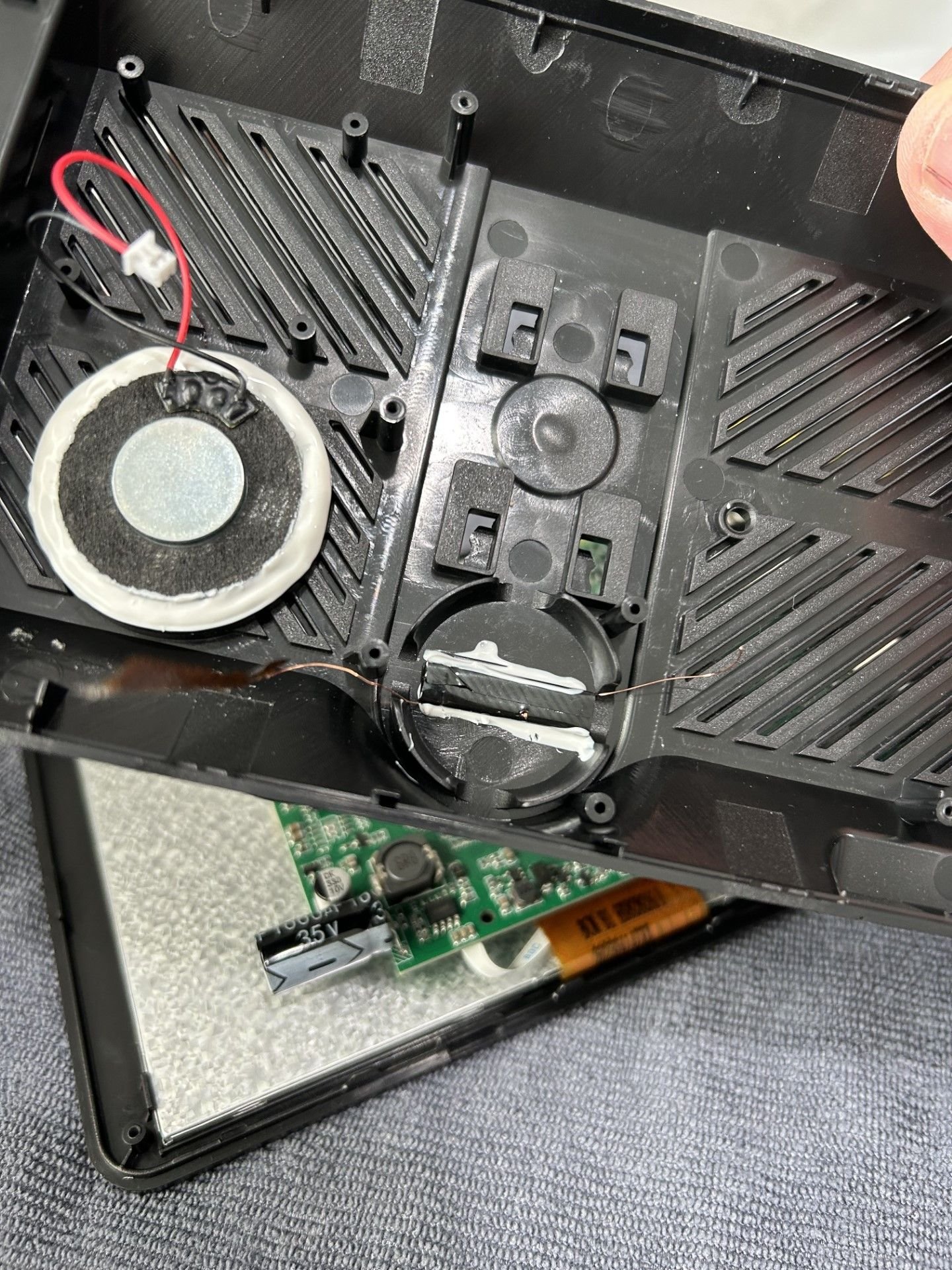

As you can see, the Carpuride unit was much thicker than the OEM screen, so it didn’t fit hardly all. Therefore, more modifications were required to make the unit thinner

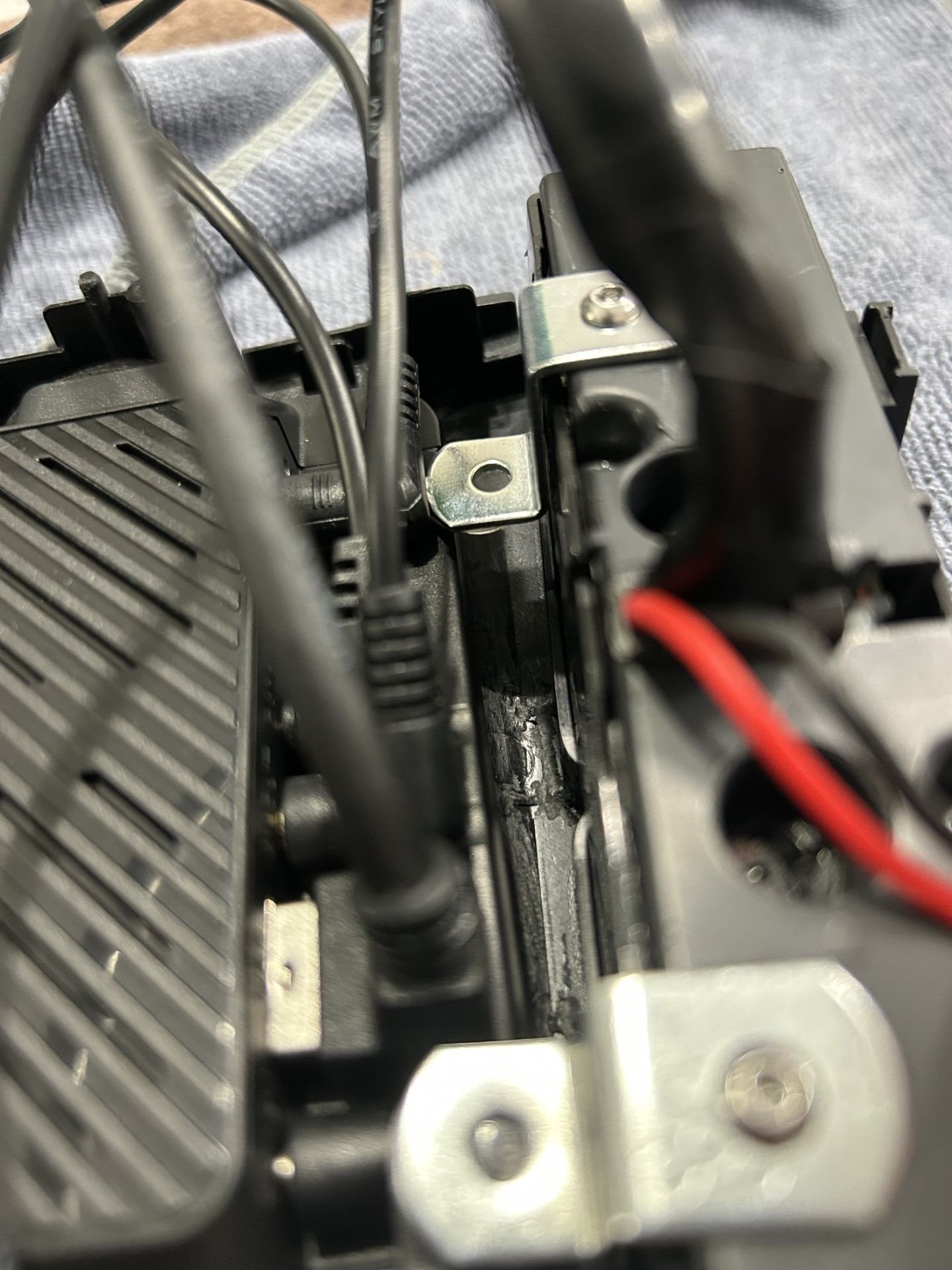

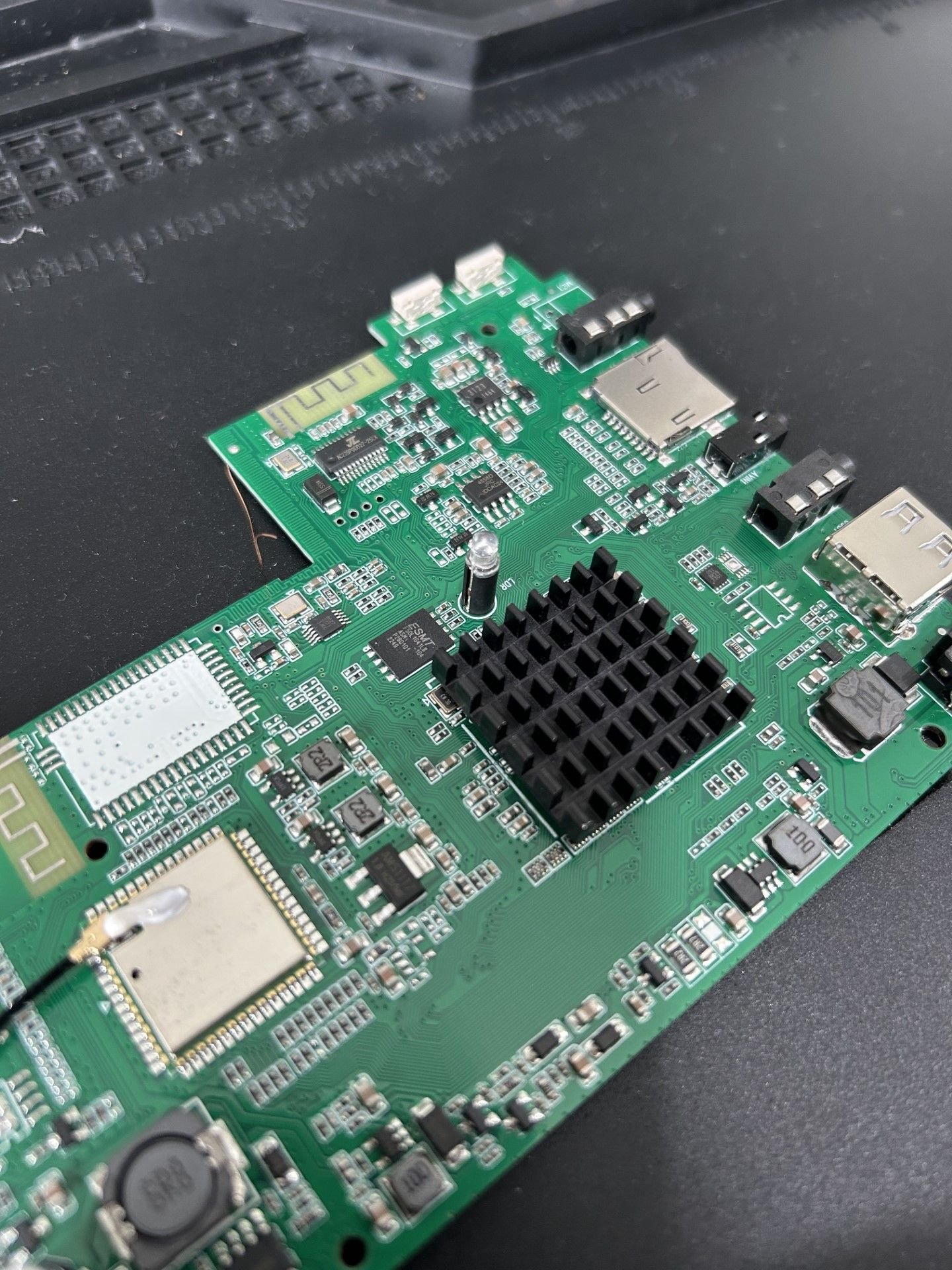

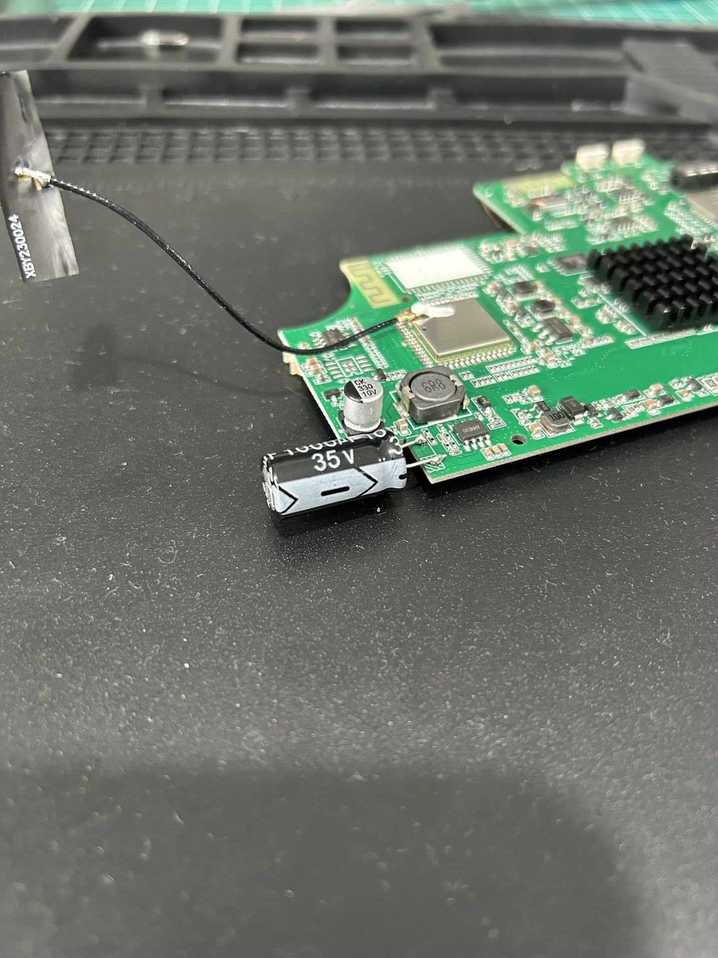

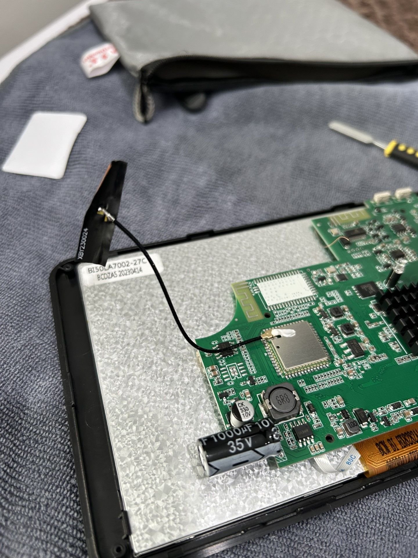

1.Unit Disassembled
I accomplished this by removing all of the backing screws and gently prying the unit open with tablet plastic pry tools.I also had to unscrew the PCB boards that were attached to the back cover.

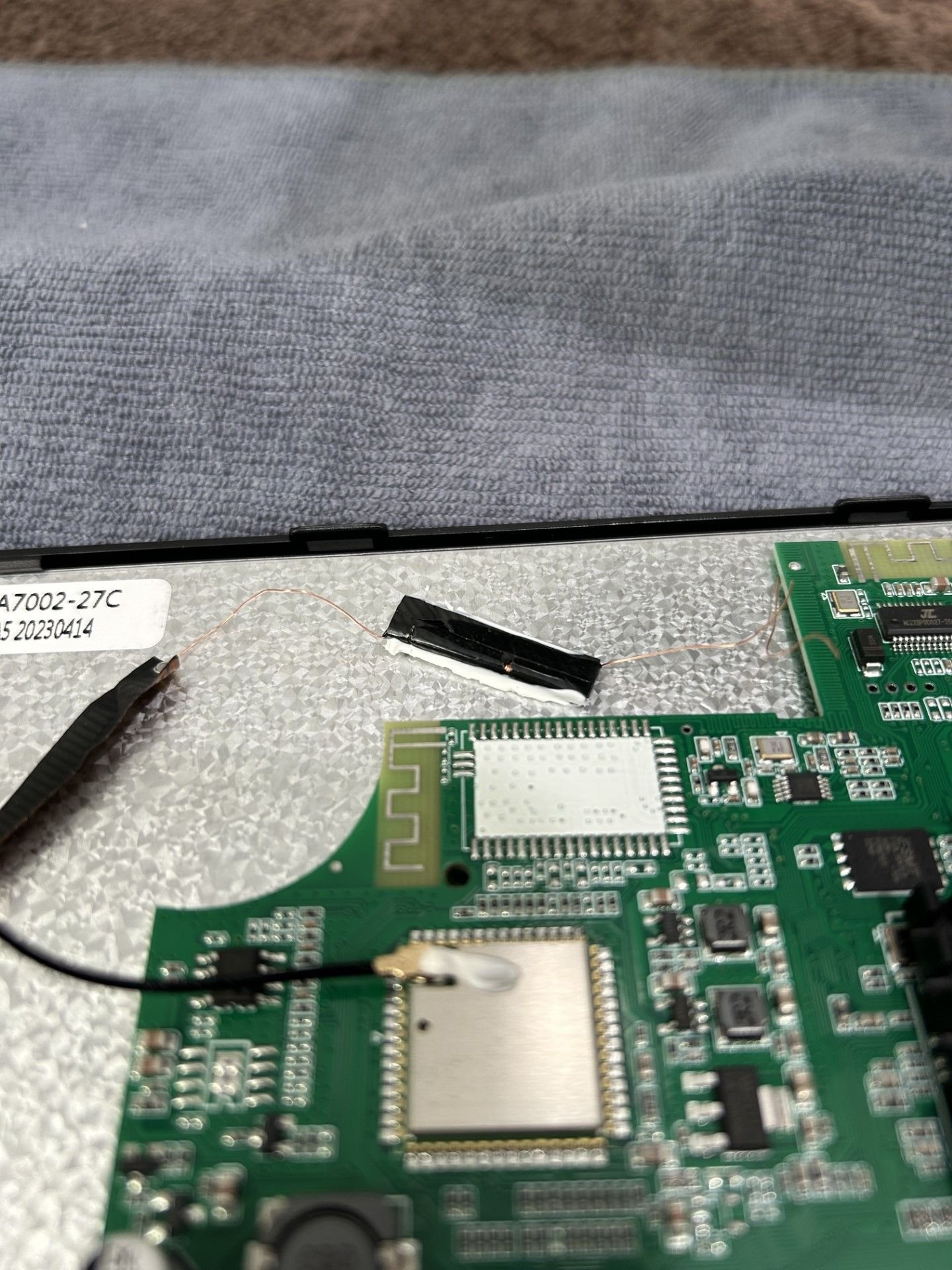

2. Bluetooth Receiver Relocated
I had to peel up the antenna, which was stuck with adhesive and relocate it to a more functional location.
3. FM Transmitter Relocated
The antenna’s cable was a very thin piece of copper wiring, which was glued to the back cover. I had I had to scrape off the glue.
I broke the wiring during the process, so I ended up soldering a new wire to the antenna instead at FMANT connection on the PCB board.
4. LED Indicator Light Removed
I unsoldered the light and cut off the black housing. This removed some of the height.

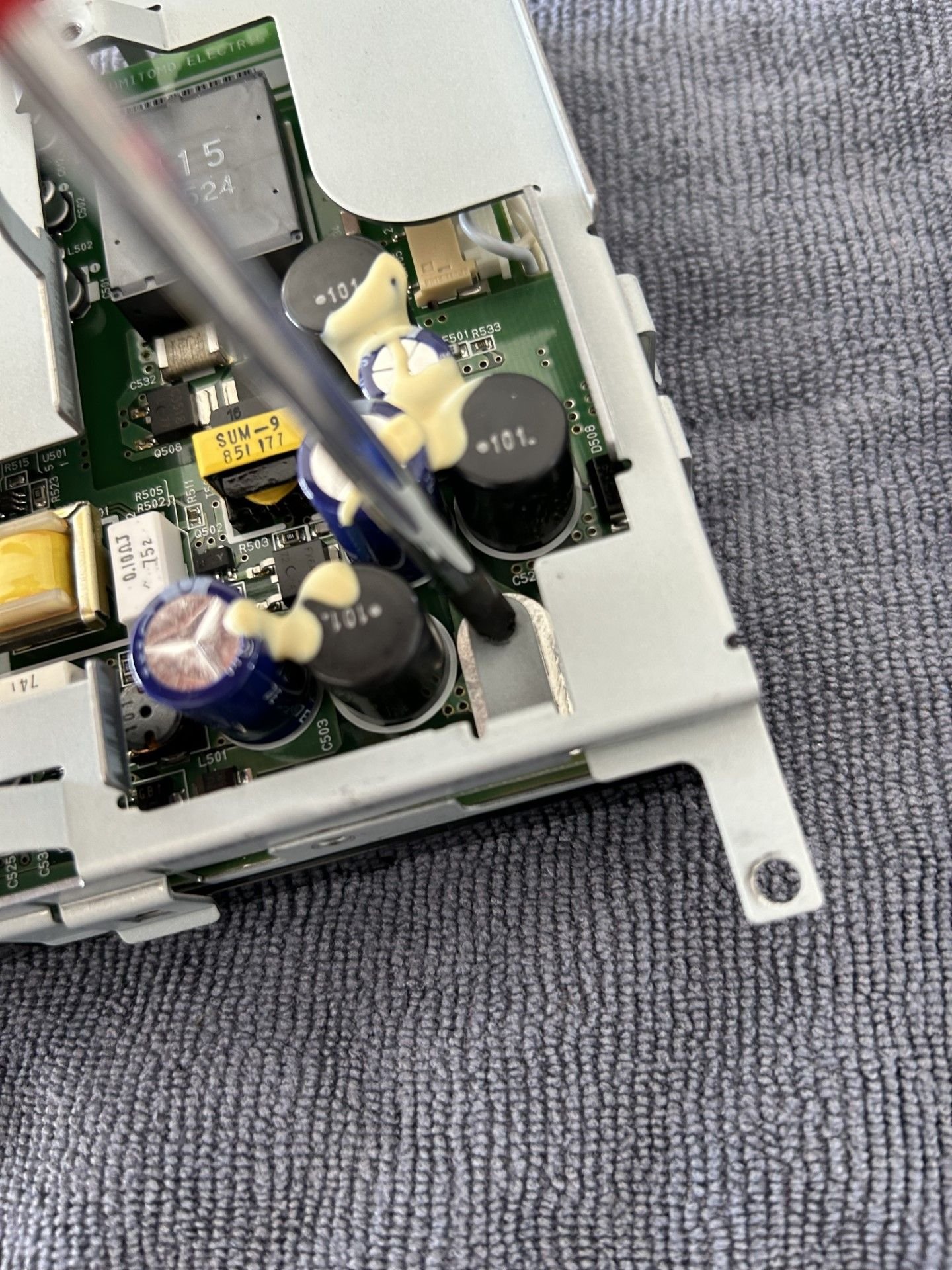

5. Capacitor Relocated
I had to unsolder the 90-degree elbow leads from the capacitor and extend it out 180 degrees to make the unit thinner.
6. Covering Fake Power Button Hole
As I stated previously, many of these companies use the same Chinese manufacturers for their internal components. With the back cover removed, light could be seen through a hole in the plastic, where I assume a power button can be installed. As such, I covered this with a small piece of furniture pad foam. Even with the foam, the hole could still be seen.
7. Cutting
I also had to cut the extra solder leads from the OEM navigation board. As I sated, this unit is thick, so every mm counted.
Here is the final result before installing the OEM navigation board on top.
Below are a few pictures that depict how the entire unit looked assembled before going into my TL.

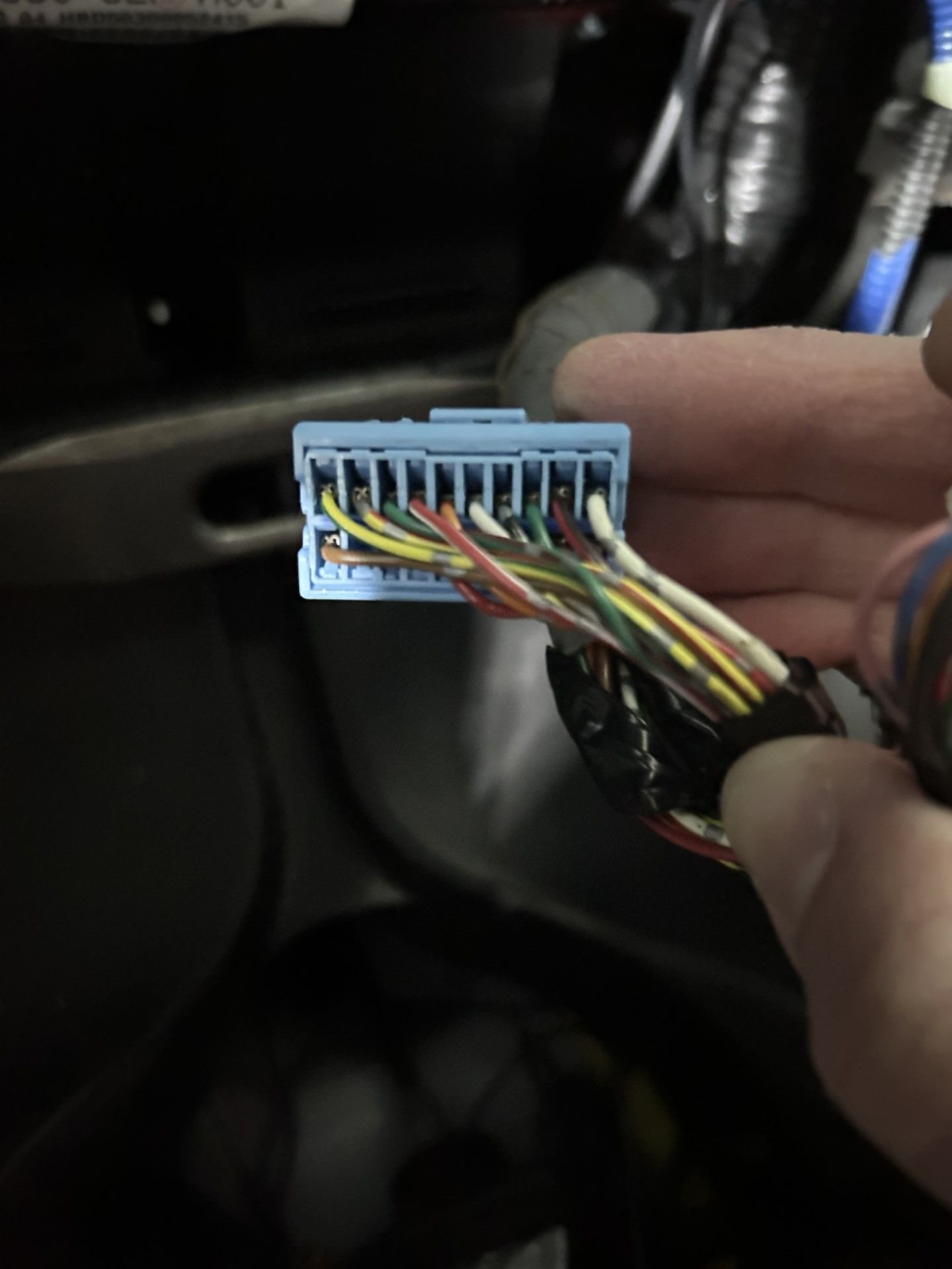

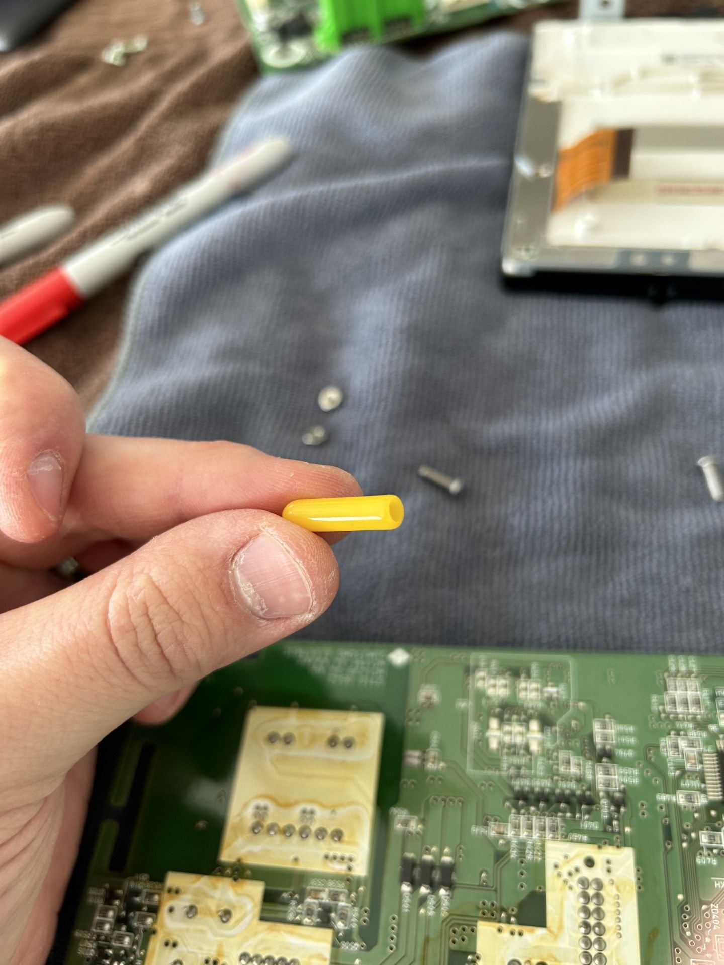

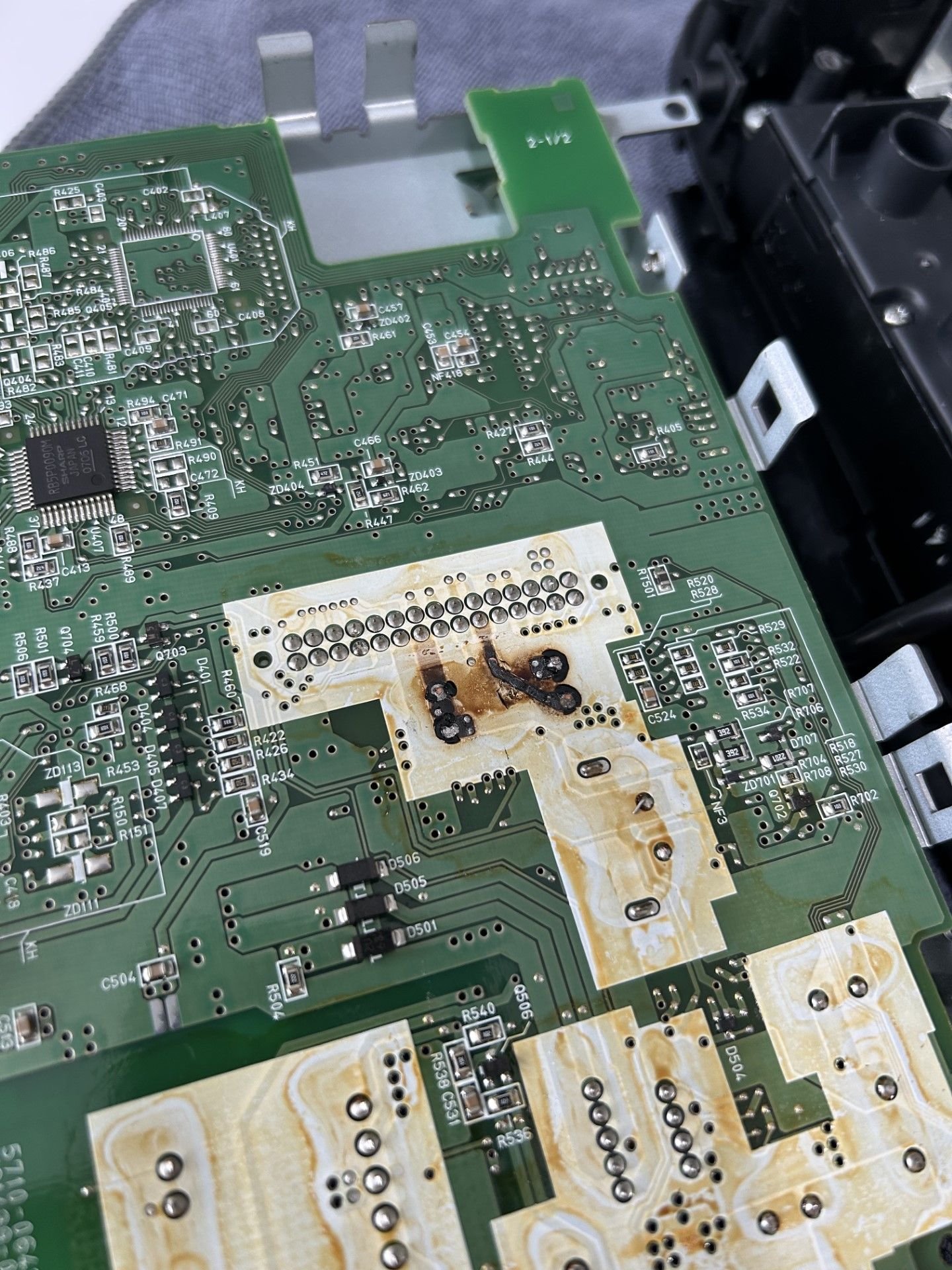

D. Electrical Hazard
After only a few drives, my Carpuride unit stopped working and I saw smoke coming from my dash. My HVAC controls stopped working, my radio went out, and so did most of my interior lights. Fortunately, I was pulling into my driveway when this occurred so I was able to quickly turn off my Car. I began smelling burning rubber and disassembled my dash quickly. After about 20 minutes, I was able to identify that the source of my issues was coming from behind the Carpuride unit.
That little black box on the back of the Carpuride PCB board was scorching hot. It got hot enough that it burned my OEM navigation board and melted several electrical components.
When I re-installed my old navigation screen, nothing was working so I purchased a replacement navigation board. When I received the new board, the system was working, but it was quite sporadic and the screen was now green. If I moved some wiring harnesses around, I could sometimes get the screen to turn back to normal. However, it wasn’t consistent, so now I had to diagnose which wire came lose (a whole separate problem.
Long story short, I actually found an issue with two of the wires form Martin Pan’s navigation harness. The pins were broken, so I had to fix them, which I accomplished with a new radio harness from a Type-S radio that I pulled from the junk yard.
Wohoo! the navigation screen was back to normal!

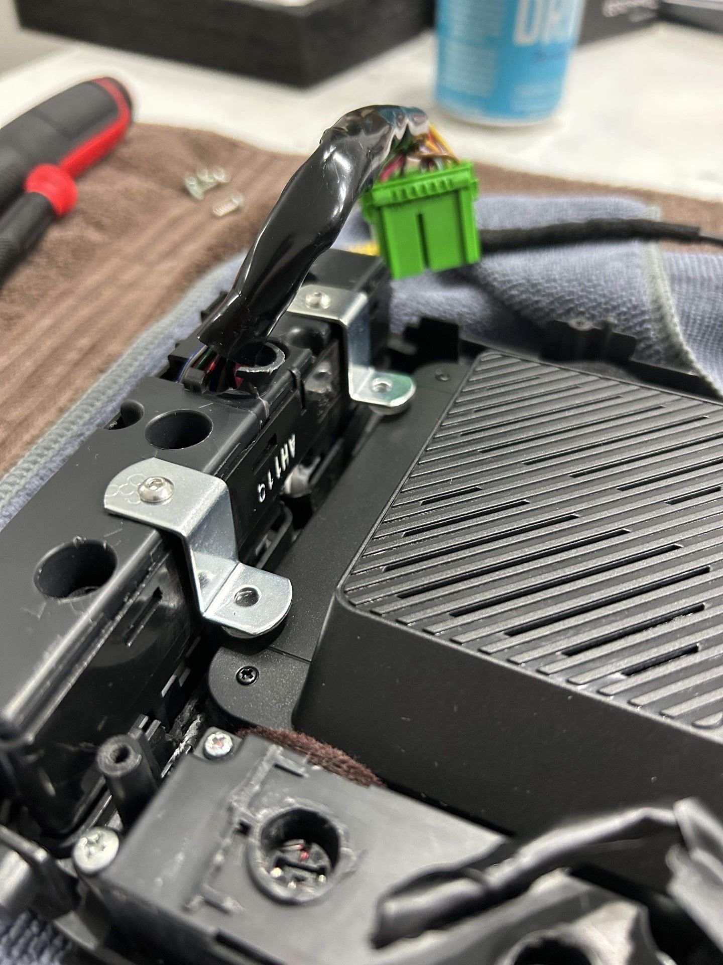

E. Carpuride Screen Mounting (Second Attempt)
After discovering that the Carpuride unit was too thick and could not be installed with the OEM navigation board, I decided that the only logical option would be to install the Carpuride unit by itself, giving it more room to vent properly.
I forgot to take pictures of this step, but I essentially centered/ the unit inside the navigation bezel by cutting and sticking furniture pads along the edge of the bezel. Then I drilled four holes in the back of the OEM metal casing, so that I could install 4 bolts with vacuum caps. I also cut out a section on the backside of the metal casing so that the cords could feed through more easily.
I installed a Carpuride unit in my wife’s 2007 Acura RDX as well. Below are a few images of that setup, which is the same process that I described above:

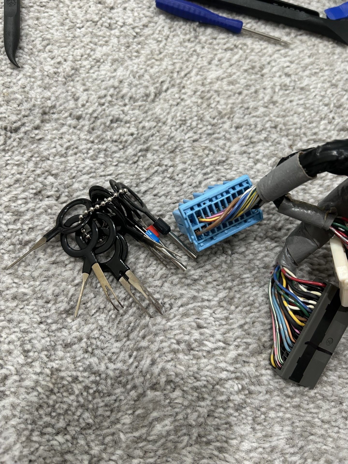

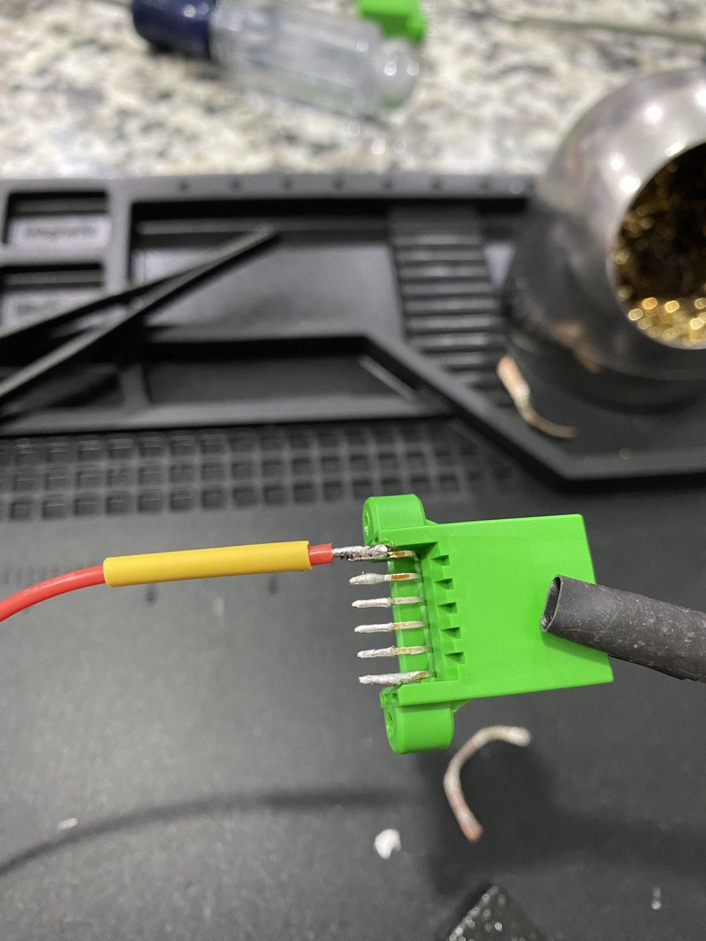

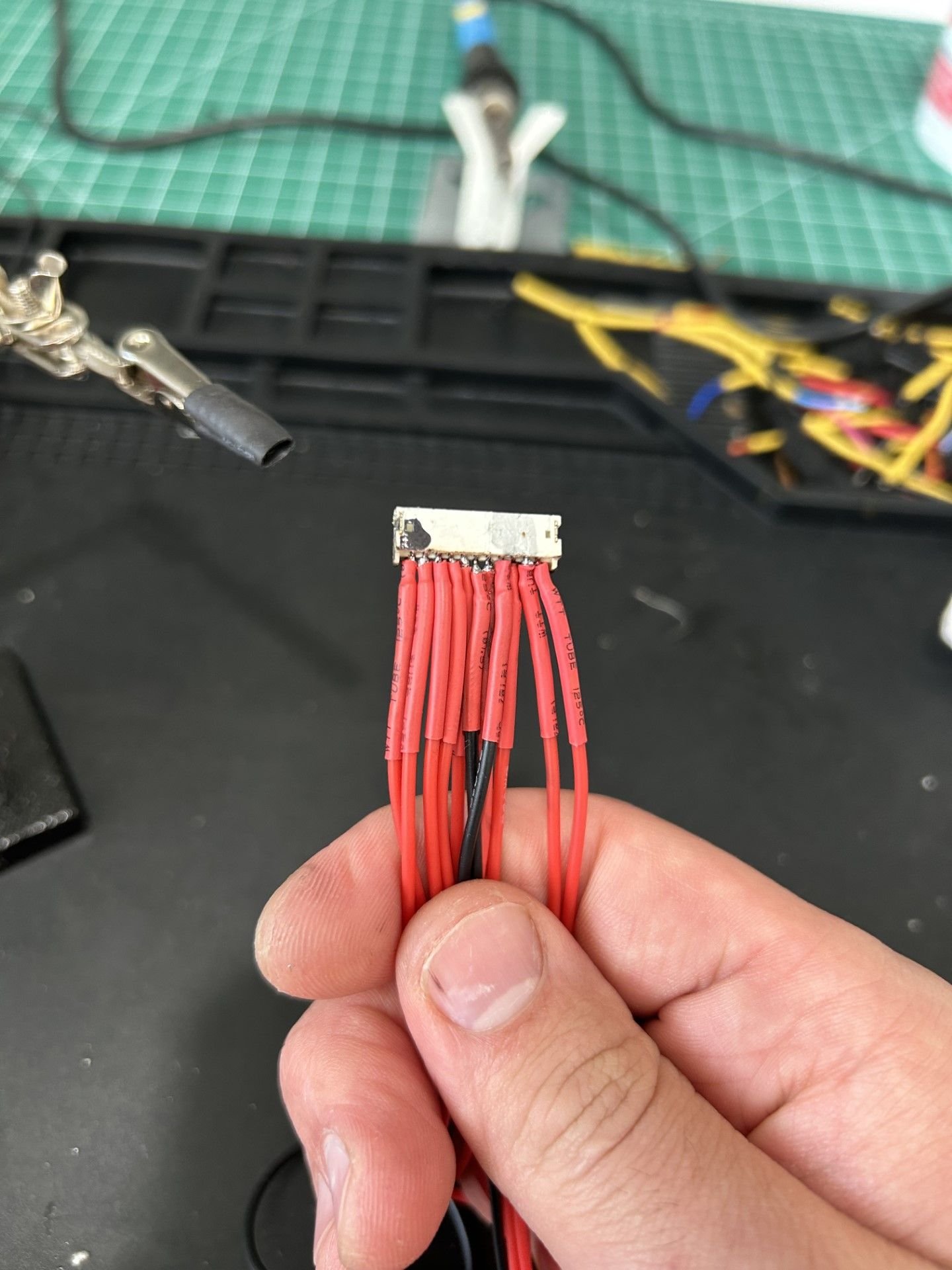

F. Navigation Screen Re-Routing
Now, in order for this method to be successful, I had to find a new way to install the OEM navigation board. The solution that I came up with was to make custom extension cables and re-route the navigation board to my glove box.
Using lots of spare cables and PCB connectors that I gathered from the salvage yard, I did exactly that. Now I have the option to plug in that OEM navigation screen when needed for any sort of troubleshooting.

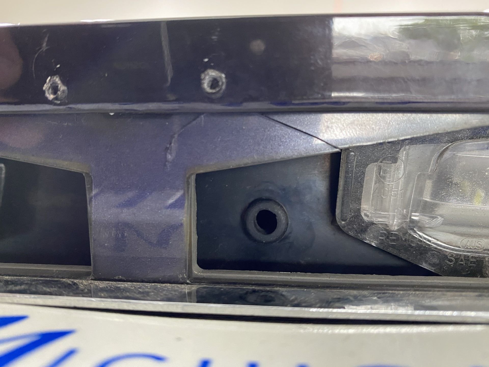

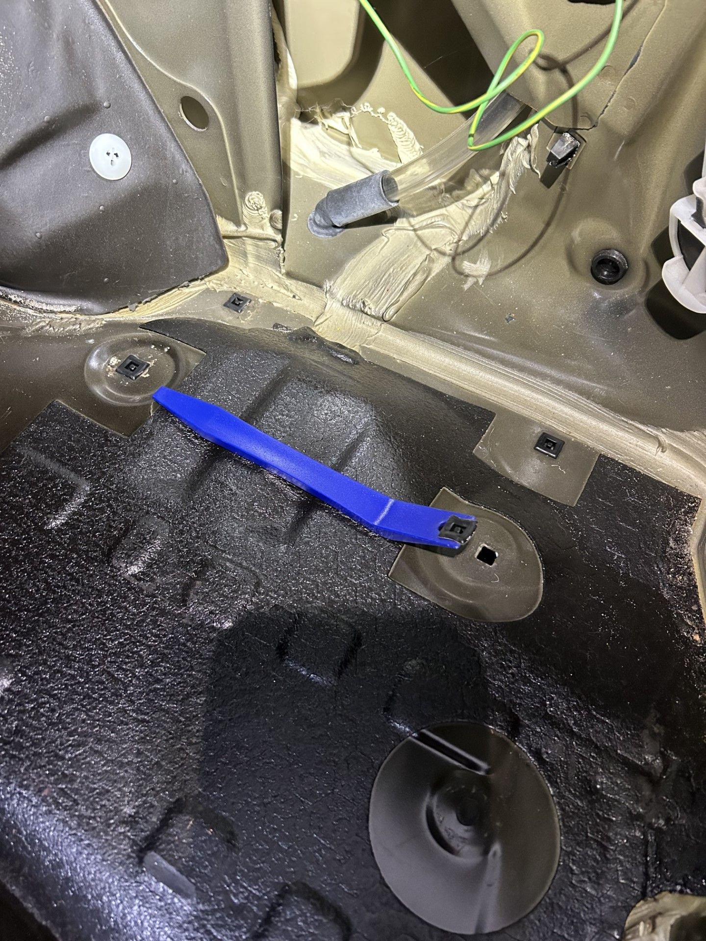

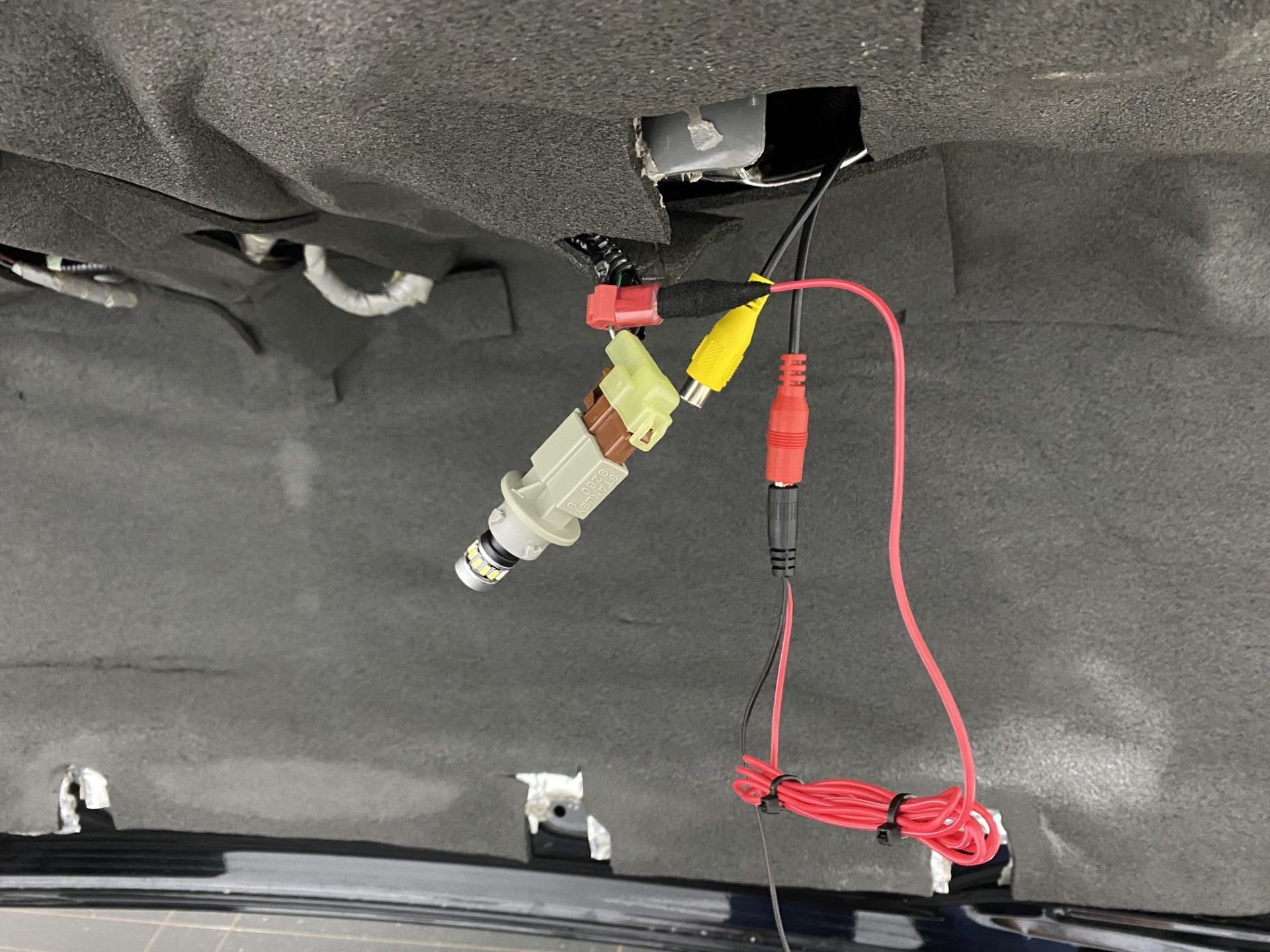

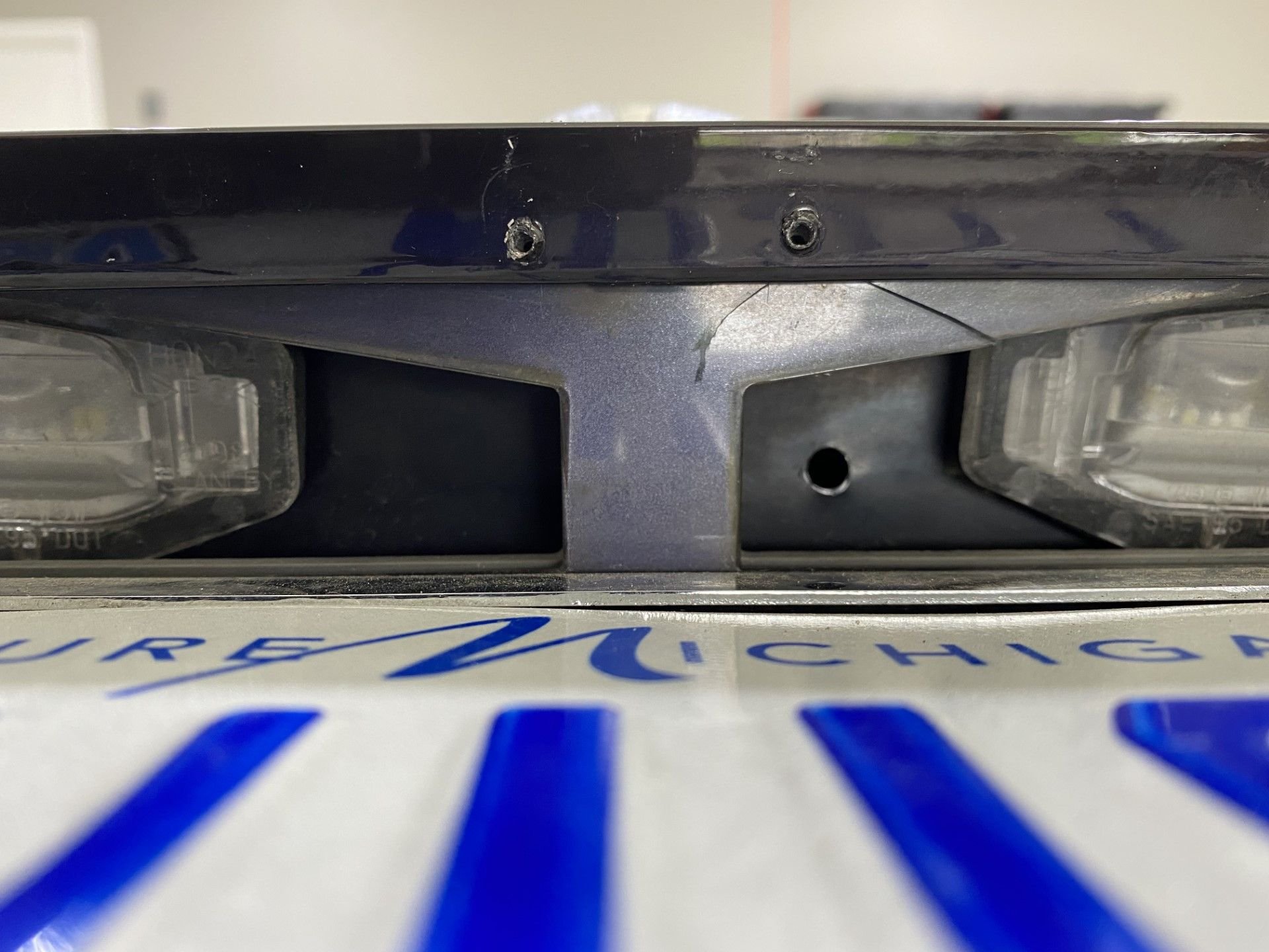

G. Reverse Camera
When I was modifying my TL for my nexus 7 project, I installed a reverse camera. However, I will be replacing this with the camera that I documented in my layout.
I have a tiny rust bubble forming on the lip of my trunk lid, so this setup is temporary. When I purchase a new trunk lid, I will be installing a 2007-08 license plate trim that comes equipped with the OEM cutout for a reverse camera. I have a few spares in storage. I just haven’t gotten around to installing them.

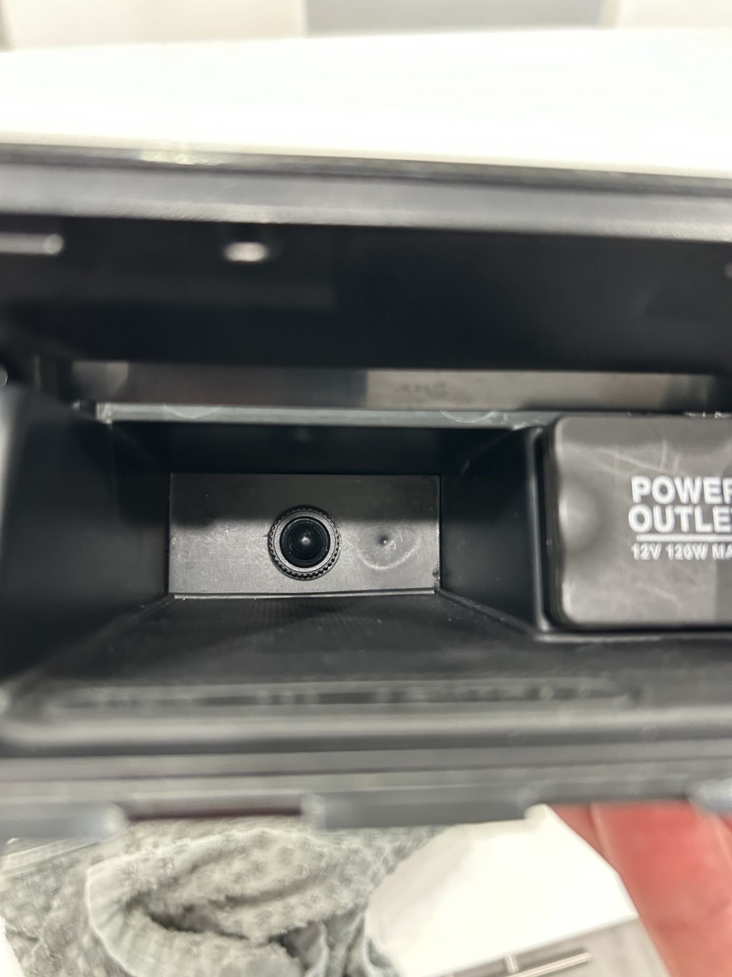

H. Microphone
I mentioned earlier that I wanted to use my external iSimple microphone. For several years, I had that microphone clipped to my sun visor. However, moving forward with the goal of maintaining a 100% OEM look, I decided to purchase a different microphone that fits the same shape and contour of the OEM microphone in the map light bezel. I spliced and added a JST connector to both ends for an easier installation.

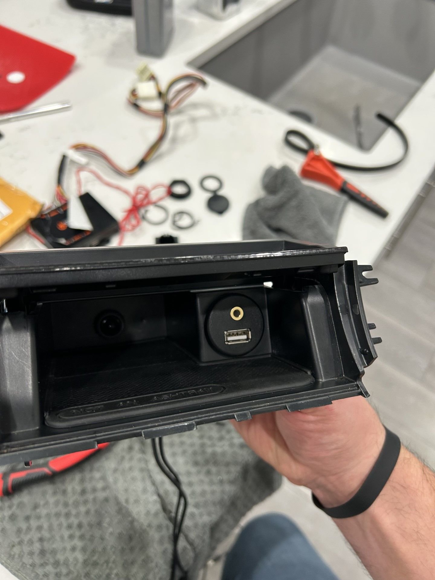

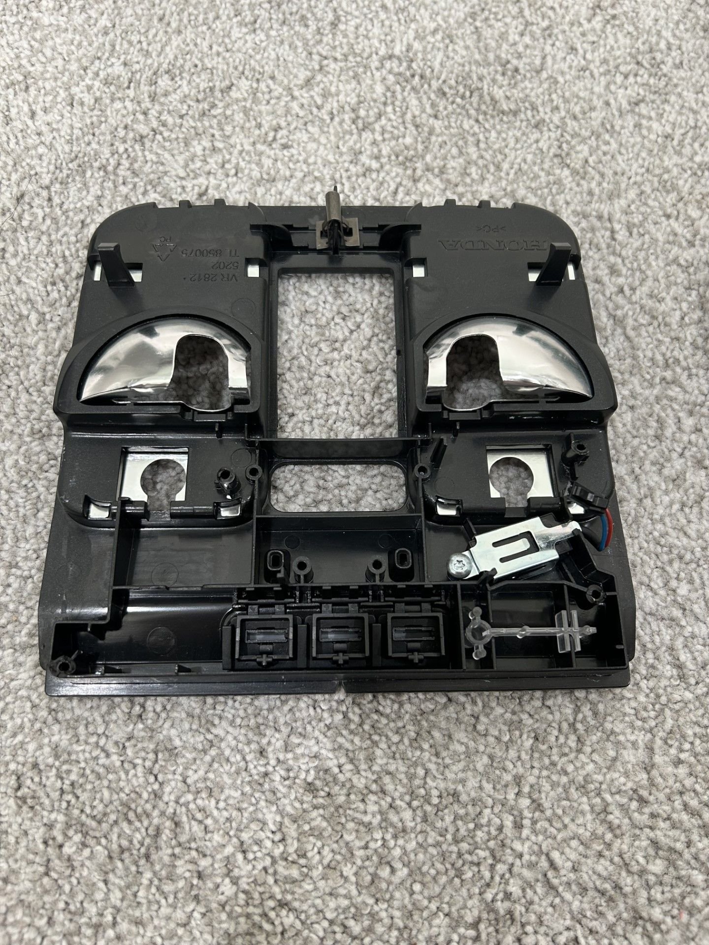

I. Toggle Buttons
Because the Carpuride unit is mounted behind my dashboard, I don’t have the access to the unit’s power button. Therefore, I wanted to add an external button in case I needed to restart the unit or if I wanted to turn it off while driving. To accomplish this, I decided to route some wiring from the cigarette power adapter to a toggle button in the lower cubby compartments.
During this step, I decided to add two more buttons:
First toggle Button: On/off power button for Carpuride
Second Toggle Button: Reset button fir iSimple device
Third Toggle Button: Unused for now
While the lower cubbies were apart, I also decided to re-route my iSimple Aux and USB cords. I implemented this setup in my wife’s 2007 Acura RDX quite some time ago and it gives it a nice OEM look.
You may notice that I had to install a water bottle cap to be used as a washer. The nut that holds the aux/usb port in place kept hitting the cubby because it was so tall.

J. Steering Wheel Controller
My future plan is to hardwire the Carpuride SWC and remap my HandsFreeLink buttons.Below are a few pictures of tests that I performed when I opened up the controller and tested the step down converter.

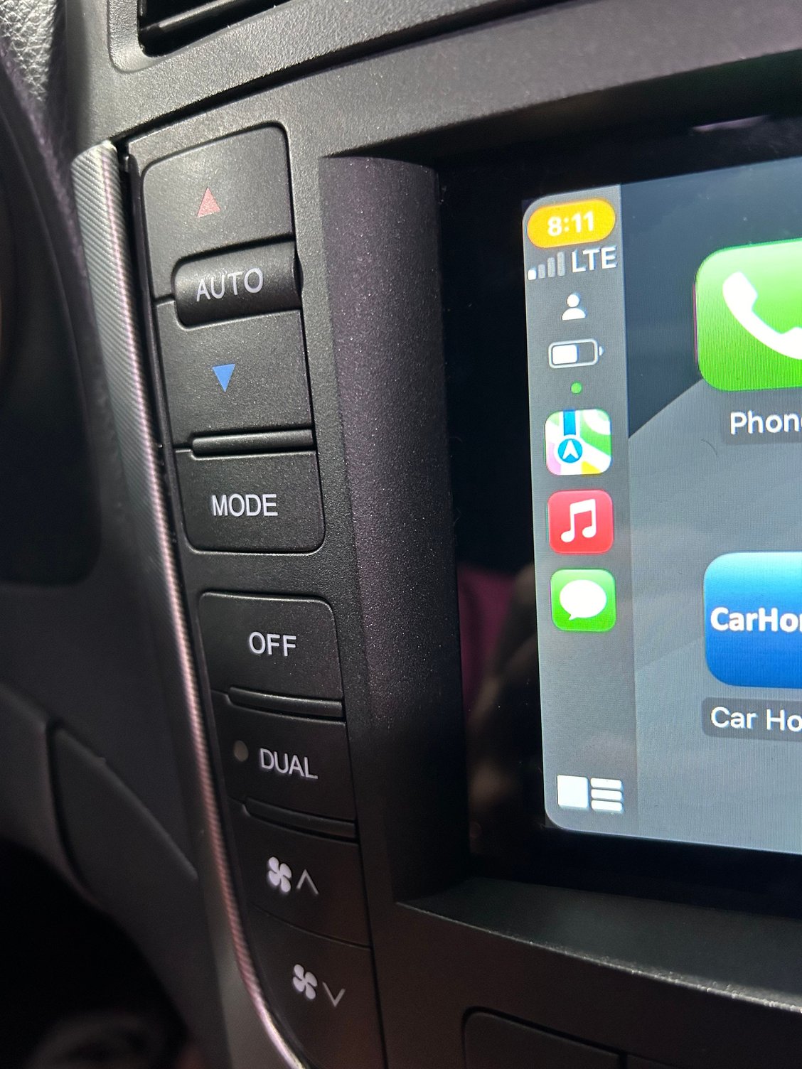

A couple closeups of the screen fitment

To clarify, I'd like to share the following hyperlink, which should be used if anyone would like to order a custom W701 screen protector (i.e. without microphone hole) from ScreenShield:
https://screenshield.us/pages/custom...1-3c8b66611d2e

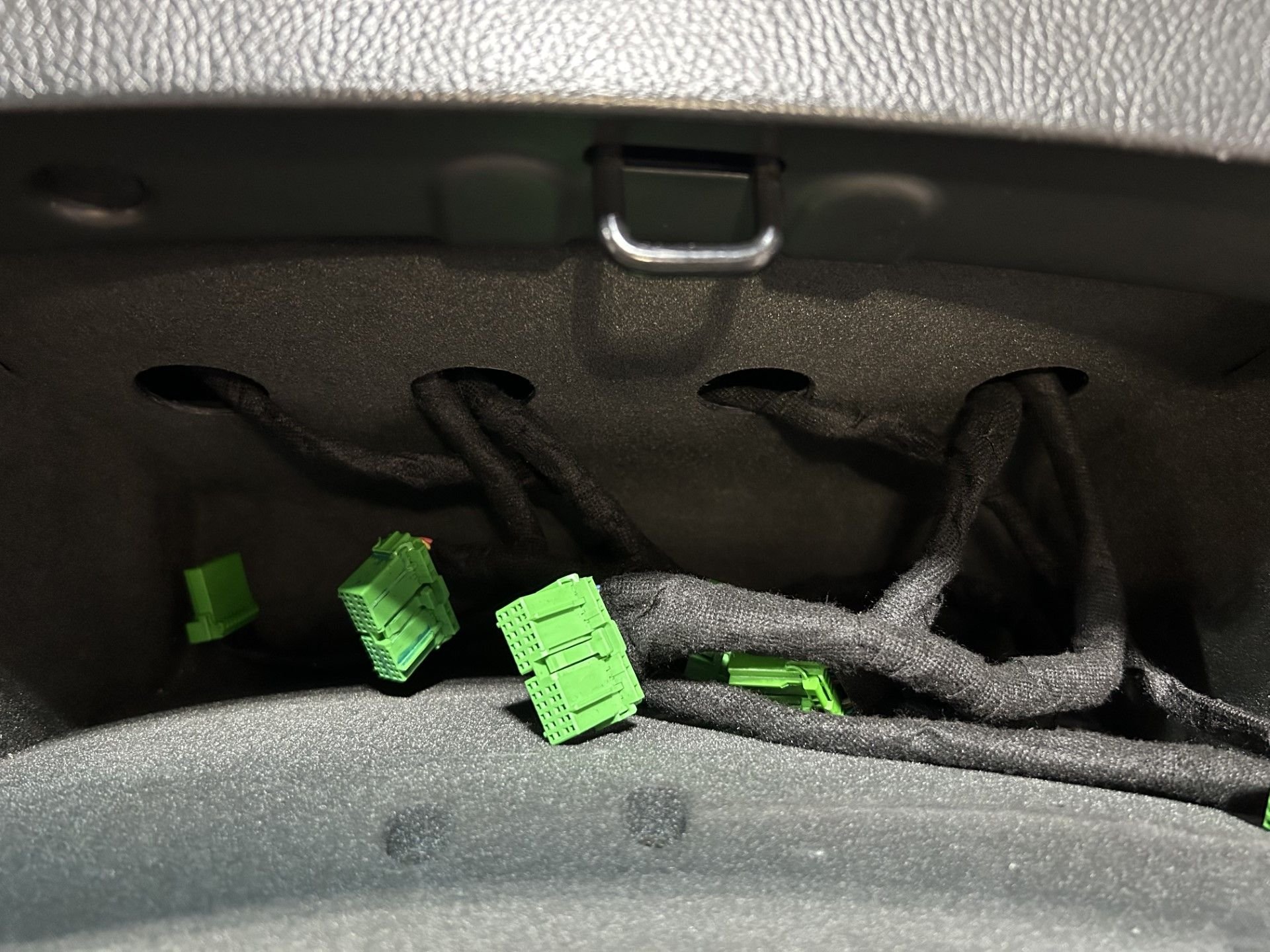

Posts: 7
Is the OEM navigation board mounted a specific way in the glove box or is just loose in there? Do you think the custom cables for the board are something that can be done by a local electrician shop?
Old Aug 18, 2024 | 11:13 AM
wusty23jd's Avatar
Joined: Apr 2015
Posts: 1,296
Likes: 257
From: Grand Rapids, MI
The screen is not mounted to anything. The screen and wiring harnesses are snug enough inside the give box to keep it from rattling around, especially because the interior is carpeted.
you could try and find a local shop to do this, but it might be a bit of a niche market.

As an update, I finally got my steering wheel controls to work with the Carpuride unit. I remapped/repurposed the HFL buttons on my steering wheel. I will post pictures when I get more time. Stay tuned!
