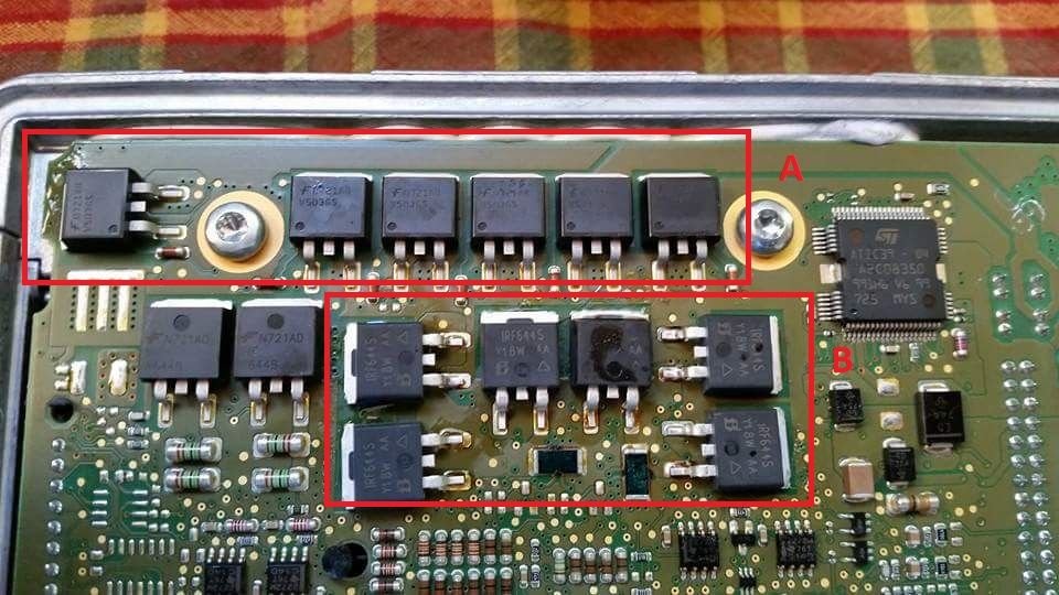

Door locks are controlled by MICU, and internally it uses couple mosfets (transistors) to switch positive/negative signals to supply power to actuator's motors.(basically an H-bridge).
Most likely one out of 4 mosfets burned out, and that's why only one function doesn't work.

MICU is build-in into the under-dash (interior) fuse box. Fuse box and MICU is one part.
And if somebody is interested in replacing only the broken part, then most likely one of the mosfets went bad.
I replaced couple of them in BMW ECMs, but in that case mosfets were responsible for driving ignition coils.
Easy enough if you have soldering iron and some practice.
Those guys are those square/rectangular black three or two legged things, although mosfet on the MICU might look much smaller
Or something like:
If you have wiring diagram and connector pinout, one could figure out traces on the PCB and track down the potential culprit.
But then for $50 why bother? I would with my car but probably not with client's - too much work getting MICU out, figuring out what went bad, ordering parts, and then most likely putting bad MICU back in to wait for parts to arrive.
But with those BMW ECMs problem was common enough for shop to have bunch of those guys in stock (and they are like $1 a piece or so), so full repair usually took hour or so.
