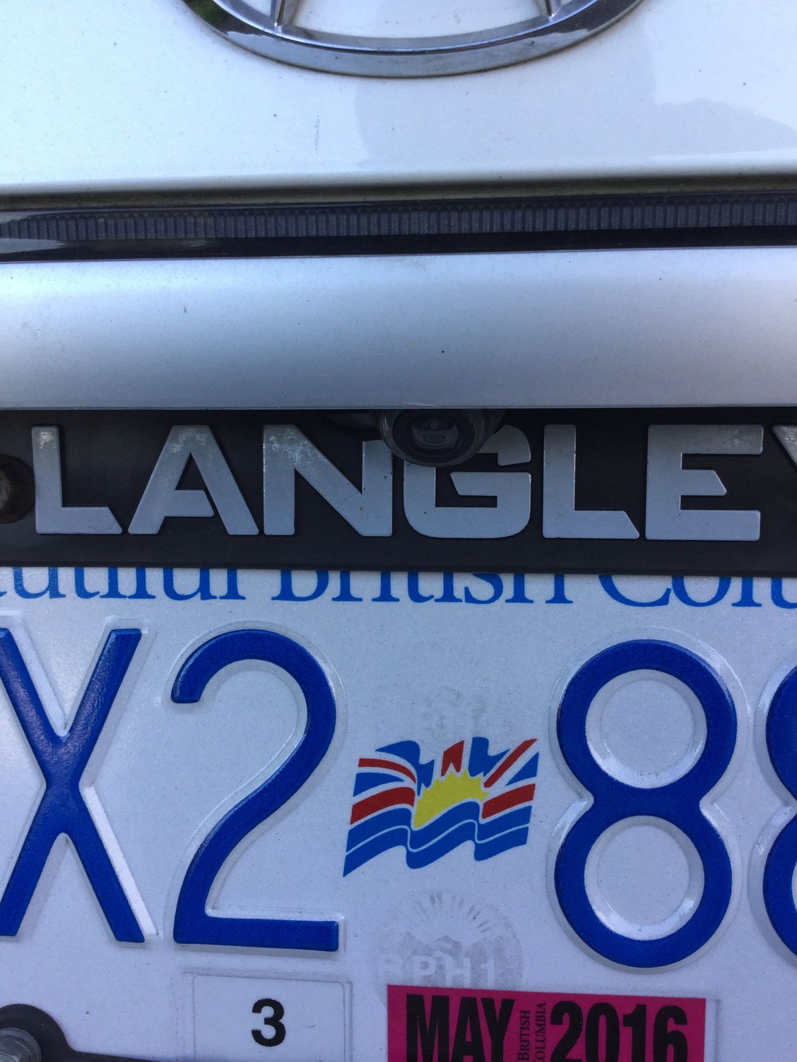

It is quite small, I actually replaced one like the other one linked in this thread.
