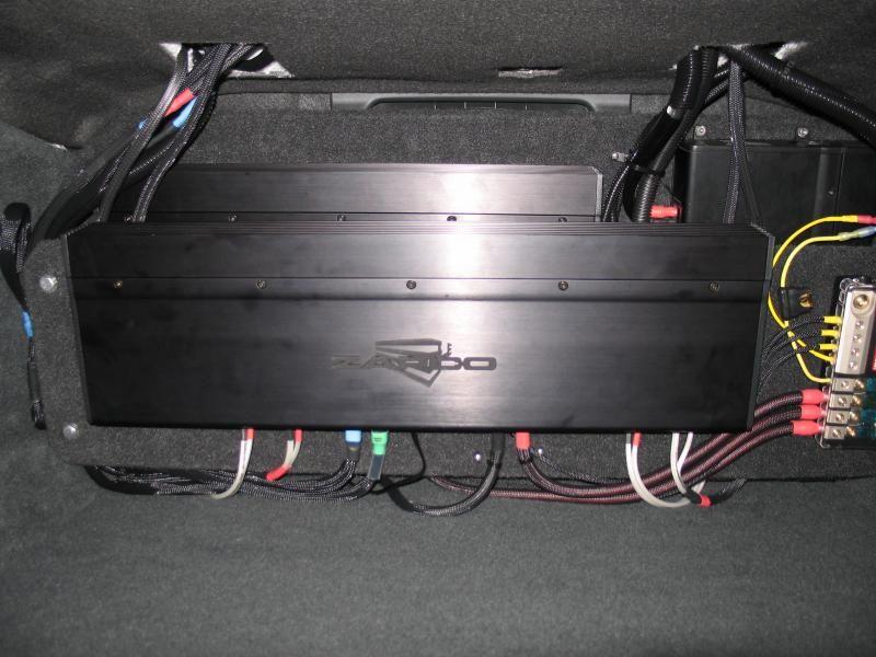

Just to add some more for you to consider; you should decide if you want to enjoy multichannel music or if you are going exclusively with 2 channel. The TLs have the pretty cool DVD-A capability and I find that I enjoy the discs that I have. I saw that your disc changer crapped-out so maybe you are going to pass on the DVD-A capability.
Because I wanted to have the multichannel setup I was not going to be able to fit my equipment under the seats so I went with a trunk setup:
Most quality amps will have balanced inputs and most will also have selectable single ended inputs as well. Just make sure that you follow the amp's convention for balanced input wiring. There is an installer in the Silicon Valley named Bing and he runs Simplicity in Sound; he is the master of high end TL installs and he recommended using a pre-amp from the TL's head unit to run the signals into the trunk area. I chose to go this way and I can't tell you if it was necessary; it's just the way I went.
If you do go with just a 2 channel system then the recommendations about keeping the factory amp for the center and surrounds is good advice. The CleanSweep is used primarily to take out any equalization that the factory headunit applies to the signal. The TL headunit has been shown to have a pretty flat output and doesn't require the CleanSweep for that. If you are happy with your sub setup then you could just go for a two channel amp and you probably could find one that fits under the passenger seat. Use the head-unit's pre-amp output before the factory amp. If you are going 2 channel and you are up for replacing your sub amp then I would recommend getting a 4 channel amp (with 2 channels bridged) and driving the sub from a low passed front L/R signal instead of using the head-unit's subwoofer output. This will give you better ability to blend the subs and your main speakers.

Nice Zapco amps in this install, you definitely know what you getting
