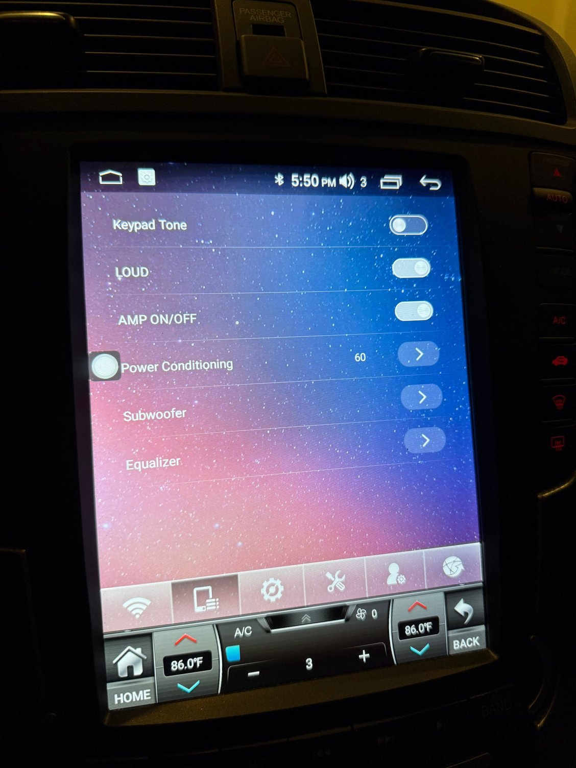

Anyone know how to fix my issue where the volume increases as I speed up then volume decreases when I slow down?
on some newer vehicles I believe this is called “speed sensitive volume” and can turn it off and on in the settings. I’ve looked through all the settings and can’t find a setting that resembles this feature. Anyone know if there is a setting I can turn off or a way to fix this?

Can anybody update:1. is there any new wireing available which improves old units (someone mentioned below testing new wires but haven't sum up)2. To update the temperature app/ driver do I have to update the all firmware (which I would like to avoid not mess up) or there is individual file I can replace. And if there is one file what is the name and where I can find it
IT seems the thread died like the responsiveness of the Navi seller in the past 😂😂😂
Few days ago I was thinking about increasing this feature 😀 but I couldn't remind the settings pass. However I'm sure the feature setting is there 😀

It is in Polish, however the setting you are looking for is the one in the bottom 😎

Thanks for responding. What’s weird is I don’t have that very very last selection as you.
i have equalizer though? I looked through equalizer, I don’t really see anything there either

🤔 strange. Differences in software. That makes me wonder it this setting really works. Maybe they removed it as it did nothing 😂😂😂😂
Will check it during next highspeed trip.

Checked. The feature seems to work.
