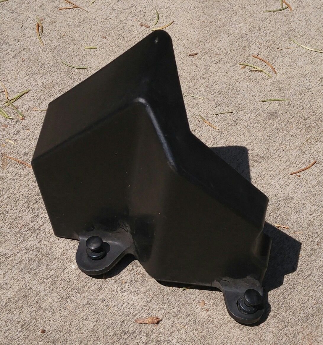

Hey People
I found this cover sitting next to my spare tire in the trunk. Any idea where it's home is? There are no PNs stamped on it. For scale, it's about the size of my hand.
I would appreciate if anyone could tell me where it belongs.
Thanks

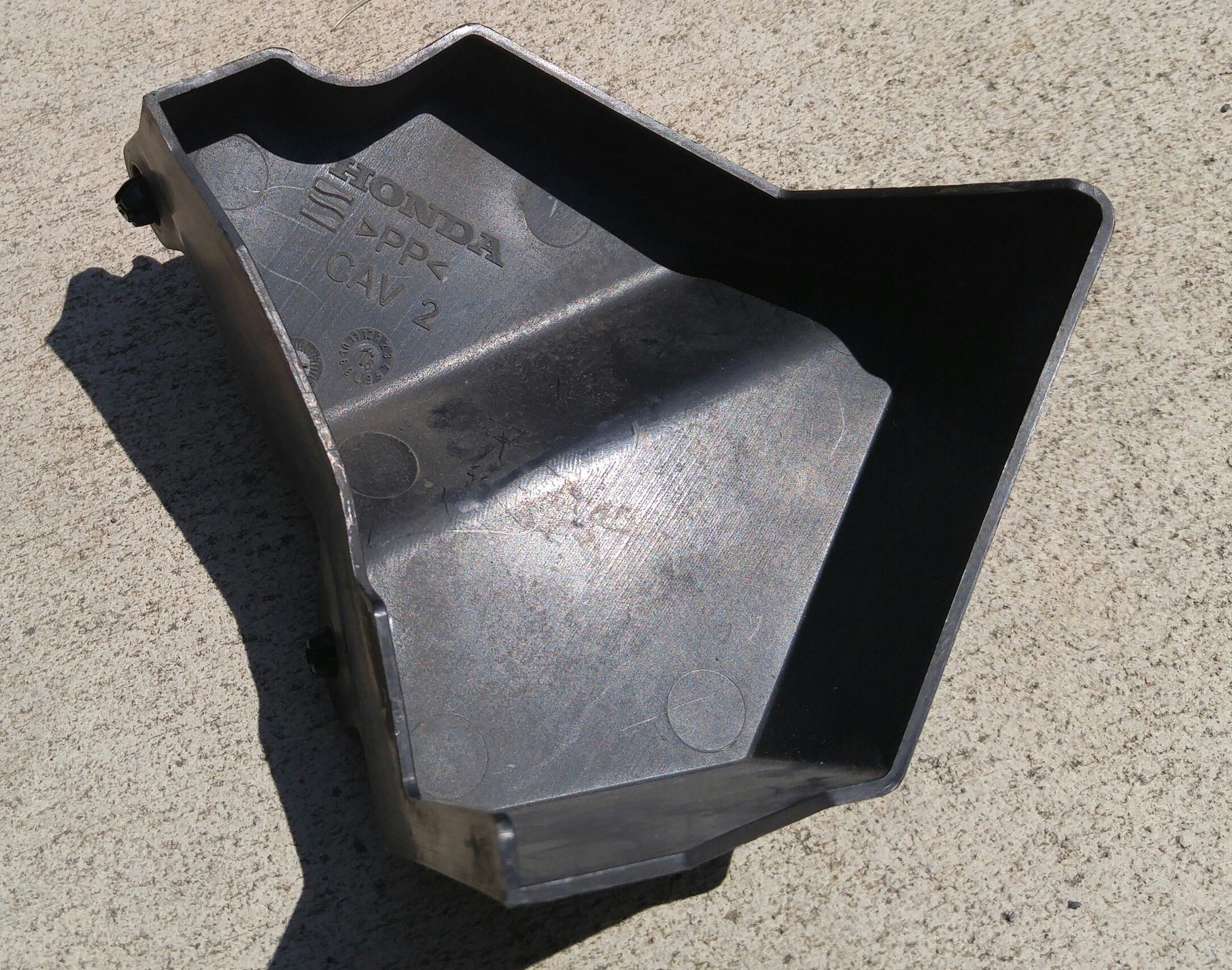

2008 TLS6 rocker splash shield, Lt side.

it goes in the behind the headlight and if I am not mistaken the two clip goes on the radiator support.

Thank you.

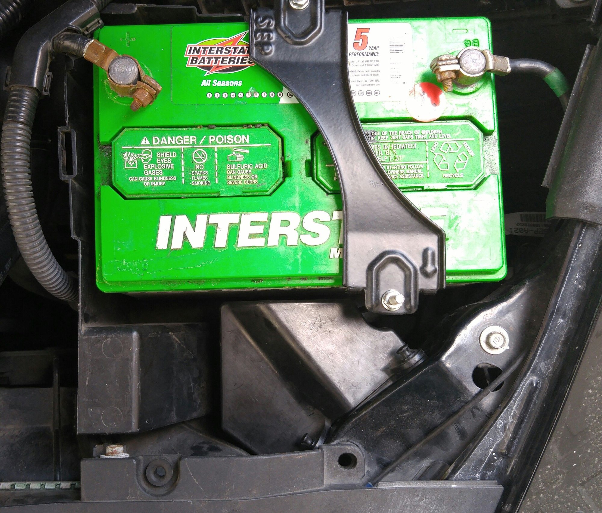

Thanks to your help, it's now in its home, on the LH side, just forward of the battery.
Thanks Again!

If you have an aftermarket intake, that piece isn't necessary. It's there to help better divert airflow into the stock intake piping. Weight reduction!
