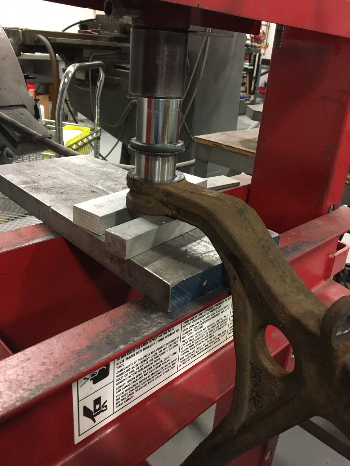

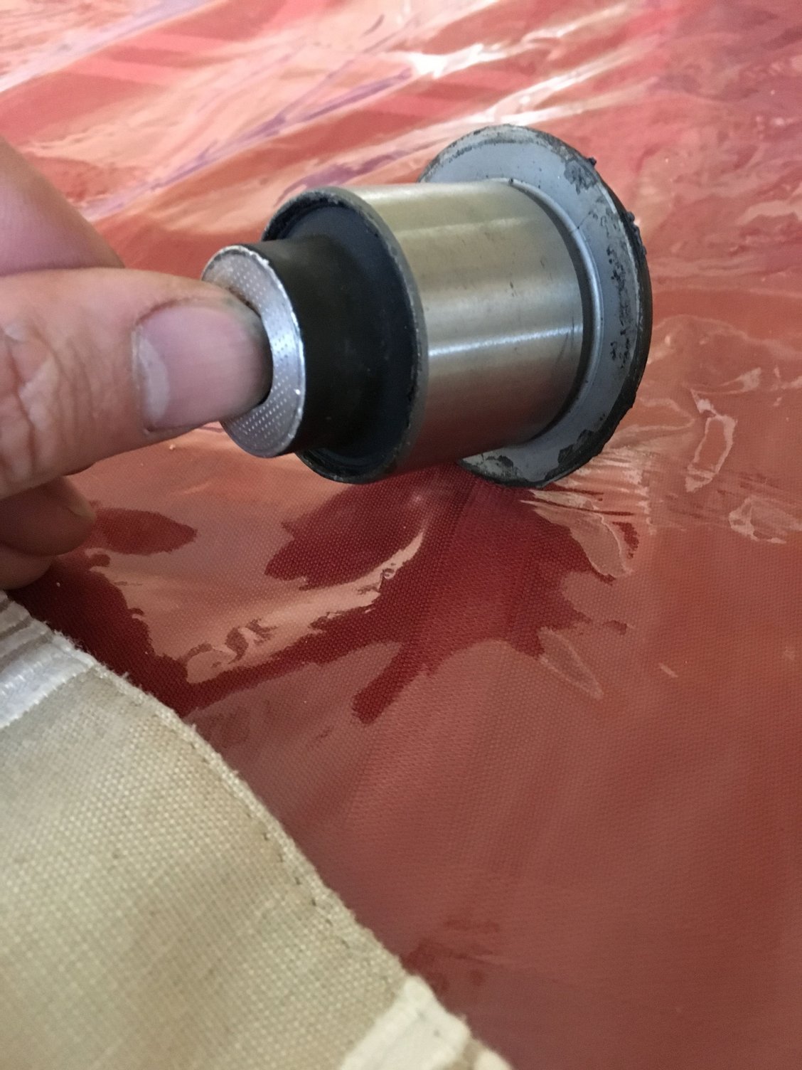

I am redoing all the bushings in the front lower control arms. The one has a metal lip with rubber in top. How does one press this in without damaging the rubber?

There is no plastic part. For anyone doing this in the future, it was a pain getting the old one out. I had to cut the flange off in two places so I could press it all the way out.
I then used the same size socket that I pressed it out with to press the new one in. It deformed the rubber and may have marked it up a little but there is no other way I could think of.

I did this myself not too long ago. I initially tried doing the socket method but it started to cut into the rubber. I switched over to a large washer that basically covered the entire rubber portion and that did the trick. The rubber definitely deforms a lot but there was no damage afterwards.
