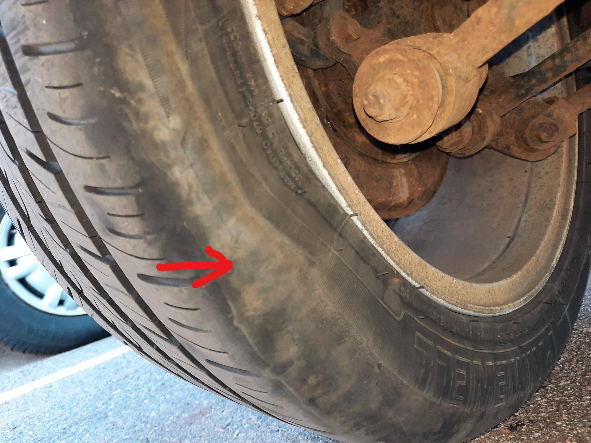

I pumped that tire with leaking valve to 48psi on Saturday. Max is 51psi. Felled vibrations already Saturday night but big time today, Monday. It turns out that the tire (it is rear driver side) is deformed now and most likely made these big vibrations. Will do photos tomorrow and will replace tire. It was not too old. I do not know why it gave up with me pumping it to 48psi or so.

Replaced that tire and vibrations are gone. Get lucky to spot problem right away as tomorrow morning tire was at 10 psi and would not spot that bump if would check day after. The tire was worn at edges and my guess was that the previous owner drove at low pressure tire for longer time. Was thinking to just replace valve and keep tire, maybe will not deform again but give up on that option. Didn't install tpms as I need not it and would cost 70$.

Looking at that photo I rather think tire collapsed in then deformed out. Watch where is green arrow. It is where air was leaking over night my guess.
