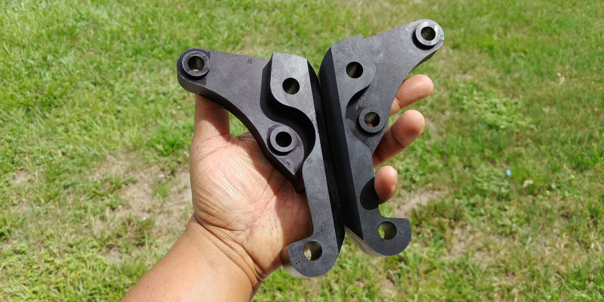

Regarding the rears i have a custom billet bracket that you can mate Tesla/ Camaro SS rear 4 pot calipers on our cars. PM me if interested.
Reply 1

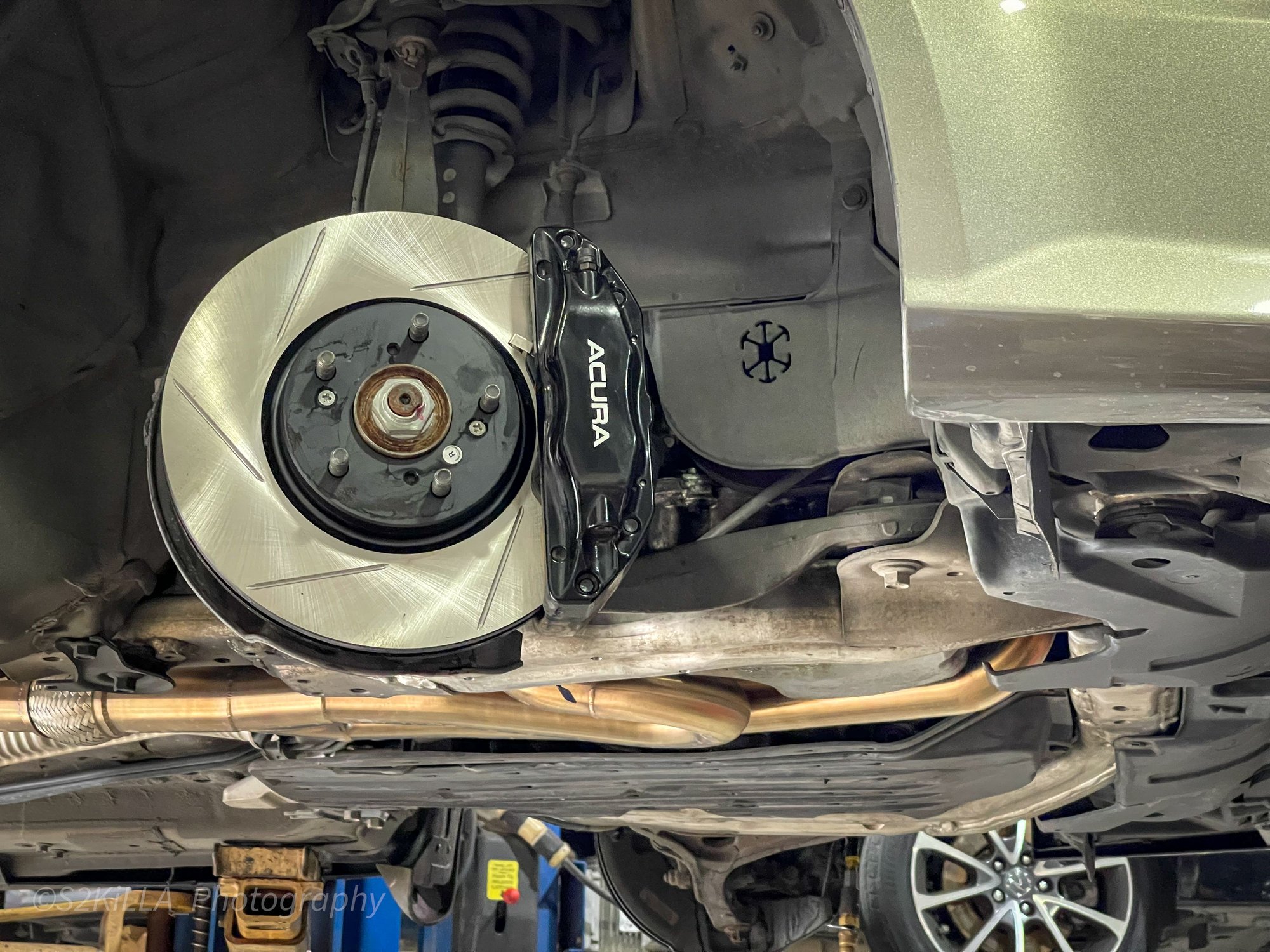

The RB Performance (Racing Brake) slotted/vented rotors are very nice. I've had a set on my car for a few years now. https://racingbrake.com/2108
Reply 1
Jun 22, 2021 | 08:25 AM
beautiful set up
Reply 0
Quote: Regarding the rears i have a custom billet bracket that you can mate Tesla/ Camaro SS rear 4 pot calipers on our cars. PM me if interested.
ill keep that in mind
Reply 0
