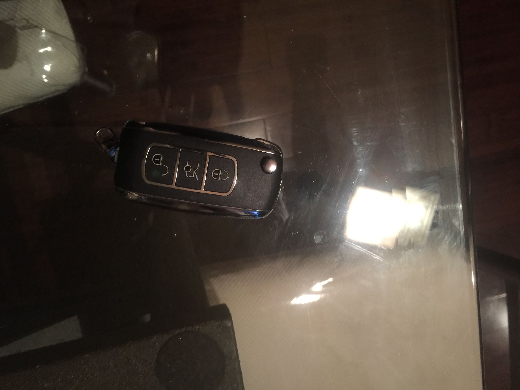

Got a new key and decided to get a switch blade key but
Did not expect it would look this good with so much
quality and one side has Acura emblem
The edges have mesh stainless steel just very cool and
Great looking, like its for a brand new car
Got on EBay motors app, $50 seller artiway
Well worth it! Locksmith cut and program it $30
Way better looking than our gray fobs

post pics!

How do I post pic from my iPhone

Old Nov 12, 2015 | 08:07 AM
Posts: 48,314
looks good!

That is a new style that I have yet to see done on AZ for the 3G. Well done OP. I have the 07/08 S/B key but yours looks great.

OP, the locksmith programmed the immobilizer chip? Door unlock and other buttons all work too? That's cool!

Doors and trunk buttons work and I expected chrome plastic but it feels like metal and with mesh on the sides it's good looking. Very easy to get , just ordered on eBay and a lock company cut key etc and that was it. $50 plus 30

Sure I live in Kansas City and Brandt locksmith off of Wornall street cut it for $1.00 and programmed it for a total $31.00
He did our 2009 Fx35 too. Acura dealer wanted $135.00. Infiniti wanted more. Ordering key was fast and trust me it looks great and feels like quality material

Oh the key has a chip so it's all in one , the fob switch blade and key with chip so just needed cut and locksmith uses a small machine and went out to car then I heard it start , test trunk and doors and that's it.
The one I chose was the nicest looking one on eBay

Is the transponder physically in the original metal key? Or is it in the remote button sender?
I just bought a set (2 each) of the aftermarket identical switchblade keys, and had them cut, and programmed them so now they activate the door lock/alarm. But they are not recognized as driver 1 and the engine just turns over and wont start.
I found a few different "how to's" and followed them. Neither will get the car to recognize the new keyfob as driver 1 or let it start.
Stuck in the driveway for now.........
Any help?
I purchased two, I had locksmith cut and programed them and starts up, locks doors and open trunk Go to a locksmith
