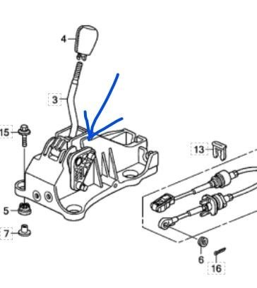

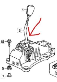

When looking at the diagram below, #3 shift lever passes, outside of the case, through #12 dust seal.
The end of #3, inside the case, then passes through #1 shift arm and held by a #9 special bolt (8mm) not shown.
MT Shift Arm - 2008 Acura TL 4 Door TYPE-S KA 6MT (acurapartswarehouse.com)

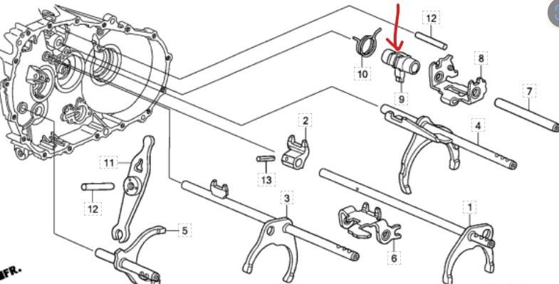

Then it appears, the area the purple arrow points to above on the #1 shift arm, interacts (fits between), the area the red arrow points to below, of the #9 gear shift piece(6MT) inside the case. Perhaps it is this area that is worn? Or the 'tooth-like' area on the opposite side of #1?

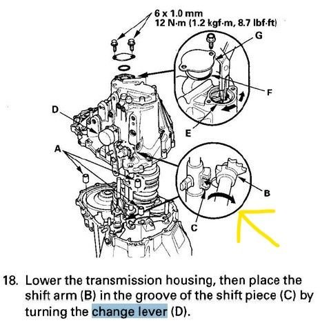

The Helms diagram below shows a different perspective as to how all of the parts interact.
Otherwise, perhaps there is 'play' at the cable connections within the #3 change lever sub-assy?

Looking at the whole structure of the assembly, #1 shift arm and #9 gear shift piece(6MT) is all that is left to consider, unless I'm over looking something.
I'm wondering now if one or both of those components is substantially worn, to cause your noticeable degree of 'slop' / play, whether you would find any metal glitter, in the manual transmission fluid upon draining?
