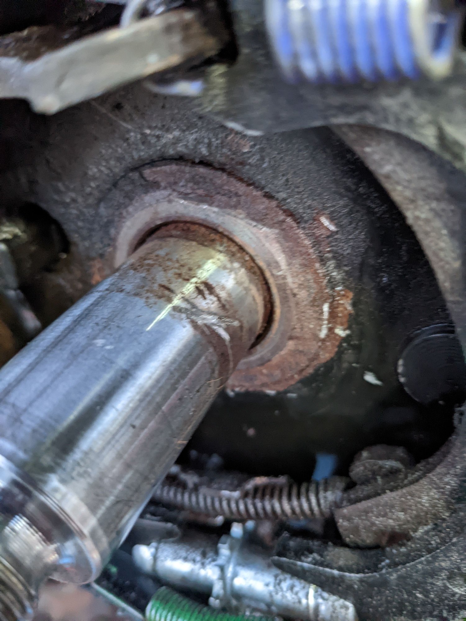

Okay, so the right bearing/hub came off easy but the second I had to grind off half the bearing surface with a dremel because it broke off. The spindle that remains is pretty rusty near the backing plate and I nicked it a bit with the dremel. I'll upload pictures. Can I just fill it with some JB Weld or something? What do I do here?

Replace it...geez. And clean up that mess, too.

JB Weld isn't going to hold up. Get a junkyard/recycler parts to replace it and go with a new wheel bearing. Same for the other side too but hopefully you can get the bearing off. Use some heat to help sweat it off the spindle vs cutting
