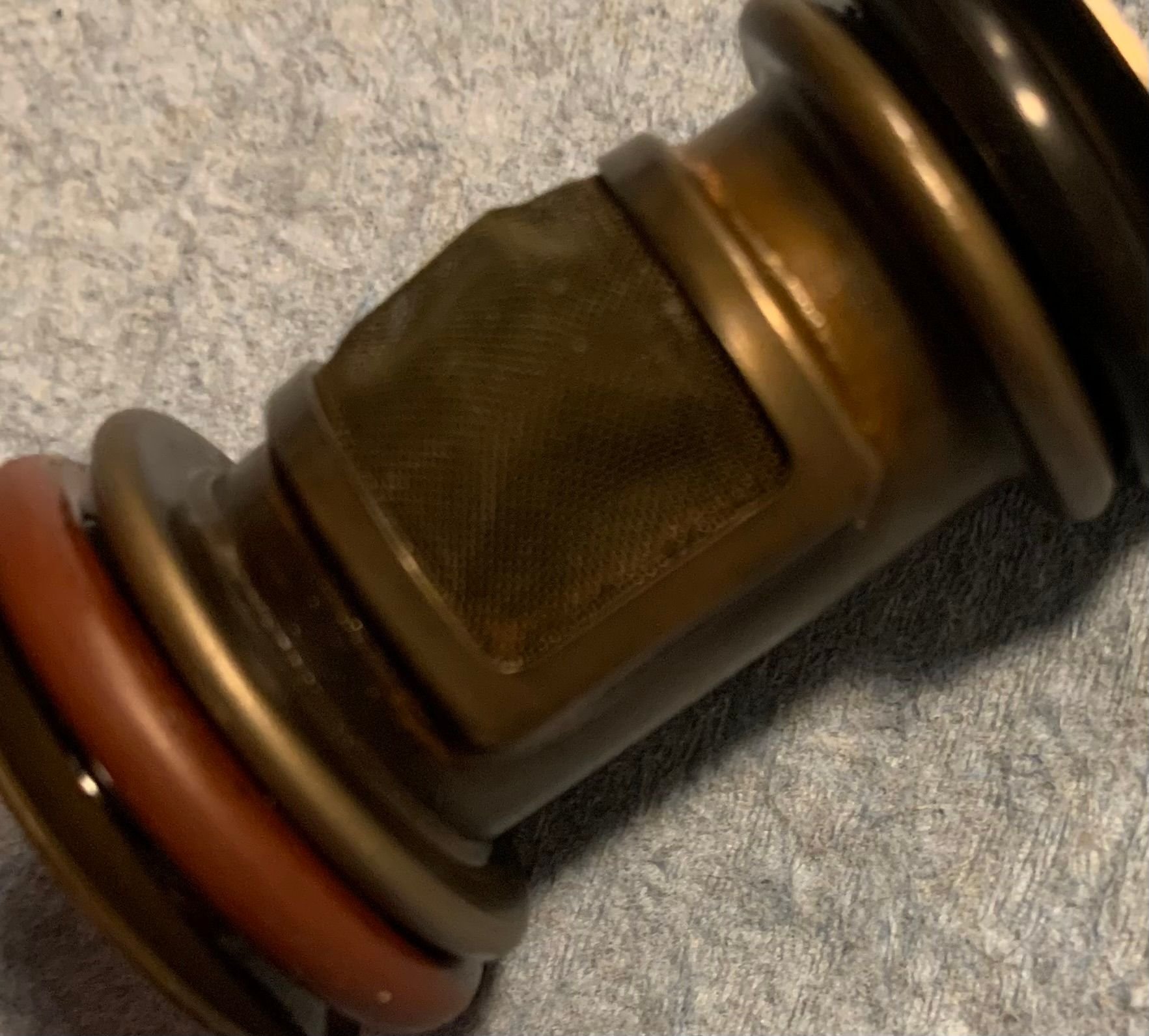

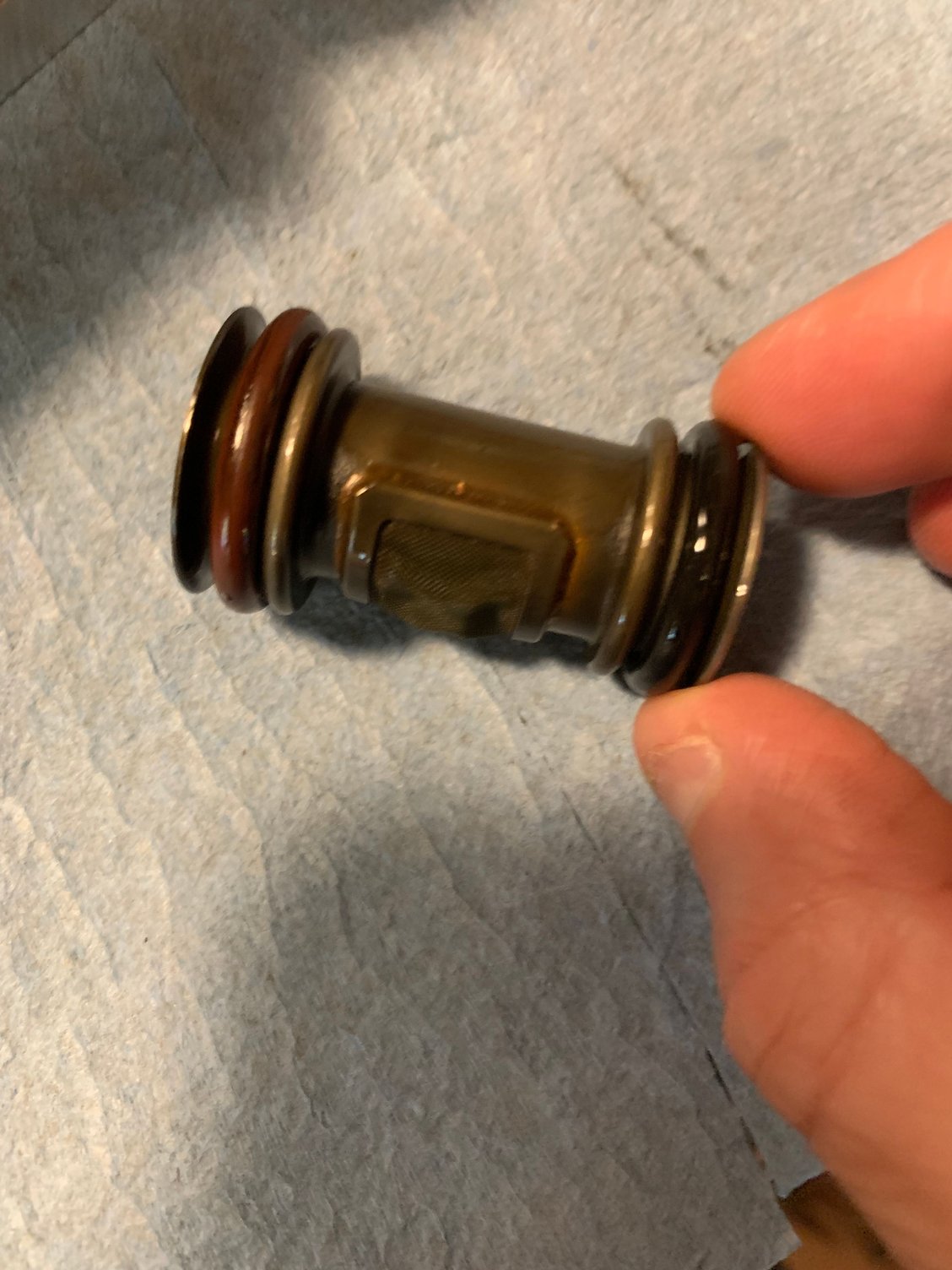

Took this out of the oil pump to install fresh o rings. Cant remember for sure which way it goes back in. Does the mesh screen face down or up? Ive asked a few guys but no one remembers or i get mixed responses. Just wanna be sure i get it right before i reseal this thing

Go to the link below, enter your car data, click on the engine-oil pump.
The visual diagram indicates which o-ring side size enters the block first & the screen direction.

found it. Facing up. Thanks. Is it ok if the mesh screen is a little bent?
