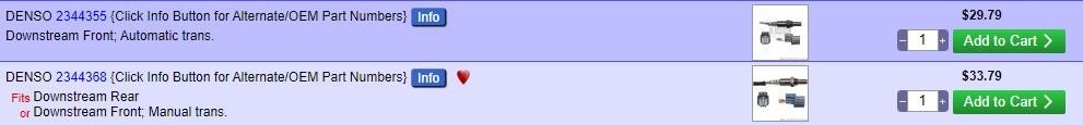

I see lots of info here, but its fragmented. I watched YouTube video and found the location of bank1 sensor 1. Can someone please confirm this Denso 234-4355 will fit?
The car had done 283k miles. Should I change the one closet to the radiator as well?
Prices on Amazon for this is around $33, but I see other places that are more than double this? Is $33 normal?
Is the sensor after the catalyst the same sensor? From what I gathered here, It seems not as the wires are longer.

RockAuto has them as shown below before shipping. There is a 5% discount code in the vendor section.
If you input the vehicle data, into RA, it will show that NTK is the 'Actual OE Part' though a little more $$.
IMHO, I would replace both front & rear at that 283k miles interval.

Got the info on another threadUpdated with Denso part numebrs
Firewall Side
Bank 1, Sensor 1 (top/upstream, before the cat) - OEM 36531-RCA-A02 or
Denso 234-5010
Bank 1, Sensor 2 (bottom/downstream, after the cat) - OEM 36542-RDA-A01 or Denso234-4355
Radiator Side
Bank 2, Sensor 1 (top/upstream) - OEM 36531-RDM-A01 or
Denso 234-5010
Bank 2, Sensor 2 (bottom/downstream) - OEM 36532-RYE-A01 or Denso 234-4368
All,
Here are the 4 OEMpart numbers our o2 sensors. Can anyone add the Densopart as a cross reference for people.
