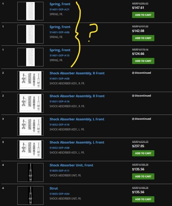

Quick question for those who might know: Only the front left shock absorber has been listed as available on the usual OEM parts sites for years now. The individual components appear interchangeable side-to-side, but there are separate part numbers for the left and right assemblies. Is this "left" assembly actually interchangeable for either side?
There's a thread on this from over a decade ago, but it goes off the rails and never clearly answers the question. Also not interested in aftermarket options.

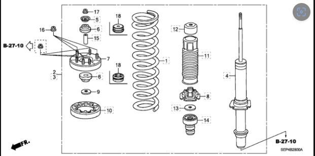

That's what the old thread speculated on. There are indeed two part numbers for the springs, but they're not listed or separated on the diagram as left and right (when everything else on the car is).

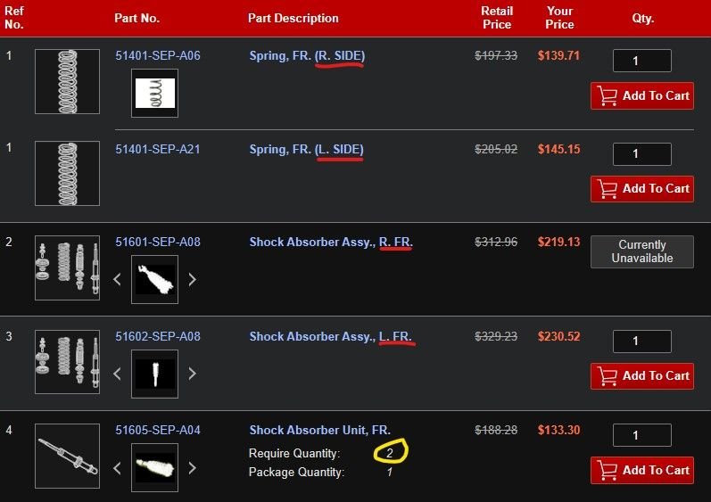

Old Jan 14, 2023 | 12:17 PM
Posts: 6,911
Likes: 2,214
Originally Posted by Superunknown
That's what the old thread speculated on. There are indeed two part numbers for the springs, but they're not listed or separated on the diagram as left and right(when everything else on the car is).
I think it mainly depends on which specific OEM parts vendor website you do your research on.
With that said, on acurapartswharehouse.com the #1 springs are listed as left & right;
the #2 & 3 entire shock absorber assemblies are listed left & right;
and, as truonghthe indicates, the #4 shock absorber unit is listed as one that is applicable to either right or left because the 'required quantity' (yellow circle)
is '2', for either left or right front side.
Front Shock Absorber - 2006 Acura TL 4 Door BASE (NAVIGATION) KA 5AT (acurapartswarehouse.com)
Now if you look at oemacuraparts.com, the springs parts diagram is the same picture; however, the parts 'listing' below the diagram is different:
Front Shock Absorber for 2006 Acura TL | OEMAcuraPart (oemacuraparts.com)
That's why I do my primary research on acurapartswharehouse.com because it has more data (IMHO ), then I scour the web for the best price.

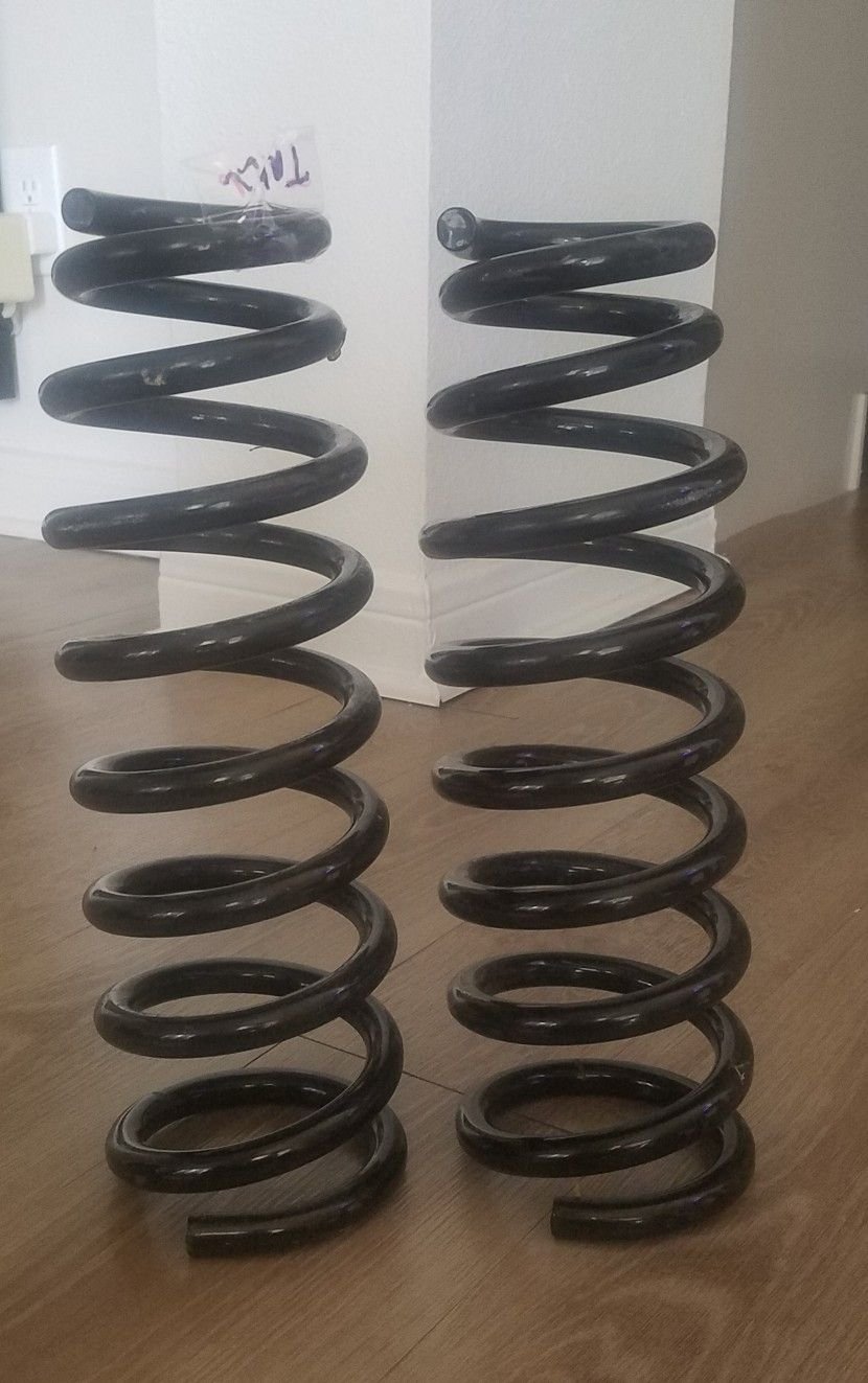

As a TEST, I have 2 Type-S Automatic springs in the garage..
I tried to weigh them and they both register 10 pounds but I had to weight myself with it. My scale doesn't do ounces. So they weight very close to the same.
However I set both springs on the floor, with the bottom coil facing the same way, and 1 spring is about 1/4" longer
The longer one might be the drivers side which could be the heavier side, on a automatic...

pigtail = end of spring.. gotcha.
both a wrapped / coiled the same direction
identical except 1 is about 1/4" taller.(maybe its a flaw? or maybe a slight weight difference in automatics?)
Both springs are straight.. and they both will hit the 5 or 6 holes at the top cap the same way. (If they were lop-sided or leaned, then yes you may have to flip 1 around to mate the other side.. but they are both str8)
The shock may change orientation but the spring winds the same direction with the same number of turns..
