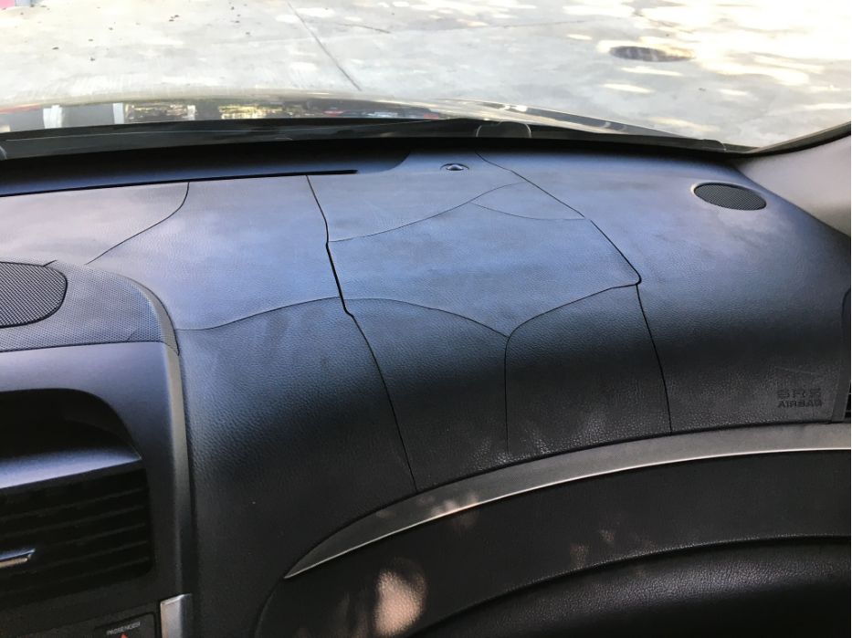

The previous owner had two kids and also used this car as a daily driver. It shows: the exterior is splattered with dents, dings, and scrapes and the interior showed life with two kids: stained carpet, food embedded in the perforated leather, and melted crayons in the door cubbies. The car was not garaged and the dash was cracked like crazy. But this is all superficial small potatoes. The previous owner also had all maintenance up to date and performed at the dealer. Sweet!
After a quick going over, it was adios to the carpet stains and embedded yogurt/milkshake/whatever in the perforated leather seats. And I bought and installed a COVERLAY to hide the cracked dash:
I also refreshed the headlight lenses:
I used Meguiar's Headlight Restoration Kit and am happy with the results.

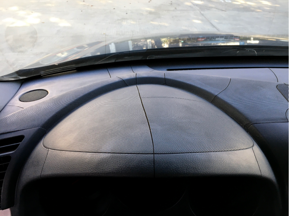

Congratulations! I have the exact same car except mine is a 2006. The dash cover looks really good on it too!

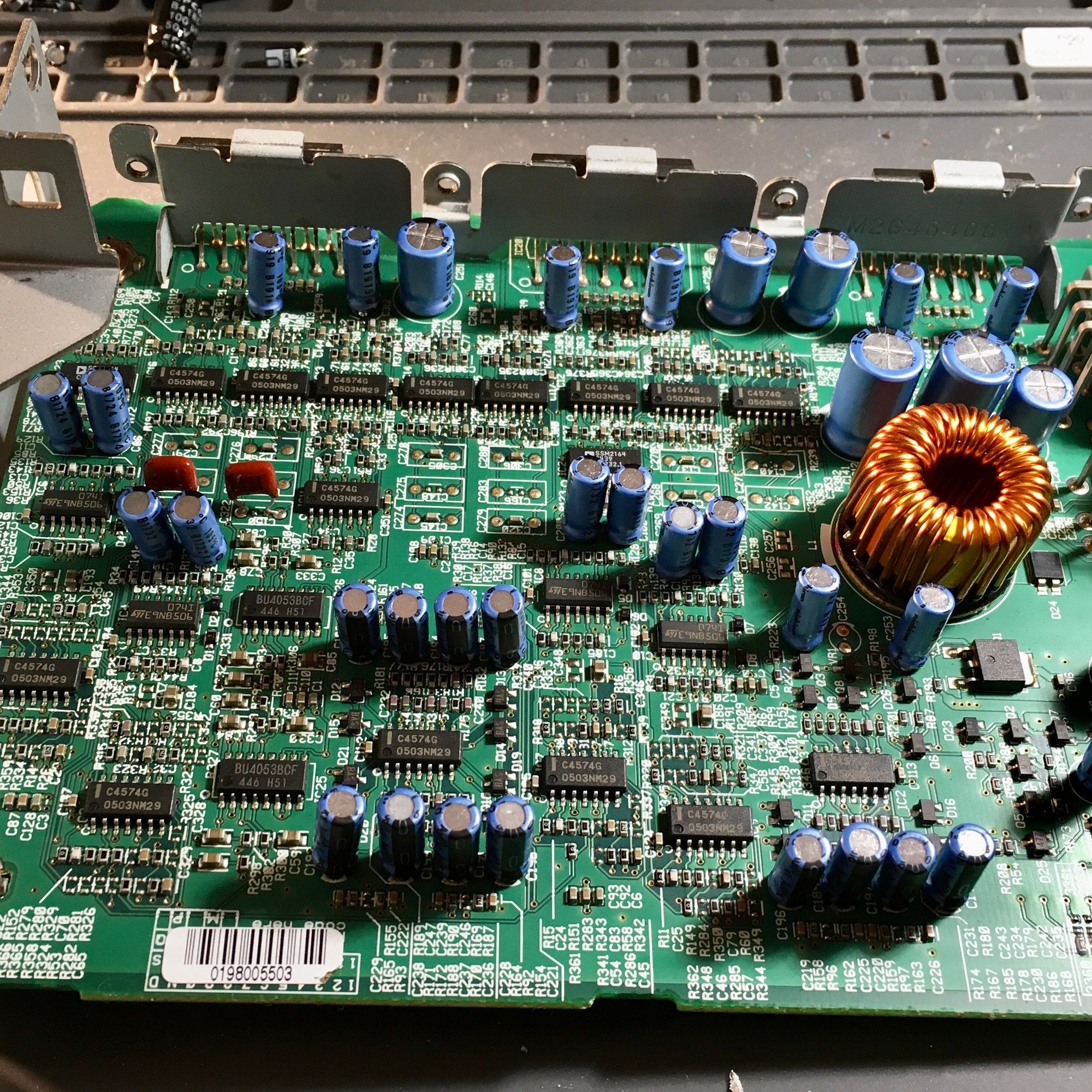

the previous owner had a 3.5 aux cord and and old apple 30 pin connector installed in the center console rear storage bin. i couldn't get the sound system to play from my phone so i started digging around:
i found the cords had become unplugged at the after market splitter box tucked away under the dashboard. after reconnecting the cords, i was now able to play music from my phone. sweet! but then i noticed the volume seemed off: it was kind of low overall but even less sound was coming out of the left channel. i found this a-zine thread: HOW TO: OEM Audio Amp Repair - fix buzzing/noise/no volume! and although i haven't messed much with pcbs, after a few weeks of staring at the parts i ordered, i decided to sack up and give it a shot. so i removed the audio amplifier, cracked it open at my work bench, and fished out the bum capacitors:
then popped in some new caps and buttoned it all up:
for about $20 worth of caps, the stereo sounds great now and i was very satisfied that i was able to repair the issue myself (but only with the guidance and knowledge of the a-zine crowd). hecks yes!

SO THIS is what is meant when somebody says "Imma pop a couple o' caps in yo' amps?" Seriously, good job!

Was your sound system suffering when you listened to Radio, too? I have a similar lack of noise but I’m assuming it’s my Bluetooth adapter
yup. after the repair, for any given volume setting, say 15, the radio is louder than the aux/iphone. having said that, if i go to max volume with the aux/iphone, it's plenty loud for me and way better than before the fix. another sign that the caps are bad is background noise when the volume is low. there are threads addressing this issue, so this is a common problem and if you are noticing these symptoms, bad capacitors are prolly the culprit.

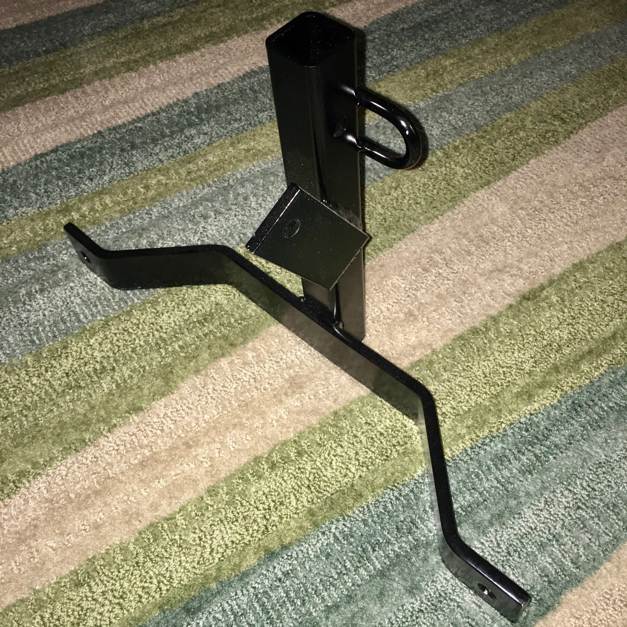

a few weeks ago, i installed a hitch receiver:

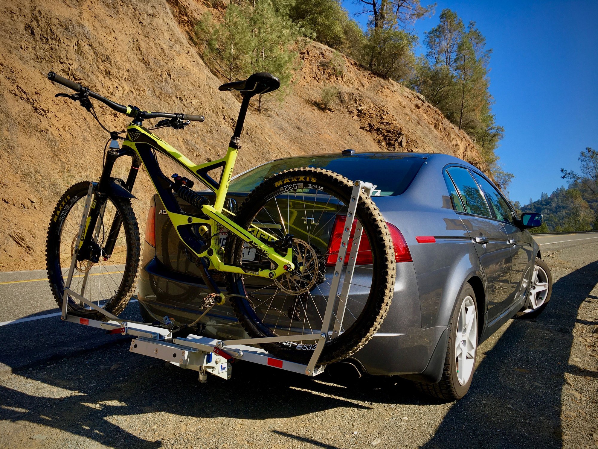

the receiver is used for this:
that's a 1up bike rack. it's arguably the best bike rack on the market due to ease of install/removal of the rack to the vehicle, ease of install/removal of the bike to the rack, and top notch materials for durability. cheap it ain't, but totally worth it imo.
i put it to good use today and went for a ride on my local trails in Auburn, CA. fun times.
btw, that bike is a 2017 YT Capra 27.5. it's flippin' awesome.

Awesome man! Did the hitch require drilling, or just bolting? I want to set up a similar bike rack for my Sette 29er!

I got CURT 11321 for my 2008 TL. It required removing bumper cover and drilling into the bumper beam. I used step drill and had no problems.
You gotta drill two holes thru the trunk floor, but it's super simple cuz it's just thin sheet metal. The hitch receiver's main attachment point uses a bolt at the tow loop thingy. The other two mount points (where you drill thru the sheetmetal) seem to be mainly for lateral stability. I'm not worried about strength because the hitch is only there to haul the bike rack, not a trailer.
BTW, I bought a Reese receiver hitch on Amazon for $100, which I believe is exactly the same as a Draw-Tite, which is slightly more pricey. Also, I've had Yakima roof racks on my cars for the last three decades, but this 1UP rack is easier to use, more burly and yet lighter than any Yakima, Thule, Kuat, or Rocky Mount rack on the market.

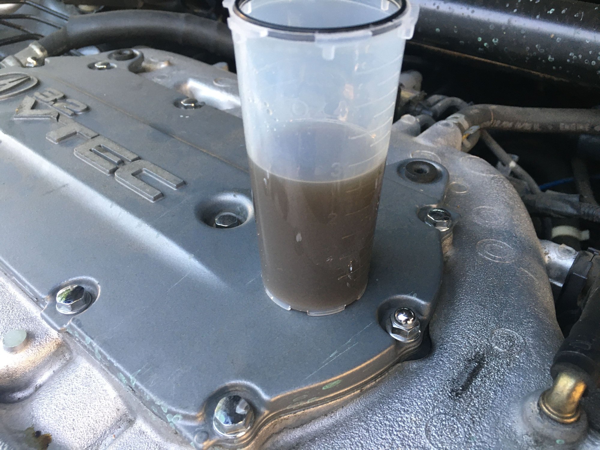

last nov, i removed the front bumper:
in order to remove some plastic bits:
i replaced that oem intake with a cold air intake from DC Sports on ebay for $150. i chose this brand for the price and for the included CARB sticker. i'm satisfied with it.
the engine stays quiet under normal driving, but the growl is a bit louder than stock when going full throttle and when the vtec kicks in. that sound is music to my ears, so my gas mileage has suffered since the installation. but there's also been a noticeable improvement in smiles per mile.

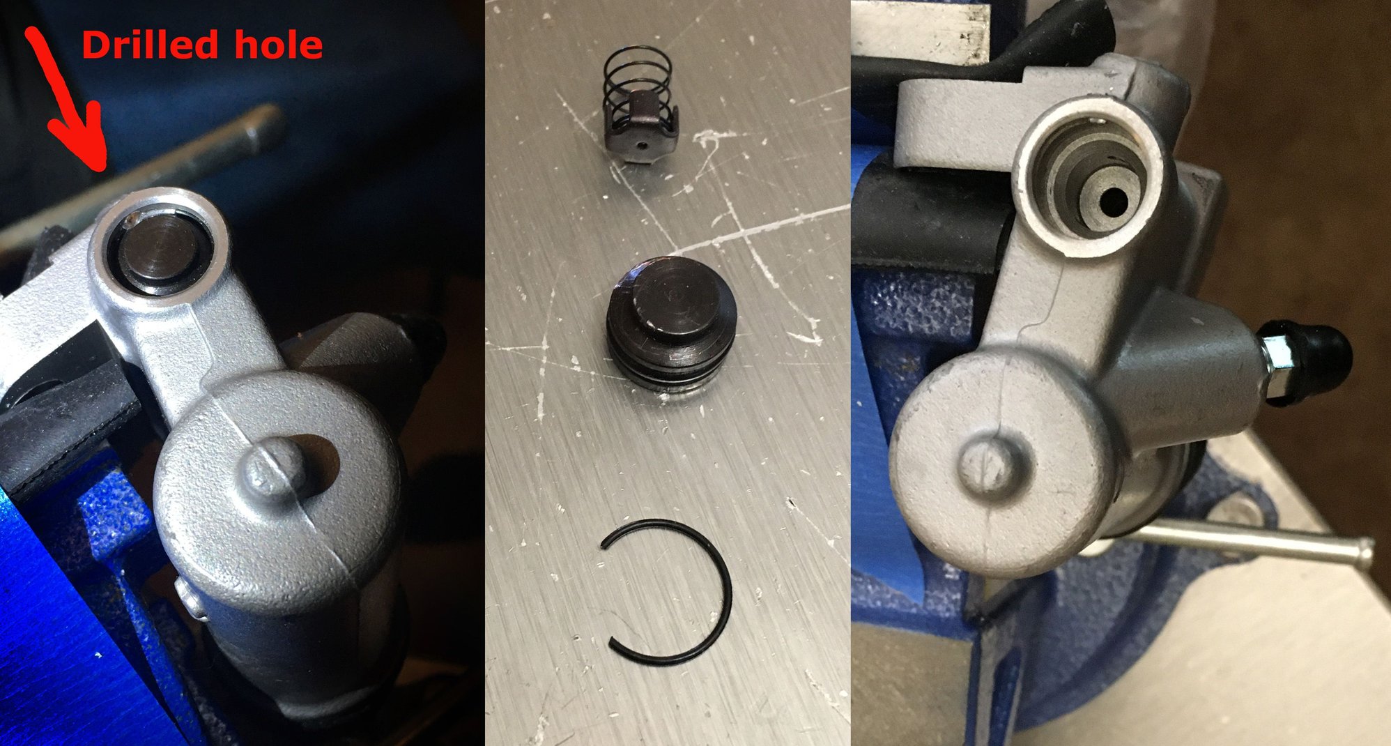

Honda is known for making great manual transmissions, and the one in my UA6 is no exception. However, I did notice that the 3rd gear synchro could be a bit fussy at times, not sliding in with ease as expected. Well thanks to AcuraZine and this thread: Manual Tranny Owners: How has GMSF fluid worked out for you over long haul? , I discovered that this was a common problem and the best solution was to switch over to GM Synchromesh fluid. So at the last oil change, I also drained the transmission and added the GM stuff that is now called AC Delco Synchromesh. OMG, no more 3rd gear issues, so smooth and precise, so sweet!
I had also noticed that the clutch took some getting used to and that I just couldn't quite figure out how to be consistent and smooth, although I've only owned manuals my whole life - that's four frickin' decades now. AcuraZine to the rescue again: A-113: Removal of Slave Cylinder check valve!!! . Turns out this 'delay' valve in the slave cylinder was the issue. So I ordered up a LUK slave cylinder and removed the offending valve.
A major headache with this mod is removing the LOCK RING to gain access to the delay valve. A tip I found on an S2000 forum suggested to drill a little hole in the side of the valve, through the groove for the lock ring, which allowed a pick to easily fish out the C shaped lock ring. So I gave it a shot:
Note: position the open end of the lock ring at the location of the drill hole to prevent damage to the lock ring (this is visible in the first part of the pic). There was prolly a little bur at the hole from the drilling, but access was super tight, so I couldn't do anything about it except to keep my fingers crossed and hope that the o-ring in the cap did not get muffed up. Once the hole was drilled, it was easy peasy to remove the lock ring, cap, and POS delay valve. Hecks yes.
So I spent most of an aggravating Saturday unsuccessfully trying to bleed the clutch hydraulic system. After reading many threads and watching many vids and carefully bleeding the system in a variety of ways, the clutch refused to work properly, it was very mushy and the transmission would not go into any gear. Think, man, think. So I removed the slave cylinder from the car, held it vertically, and filled it to overflowing with fluid. After carefully reinstalling the bitch, taking pains to minimize fluid spillage, I bled the system one more time an noticed that the clutch pedal looked and felt normal instead of being limp and flaccid like earlier. Hells yes.
With the delay valve removed, the clutch now acts and feels similar to the many other clutches I've used over the decades. No more weird delay or modulation issues. Thank you AcuraZine! If your UA6/UA7 has a manual transmission, I highly recommend this simple and effective mod! (I have read that the delay valve is there to reduce the harshness of clutch engagement - but IMO the real answer to reducing harshness is to become a better driver. yup.)

At this point, the folks here have literally millions of miles of usage with ACDelco Synchromesh Friction Modified (formerly called GMSF); empirical data shows if you switch to the ACDelco fluid soon enough, as in, before severe 3rd gear synchro damage has been achieved, then your transmission can last literally hundreds of thousands of miles.

OP if you think your clutch fluid is bad, wait until you see mine when I first got the car lol.
Old Apr 19, 2021 | 11:52 AM
parkmeister's Avatar
Joined: Oct 2020
Posts: 34
Likes: 37
From: Sacramento, CA
i know it's not horrible *except* that i replaced the clutch slave cylinder 3 months ago and pumped a shit ton of fresh fluid thru the system. so for three month old fluid, it sucks balls. (my power steering fluid looked like swamp water- it was fkn gnarly)

Out with the old, in with the new.
Replaced the clutch master cylinder today and the TL is back in business. Hell yeah.

welp, this unfortunate incident recently occurred:
Full Disclosure: In a nutshell: I am a fucking dumbshit, this was a single vehicle incident, I was NOT rear-ended. Yup.
Driving up to Tahoe last Sunday and looking forward to riding the Meyers area for the first time this season, I was motoring up the hill on Hwy 50 with much "enthusiasm and vigor". More so than usual, actually. So when the uphill high speed sweeper leveled off, my suspension unweighted just enough for the tires to lose grip and send me skidding sideways down the road while watching on coming traffic whiz by on the other side of the double yellow. The car continued skidding and yawing to the left until I was bassackwards and eventually slammed into the armco. So yes, I am King of the Dipshits. And actually quite lucky that I didn't hit another vehicle or depart from the roadway. And while the car is prolly totaled on paper, the damage is relatively minor and I was able to drive home without further incident.
On closer inspection of the bike, I lucked out even more. The frame and fork, as well as most of the bike appears undamaged. The front wheel is toast (although I may be able to salvage the hub), the rear disc is a write off, as is the snapped derailleur hanger and RH crank and RH pedal. But that's it. I really got lucky cuz things could have turned out so much worse. Whew!
I'm gonna attempt a diy repair on the car, the rack, and the bike, wish me luck, I need all I can get!
