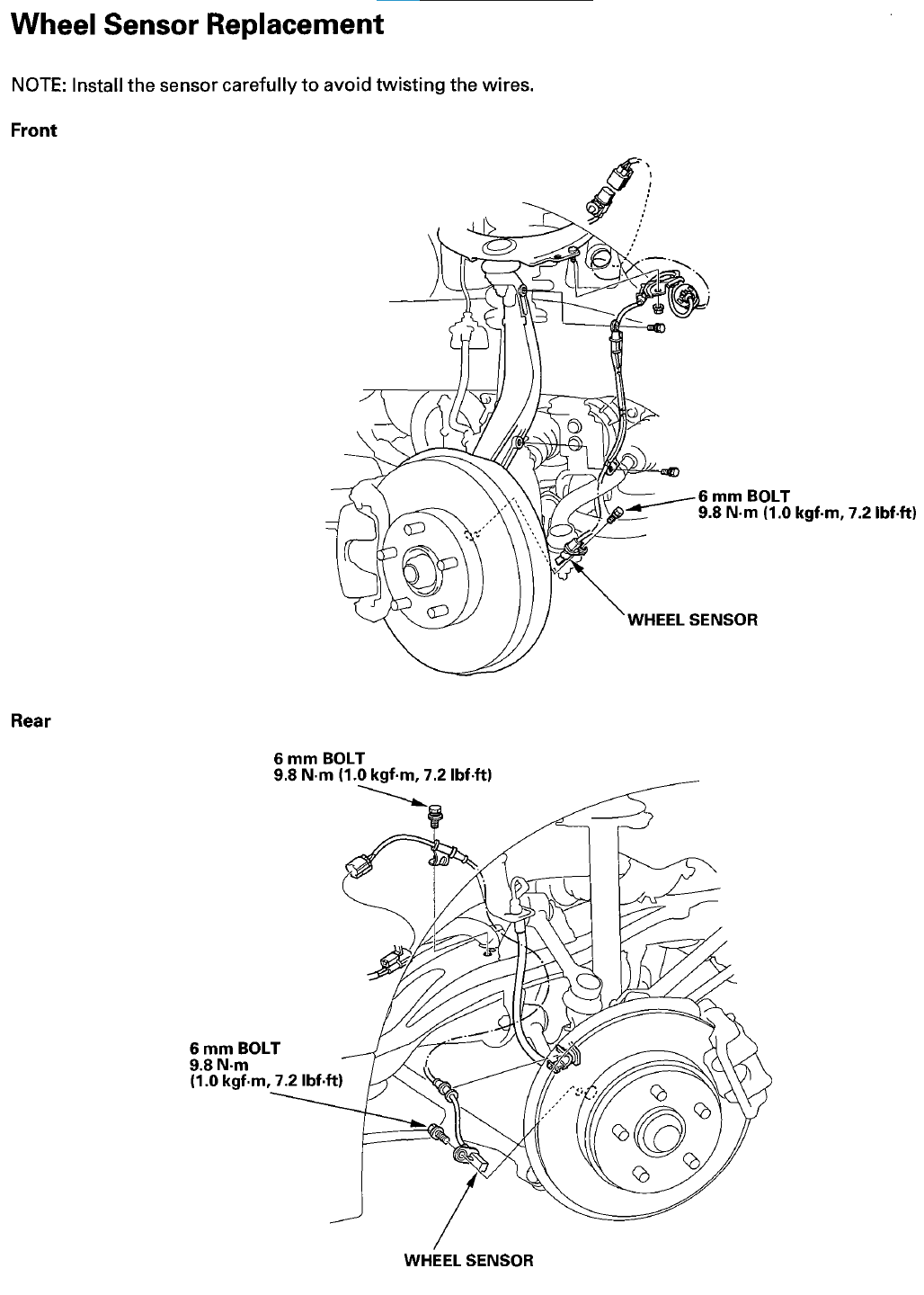

The speedometer not registering seems to be a root issue. Was the D gear light ever flashing? Does the car shift through all 5 gears smoothly? Do the revs peak right before 4100rpms? If so it might be related to a countershaft speed sensor. This is what I could find from the service manual.
Also recheck the connectors on the top for the wheel speed sensor.
