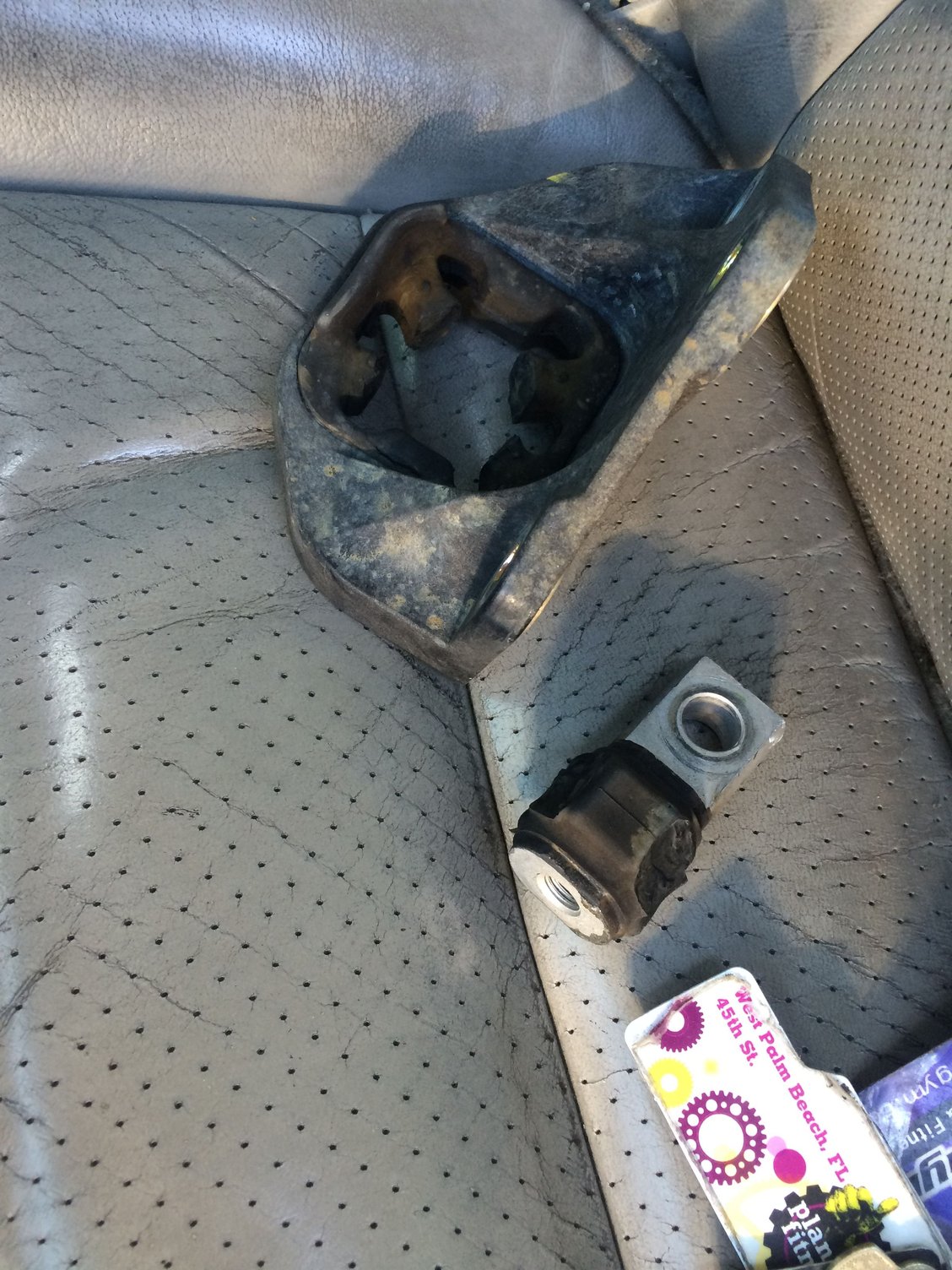

So while doing my radiator I look at the transmission mount and find this, I changed it out, think this can cause some of my shaking?

Changing passenger side mount tomorrow, then in a week or 2 changing the front mount, then slowly the rear
