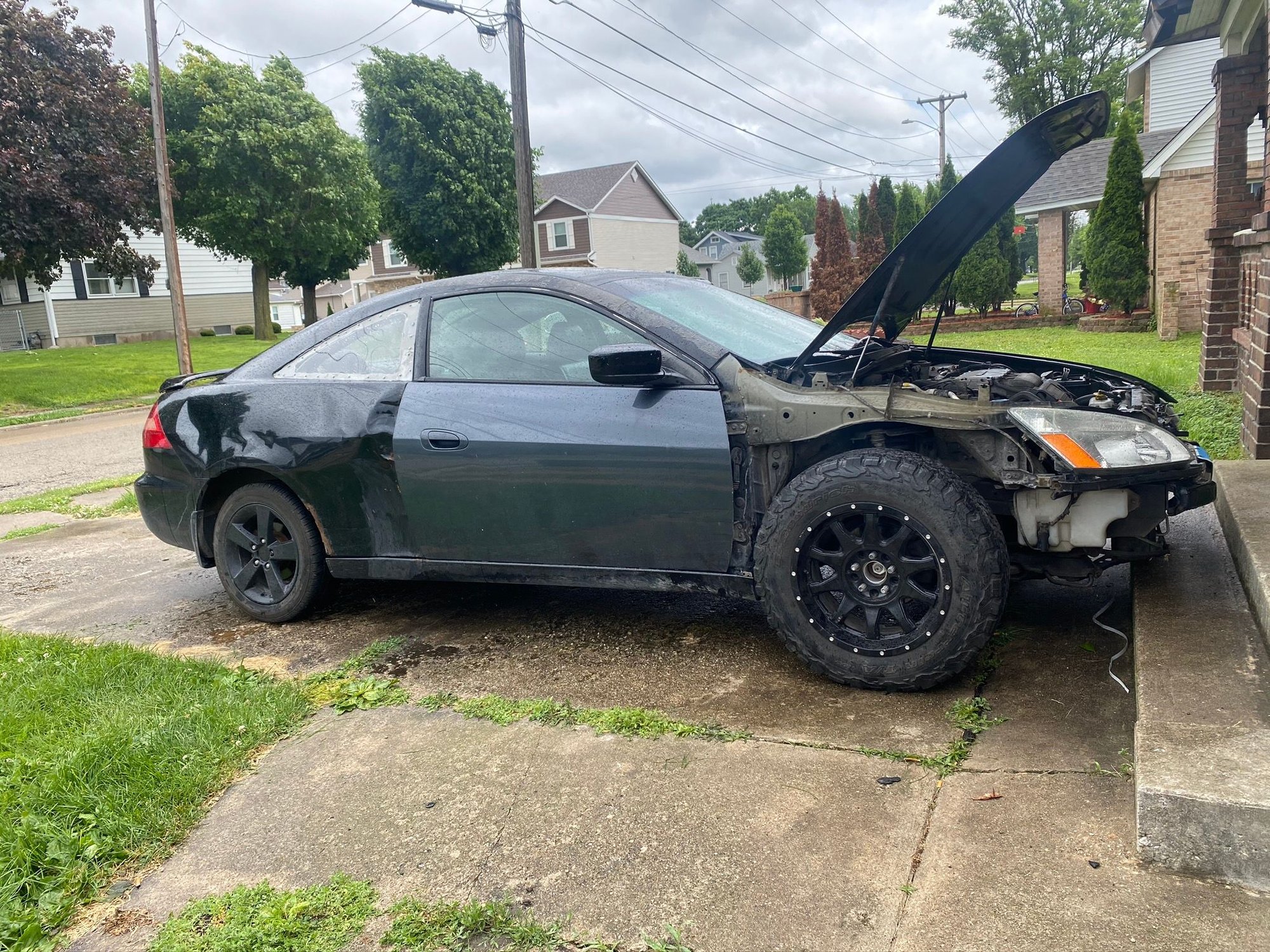

I have a 2003 Honda Accord v6 AT. I want to swap it with a J35a8 and turbo charge it, but I can’t afford to mess anything up cause it’s my daily.
I’ve read a lot about cracking skirts and blocks due to high compression. Also considering making it a 3.6 or 3.7 franken engine, and maybe j32a2 head swap. Would you guys recommend k20/k24 (+3mm) pistons, or boring it to 90mm and using j37 pistons.
I have a lot of experience taking engines apart and putting them back together but have never done a project like this. Any help and advice I can get would be greatly appreciated.
also in the picture below, what does it mean “must also swap IM if Automatic”

my plans were originally to just use a 8th gen bell housing with my 5spd that was in my 7th gen. I’m actually genuinely considering going awd though at this point witch is why I’ve decided to go with the 6spd.
I was already working with HRG lifts to lift the vehicle and put my truck tires on it. So now I’m just looking for a 08-09 TL that has severe front end damage to buy and part out the rear drive train.
I also found another Accord body with no damage for $200
