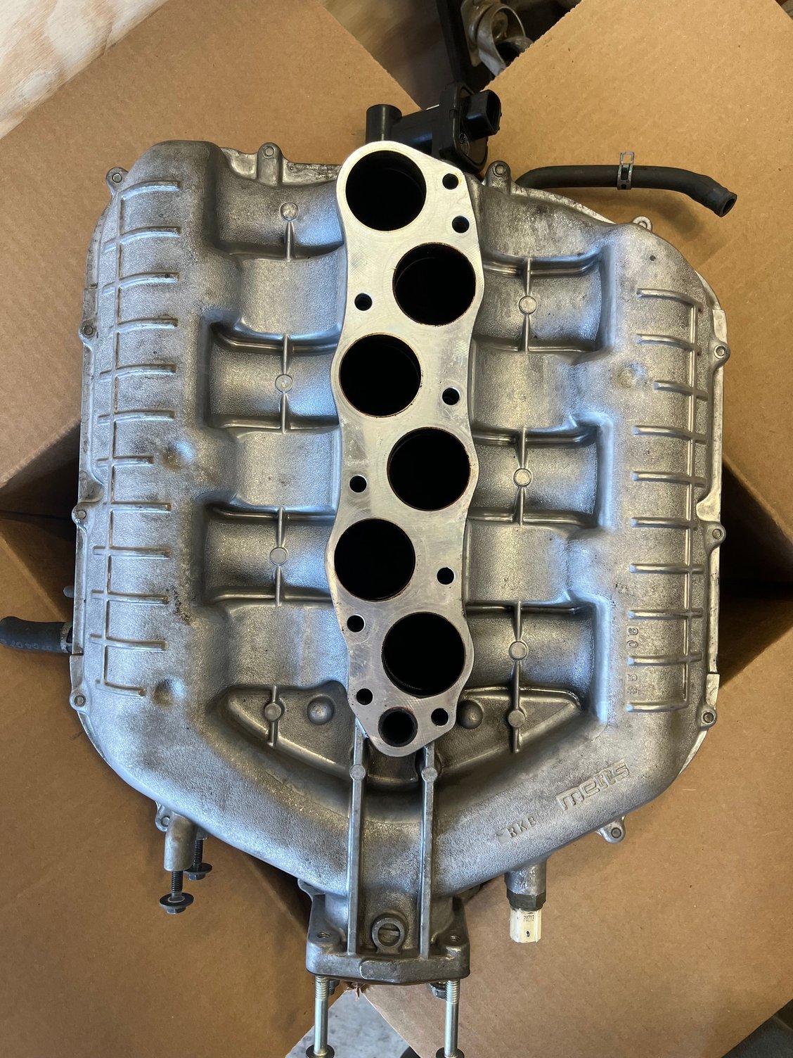

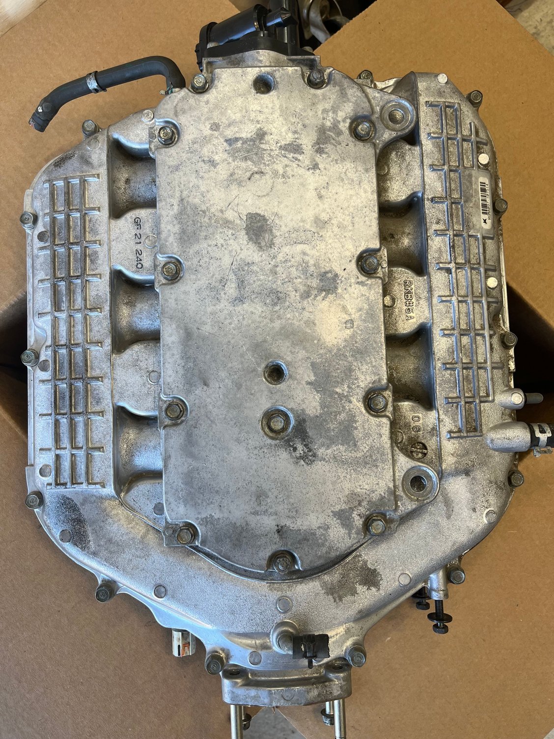

Came across a relatively clean J35A7 intake manifold in an '07 Odyssey EX-L at a junkyard, and I picked it up for $52.
Now, I have two TL's: a '04 base 5at + a '08 base w/ Nav.
I am curious, would this be an upgrade over the OEM 2pc magnesium manifold in my '08? or would be it basically equivalent?
Since its the 2pcs magnesium IM, I'd be inclined to believe its an upgrade at minimum for the '04 (OEM cast IM).
At minimum, I can delete the IMRC & throw it on my '05 Pilot

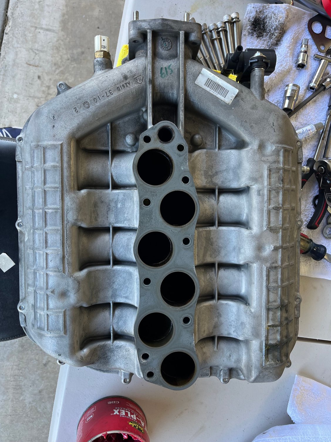

RKB mani is same as 05-08 RL. Not an upgrade. esp if its the heavy aluminum material.
I've got several dbw j35/early j37a1 magnesium manfolds. Pretty mich identical except for whether or not they are tapped for Intake air temp sensor. Which the earliest ones like that were. I also don't see Mg stamped on the bottom. Not worth $50+

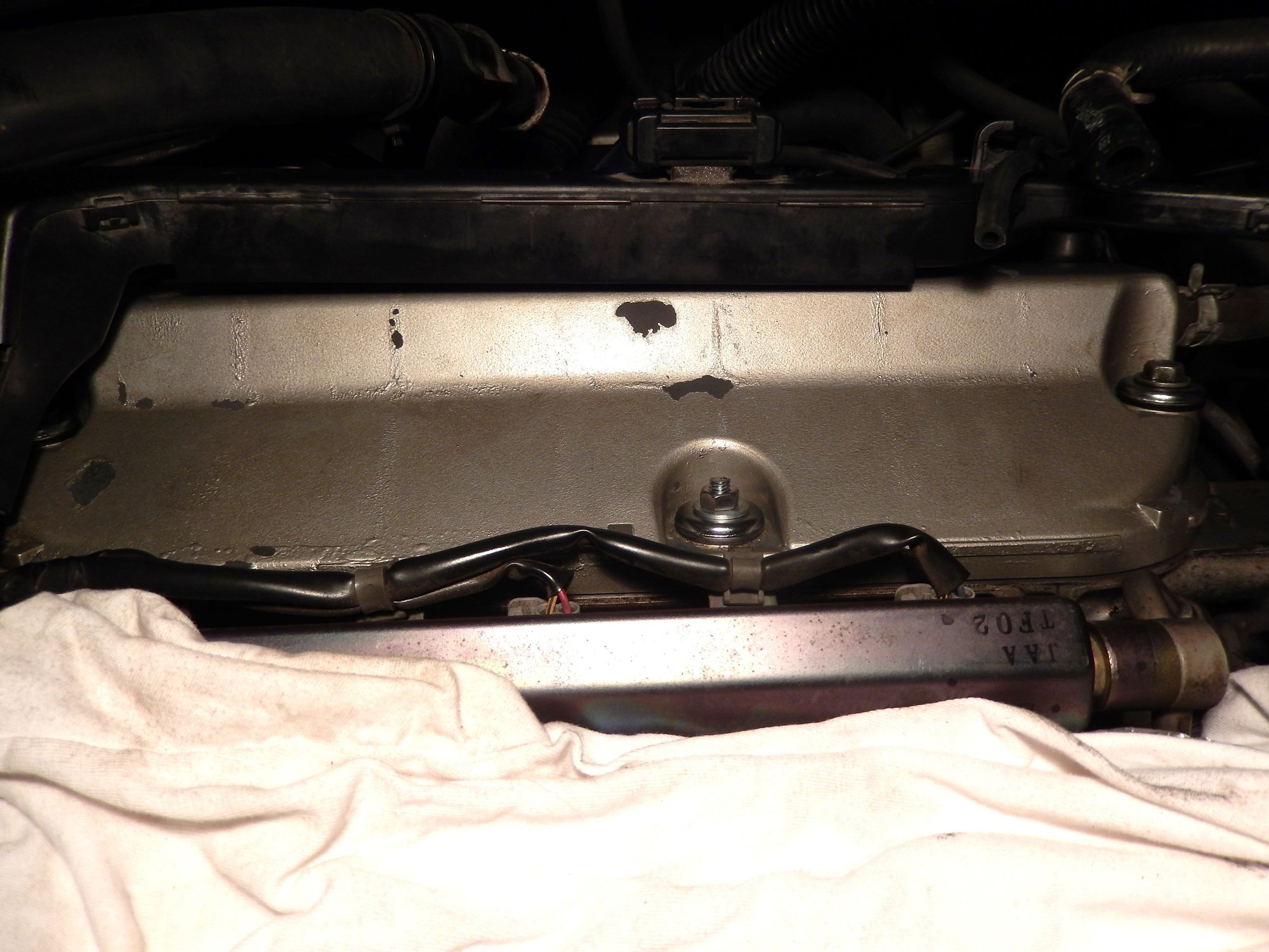

I hadn't heard of plenum spacers before I read your post and you have me intrigued. When I replaced the valve cover gaskets on my 2005 RL, the middle valve cover bolt broke and I had to improvise and make a stud (see image below). Since the intake manifold is so low against the valve cover, I can't keep an eye on the stud to make sure it's not coming loose. I wonder if I put a 1/2" spacer would it allow me to at least feel that stud I made to make sure it's not coming loose. I'm not really trying to change the car's performance, but a little more clearance would be nice.

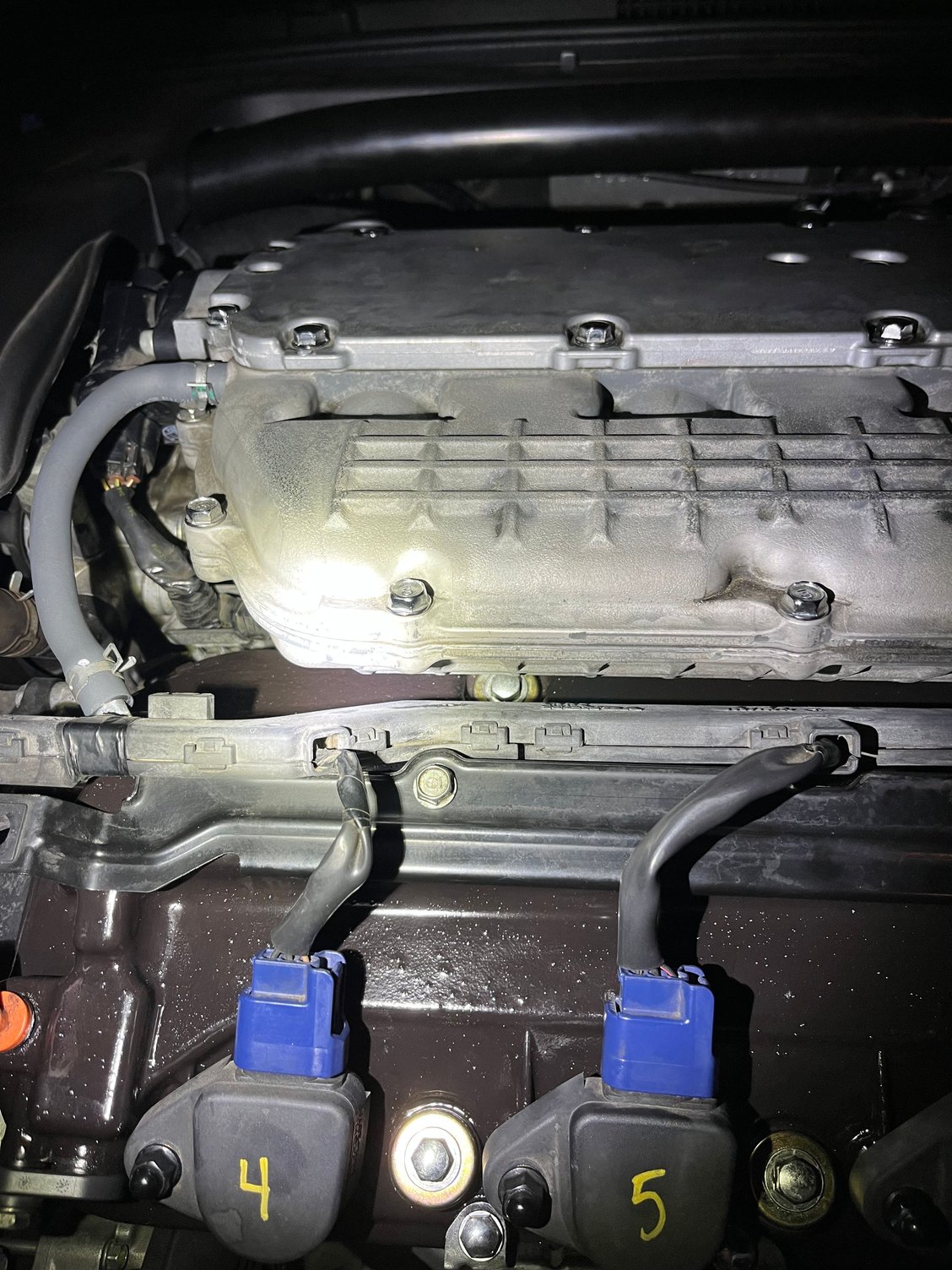

This is about how much I can see of the middle inner bolt on my front cylinder bank. The spacer definitely adds some visibility if thats what you're looking for:
