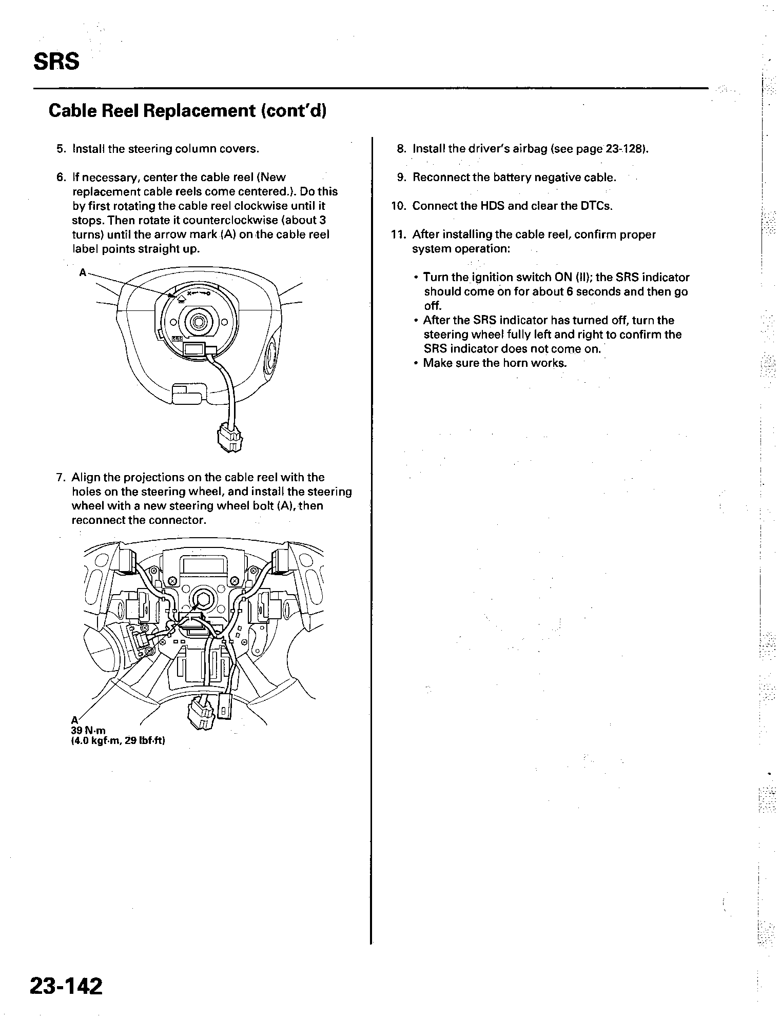

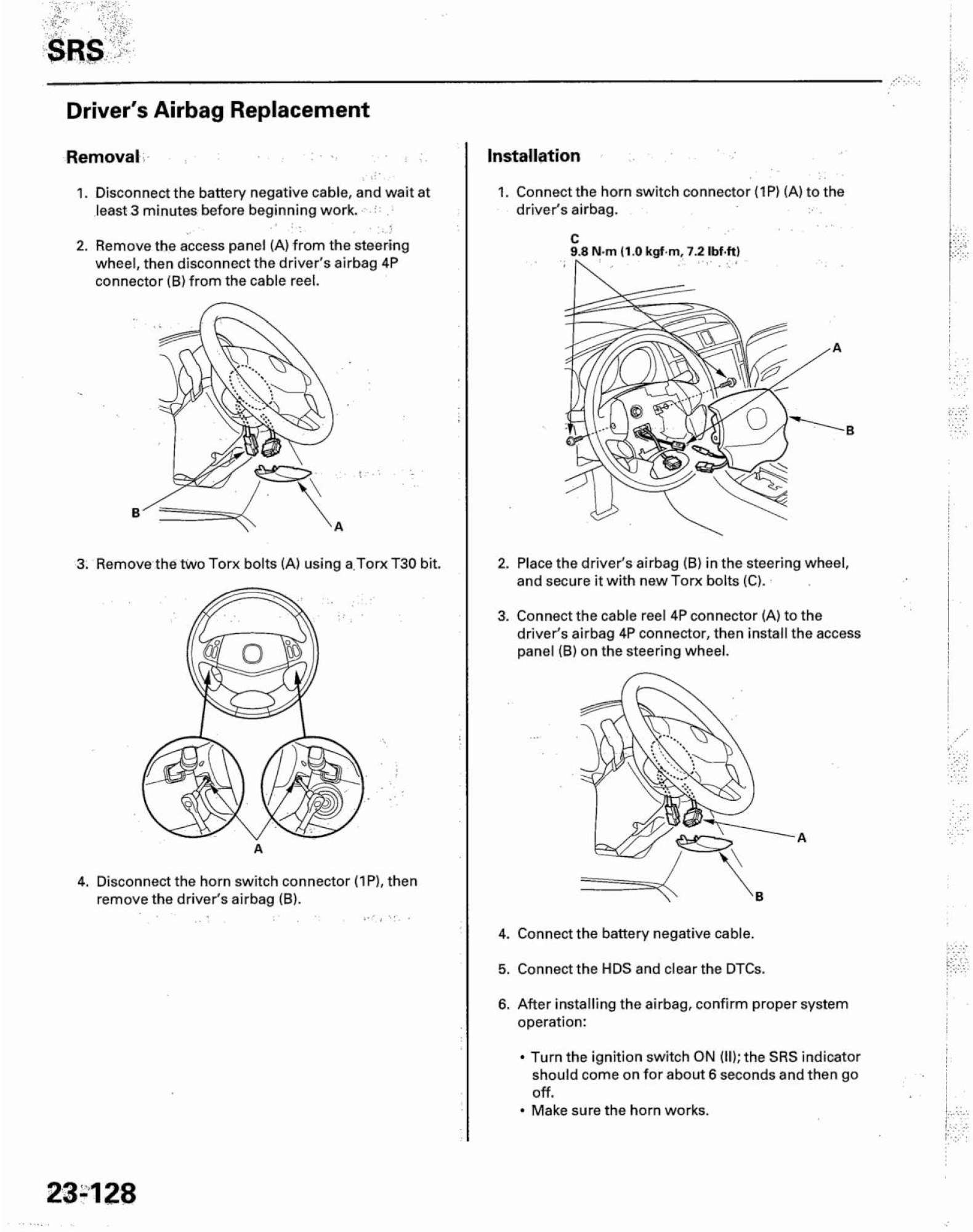

From: CT
Here are the scans for cable reel replacement and airbag removal/replacement. Many people have stripped the two T30 torx bolts because there is a good deal of thread locker on them. Use a top quality torx bit and be very careful when you try to remove them.
