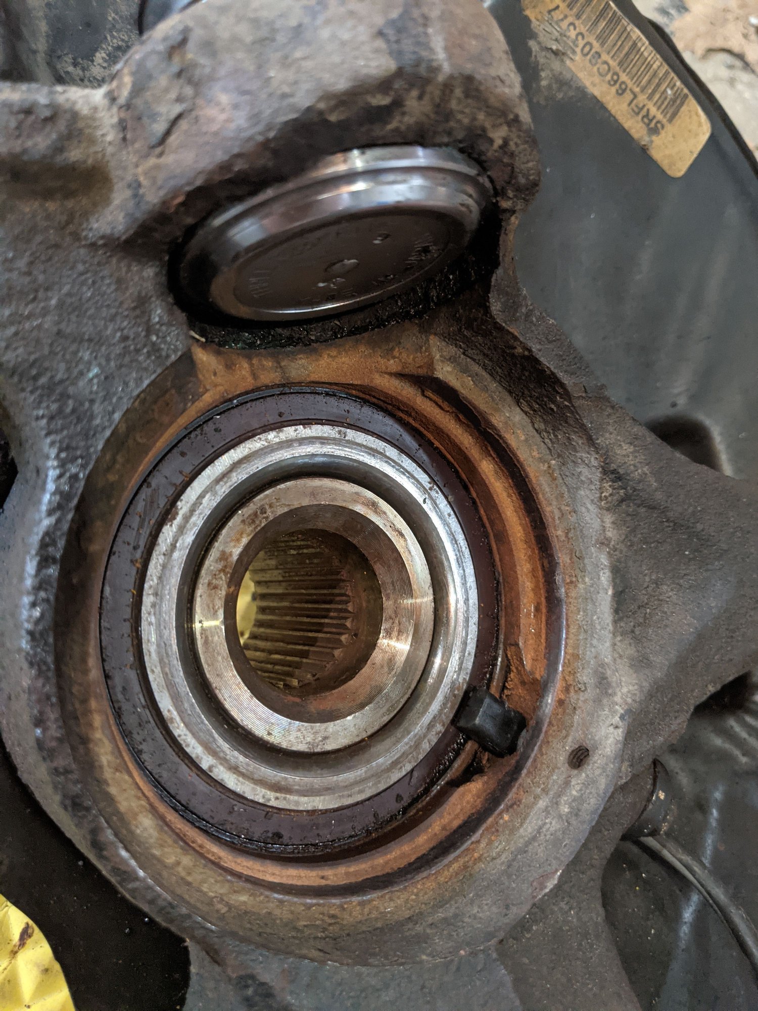

How do I remove the wheel knuckle ring?
I can't seem to get this thing to pop out, and I've already deformed it a bit. Tried using a pry bar at the top openings near the abs sensor, as well as a pry bar next to the ball joint, no luck.
Any input or advice would be appreciated!

Bend, pry, destroy it and throw it away. Mine is actually missing from the last shop that did the ball joint, I only found out when I went to do the ball joint last summer. If you care and would like to put that back, buy a new one. But you'll need to grind and de-rust that area on the knuckle to fit it in.

I guess the reason you are asking and from the perspective of the picture, it appears the ball joint removal process will run right into that knuckle ring?
The #5 wheel bearing looks 'beefy' for that 3G TL knuckle.
Front Brake (1) for 2006 Acura TL | Acura OEM Parts
It also appears that the inner flanges of the #1 ring may be accessible, for removal, only if the wheel bearing has been pressed out?
Knuckle for 2006 Acura TL | Acura OEM Parts

If you're not running one on your car, that's good enough for me. I'll try using some more force today to get it out.
That's correct, I'm planning on removing the ball joint. And I believe this ring/retainer actually *should* pop out, I found an obscure video on youtube where some other guy was able to pop it out like a snap ring, and he used a small chisel. I'm beginning to think that mine just might be horribly corroded in there, it has to be the original with 240k on it. Now I'm getting concerned that I should be replacing the wheel bearing while I'm in here, I think I slightly damaged the surface when trying to pry the ring out (the surface to the right of the abs sensor).....wonderful.

Thanks peter, always appreciate your input on my posts. Looks like I will simply try to remove it and leave it as is. But now I'm worried about that damage I caused to the outer seal of the wheel bearing probably wouldn't hurt to replace that since I have it all apart anyways...

Just an update to this, I heated up the ring with a torch for a few seconds and was able to pry it out. Additionally, I didn't actually damage my wheel bearing seal, it was just a ton of debris around the edge.

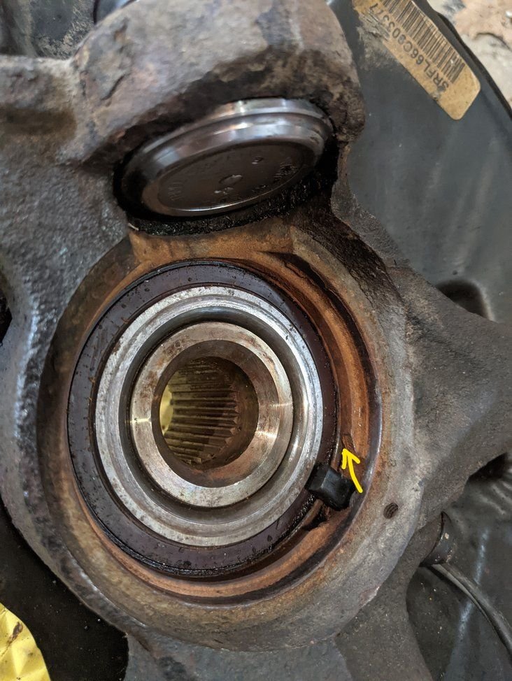

TheSauceBoss, just curious. Do you have a picture, like the one you provided above, that shows the knuckle without the knuckle ring in place?
Old Mar 31, 2021 | 12:05 PM
TheSauceBoss's Avatar
Joined: Mar 2017
Posts: 842
Likes: 323
From: Columbus, OH
Sure, the assembly is just sitting in my garage while I wait for my new axle to show up in the mail.
Old Mar 31, 2021 | 12:28 PM
Posts: 6,910
Likes: 2,211
Thanks, that is were I wanted to see if the outer case of the bearing bottomed out, against that circular flange highlighted in yellow.
