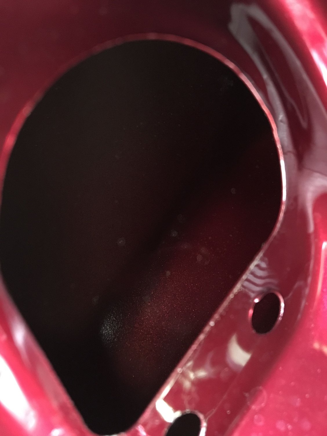

I've got the wing type spoiler that I'm trying to remove and repaint. Looked inside trunk, didn't immediately see any attachment method like bolts or screws. How TF did they put this thing on here?! Want it off so I can thoroughly prep and repaint, but not seeing any attachment points.

I see no evidence of any type of bolt, unless in the one pic, there is a Allen key inside the only hole I see.

This is what i found at acuraparts.com , It might help letting you know their is 2 fasteners on each side.
