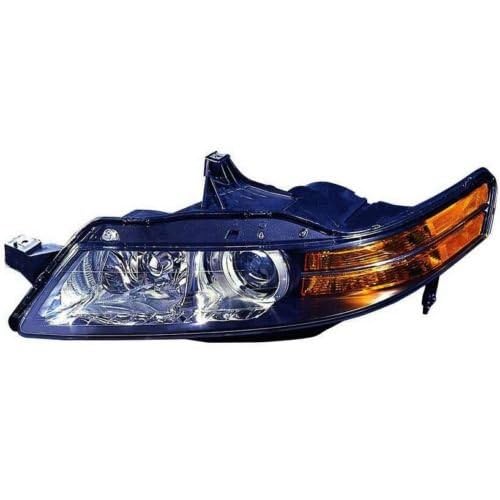

Yeah the US and Canadian headlights are subtly different on the 04-06 models. You can see in these pictures that the Canadian lights' DRL reflector is a slightly different shape than the US model's fog light reflector and it lacks the bulb shield.
Canadian headlight:
US headlight:
