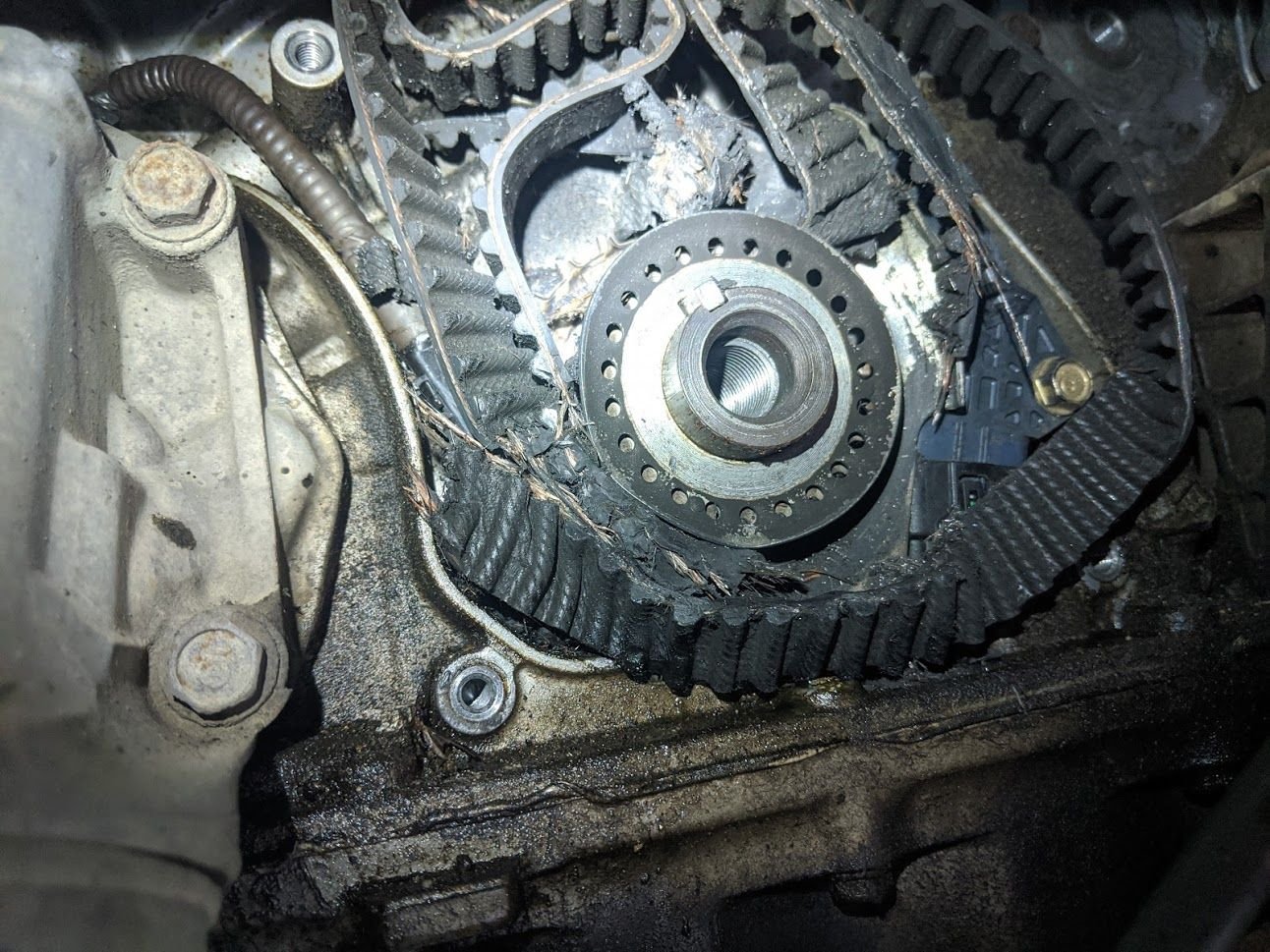

Welp.
Some of you may recall a thread I posted a month or so ago, where I expressed my concern with the timing belt/water pump kit that I got off ebay. I thought it was genuine when I purchased it, but during this thread, I explained the reasons why I begun to believe that it was a knockoff kit. https://acurazine.com/forums/third-g...t-isnt-988847/
I also said that I would look into re-doing the 105k service, and was just banking on the now seemingly fake kit to last me just 40k miles.
Today, my suspicions were unfortunately confirmed.
Not sure where to go from here. I'll probably end up taking the top end apart to look at the valves, I was unable to hear anything when the engine failed, I was listening to music when it died. All I know is that the starter sounds like it's trying a bit harder to move the engine....
I'm just assuming the worst. I've never taken apart this engine before, so I suppose there's a first time for everything.
I was wondering if anyone has any input on where to go from here. Whether I can get away with new heads, or if it's more cost-effective to simply source another engine and swap the entire thing, idk.
Working on finding a temporary ride at the moment.
A lesson learned the hard way. Be sure you are buying OEM parts.
Thanks for any thoughts or suggestions.

Throw belt at it and check compression. I had couple of honda v6 with broken belt that survived just fine.

I guess I have nothing to lose at this point, right? I've never done the belt job myself, I will need to look into how to tension it and line it up. Then at that point, if it's still screwed up, I'll then take off the heads.
I was going like 45 mph, on an incline, at least at 3k rpm when it failed. I'm sure that doesn't give high hopes for the engine being fine but again, I'm inexperienced when it comes to this failure.

so many warnings about the fake kits!!!! Throw a belt and see if it runs before you even want to do a compression check but you stated you've cranked the engine which isn't good. The cams are now disconnected from the crank (no timing belt) so the crank is spinning with pistons but not the VALVES! You could have made valve contact doing that since the cams are totally out of time!!!!
Thankfully heads aren't that bad of a job on these V6's and can be done in the driveway/garage. Youtube has a TON of videos showing how to do it and take "shortcuts" by not disassembling everything to little bits but leave it in larger assemblies. Rubber bands/zipties/tie wire is a great tool!
If the valves are bent it's easier to get junkyard heads or used ones rather than trying to get yours built unless you want to learn how to do it! I doubt any damage to the pistons as they are pretty sturdy vs the valves.

Im with Pete. Easy enough to just throw a belt and hope for the best.

Well...you shouldn't crank a car with a broken timing belt....
Anyway, you likely damaged the valves already at 3K.
I agree to toss a belt on and check compression.

That's the worst but we are human! You are totally right about natural reaction and that is why so many cars that get flooded get hydrolocked... instinct to restart!
Car-part.com will help greatly. LKQ and You-Pull-it and if they have a car, you can find people that advertise services to remove the parts for you from those places. Facebook marketplace also has a few sets of used heads. Just have to make sure they are good heads (no damage) and that they fit. I believe MDX, RL and TL heads of a variety of years fit with no issues.
I also agree with Zeta it might be easier/cheaper to swap in another engine depending on what damage you uncover such as a valve bouncing around the cylinder chewing up the cylinder walls, etc.
Do you have a boroscope with flexible head and light? Get a cheap one off amazon and you can look down spark plug holes for debris.

main thing to see is that there is no pieces of valve sitting on the piston and that the walls are good. It should be easier to see once you get the camera head in and turned/flexed, the non-flex ones can suck unless they have multiple cameras. Also don't forget to post more pictures!

When realigning everything, take the plugs out so engine is easy to crank, and then just simply move everything to the right position.
If you feel unusual resistance, then back off, and try to rotate different thing.

Rough luck but there have been some stories of belt breaking with no issues. Hopefully the link will help.

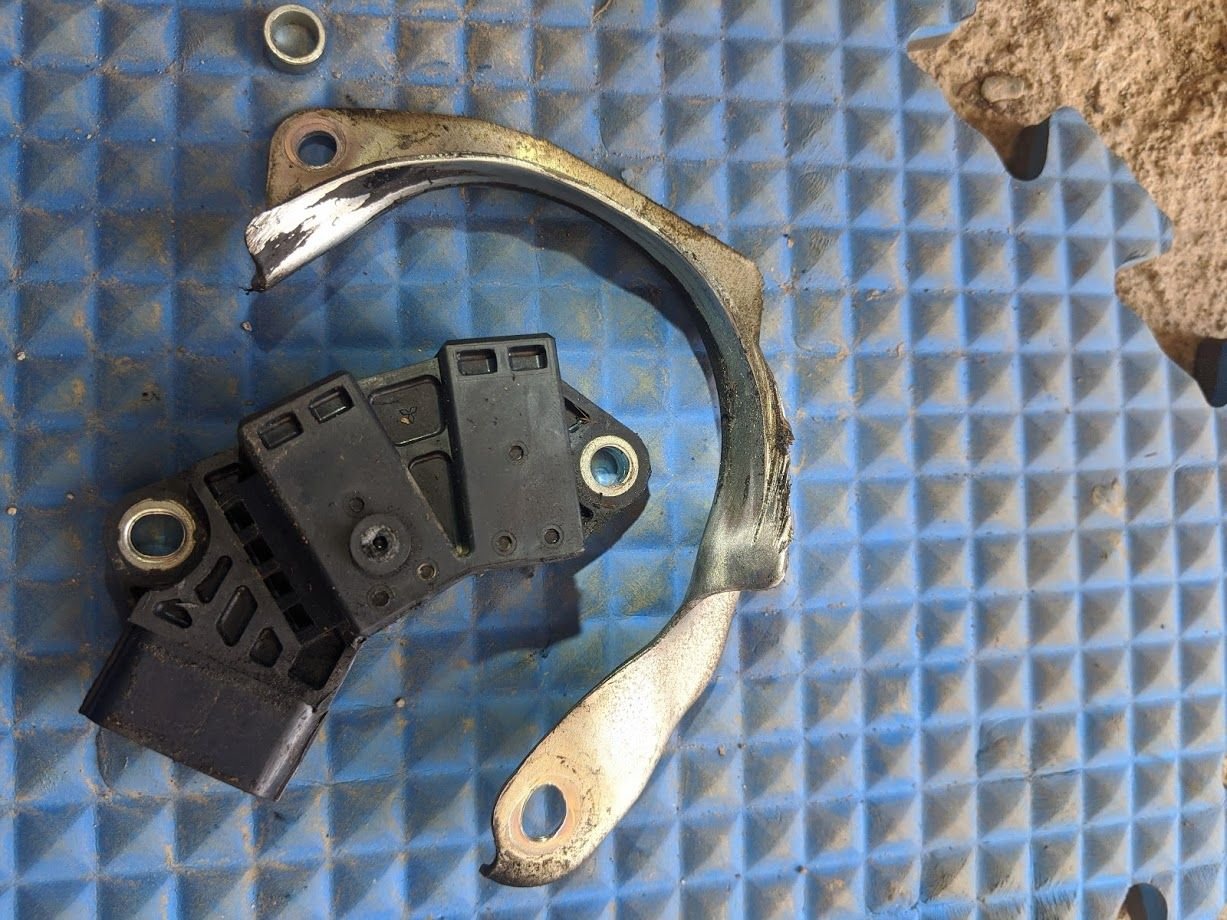

Life has really been kicking my ass lately. I got tested covid positive this past week, and I've been bedridden since right about now where I can finally get back to working on this. Guess I really don't need a car right now anyways.
Check out this catastrophe. The lower belt dust cover is 95% intact, with the seal being deformed at one point, and the bottom right fastener hole being broken. Probably going to have to replace it.
Looks like I may be in the market for a new front belt cover as well.
Apart from feeling horrible, this is extremely discouraging. Who knows if the crank sensor is still in good shape. There's a lot of debris inside the bottom of the tb assembly. Guess the only thing I can do is keep moving forward to get my new belt on to see if somehow the thing miraculously turns over/starts without huge issues. I don't have a high hopes. I'm just trying to replace the belt for now.
If i replace the belt, will it hurt to try and start the car without any of the covers on? I figure it's not worth replacing all the pullys, tensioner, water pump if the engine ends up being toast anyways. I just want to see if my heads are done for.
I figured I could go back and do the WP, tensioner, etc. if things look promising.

hmmm now why is that cover plate all mishapen..
you can definitely run the car with the upper/lower timing covers off to see if it's working properly. Hell you could always just install the belt and then manually rotate the crank yourself

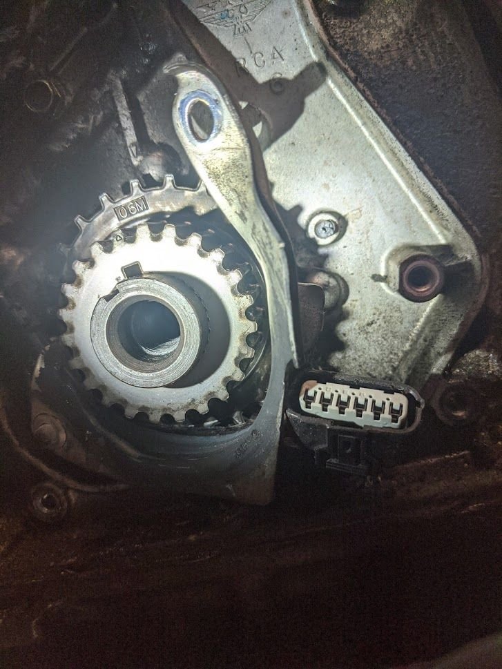

Looks like i need a new crank sensor and sensor shield. The eye for the sensor got busted off halfway inside the block when the TB snapped, and the shield got deformed during this as well.
I'm starting to wonder if I'm just wasting my time throwing money at all these parts. Any brand suggestions for a new sensor where I'm not paying hundreds of dollars?

Thanks, coincidentally I think i mistook the "eye" for something that is just a mounting stud. It may not affect anything even though it snapped off, because the entire assembly still can be mounted correctly with the fasteners. I may be able to reuse my old one.
