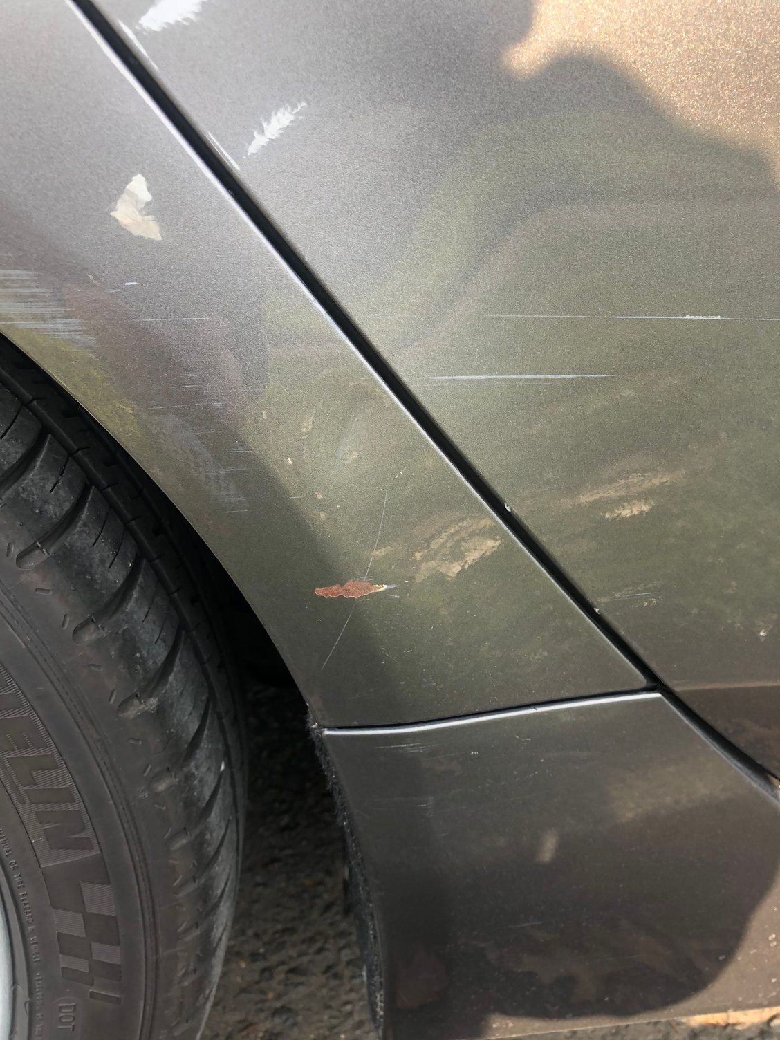

These are the deep scratches I was talking about. Going to get some scratch wizard putty and some touch up paint. Any added advice would be helpful, I know the general process but any tips or tricks would be appreciated. The car has plenty of other marks but these are the only ones that are too deep to let stand.
This is the spot on the top center of the hood that is fading, I think it’s the clear coat, right? I don’t exactly know how to fix this, Thanks

I had a hunch... when I read 18 year old, possibly first car, probably got it for cheap, 10 year old car, mentions lots of scratches... odds were (at least for me) that it'd need more than a paint correction.
You'll need a repaint for those panels with rusted scratches and the hood will also need a repaint.
I wouldn't bother with touchup paint if you're looking to repaint it in the near future.

My advice: just sand and touch up the rusted areas so they don't grow.
Screw repainting.. there's so much better use of that money at your age and you know it's just going to get worse

I think my money may be going elsewhere into the car, at least for the next few months. Will probably still touch up as it’s cheap enough to do and it isn’t a huge investment or hassle.

Yea, I think you can get away with doing "spot touch-up" in your case because your clear coat hasn't deteriorated like mine, for the most part. There were too many panels that clear coat is gone that I had no choice but to respray the whole car.

Most of that isn't all that terrible and can be fixed with a paint correction. It won't be 100% but it will be better. For the ding, a paintless dent remover guy can pull it out either fully or at least nearly gone. I would get touch up paint and fill in those spots that are down to bare metal. Fill in very lightly and do 2-3 coats. Since you're in south jersey (Google paint correction detailers south nj) This guy is mobile KJW Detailing | South Jersey Mobile Detailing Specialist and pretty much right where you said you live. His paint correction starts at $600 which isn't a bad price. You can give him a call and have him evaluate the car 1st. Other than that, you could still use a PDR guy for the ding, fill in the spots with touch up paint and try to wax the car yourself though waxing is only a temp solution.

Thank you for the referral/advice. I’m definitely going to touch up at least for now just to protect those spots, since I think there are some other things I’d like to do to the car first
