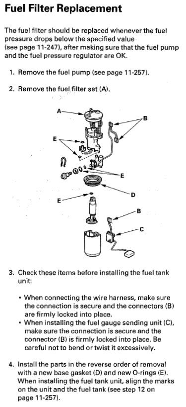

Does anyone know the interval of this? And the location?
I Am at 52k and like to stay on top of everything, but forgot about the fuel filter...anyone know about this?

I think the filter is near or in the actual gas tank. I have 25K miles so haven't thought of this item yet.
Old Sep 12, 2009 | 05:27 PM
01tl4tl's Avatar
Posts: 33,535
Likes: 1,142
unless they changed everything since gen2- the filter is a sock that goes around the pickup inside the tank
Its not cleanable and only replaced if some major malfunction
Run a bottle of good fuel cleaner like redline thru 1/2 tank of gas to clean all the parts

like I said- not really made to be serviced- only if there is a documented problem and it split open or something and allowed crud into fuel pump causing its failure
Then you would need to replace it

ahhhh. I am used to the old Legends where u replace it every 30k and its mounted on the firewall. So i take it this one is a "lifetime" one.
thanks doods!
Old Sep 13, 2009 | 11:27 AM
01tl4tl's Avatar
Posts: 33,535
Likes: 1,142
yes-- maybe not your lifetime,,, but the cars~
